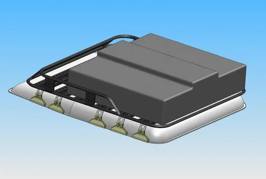

I've been working on a rack design for my RTT
Any thoughts? I still have to add light tabs in the corners and front/back. Also a removable rear section for when the tent is not on the rack. I will be opening the tent to the rear. I also will have mounting bosses for my awning and a deck for the front section.

That is done in Solidworks 2013. $7500 per seat. Obviously not mine, I did it at work in my "spare" time. Gonna add some details to it today and I'll post a couple more shots.

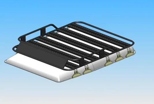

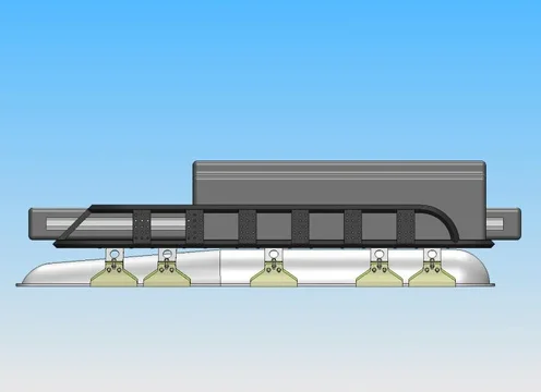

Didn't get as much time on the design today as I wanted. Something about working at work :meh:
I...
added another cross slat
changed the risers to a universal bolt patern and added more
lengthened the rack 2" so the math worked out better
added the front and rear little deck sections
added a bunch more perferations to the cross slats for weight reduction and utility
lengthend the side walls
narrowed the cross slats for better symmetry
added the awning model
etc...
side and top view
Looks great. Nice to see the design ahead of time.
This is going to be like the 45 beds but a little easier:p everyone will want one...

How heavy is that rack going to be? I've never seen so many roof clamps before...
Well yer not lookin' hard enough then. Most I've seen have 4 sets. Some have three and some have five. I've even seen six and seven on bigger cruisers.
My reasons are simple... Firstly, they are free (to me) so I may as well get lotsa support. And B, more means less psi/ unit on my gutters.
As for weight, two adults, tent, awning in the wind, jack, shovel, axe, prybar, coupla fuel cans, duffels of gear.... Could be 800# up there. Plus the rack. I might go aluminum but I will be going thin on thickness. Hopefully good design will make it light-ish and strong.

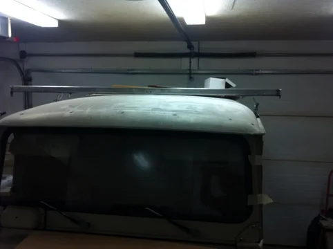

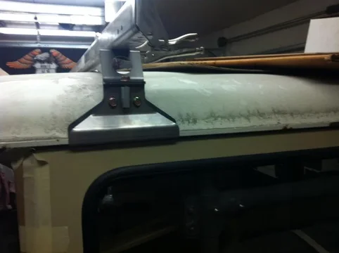

I had time today to build a couple of gutter clamps to test on the roof. I want to see if my design works before I finalize and make them all.
I tacked the coupler nut to the one plate and bolted two gutter clamps in place. Here they are just clamped to a length of angle to check the height above the roof. There is about 1/2" of air under the crossbar.
Here is a end view of the clamp
and a side view. The size of the clamp is 8" long at the foot and 3" at the top. On my computer monitor they seemed bigger in scale than they are in reality. This photo makes it look quite big too but in person they are smaller than they seem. I think 5 sets down the side will be fine.
So does it work? Yes. But I want to make a couple changes. I want to stiffen the upper-most piece. Because it is one dimensional (flat metal) it wiggles and might fatigue over time so I will add some sort of gusset to stiffen it and eliminate the jiggling. The clamp action works great so I'll leave that alone.
