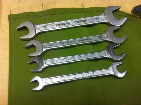

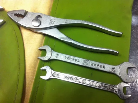

I was thinking more of the jack and bars at first. I didn't really think the later 40 series had the full tool kit with wrenches, plier etc. I do have some Toyota tools that I got of ebay last year. I also have a tool bag that I got from a late 80's pickup at the wrecker.

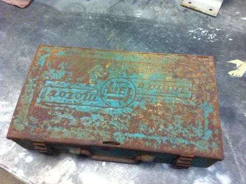

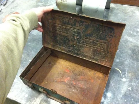

I also have one of these tool boxes. I got this one from mot before he left Japan. It was one that was too rough for him to sell mainstream and I was willing to refirb it. I am going to bead blast it and straighten it up a bit and then powder coat it. Might do it silver/ pewter with the front bumper and the rear bumper thingies.

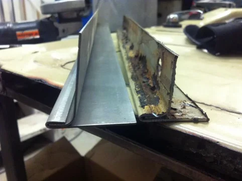

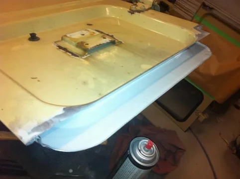

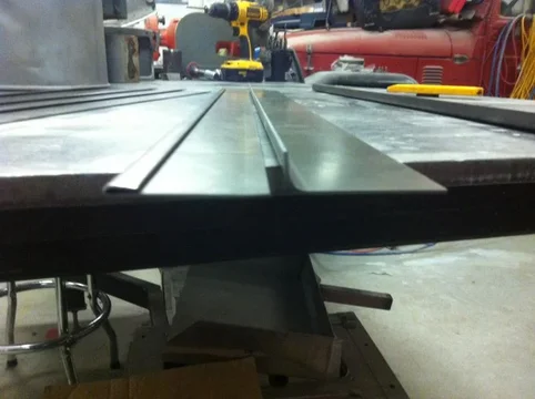

I started the repair of the rear doors. I began by taking a look at the rusted area and devised a plan.
At work I sheared some strips of 18ga and formed two different parts from them. The door outer skins wrap around the inners with what we call a hem. The inner panel goes inside but has a larger radius to the bend. It is also a few degrees less than 90.
You can see how the two parts meet on the door bottoms.

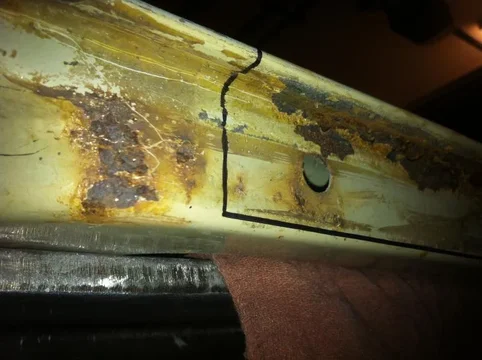

I marked out the path of the zip disc to remove the rusty stuff.
Now you can see where I'm going with this

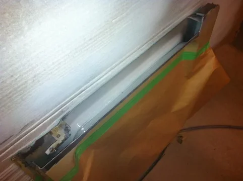

This is an inside view of the water trap.
And a peek inside. Still a lot of surface rust that did not come through yet.
I cleaned and scraped and sanded the remaining internal surface rust as much as possible and sprayed a rust encapsulating coating liberally several times. This stuff is thin and so I let it run into all the nooks and tight spots. I'll let it dry overnight and begin welding tomorrow.
