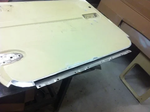

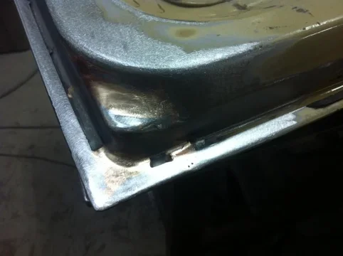

My first 40 series door tear down. It went well. got the glass and seals out pretty easy. The rust is a little more work.

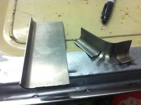

I started by making some profile sections at work, kinda like I did with the back doors.
DO NOT FOLLOW ME LEAD HERE!!
Don't do it this way. I'll explain later. This is what I did. Don't do it this way.

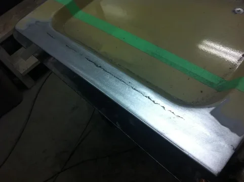

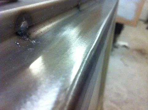

I decided, without enough forethought, to cut away the inner panel rust and leave the outer panel intact. My thinking was I could use the outer panel to locate the inner one correctly. For that purpose it worked fine. So I cut away the inner panel and ground off what was left of the spot welds. I trimmed and added drain holes and spot weld holes to the patch. So far so good, right?

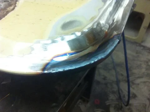

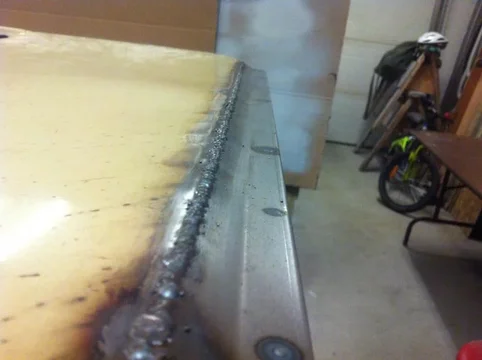

Then I flipped it over and cut away the outer panel rust. I trimmed a patch and welded it in.

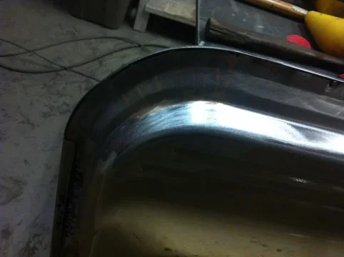

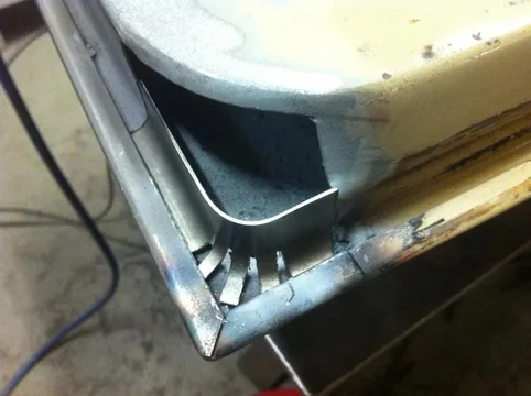

So whats wrong you ask? You can't see it well here and I stopped taking pictures cuz I was dealing with the issue. You can see a bit of it in the third pic here. The weld along the bottom of the outer skin shrank. That put a hugh oilcan effect into the door skin. It bulged up and down and up again. It was horrible.
For those that don't weld I'll attempt to explain. Welding is melting metal. Molten metal is hot. Hot things expand. The $Hitty part comes when hot things cool. They shrink when they cool. They don't shrink much but when you weld a line, even tack,tack,tack a little at a time it will shrink enough to notice. Normally I would deal with it by hitting it with a body hammer and dolly. The impact of the hammer mushrooms the weld bead and effectively stretches it back.
But I can't put a dolly behind this weld because_I_already_welded_the_inner_panel_in_place. :bang:
I was tired and too confident and things went from bad to worse. I started hammering and cutting and welding and things just got worse. I should have just walked away and come back later but I kept going. Worse and worse it got until I finally walked away. I am too embarrassed to post a pick of the carnage but suffice it to say there will be a skim coat of filler from the door handle down to cover my gaff.
What I should have done was cut out the inner panel and dolly the weld bead down before re-welding the inner piece in. Lesson learned.
