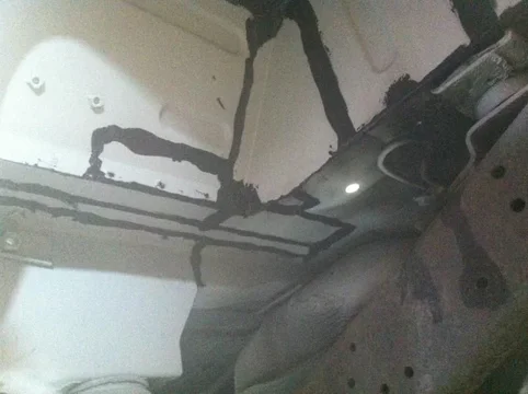

I'm still working on it. After the last update I sealed up all the joints and even ran some over all the welds I made.

Then I installed the rust traps, er, support brackets. I could have fabbed something that was less of a water trap but I wanted original look so I bought these from CCOT. I used a floor jack and length of pipe as well as vise grips until I got them into position and tacked. The epoxy primer is easy enough to weld through but that sealer is a real pain. Poppin and fartin and drooling all over. but they're in. Also did the seat anchors as you can see.

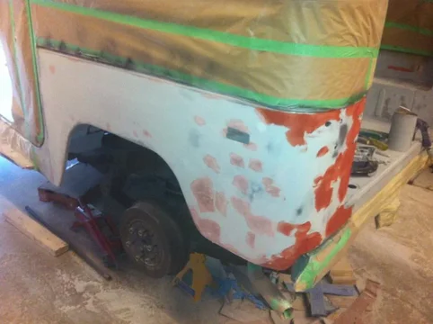

I also made progress on the quarters. A skim of bodo, sanded flat, filled any defects.

Sand, fill, repeat.
Flat enough. I have two coats of filler on now. I will block it once more and shoot color.

Ahhhh body work, everyone is hot for the sheet metal work then the crowd goes quiet during the time consuming block sanding....
I like it all and even like getting in the booth and spraying the colour...
Looks real good ;)

me, i HATE the feather fill and sanding, right up there with 'E' controlled diesels.
i sub that out to those that enjoy that kind of work.

I think the number one mistake rookie body guys make, they do not wash with final wipe and rush the high build primer sanding. We would spray the lower quality primer which shrinks alot over a 24hr period.
They would spray shortly after and have paint issues...
Now if you shoot PPG 300bucks a gallon, you can sand it in less than a hour and there will be no shrinkage, it contains high build and eching primer combined...

I appreciate the offer but I have a decent primer gun and after Thursday's issues I believe I will buy a good gun. I'll get enough use out of it to justify the expense I think.

Thank you for the advice. I am a novice when it comes to paint. I have the basic steps down pretty good and I have painted a couple of motorcycles with good results. I just take my time and let my OCD run rampant.
I alluded to issues last Thursday. I had decided to seal and shoot color Thursday evening but had trouble getting a nice smooth coat on with my gun. I have a 1.5 gun that is well built but with the primer mixed 4:1:2 for sealer its so thin I think I need something smaller. I was rushing and made a couple of runs and had trouble with access. I had put a regulator right on the gun which made it too long without a swivel on the air supply. Reaching in the side doors and rear doors was awkward.
I was in a hurry and it just wasn't comfortable so I shut her down after a thin coat of sealer.
