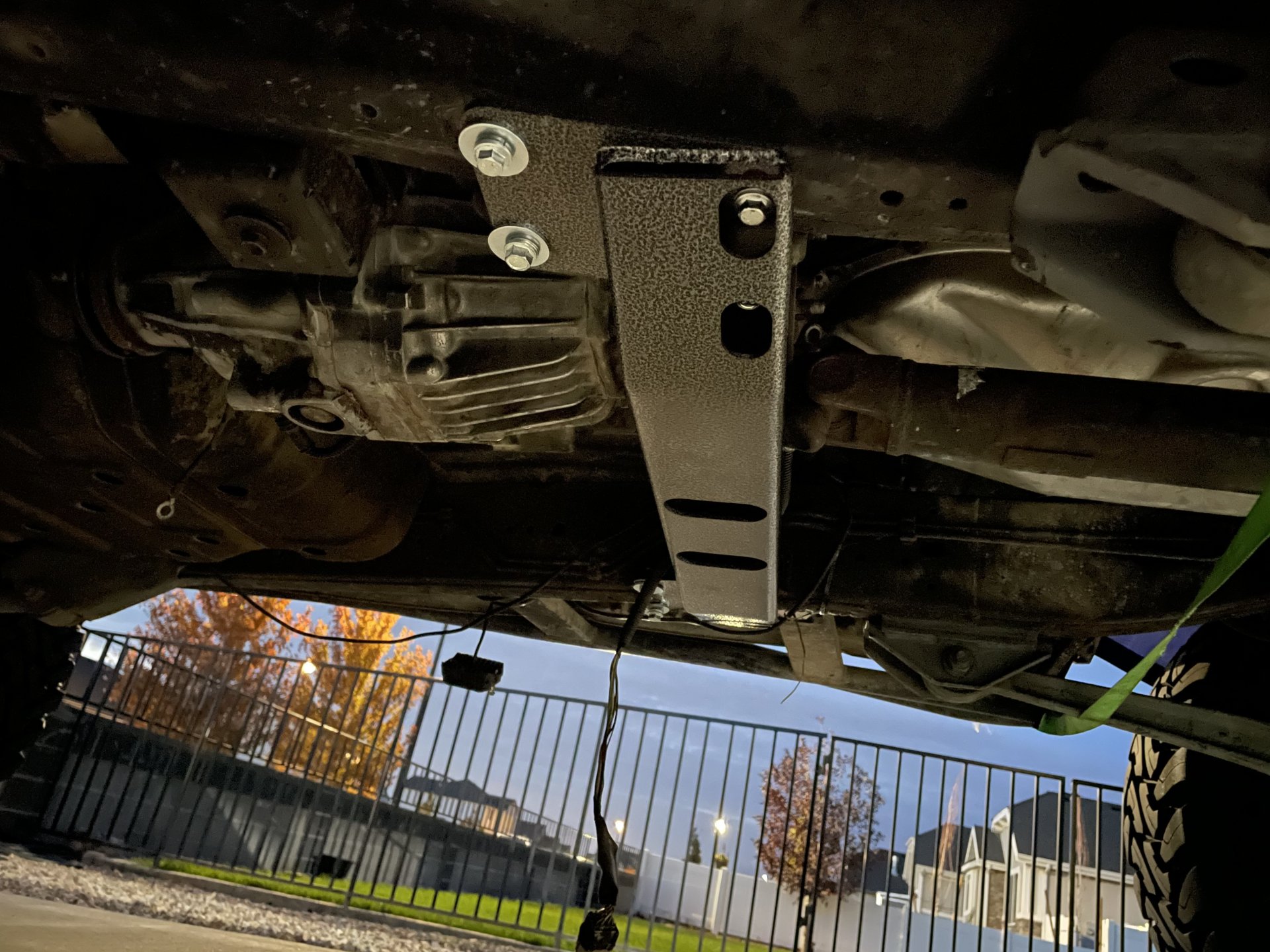

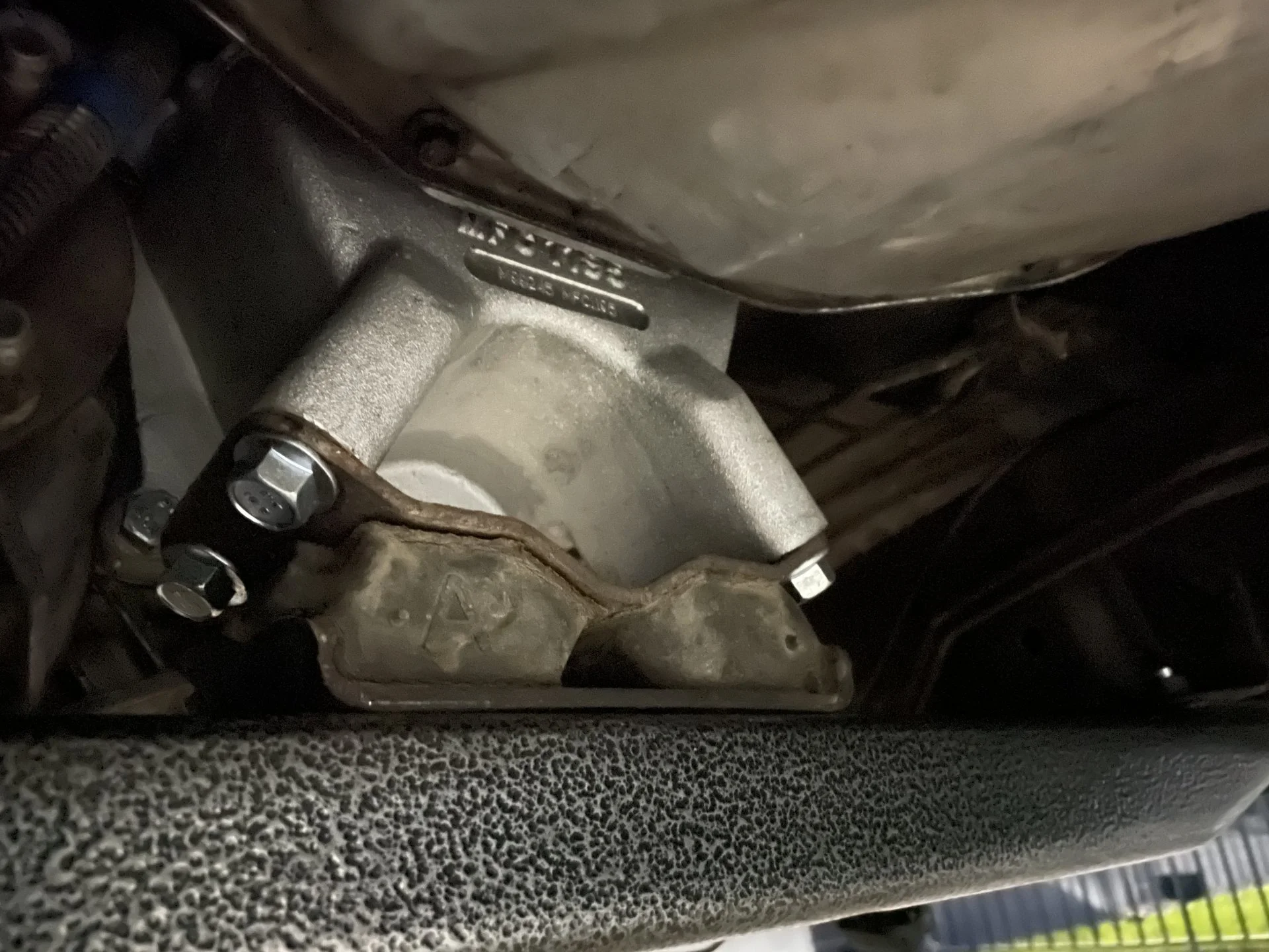

So impressed with Selkirk’s motor mounts and crossmember. They fit everything within cm of firewalls, coolant lines, brake lines…strong work coming out of Idaho. If I met Mark from Mark’s adapters, I would punch him in the nose. Next time I do this, I will not be buying that adapter. I will drop the coin for an atlas and just make a crossmember.
With these motor mounts did you have to do any cutting. .and could you explain how you installed?
No cutting. Direct bolt in application for the motor and crossmember. Having said that, if I were to do this again, I would pony up the extra $1k for an atlas and simply make my own crossmember. This would be in place of the Marks adapter. I hate that thing. I still haven’t gotten to my CDL switch yet but I’m planning on it kicking my ass. With an atlas or even a 300 I would just need the part time kit for the 80. Seems like a more solid combination since my t case has 240k miles on it

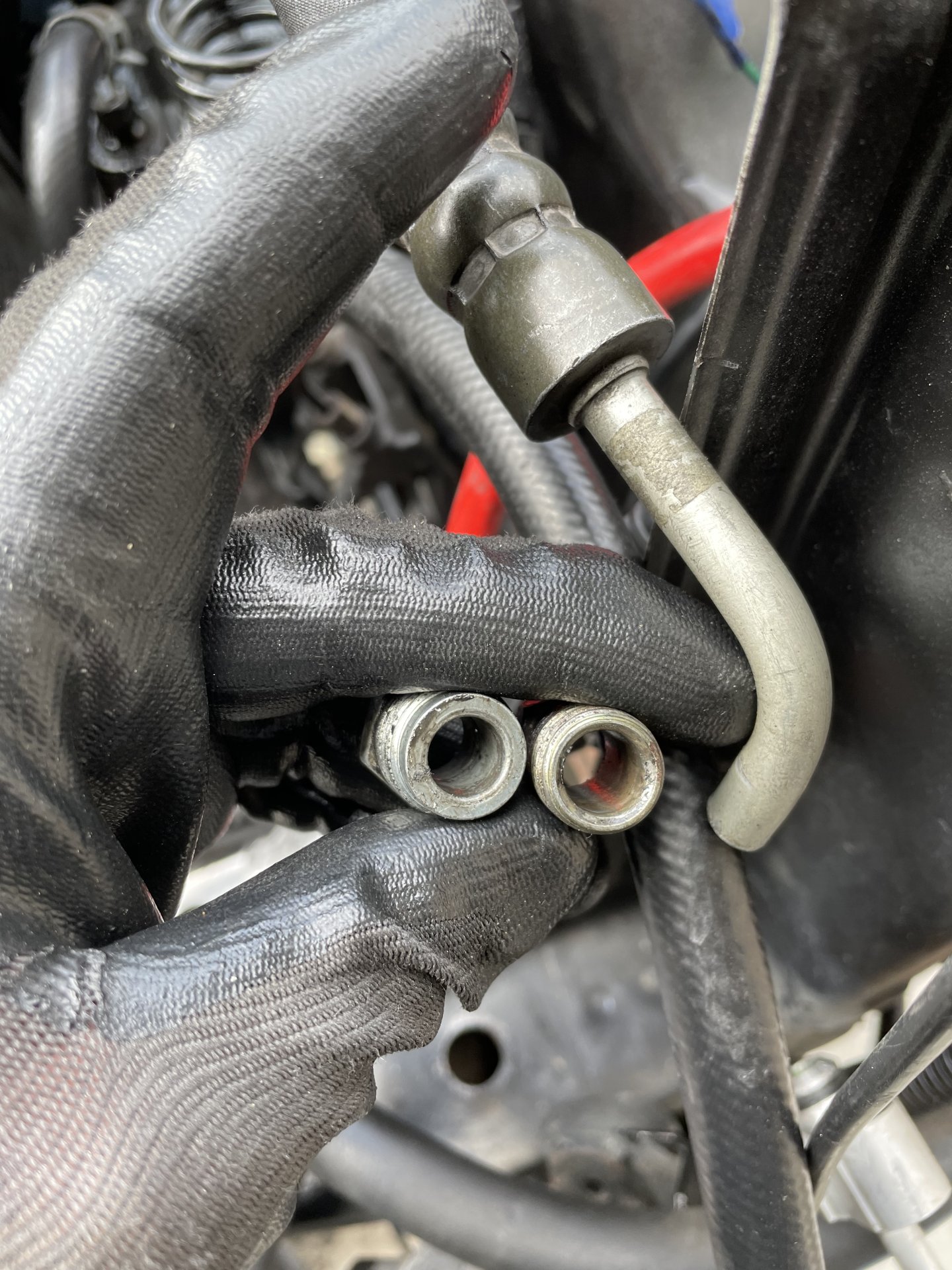

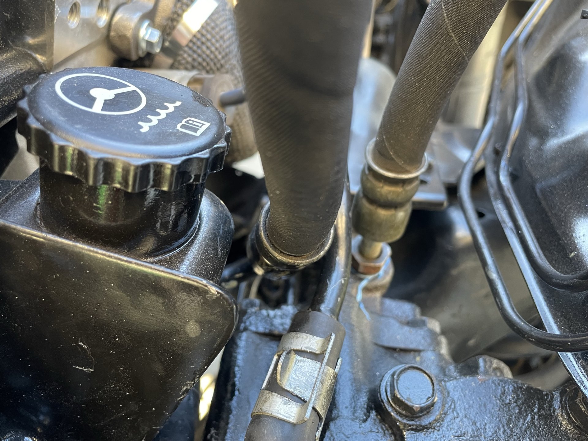

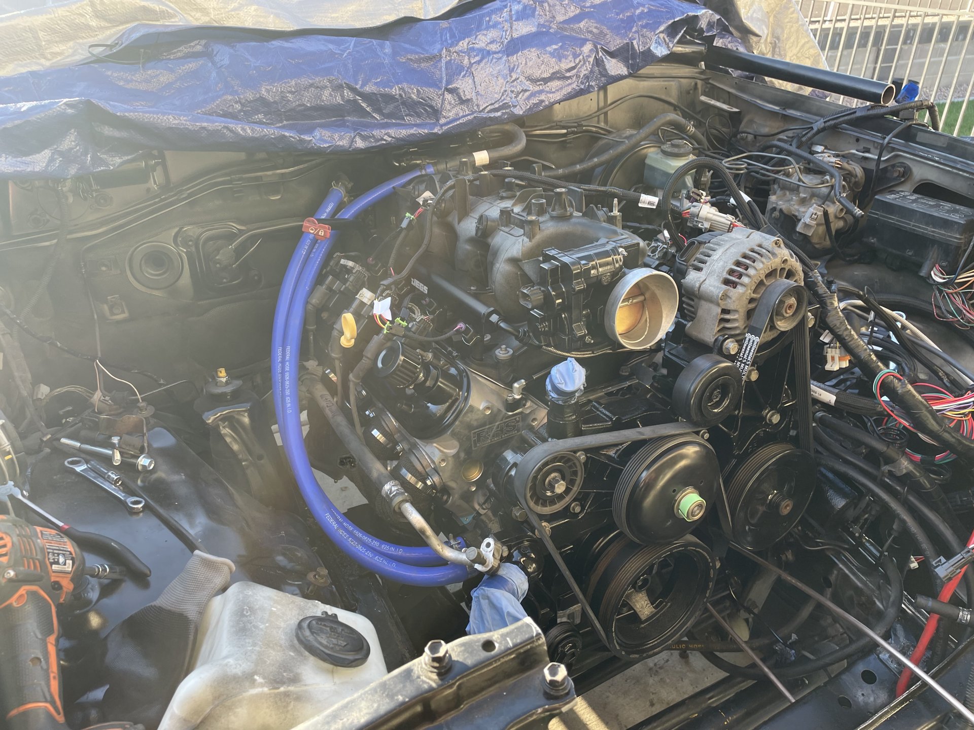

Power steering… there was enough hard tubing for me to cut and replace the gm male connection with the stock yota one. The Gm power steering pump has a line that is not removable on mine so this is what I came up with. I also removed the old paper clip cooler and ran a finned cooler in the same spot.

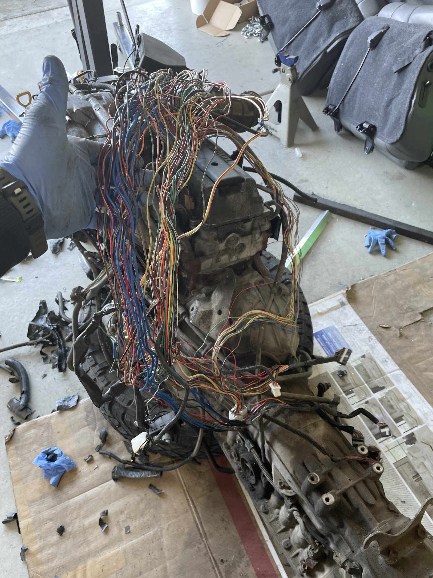

This is the wiring. I’m going to be blown away if it all works the ways it’s designed. I kept everything that goes to the T case and I also bought a CDL switch so i can do the 7th pin mod. Hopefully that gets my t case locked up when I want to.

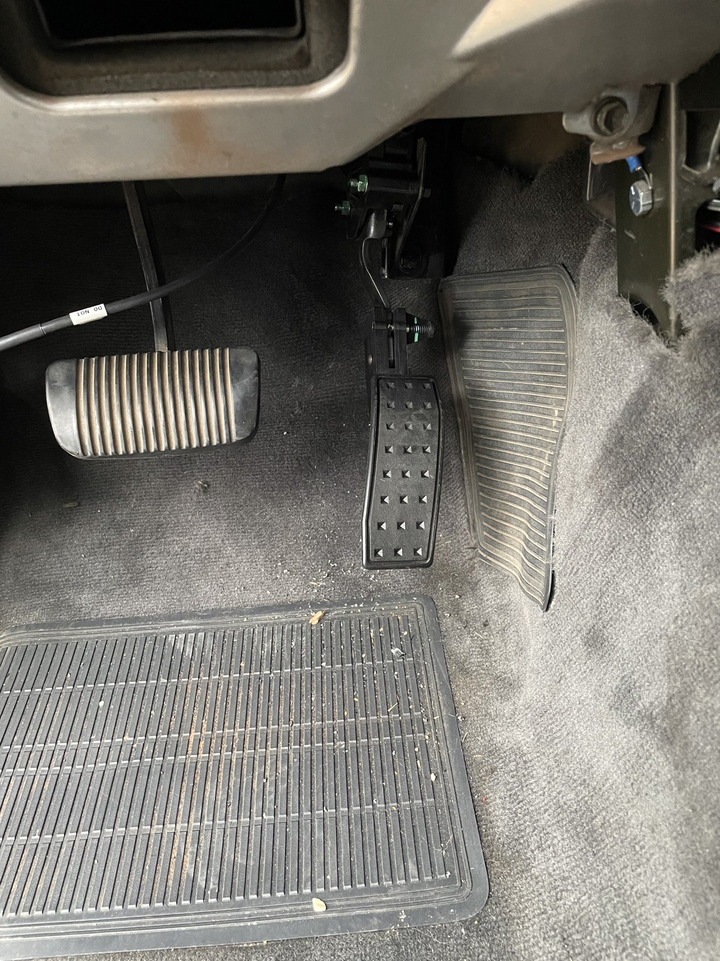

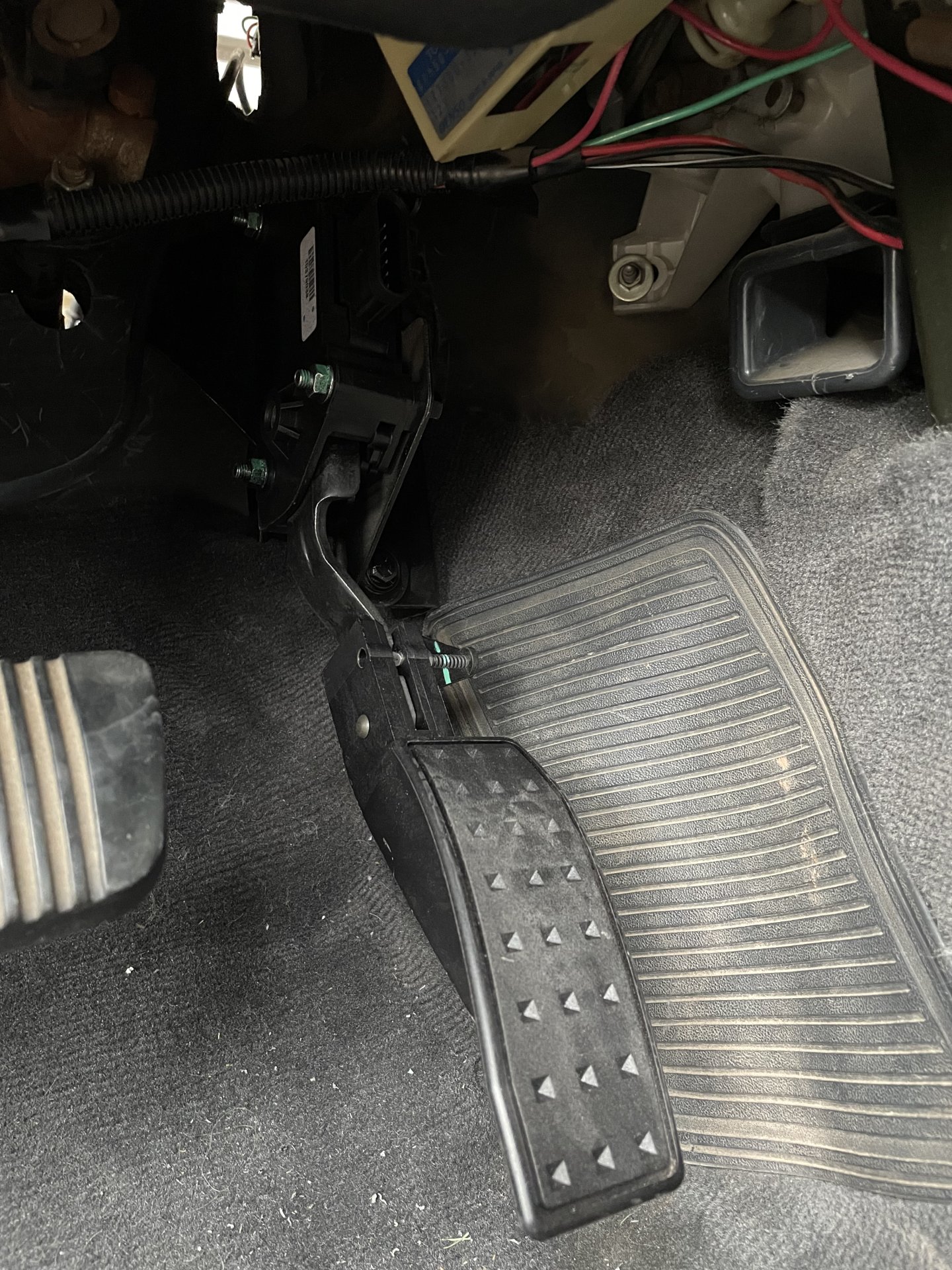

Accelerator is in. Crazy hard to get it all to line up but here is the bracket I made

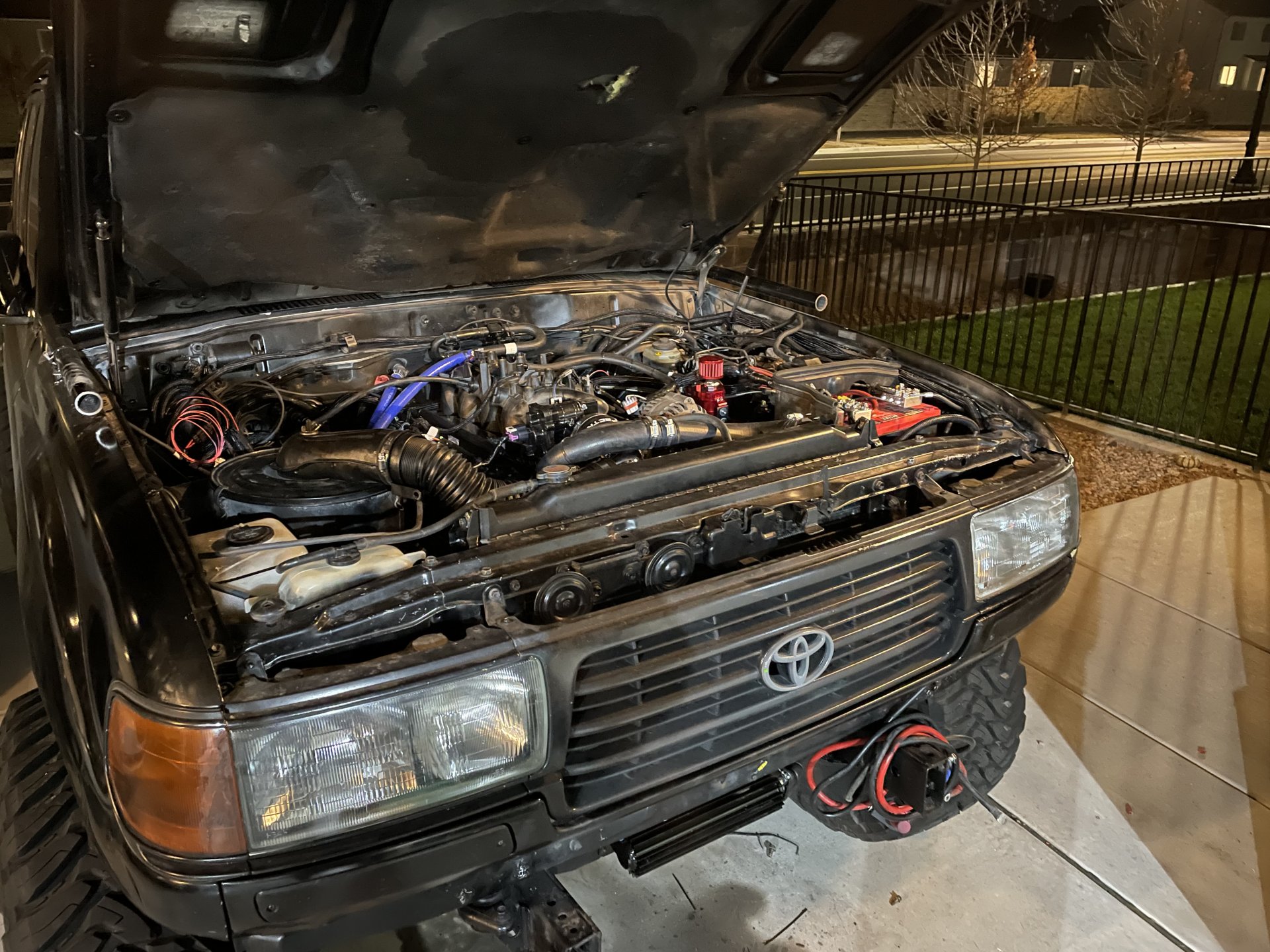

I’m getting into the nitty gritty of the wiring now. I cannot find the main power supply to the Toyo ecu. I am running a Holley ECU for my motor and trans so that will run off a separate system. Is there anyone who can help me locate the power for the rest of the car?
