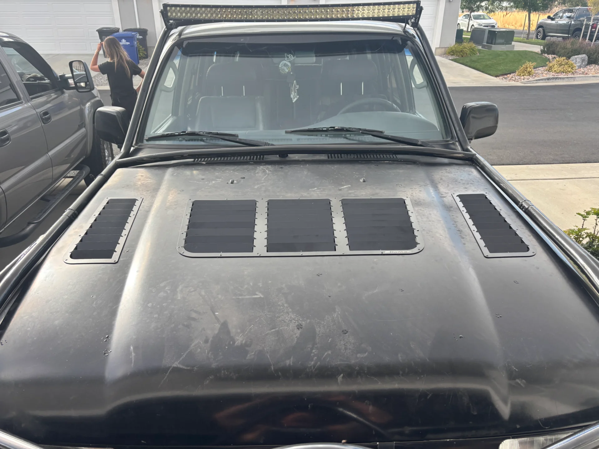

Hood vents in. Fast forward to summer, temps are staying a little lower. She still gets hot moving slow on trails when it’s above 90
Did you mod the fan clutch oil to help with heat?
Engine temp. Once it hits 220, it doesn’t come down unless I shut it off. This is happening while climbing at slow Moab red rock speeds
So your ECT hits 220....that's alarming and not right. You said you have Aux electric fans?
How old is your water pump and your radiator?
Also are you monitoring the temp gauge on your instrument cluster?
