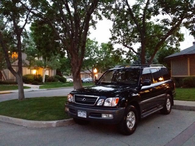

Whole lot easier to find a black LX470 than an LX450. This thread might just become an engine swap thread. Can I keep it in the 80's section since I am using the 1FZ? lol
Trade me any one of those LX470's for my LX450. I will have all the body work done and resprayed black for you. Im in Denver and will even drive it out to Moab for you.

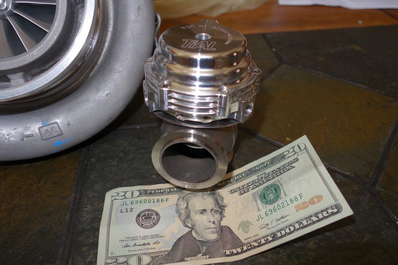

Wow! $20 each for those! Man....What a DEAL!
That's a big ol' turbo! Or an example of the shrinking US dollar!
Yes, I know. My wife would have said it was at LEAST 12" in diameter.
Well you have been lying to her about 8" for all those years. :flipoff2:
It is a 5" intake, 3.5" output on the cold side.
The hot side is going to be a Tial SS housing it hasn't arrived. But it will be 2.75" v-band inlet with a 4" downpipe outlet. A/R 1.30.
Another small piece of the puzzle. If this one works it is going to be my best idea yet! Lol

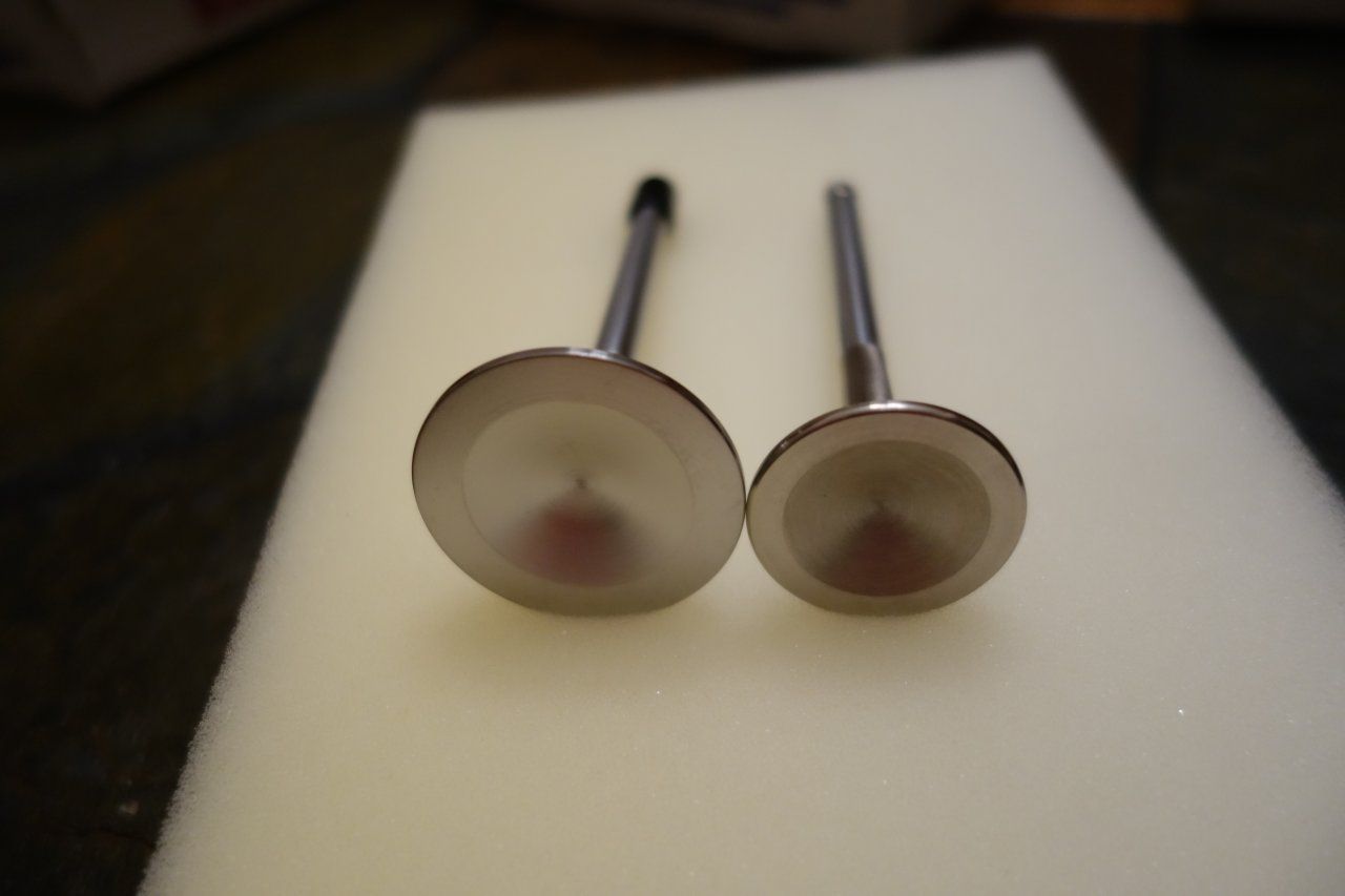

+3mm intake valve, +1mm exhaust valve super alloy
Cool to see the intake valve stem is back cut for more flow

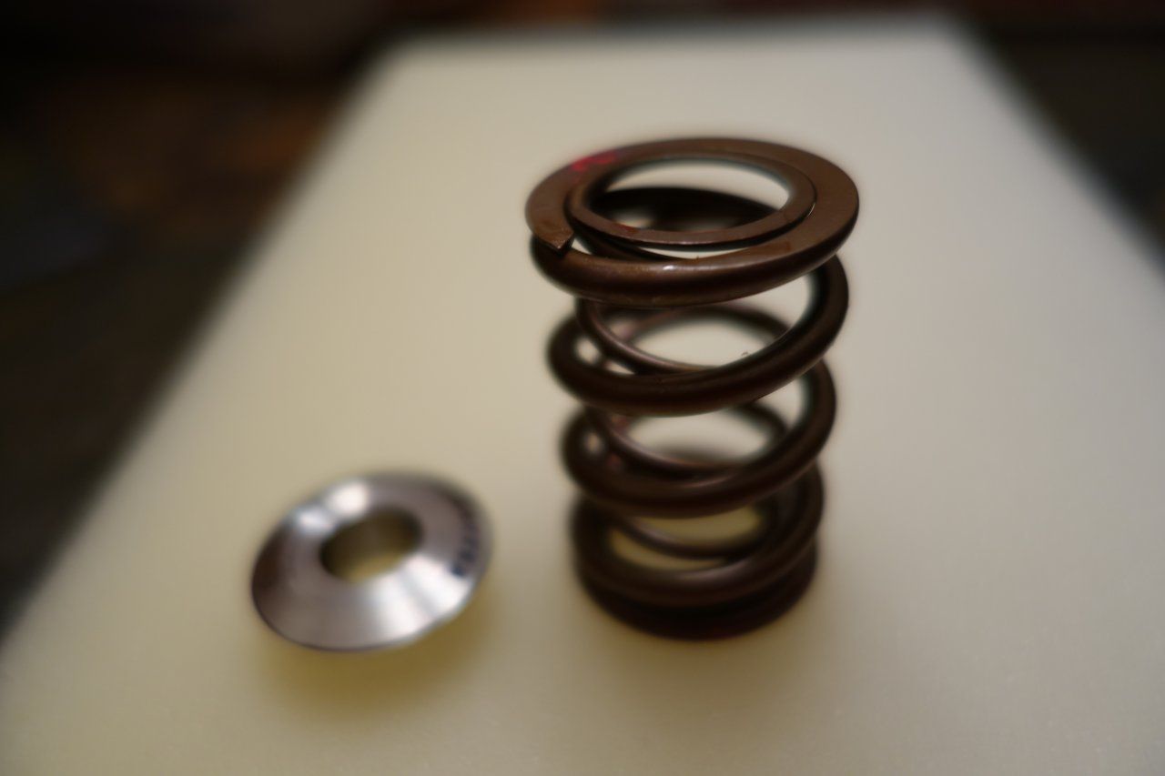

Dual spring valve springs. Seat pressure 75lbs at 33mm, coil bind at 17mm, I am only going to run 10.35mm/10.55mm

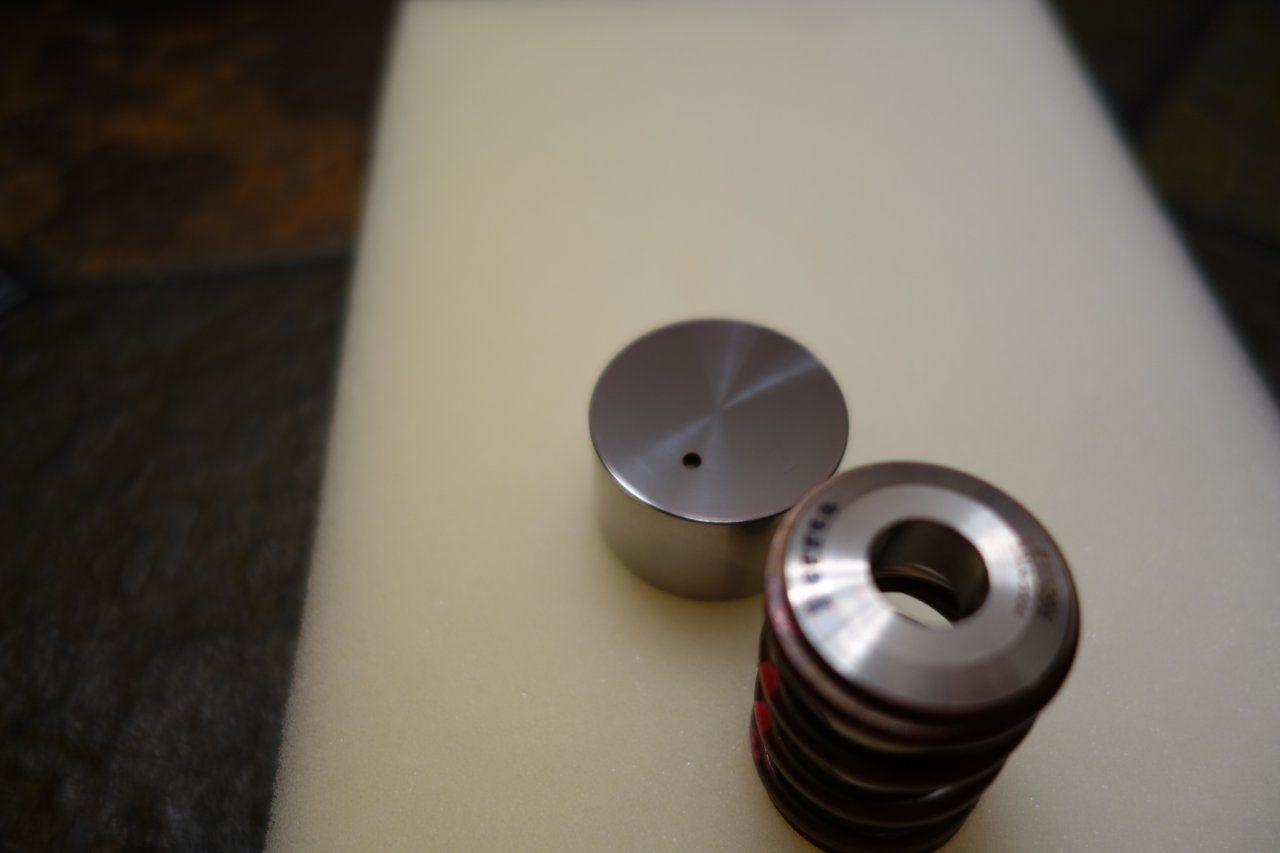

Spring retainer fits the solid bucket, I really need to pull the head out of the box to test it.
