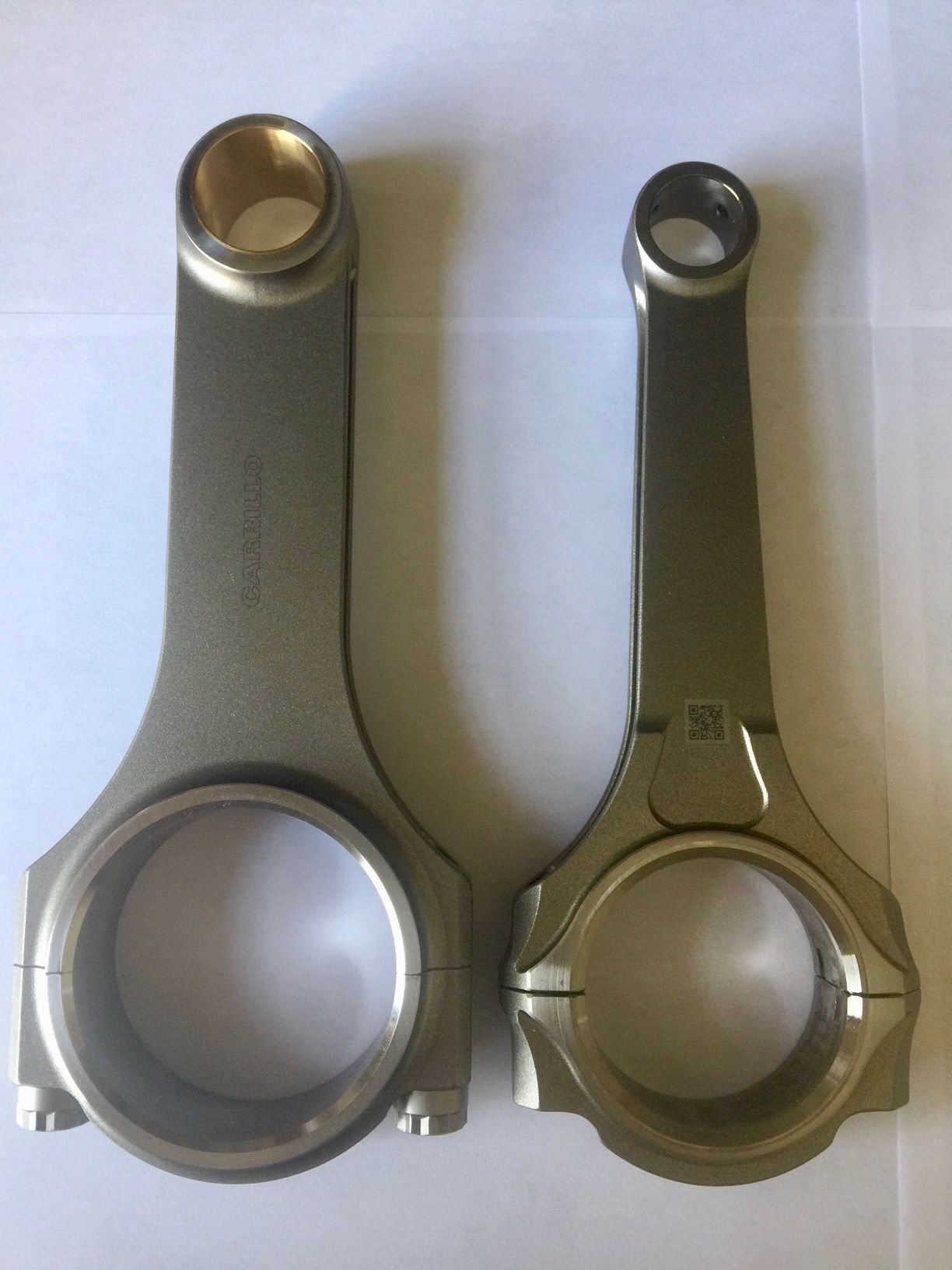

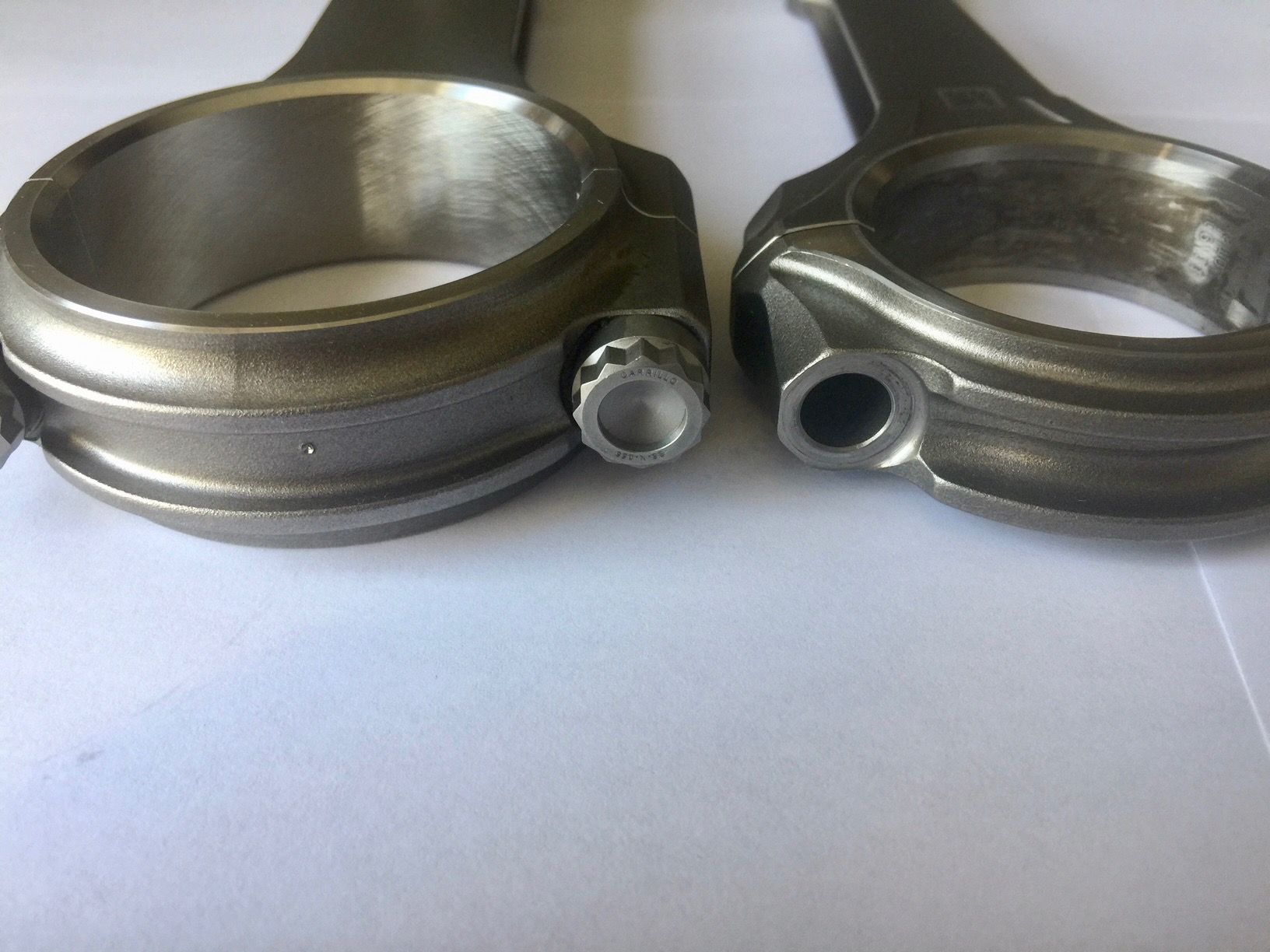

I thought this would be kind of a funny demonstration for anyone that hasn't seen just how beefy the 1FZ bottom end is. These two rods are both done by Carrillo/Penkl they are both about $2300 a set. The little tiny rods are for you know just a 900hp V8..... the other rather rotund rod is the 1FZ rod! And if you remember this rod is even 20% lighter than the stock rod! Short of a diesel there aren't many bottom ends near this strength.
Weights
900+ Hp V8 rod - 535g
1650+ hp 1FZ rod - 760g
Stock 1FZ rod - 910g

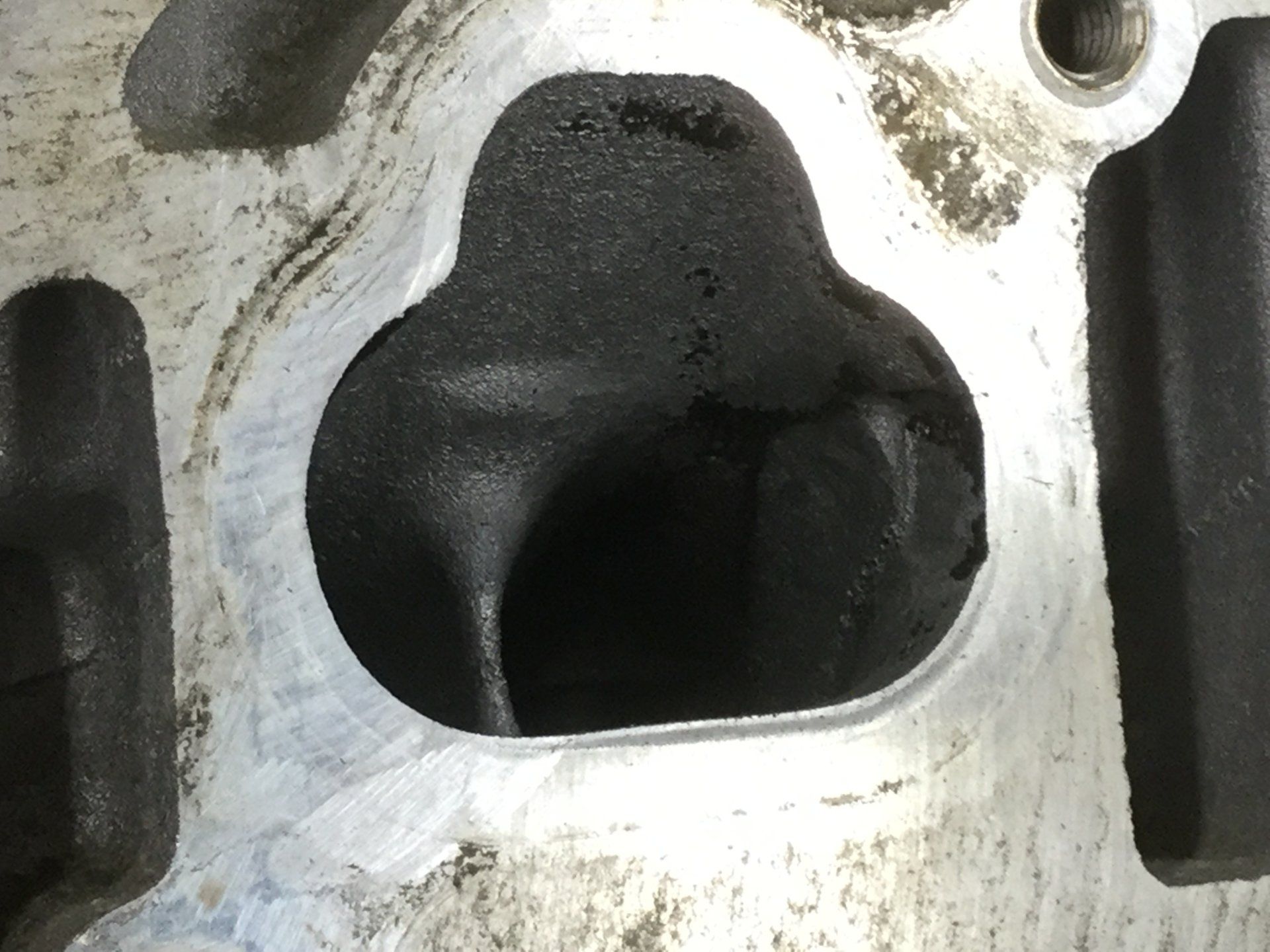

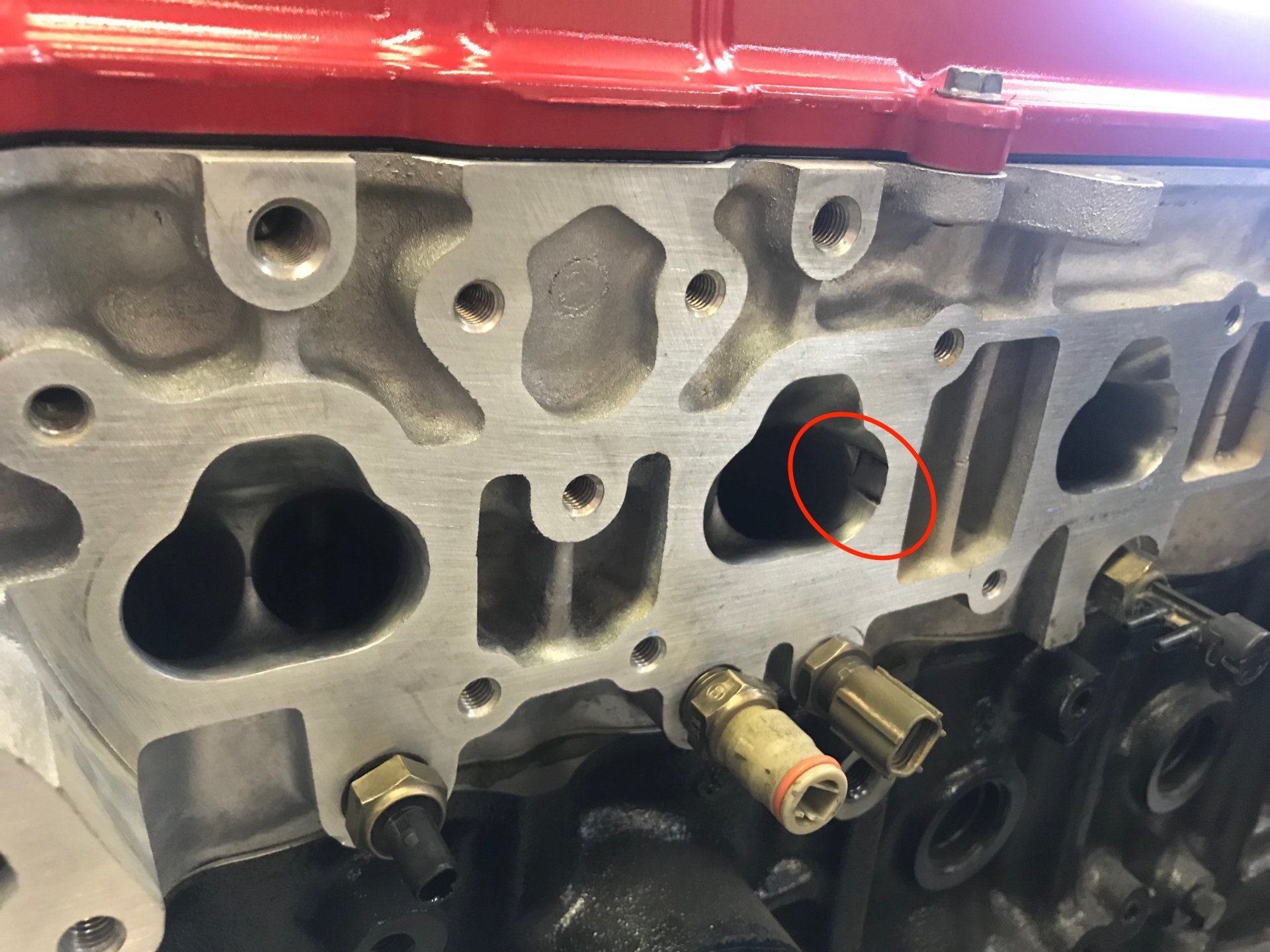

Not a huge deal, this is Robbie's port job but you can still see it in the second port from the left on the right wall and this is after he has worked on it. Stock it is even more dramatic. I was able to get rid of it, but like I said it was a little nerve racking not knowing why only that one cylinder has it and what could be underneath.
Just got back from trip. You’re right, mine has it also, kind of like that mysterious boss above and between intak 1&2, and the associated extra cam lobe.
Right, and you will see how much material you have to remove to get rid of that inside the runner. I bet it is close to 1/4" at the high side. That is what I meant when I said it would be nice to have a practice head to be able to just cut on with reckless abandon so you could see what was behind there or how much area you could remove. But I feel pretty good about where my head is right now, I didn't do a lot of port reshaping, just a little and mostly a lot of clean up.

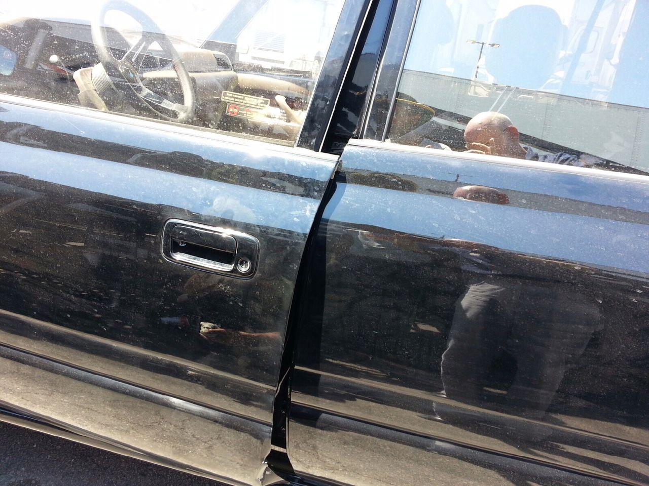

Ugh this makes me sick to my stomach. Just shipped my trucks across the country and the shipper left the door open backing off the trailer and stuffed the door into the side of the trailer.
So fortunate that Cdan was there to witness it all. But looks like my newly painted LX is likely going to need a new door and hopefully the pillar where the hinges are mounted isn't bent. And yes that is as closed as the door gets, it is hanging 2" low at the rear. ****! I shipped this truck across the country from Oregon to Virginia and back to Utah to get a clean cruiser. And of course the paint is non-factory. :-(
That's focked up. I feel your pain, I've been screwed before by a moron transport driver as well. At least yours will be well documented and quickly resolved. Good luck buddy
Thanks man, they are taking it to Cdan's body shop. The situation is kind of odd since I contracted with one company who subcontracted it out to another company. They don't want to turn it over to insurance so we will see what actually happens.
