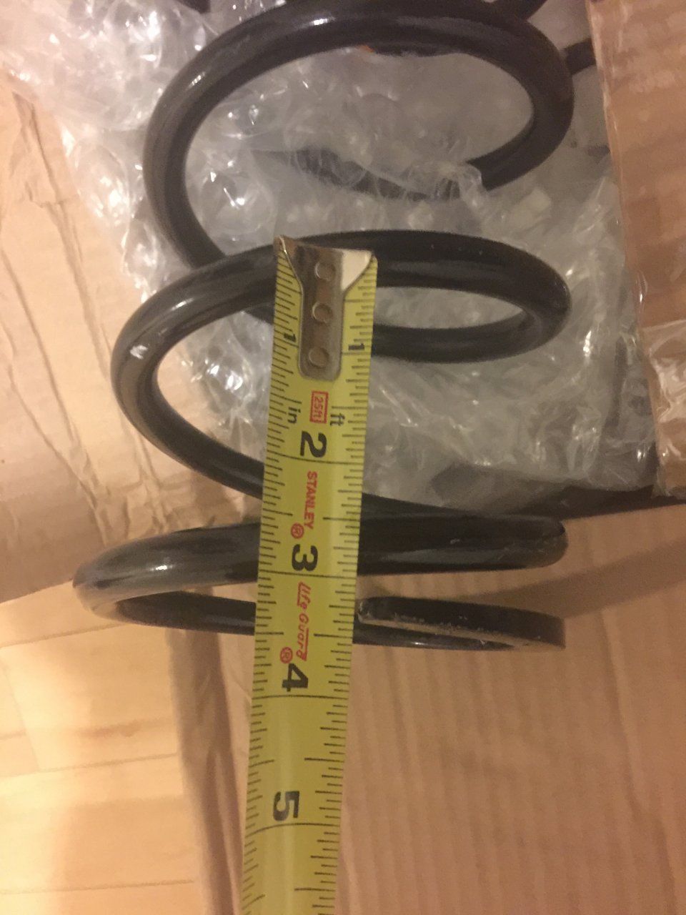

Cool, I finally had a chance to open the boxes from Beno. The new stock LC springs showed up and look to be just right.
The full wrap is 3" in height and there are right at 8.25 wraps. So if I cut a single wrap I should see a 3" drop and a small raise because of the increased spring rate of about 22% from the stock LX coils (10% for being LC, 12% from cut)
Guessing maybe 2-2.5" overall drop. Not huge but should also help with all the same drivetrain issues/vibes when lifting over 2.5". While part of me wants to just say screw it and chop 2 wraps out since it would be better looking I don't think it's a good idea. Lol

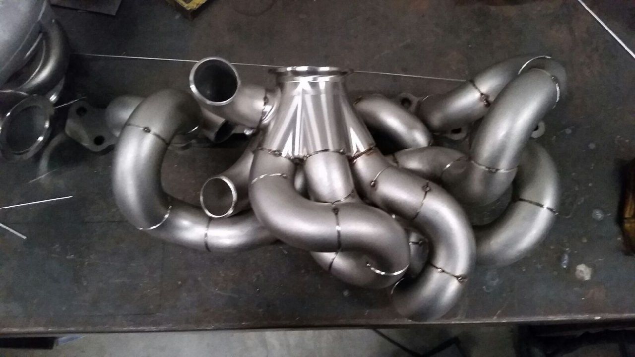

Some more tweaks and changes but very close now. Only 1 runner left to lay out and then time to witness mark and weld! Definitely looking forward to getting this thing in my hands. Lol

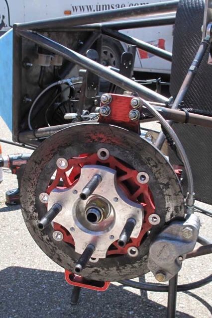

One issue with two-piece rotors that I've heard about is bad heat-transfer characteristics between the rotor and hat if they are different materials. On my school's formula car we have tabs holding the rotor to the hat made of machined titanium which apparently remedies the issue. This isn't my picture but shows the tabs pretty well:

That turbo header is both scary and beautiful at the same time!
I doubt titanium was selected for its heat transfer properties, as titanium has poor heat transfer properties. Weight and strength in that application. An aluminum hat is going to conduct heat away from the rotor much better than steel, but that heat is going to end up in the hub. Whether that is an issue or not remains to be seen.

I did think about that, and I even just thought about using the trucks stock springs but I just figured that most springs were getting to be 20+ years old and they were probably not as stiff as they should be. So I bit the bullet and bought new. I will start with 1 wrap and if it looks stupid, I can always cut lower :)

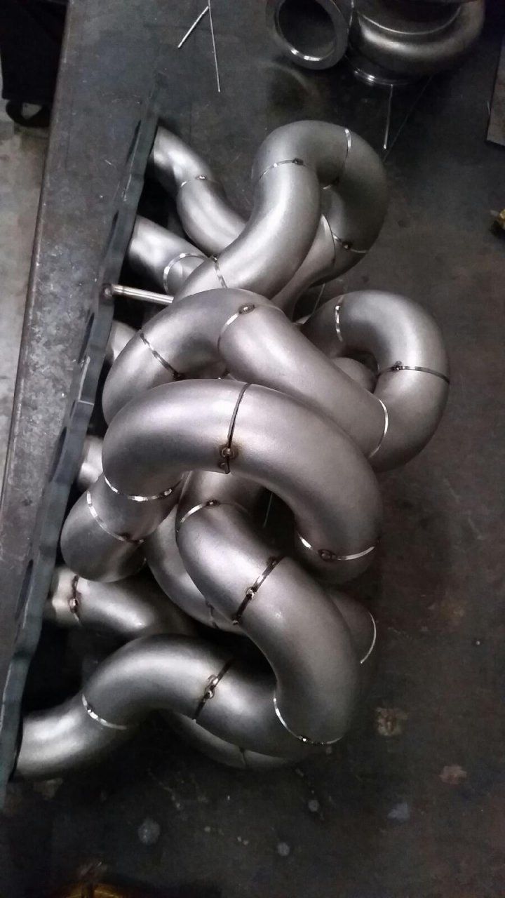

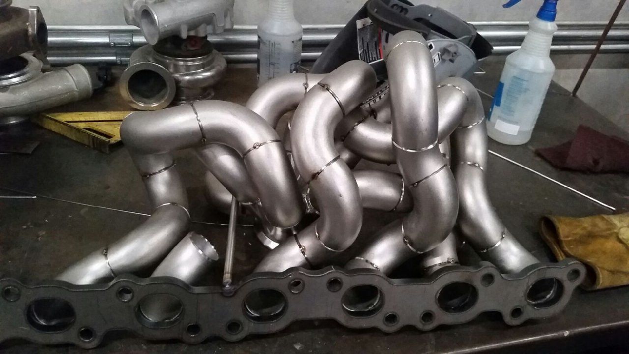

Runners finalized! What a mess of spaghetti! lol. I was told the finish welding, flange surfacing, and port smoothing should be done by the end of the week. :steer:
Haha yeah it is kind of crazy, would have been so much easier, cheaper and boring to build a log manifold. But I think this will be kind of cool under the hood definitely unexpected. lol.

Also that manifold looks........ Okay :O
