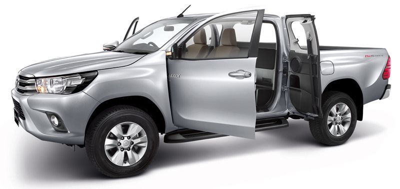

Have you not recognized that not even lambos have Lambo doors anymore! Lol
YUP
