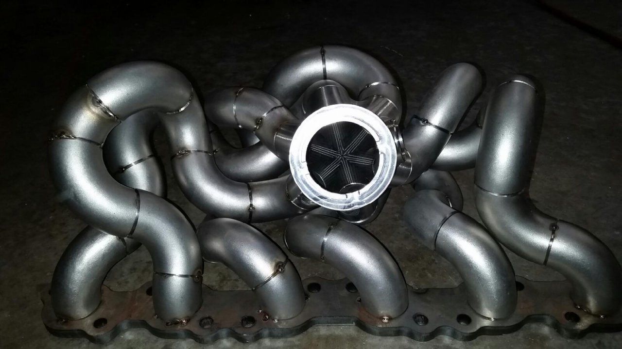

Why not use a electric vacume pump from a diesel Ford?

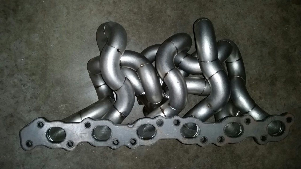

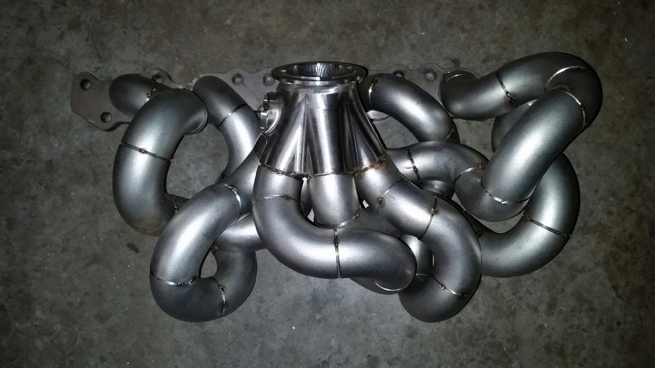

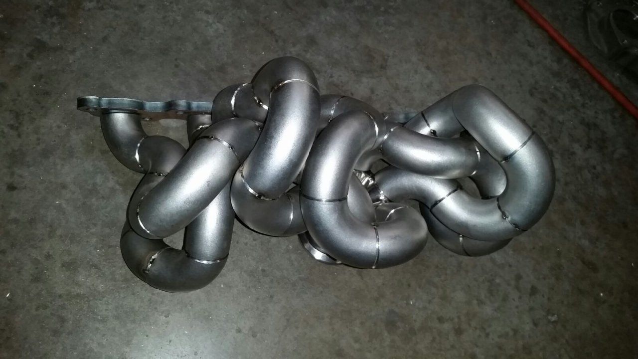

Also that manifold looks........ Okay :O

Look what I found.
