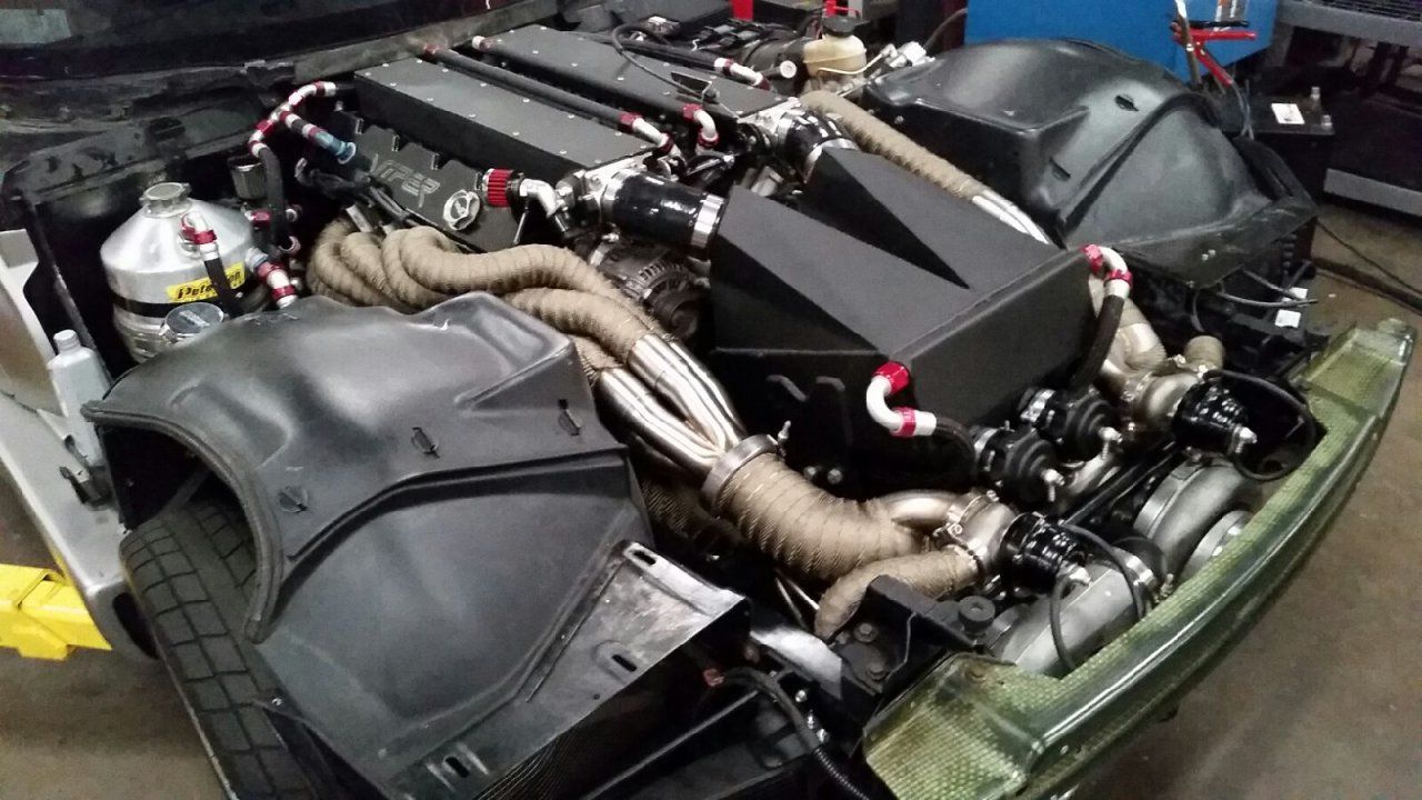

Well looks like Marc is finally finished with his little side job and can get back to my important work!!
This little guy only made 2400hp. Lol
Dyson ain't got s*** on those two snails. Talk about suction!
Haha just because I love crazy numbers. Those two turbos are sucking in about 3250 cubic feet a minute. Lol
I got a couple buddies that use the run close to 1600hp on their old foxbody mustangs. The custom fab work to make those manifolds are incredible, not to mention the detail to make them look like pieces of art that just blow hot air, lol.
Yeah, the guy really is very talented. I know I said it earlier in this thread and in my other build but I feel very fortunate that he was the one to work on my old junk Land Cruisers! As a fabricator building manifolds for a 400-500hp 20 year old truck when you have customers lined up with new Vipers, Lamborghinis, Supras, etc is not the most exciting but I appreciate that every job he does is perfection and he won't rush or cut corners just because it is a 20 year old truck that I only paid $6k for. lol. He is a true craftsmen and I appreciate that. It is becoming harder and harder to find!!
