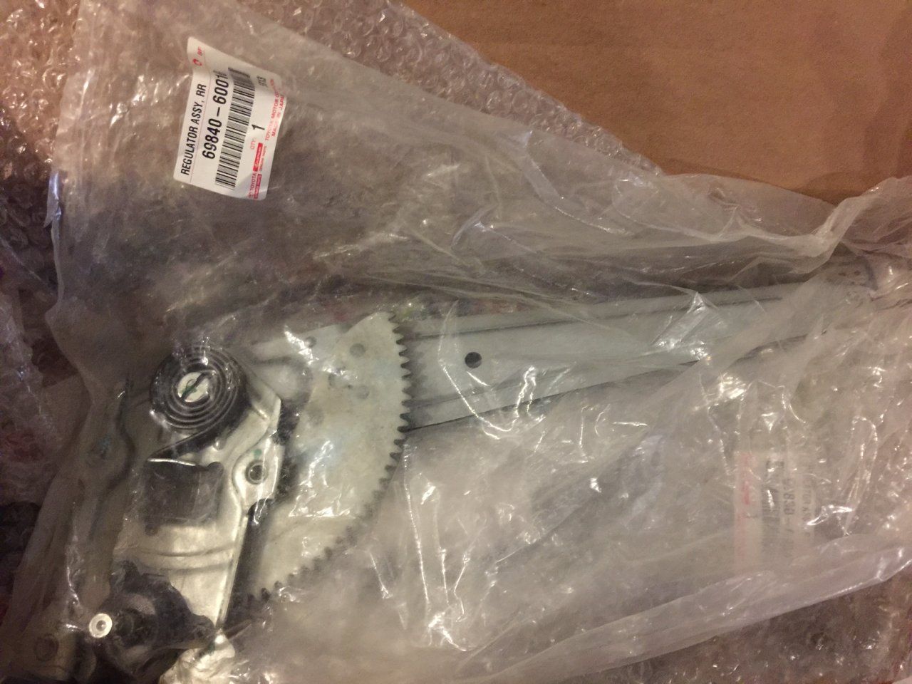

Hmmm another box of cruiser junk.
This might be the first box of stuff I am questioning wether I am moving forward or not. lol.

Curious to see how the manual window conversion comes along, if you choose to go that route.
What is the weight difference between the 2 window mechanisms?

Yeah window mechs will save a little weight. The biggest savings is just going to be pulling all 3 rows of seats and replacing them. Pulling the spare tire and mechanism, pulling the receiver, replacing the sliding windows, just removing all the unneeded stuff, etc. I would bet there is close to 300lbs of weight savings but that is about it.
