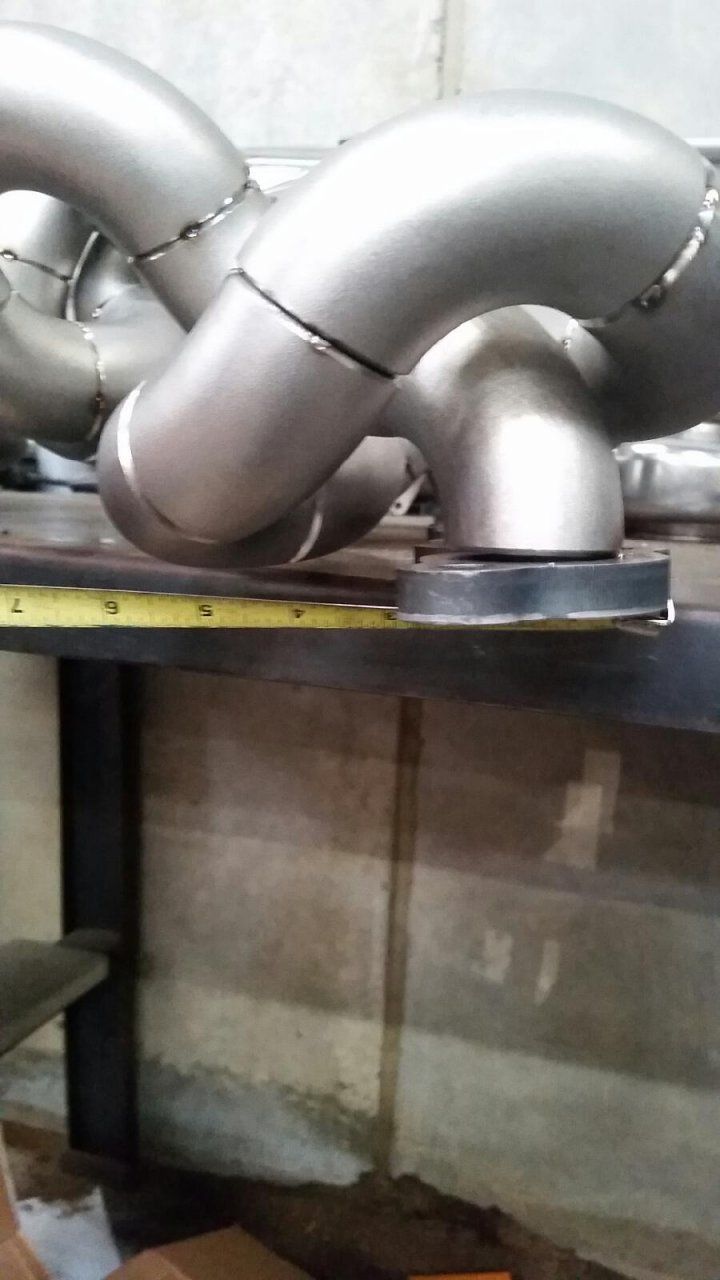

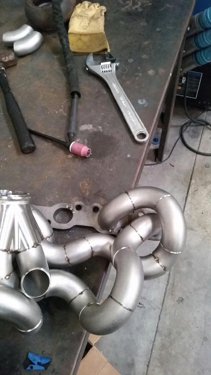

Marc doing a little more work tonight but I think he is going to have to find a new route for cylinder 2, because of the thermostat neck. I keep telling him it's ok if it isn't exactly equal length and equal radius to make it easier but he insists.
Yeah we are looking at options, I made my suggestions and will just see what he comes up with. Lol
Could also make a new thermostat neck no?
Is equal length measuring along the centerline of the tubes? I suppose it must be
That's correct. And in his opinion equal length isn't good enough so Marc actually calls them equal length and equal radius. Since if you had one runner that was perfectly straight and one that had 8 bends in it the exhaust pulse would take longer or slow down more in the runner with the bends. So what he does is make sure every runner has the same number and length of bends. Even if he has to cut a full bend up to make it work he uses the rest of that bend somewhere in the runner.
