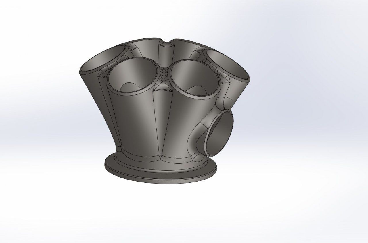

Got the completed drawing back from www.elmerracing.com for the CNC turbo merge collector. Looks pretty awesome to me so I think it is going to have to get ordered even though it's just going to storage. Lol.

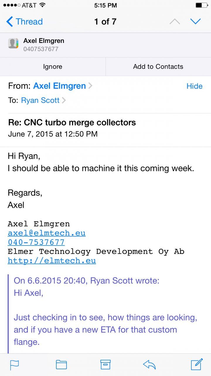

So the CNC merge collector is a go. I worked with Elmer Racing to get it just the way I think I want it. Axel was very accommodating. The price seems quite reasonable given the size junk of stainless it is going to have to be!
He said about 2 weeks to get it on a machine and then who knows how long it will take to ship from Finland lol.

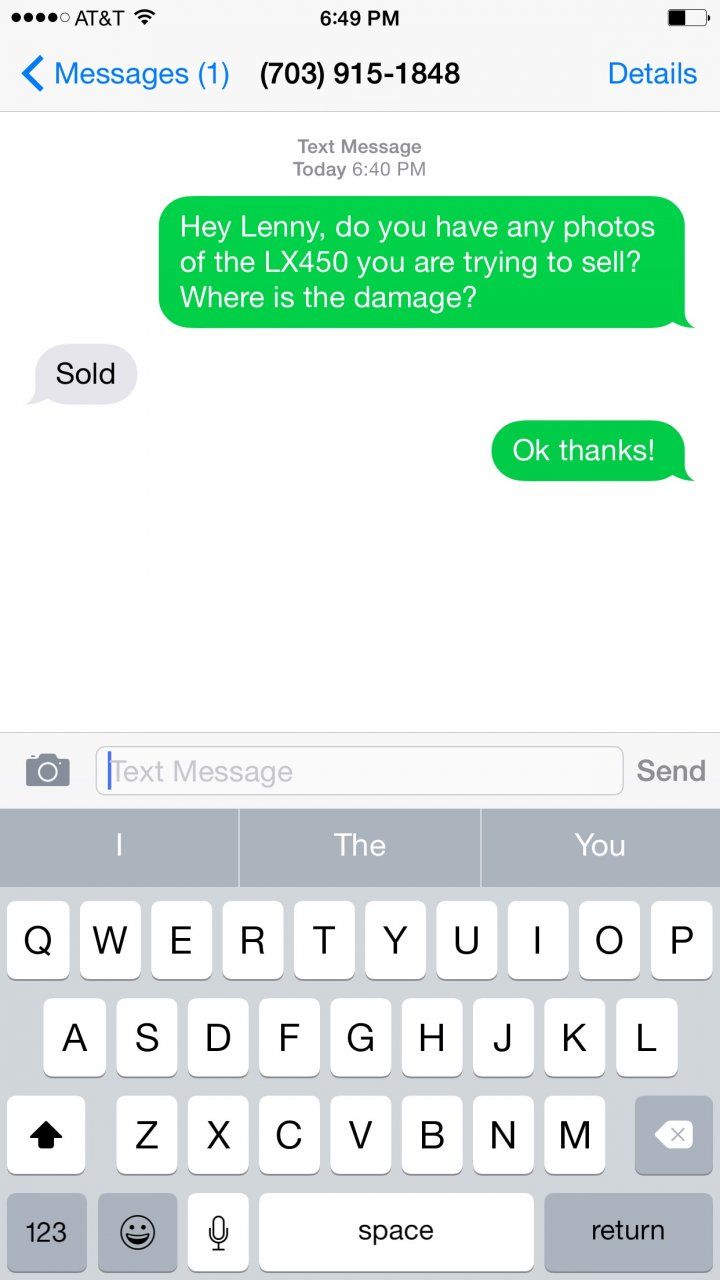

Sorry I noticed I didn't change my location. Yes I am still in Richmond and will likely be for the next 4-4.5 years. I am not sure I want a mechanics special and I really don't want a totalled truck, but I went ahead and texted Lenny from that ad to see if he could send me some photos so we will see. Thanks for looking out.
