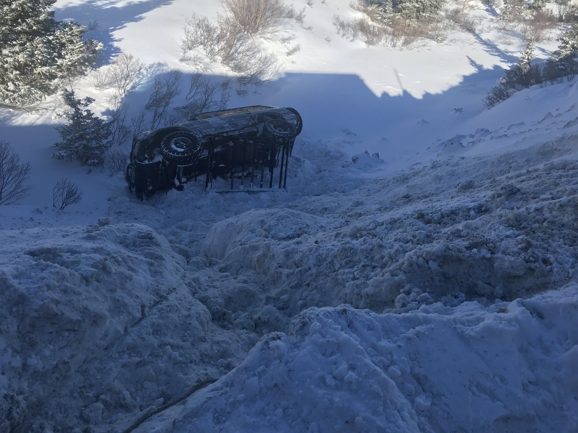

This wasn't planned either and I'd like to think the wife is a safe driver. She said coffee mugs and ski boots became flying projectiles... coffee mug hit passenger in the head. ski boots hit the window inside hard enough that it scraped up the window tint on the inside. Thankfully the winter kit, tool kit, etc... were secured inside my drawer system. It's not hard to secure the drawers and is a lesson better learned the easy way. Rant off.

It is such a nice sleeping platform to not bolt down. Plenty of locations. I used every bolt location available to secure the base. I have flip a vehicle before and remember my radio coming out of the dash and floating as I rolled like it was in space.

DaFuq! Made a believer of me!!!

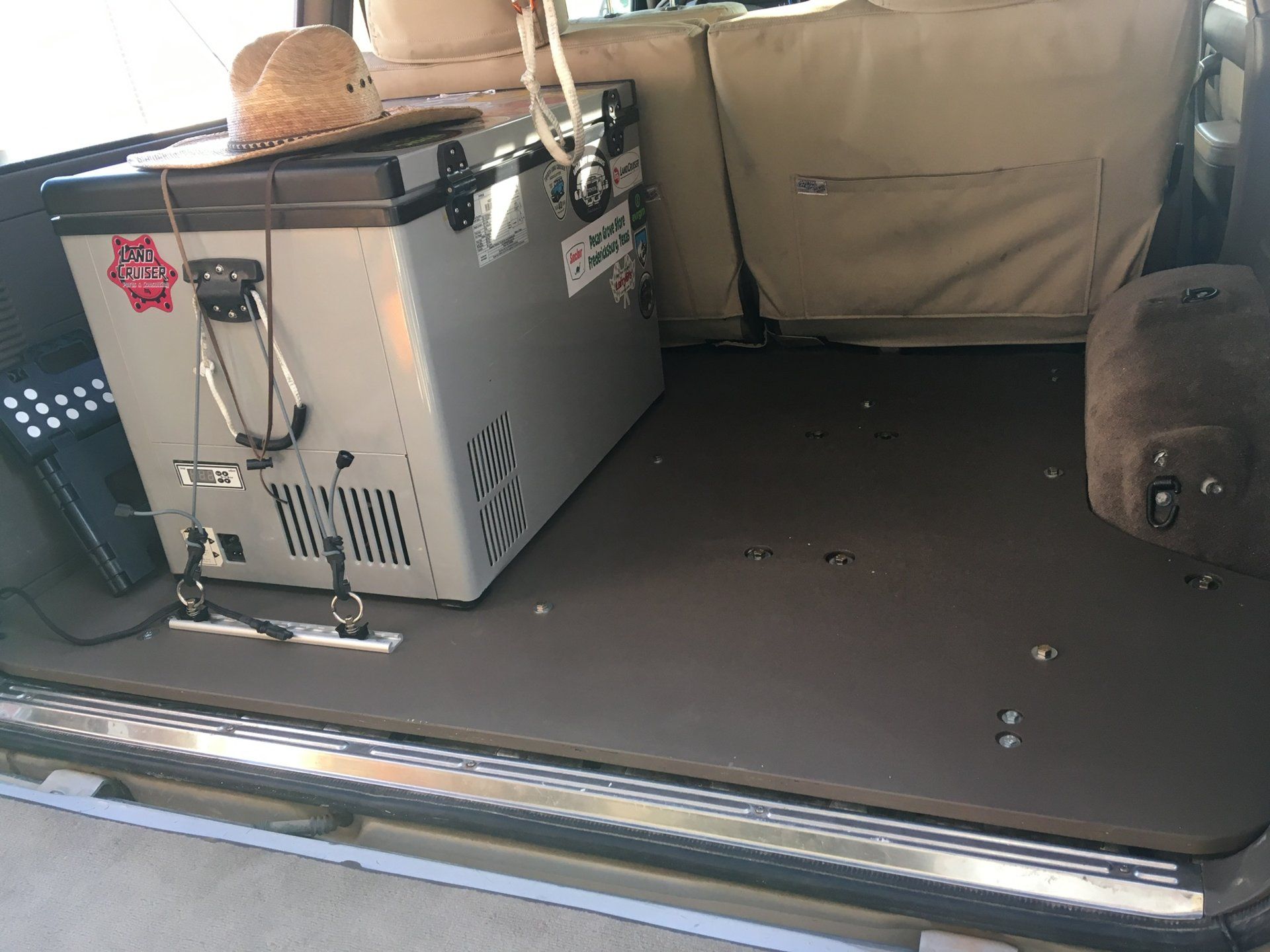

No. It's not tied down or secured in any way. It's weight holds it in place
Very simple. When you unbolt the seat mounts from the floor just run a bot from inside the platform right down into the existing bolt hole. Just use a big fender washer. Should take just a few min to put 4 bolts in.
We are lucky how easy it is. With the seats and hardware removed the floors on these trucks ar perfectly flat and covered in massive bolt holes all over the place.
My '91 has tie down points that pop through the carpet just behind the front seats and the back. Aren't these also on the FZJ80?
The tricks I used to find where to drill was to drill from under the truck to mark the holes. And the spots you can’t see from underneath is to put the bolts in the holes and then whack the platform with a mallet and it should indent the bottom of the wood to show where to drill.

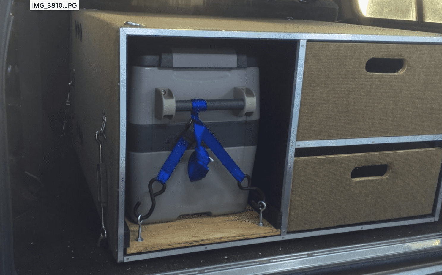

Here is a sleeping platform/ storage system for the back of an 80 Series Land Cruiser. I had a basic design drawn up, which was inspired by previous MUD builds, and a local cabinet guy ("Thomas") brought it to life. Because I did not do the fabricating I do not have much detailed knowledge of the build process or components. However, I thought it might be helpful or inspiring to others just to see it. The platform is not mounted to the vehicle. Total dimensions are 72"L x 56"W x 9.25"H. Drawers are 34" deep by 16" wide.
