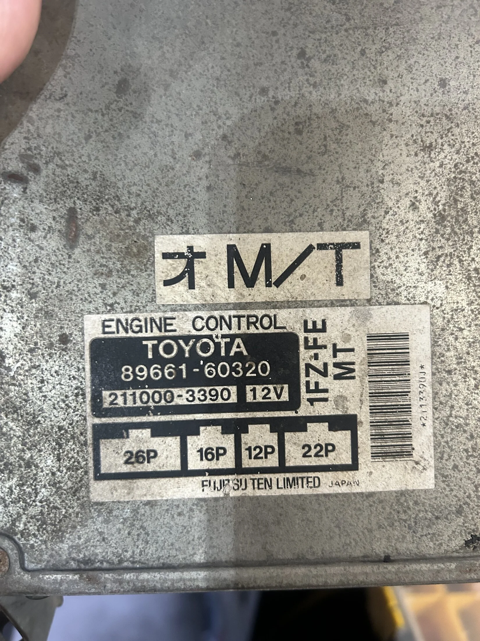

What is the part number of the MT ECU?
Sorry for delay part 89661-60320

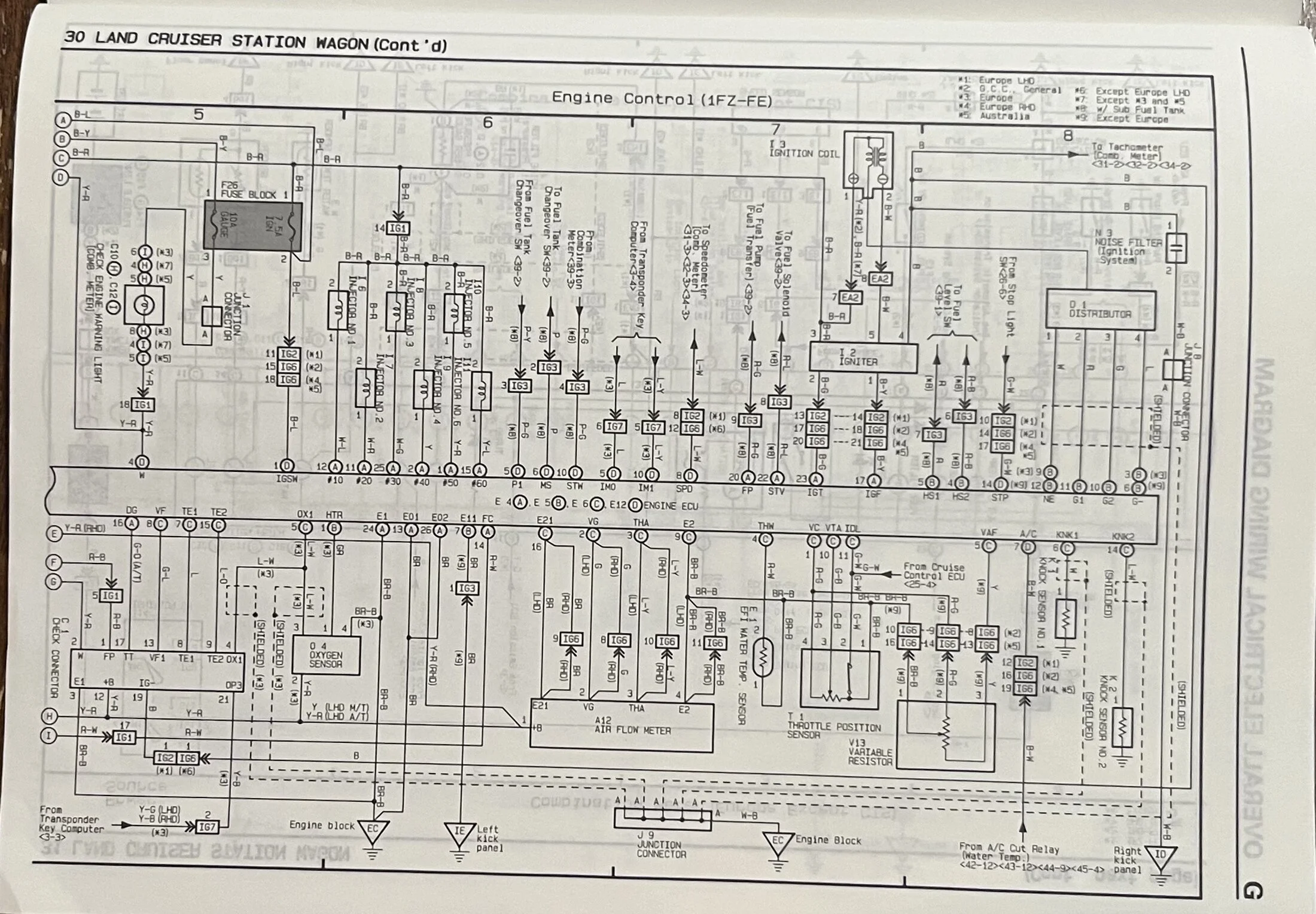

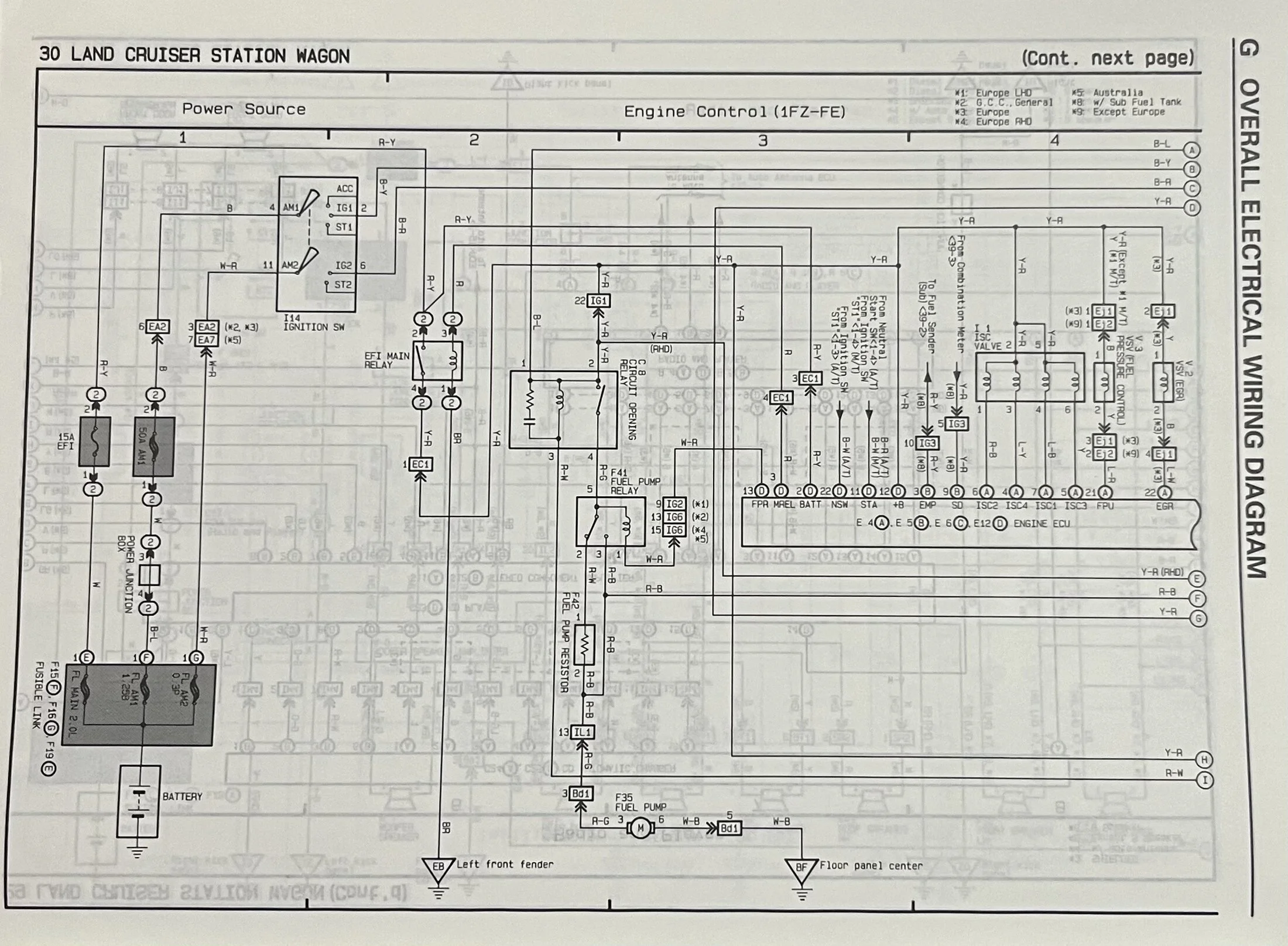

So Dan martin with Back 40 imports has been very helpful here. Turns out the pin out from the M/T ECU for the tach is in a different location than the Auto ECM. I plan to tackle this tomorrow and we’ll post what I find.
Anyone have a 1997 HDJ80 EWD link or book that can send me the high level wiring pin out for the ECM? Ive got an AUS 12V ECU and need to repin some things to get tach/cc functions back after my H152 manual swap. I’ve got the US FZJ80 EWD but need the AUS EWD. Need to verify pin change out to ensure I don’t burn something up.
This group has a lot of Australians in it and may have the EWD you're looking for.
Up at the top, click on the "Files" tab
Does this help:

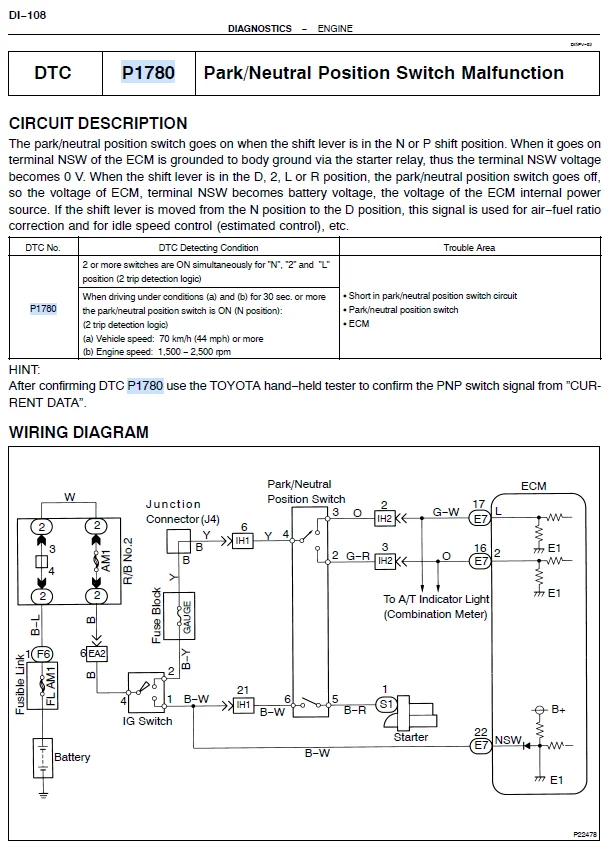

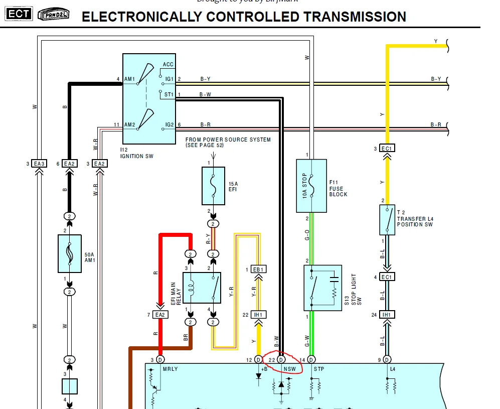

On the electrical diagram for the ELECTRONICALLY CONTROLLED TRANSMISSION, the neutral signal from the PNP switch seems as if it's not used by the ECU, but in fact it is - it is the NSW wire on pin 22 of E7 connector and is a +12v signal directly from the ignition key and has nothing to do with the PNP switch on the side of the transmission.
One very helpful table about the behavior of the AT, is the table that shows electrical signal combinations that tell the ECU what gear it is asked to activate. What I found was that the ECU judges that the car is in NEUTRAL when no +12v signal is sent to either of the three gears (R, 2 and L) and the NSW pin 22 on the E7 connector. Simply removing pin 22 from the connector to prevent the +12v signal from reaching the ECU, isn't enough to make the ECU think that the AT is in neutral.
From another Toyota document (in the description for the DTC 1780 for ENGINE diagnostics, not ECT diag), we found that that same signal on PIN 22 of the E7 connector, is in-fact dual signal pin. When the car is driven, it receives +12v, but when the car is in NEUTRAL, +12v is cutoff and it is grounded thru the starter circuit (Pin 11 of E7 is also grounded thru this wire). So either you have to depin the original wire and attach a different wire with a pin and splice the other end of the wire into the ground wire of the ECU, or you have to bridge pin 5 and 6 to be in NEUTRAL. If you want you can remove the speed sensor signal number 1 (back of transfer case) from the ECU connector (pin 8 of E7) and viola - no more CHECK LAMP!
