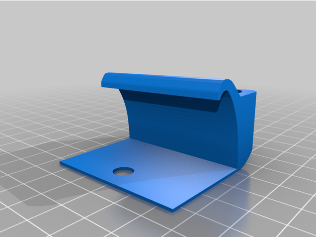

I let mine dangle freely, as the wire was strong enough and the plastic was light enough to do so. In this state, go ahead and slide on the 3D printed visor holders. They are designed to either go on the left or right hand side. You do not need to force it in to fit. If it is hard, try putting it on the other side.
When sliding on the visor holders, this is the plastic spacer that may have shifted or fallen. This is how you want to align it before screwing everything back in, and you're done!

Do not fold over and snap on to align. They are tapered so they slide on smooth, From back to middle.

looks good. Got a link?
Here's his Thingiverse link.
