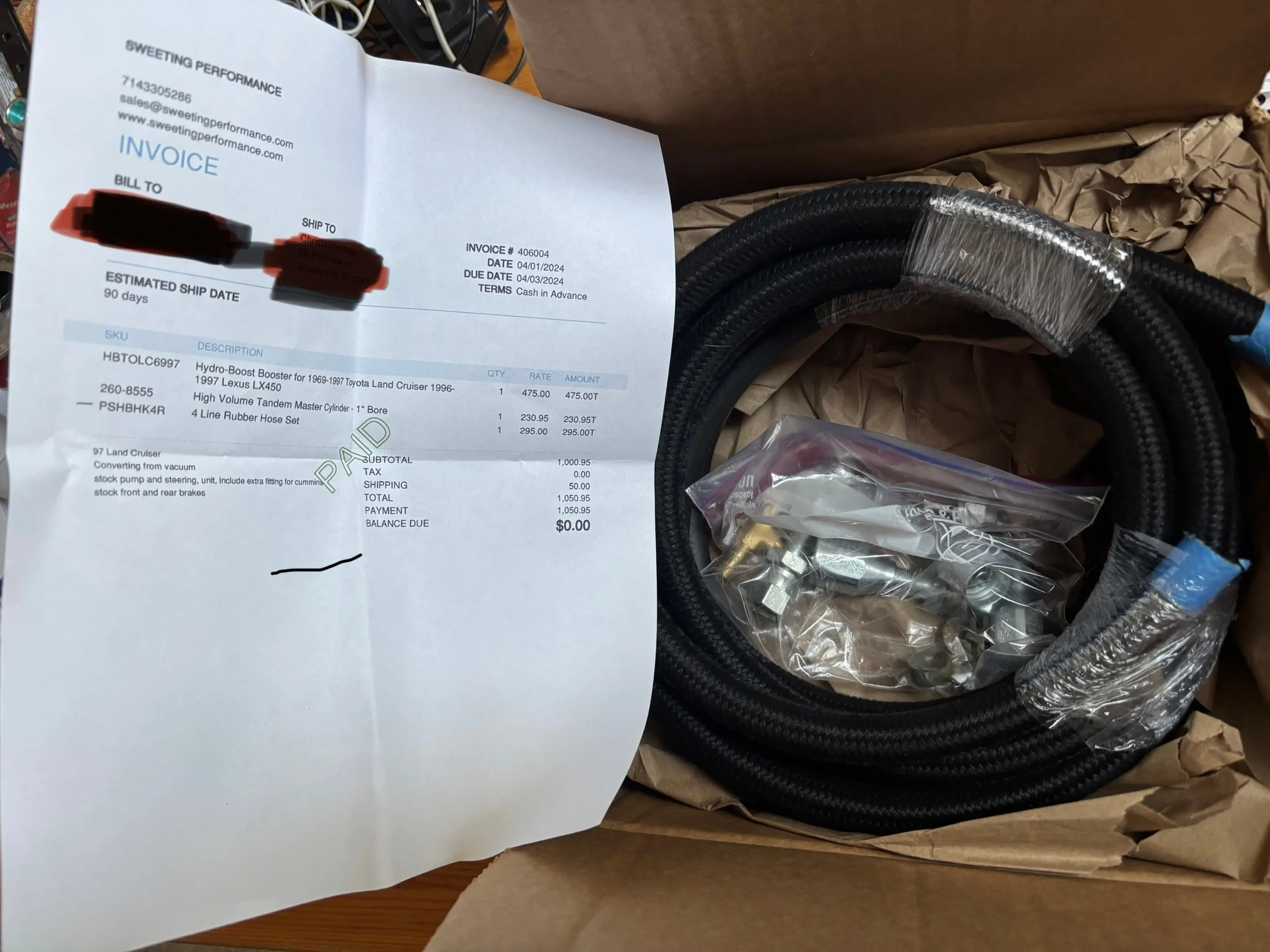

Just throwing in some of my recent experience. I also ordered a set-up from powerbrakeservice.net AKA sweeting performance. I ordered the beginning of April and he said 90 days. I thought that was quote a while to get it but decided I could wait. After it was about a month and half late I contacted him and asked why. . He said he took a week off for vacation and then two weeks to move. That only accounted for 1/2 the delay. He then said the 27th of August. That came and went, so I contacted him again via email (because of course his voicemail was full). He then said a couple of weeks. That has now come and gone as well. Contacted him today and left a somewhat stern voicemail. He called back pretty quickly this time. He claims he’s working very hard (80 hours per week) among some personal issues. Told him I’m sympathetic to his issues but he still needs to be truthful to his customers and/or not take any more orders if he can’t fulfill. I told him my items ship tomorrow or o want a full refund. He keep saying “they will ship soon” no matter how many times I told him no, and the only two options were shipping tomorrow or a full refund. He also claimed he has been truthful with me all along, yet promised shop dates have come and gone. And just in case anyone has any questions, all the communications except for today have been via email so I have proof. Well except for the initial conversation on the phone before he got over $1000 of my money, he was pretty helpful then of course.
So my advice….steer away from this company. It seems like I will likely be talking to my bank on Monday.
Just throwing in some of my recent experience. I also ordered a set-up from powerbrakeservice.net AKS sweeting performance. I ordered the beginning of April and he said 90 days. I thought that was quote a while to get it but decided I could wait. After it was about a month and half late I contacted him and asked why. . He said he took a week off for vacation and then two weeks to move. That only accounted for 1/2 the delay. He then said the 27th of August. That came and went, so I contacted him again via email (because of course his voicemail was full). He then said a couple of weeks. That has now come and gone as well. Contacted him today and left a somewhat stern voicemail. He called back pretty quickly this time. He claims he’s working very hard (80 hours per week) among some personal issues. Told him I’m sympathetic to his issues but he still needs to be truthful to his customers and/or not take any more orders if he can’t fulfill. I told him my items ship tomorrow or o want a full refund. He keep saying “they will ship soon” no matter how many times I told him no, and the only two options were shipping tomorrow or a full refund. He also claimed he has been truthful with me all along, yet promised shop dates have come and gone. And just in case anyone has any questions, all the communications except for today have been via email so I have proof. Well except for the initial conversation on the phone before he got over $1000 of my money, he was pretty helpful then of course.
Awesome, I'm in the same situation as you.
Ordered mine on may 10th, he is also not responding to my calls or emails.
If I don't get a legit tracking # this week I'm calling my C.Card company also.

Called my bank last week and had the charges reversed. I highly highly doubt you’re getting a tracking number. Just talk to your bank on Monday and dispute the charges before it’s outside the window of being able to do it. Got my money back in three days.
I had a similar experience with him. I think he tries to string you along past the timeframe where you can make a charge back. I use an Amex for these types of purchases and they had no problem instantly refunding my money. This was a few months back, and coincidently the day after Amex refunded me I got an e-mail from him saying that I'll be getting a tracking number soon. It never came of course.
I was right at my limit with Chase bank. They got my money back a couple days after I filed the dispute. I actually got him on the phone and told him I’d give him one more day to ship or refund my money or else I’d be doing a charge back. He just kept repeating over and over that it will ship when it’s ready like a broken record. I’m like, “man, don’t you hear what I’m saying….Im only giving two options?” After 10 min of back and forth he hung up on me. Never heard about shipping or a refund so I went to my bank and took care of it. Sounds like he’s becoming what wits end was.
So just an update. This douche bag sent me a couple chunks of hose and some connectors (nothing else) a year and almost five months after placing a $1000 order from him that was supposed to ship in 90 days. I emailed him several times to asked what the point of this was but zero response. Stay far away from this company and this chuckle head. Wonder where else I can report him?
