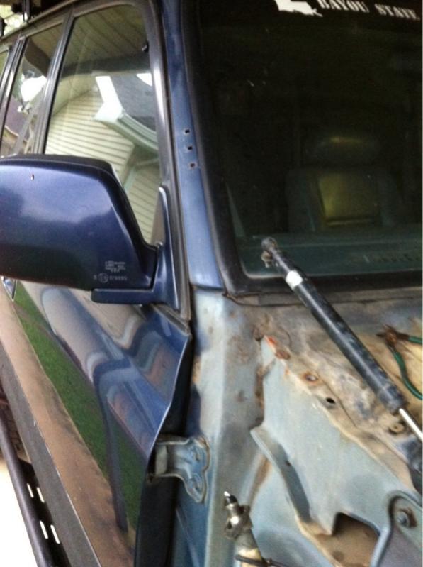

Nice Plan! When I installed my snorkel I used aluminum nutserts (or rivetnuts) and machined SS screws on the A pillar. Not sure if that's what you mean by captured nuts, but I can ship you my nutsert tool if you don't have access to one and I can get it back from you at SCC. That would be much cheaper than buying one of those boogers.
Thanks bud will talk to you this afternoon I did mean rivetnuts, I think Paul has one but if he doesn't I'll take you up on it :)
