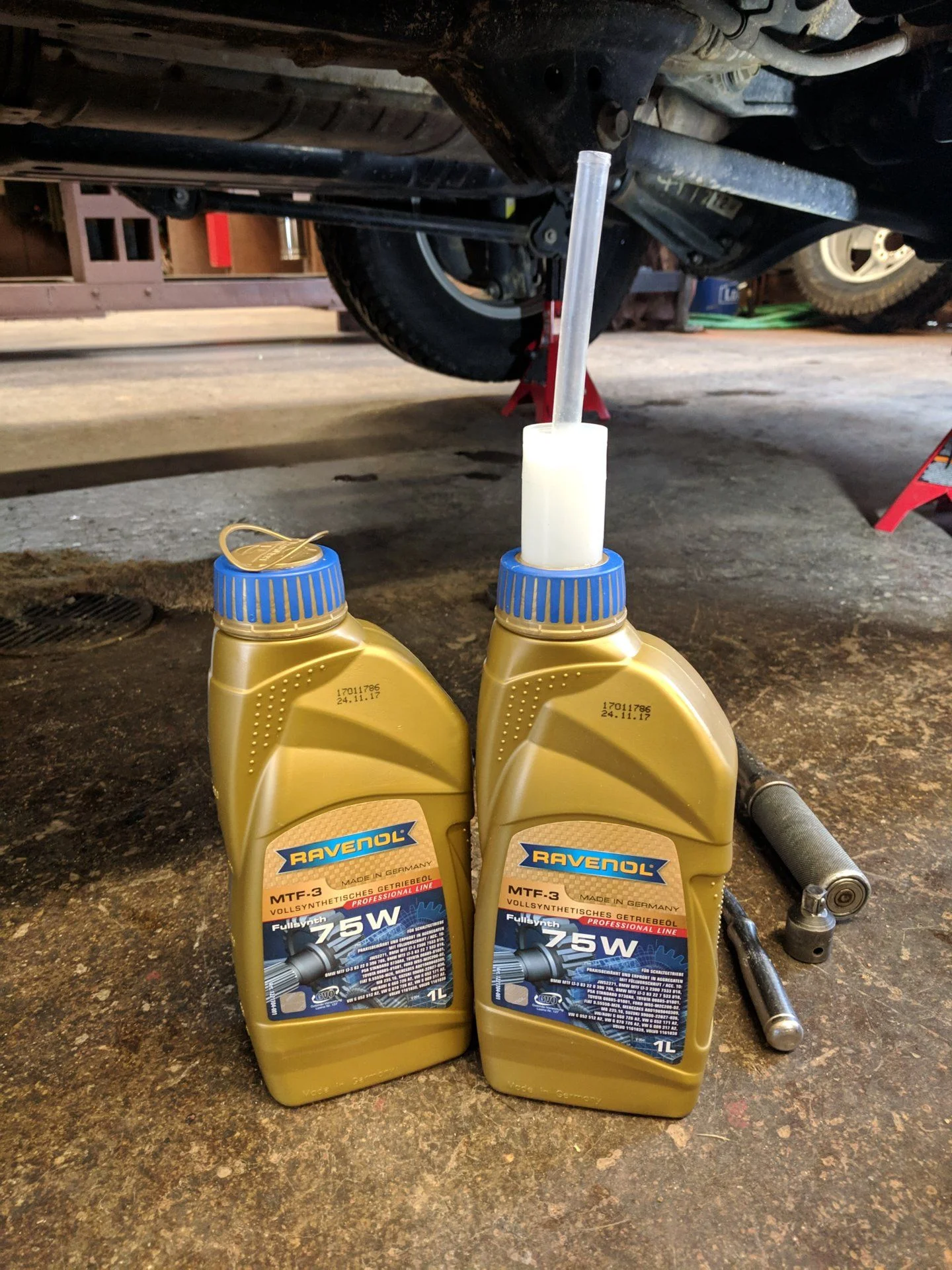

I bought the Ravenol 75W that has been posted here a few times. Very clever bottle, you yank up on these little "handles" on the cap, which extends the neck of the bottle. Then the little cap unscrews, and there's a nifty hose under this cap. It's pretty easy to wiggle the bottle up above the fill hole and get enough out of them to get ~1.5 qts in.
Odd, but it looks like they only sell this in cases now? You can't buy individual liter bottles anymore?

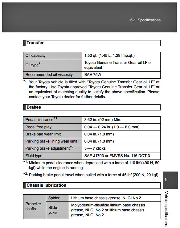

So is the drain and fill of the transfer case 1.5 quarts oh 75W ?
Don't you folks ever look in the Owner's Manual? :bang:
HTH
HTH
Lol. Or, it’s like every single other vehicle in the world where after you drain, you simply fill until it starts to weep from the full port. I highly doubt anyone is measuring exactly 1.53 quarts
I agree, but knowing how to do it doesn't answer the question of how much is needed to do it. "Drain and re-fill" answers how, but "1.53 Quarts" answers how much - which was the question I was addressing. Knowing how to do it doesn't tell us how many quarts one has to buy to get the job done.
