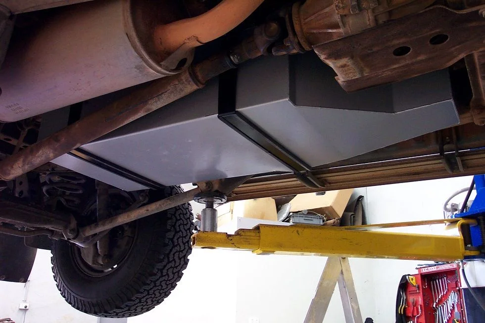

For what it is worth, I have spent the last 5 years representing Long Range Automotive fuel tanks as co-owner of Long Range America (LRAM). We have sold a number of auxiliary (42 and 24 gallon capacities) and replacement (37 gallon capacity) tanks for the 3FE and 1FZ-FE powered 80s/LX 470s (also non-US spec diesels - both manual and auto trans models).
As my 71st birthday approaches, I am headed toward (semi) retirement, handing off all meaningful work/responsibilities to Aidan Stott and Khris Korell - my two partners at the firm. Coincidentally, I finally bought an 80 (well, an LX 450) and the first thing I did (after delousing the truck after 4 years of storage) was to purchase a replacement fuel tank from LRAM inventory.
I have heard a number of sad tales from 80 owners, reporting leaky OEM tanks and scarce replacements from Mr. Toyota. Many of our main tank sales have been to replace failed tanks (along with 47% increase in fuel capacity for the 1FZ-FE models). There are some NOS tanks out there - @ARJMN and @Delta VS (Dave Schenker) have both scored lately, but I am lazy and had one on the shelf.
The LX is getting a new short block and valve job, but next up after that is installation of the LRA tank, along with new fuel pump, sending unit and related hoses, valves, etc. and a Delta combo console - shifter and center models. Hopefully won't have to drop the tank again.
Not a sales pitch, but an FYI regarding an alternative to repairing the failed tank or looking for OEM NOS. If you are interested in what it looks like/how it installs, the install document is attached and you can see the tank here TLC80FR-PA-US - Long Range America - https://longrangeamerica.com/product/tlc80fr-pa-us/
