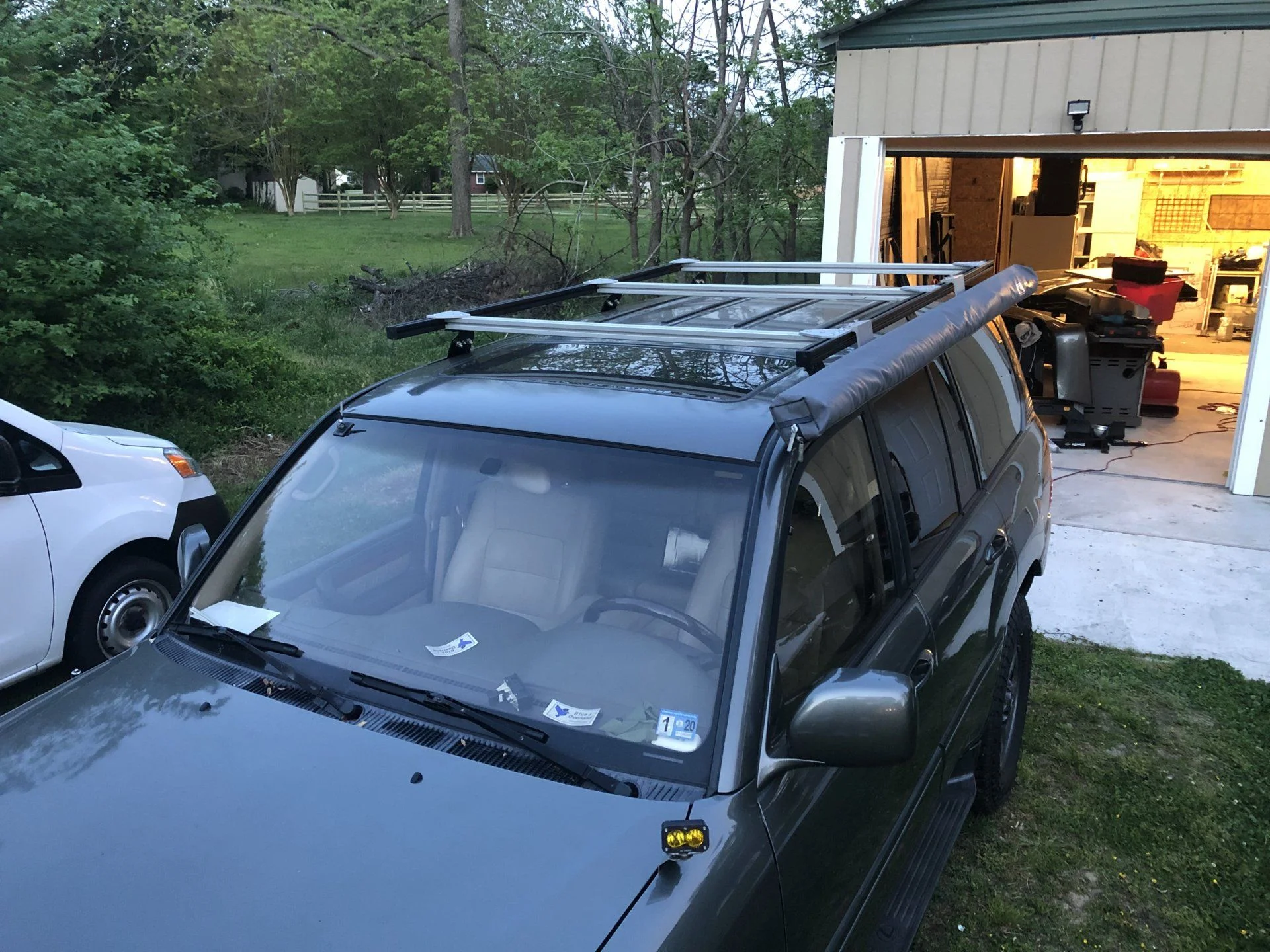

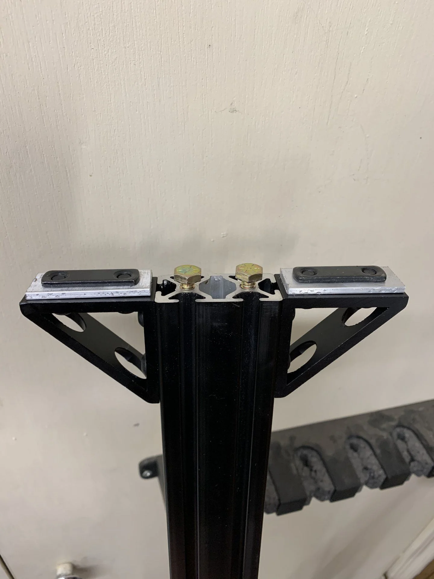

This was my solution to that problem. I didn’t feel great with the size of the nuts that came with the brackets. I made washers out of aluminum. I also tapped the end of the rails and put some bolts in to add more contact points for support.
Yep, this is the most solid solution I could think of too, just ran out of time to make that many little custom washers, I may end up pulling mine all off and doing this as well as the washers made installation a real PITA and will probably rust one day. Looks great, thanks for sharing.

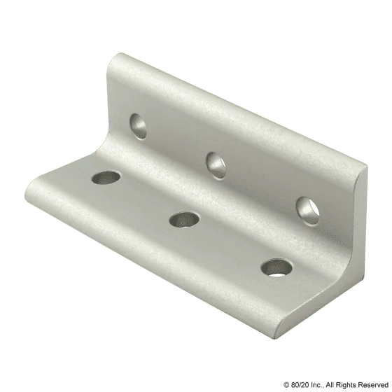

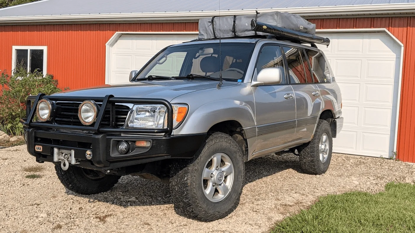

I made generic L brackets to hold my awning along side the RTT. Used generic drop in nuts from Amazon to secure the brackets to the 8020 cross bars. The tent and awning worked great together on the 8020 crossbars!

I used 4 of these, one at each corner. Fastened with two bolts (one on each end) to the 8020 bar and and one up to the tent. Seems to be working well. The clearance is tight to get the tent bolted on, but it can be done.

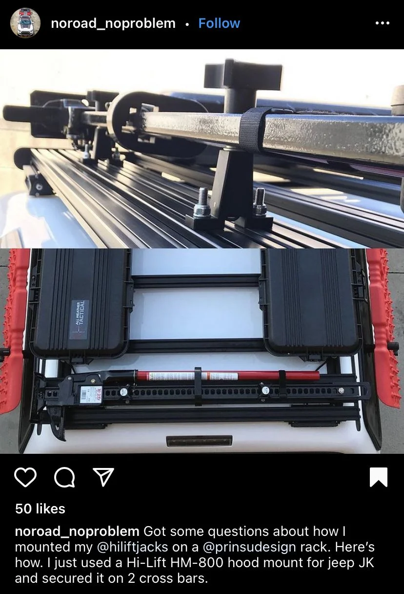

Can anyone recommend a rotopax mount that would be bolt on, if I replaced my factory crossbars with the 1515 sized extrusions? I was hoping for something with a good amount of adjustment, as I may want to mount it along with a roof top cargo box.

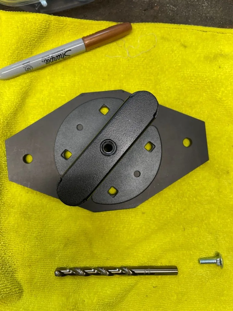

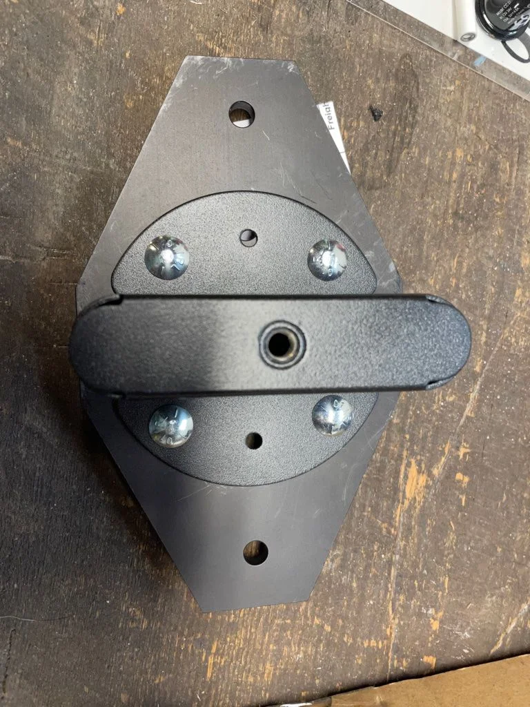

I just mounted up some 15-series 8020 bars I bought used here on the forums. Have two rotopax mounts that I "made" using a 7 hole plate from 80/20. Had to drill extra holes in the plate for the Rotopax bracket, and the original holes work great for mounting to the bars. Final setup is really solid, and I'm only using the two outermost holes for securing the flat plate to the 1515 bar.
The 15 series holes happen to line up really well with the Rotopax mount holes on a diagonal also if you're willing to mount it at a weird angle.

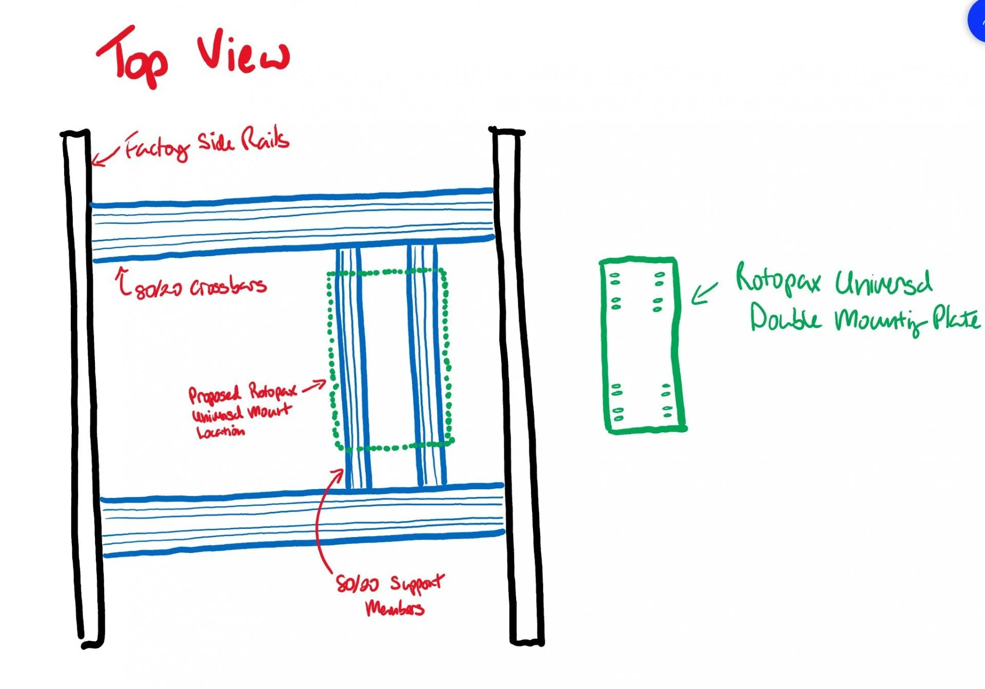

So this would cost a bit more money, but what do you think about this for mounting them in a more plug and play way?

I suspect a flat plate from a different series (instead of the 15-series plate I used) would have potentially proper hole spacing to just bolt up the Rotopax bracket without drilling new holes. From there, 2 or 3 holes in a single row on the plate, would bolt to a 15-series bar no matter their spacing.

Did you get the single or the double mounting plate? I’ll probably order mine tomorrow and then mount it how I showed in my sketch.
