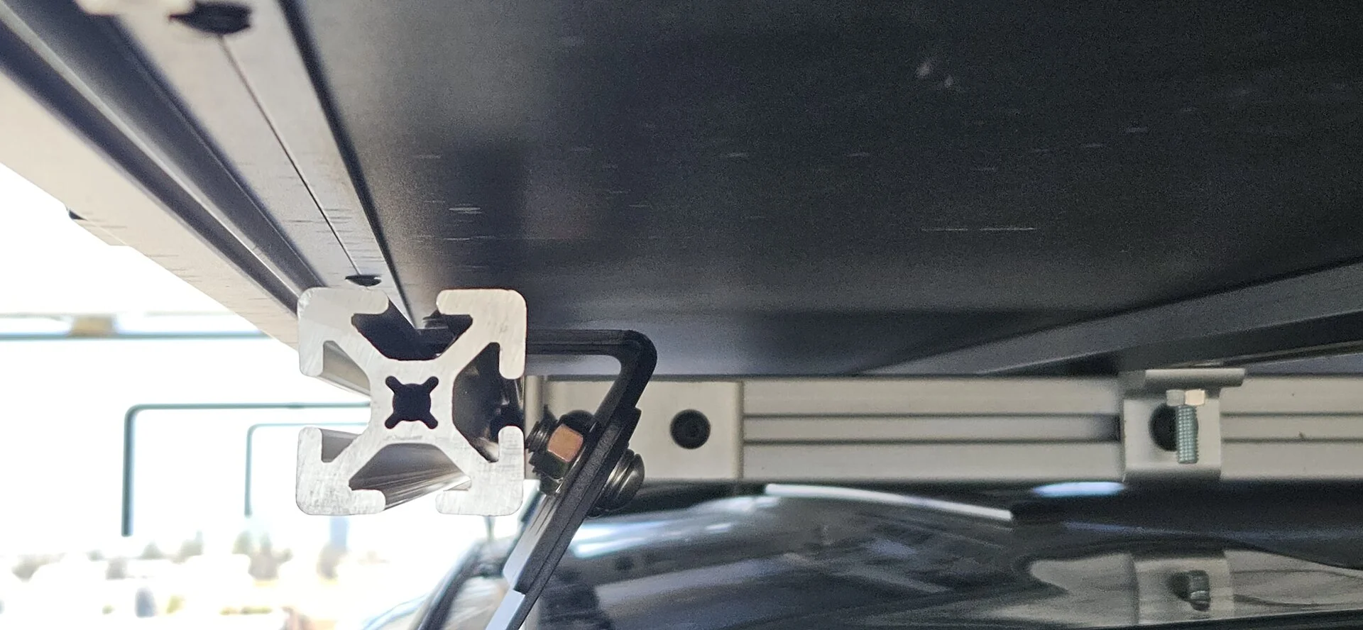

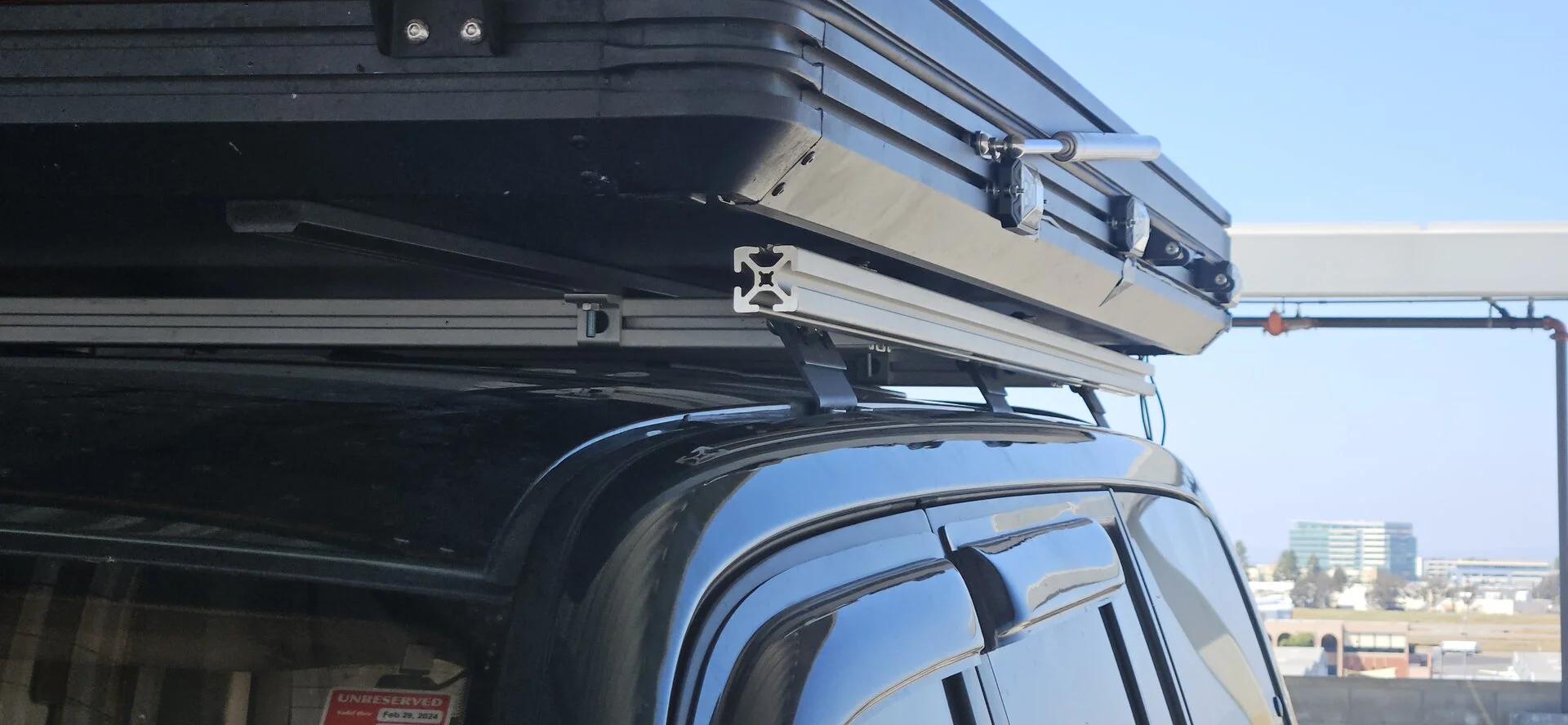

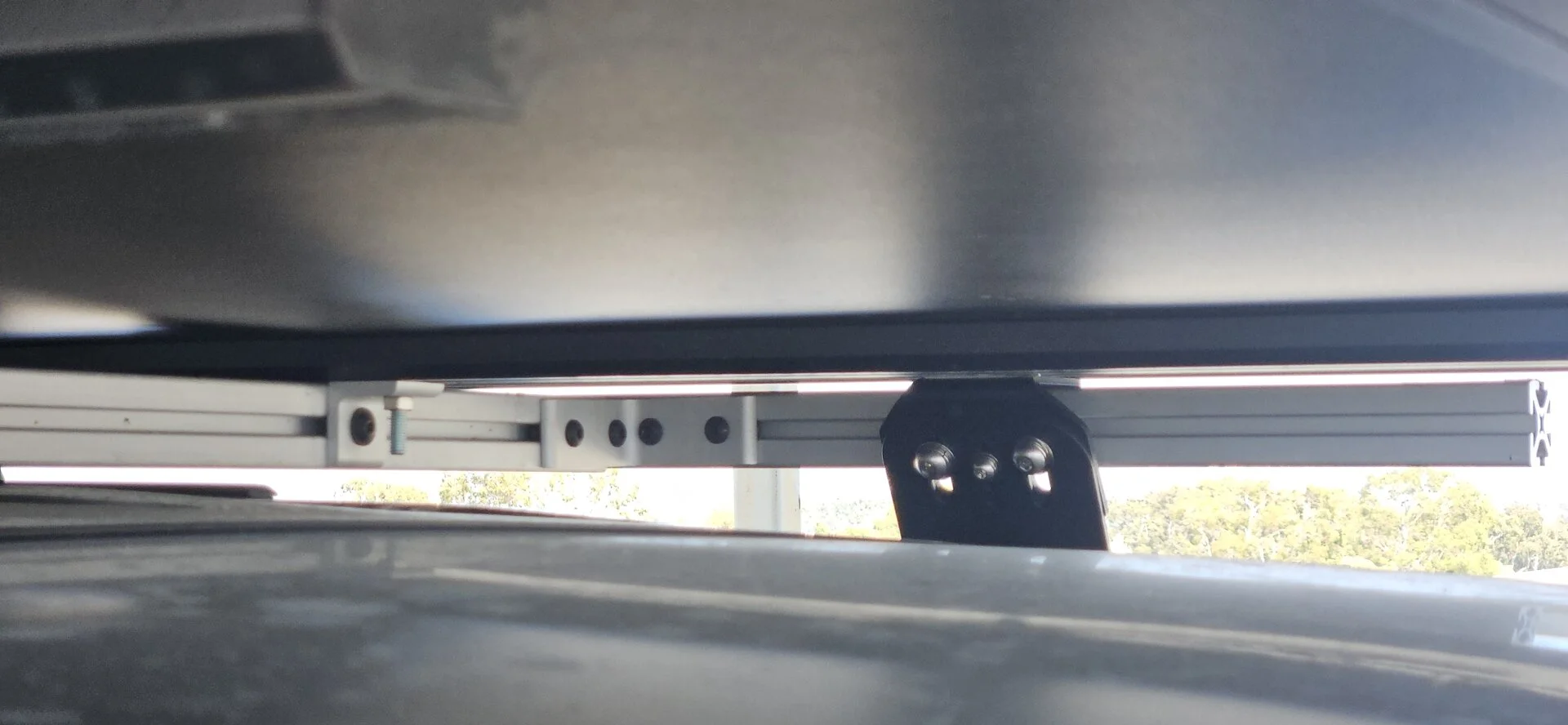

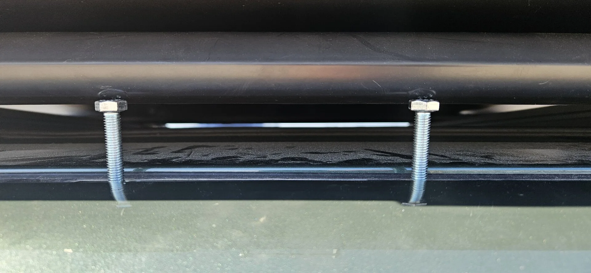

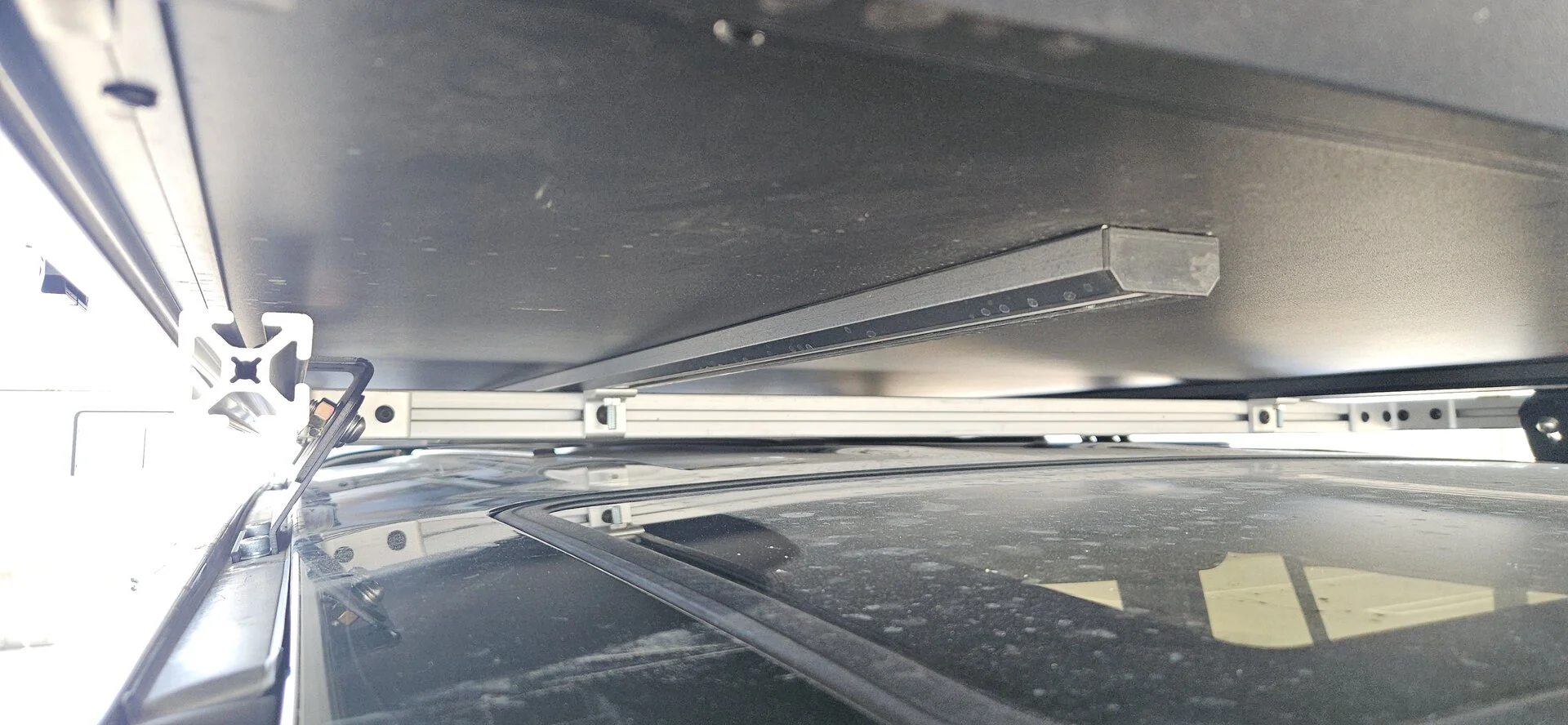

The only play that I got was from the OEM foot to OEM bar so I installed these Ultra scientific and very nice looking bolts (looks like crap) in the center foot which I don't have, to support the bar a little extra. I expected it to help a little bit but it actually stiffened up the rack a huge amount if I was going to do this 80/20 project again I would buy the gimviti feet and make all of the bars out of aluminum
1515 front to back with gamviti and 1530 cross rails, seems amazingly strong, oem bars were very weak
