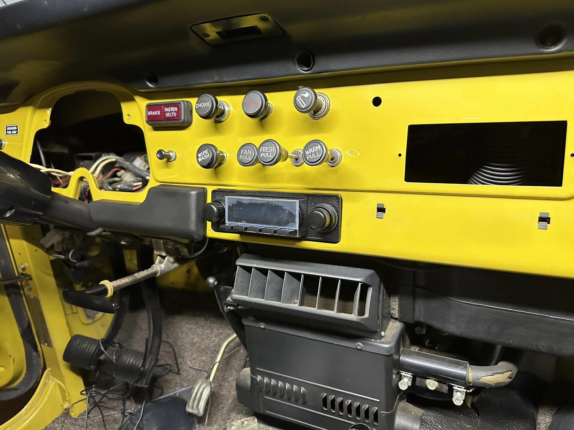

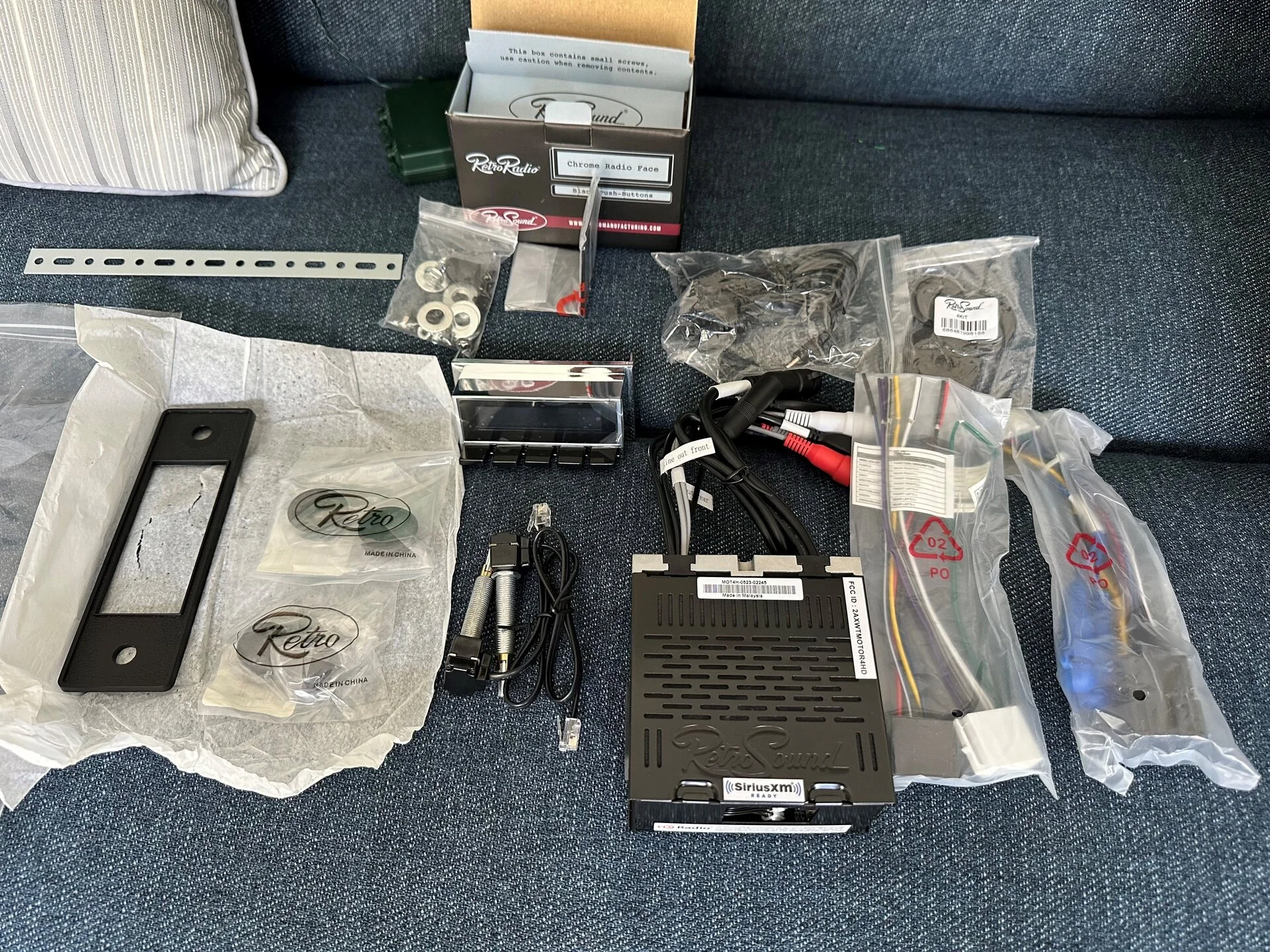

The radio has arrived. Some assembly required lol...
I have done Griffith park, El Segundo, and the OC Quarantine run and the other one I don’t know the name of it but it is on Magnolia.

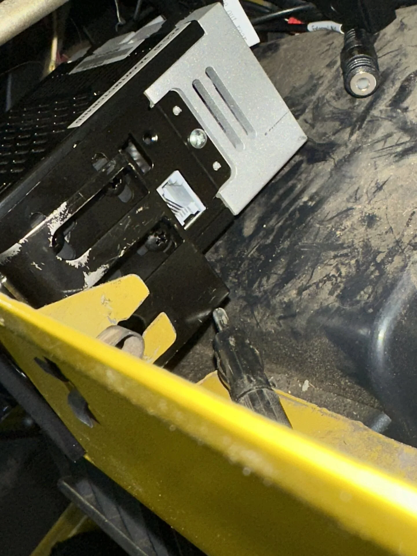

Holy crap this radio SUCKS to setup. It took me 2 hours to modify the brackets and set the faceplate and knob depth.
I’ve read up on how to mount this but there was only one guy who fabricated his own brackets. I figured I can take a swing at the side mounts that come with the radio.
What I did was bend them right at the same point it meets the faceplate so that it would slide into the dash. Then I flipped them from left to right (they are side specific according to restrosound). Once I did that the two points lined right up with the factory side mount holes!

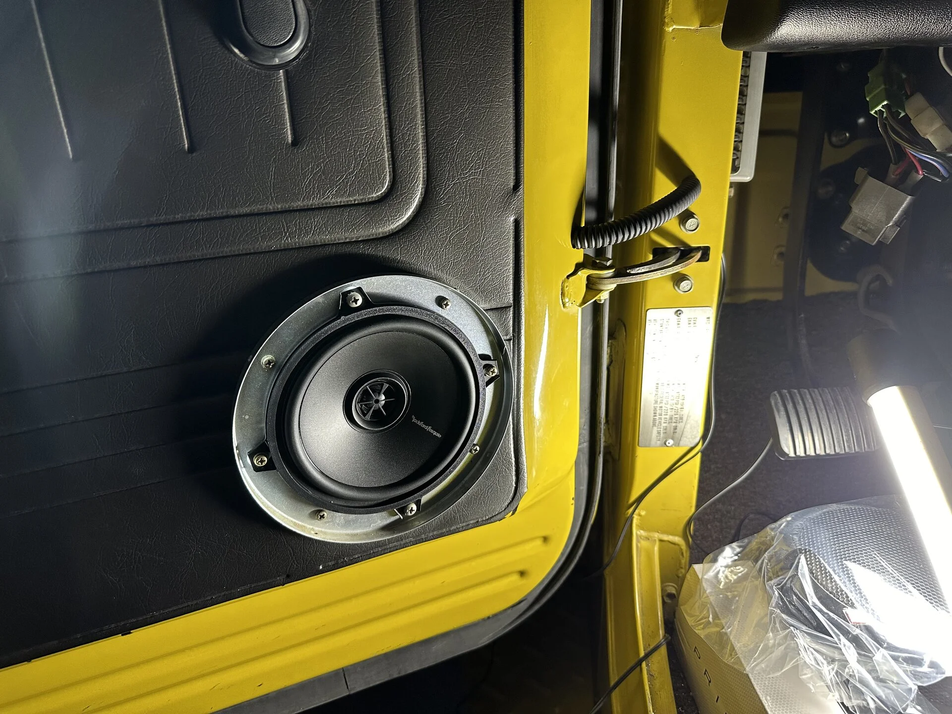

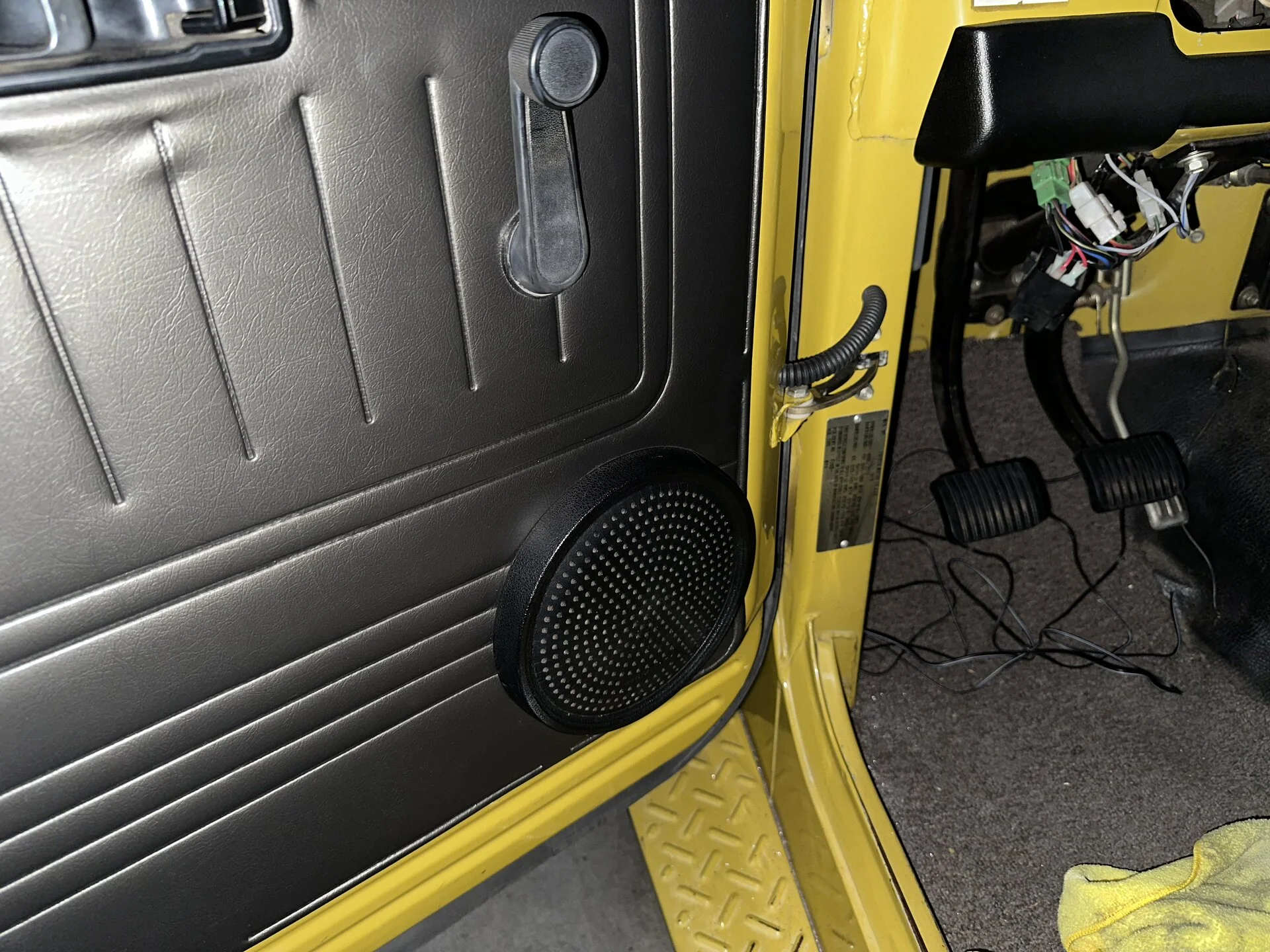

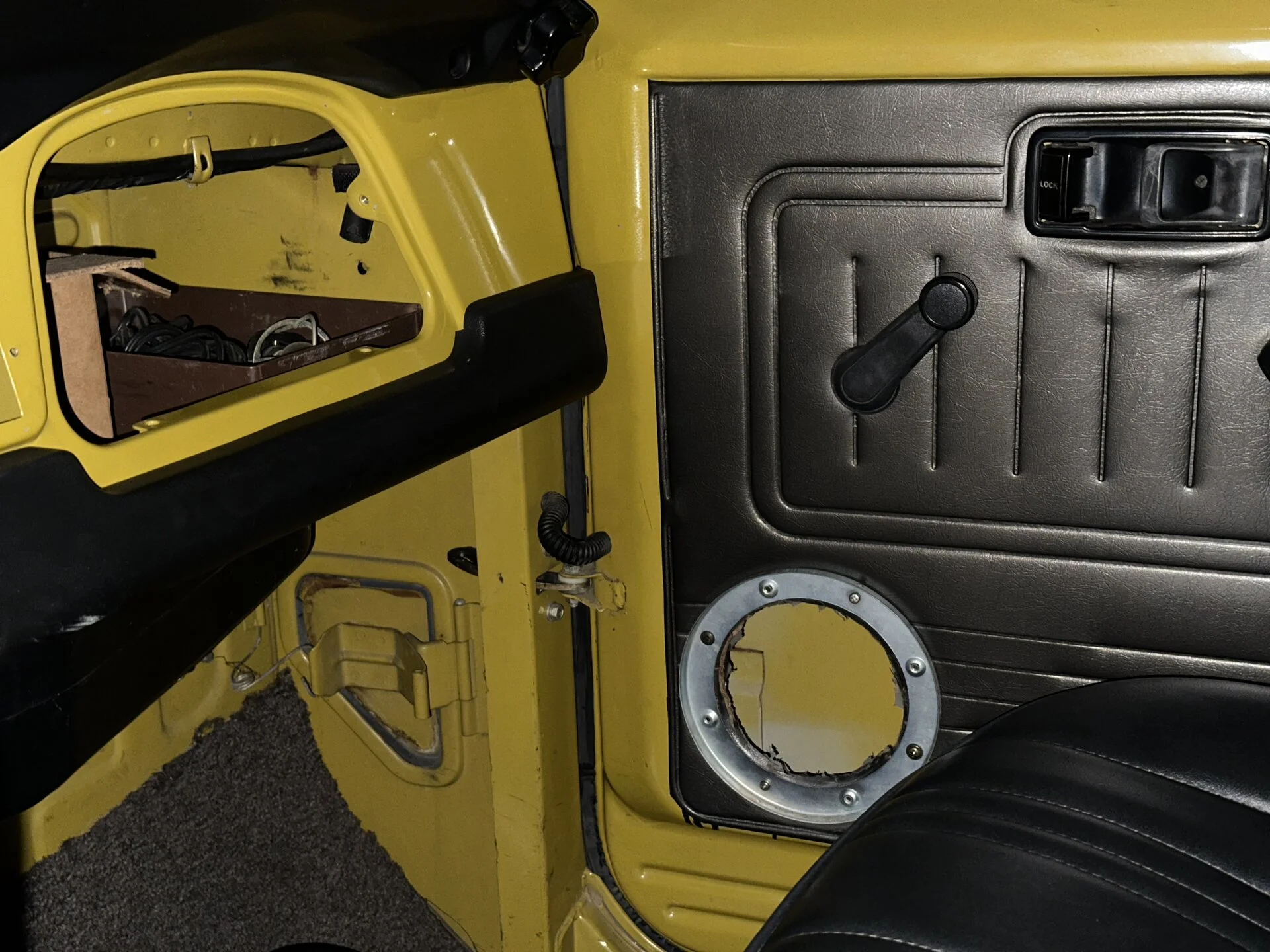

The door speaker wiring originally jumped from the a pillar to the door with no boot. A quick search on Amazon and I found these boots for $8 each. After that I wired and mounted the door speakers.

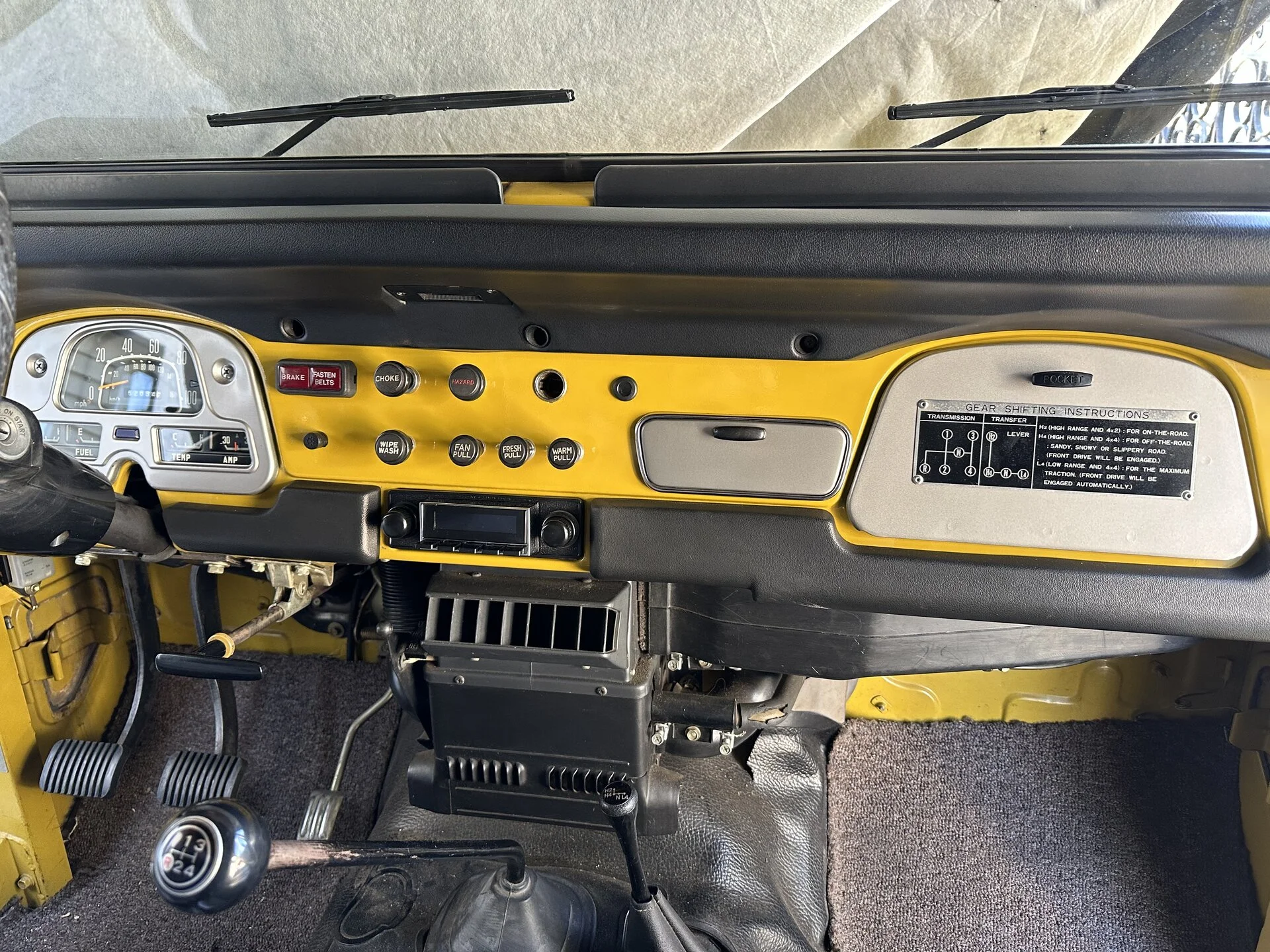

The original radio plug has the 12v acc & ground, so all I needed to source was a constant 12v. I ended up tapping the cigarette lighter and then it was time to test it out.

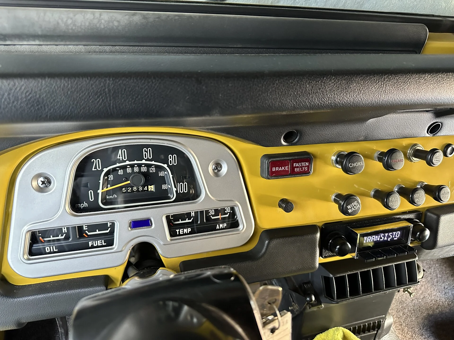

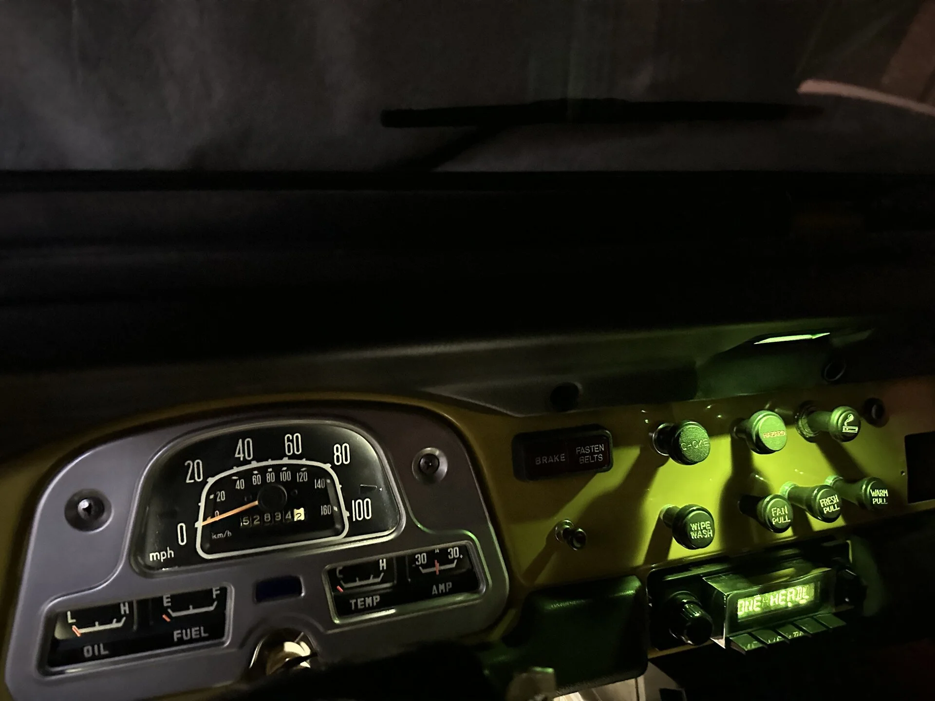

The led lights on the gauge cluster, dash pad & heater controls are so much brighter! The new radio sounds great and all I need to do is to put the dash back together.
I have never found music in an FJ40 to be something that was pleasurable. Especially with the single stock speaker. Seeing those holes in your doors makes me cringe.
They were there already, and I love a good sound system in all my vehicles. At some point I’ll add a small subwoofer and amp to finish it up.
I got it all buttoned up. I made the job way harder than it needed to be, but the polished dash and hardware look so good. There was an unknown switch under the brake warning light. So I removed it and put the microphone there for hands free calling.

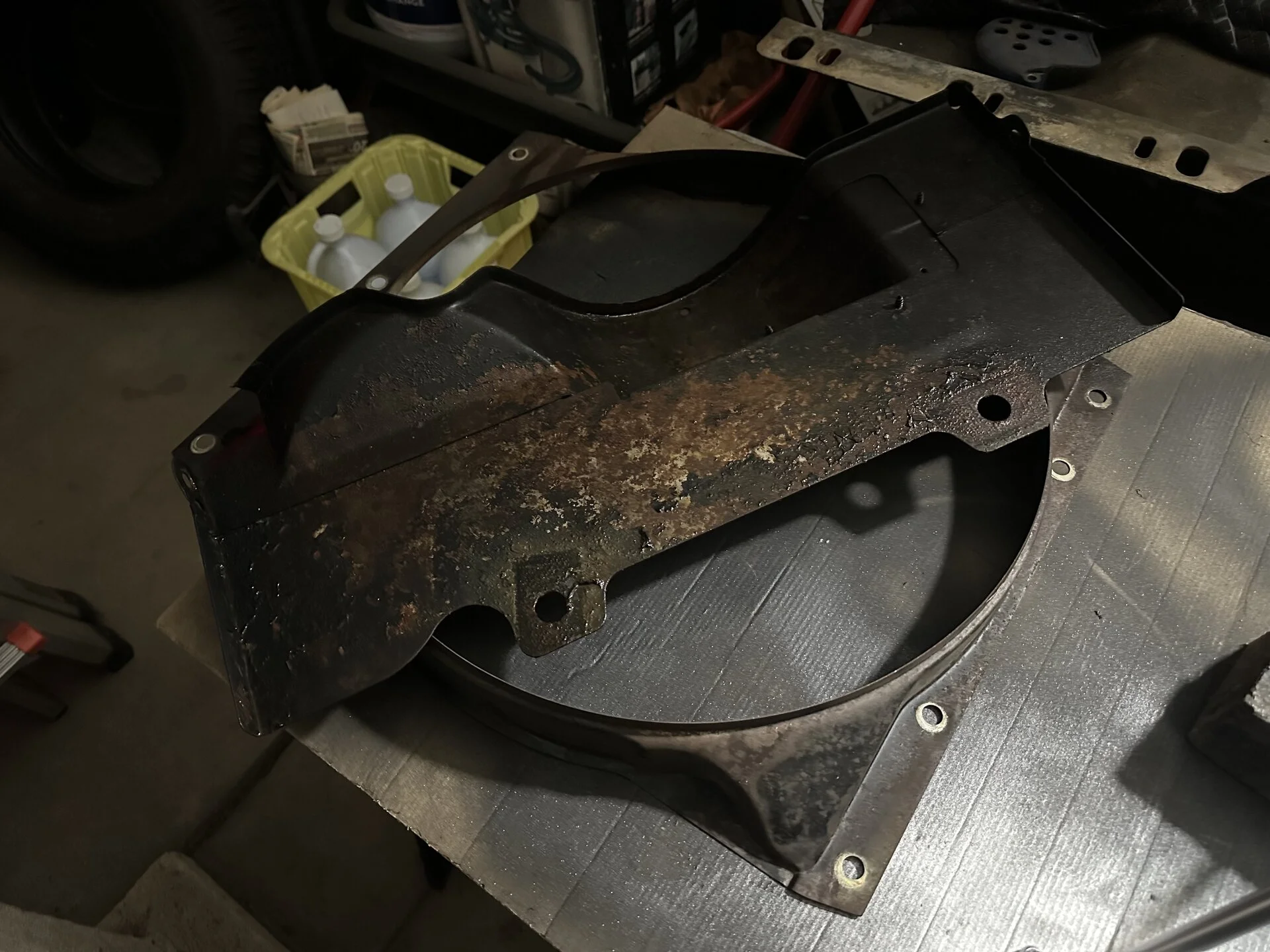

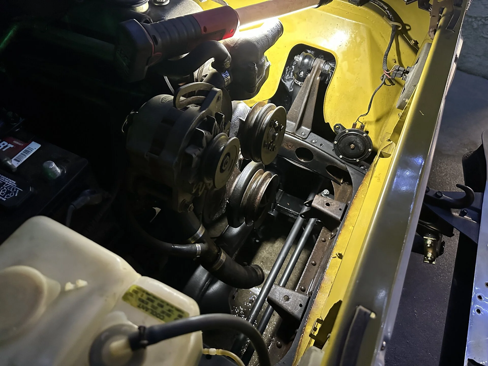

These last bits of rusty pieces were driving me crazy, so I took it all apart to refinish. While I’m in there I’ll be swapping in a mishimoto aluminum radiator, and replacing the worm gear clamps with oe style wire clamps throughout the engine bay. Then I can swap in the new front grill emblem and put it all back together.
Rusty pieces?
