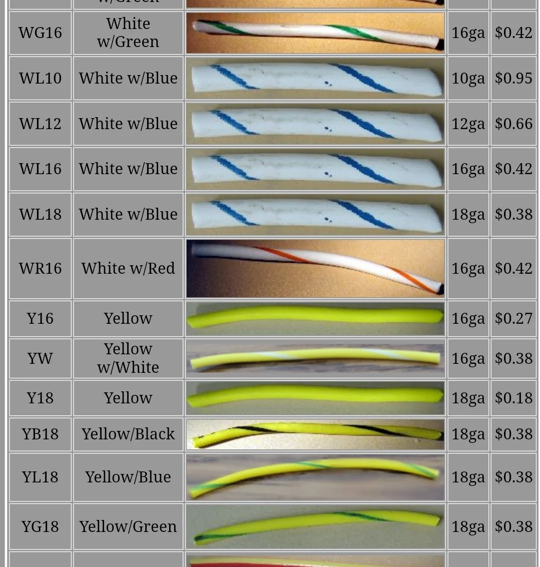

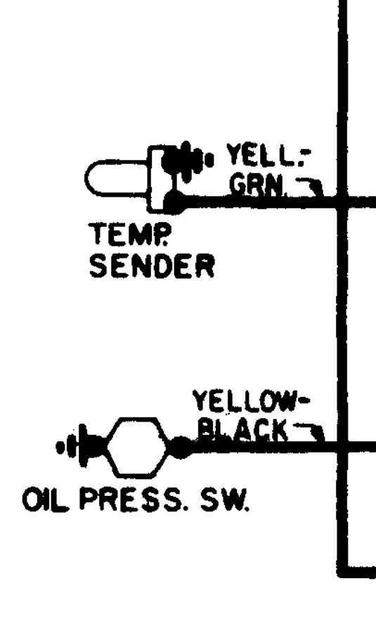

Sure looks like the WL wire to me.
I have seen toyota use yellow with green fir temp, and given the location next to the carb and that single wire with the black sheath, I put 90% odds on that.If I had to bet, it would be for the temp sensor on the head. The black sheath is a clue

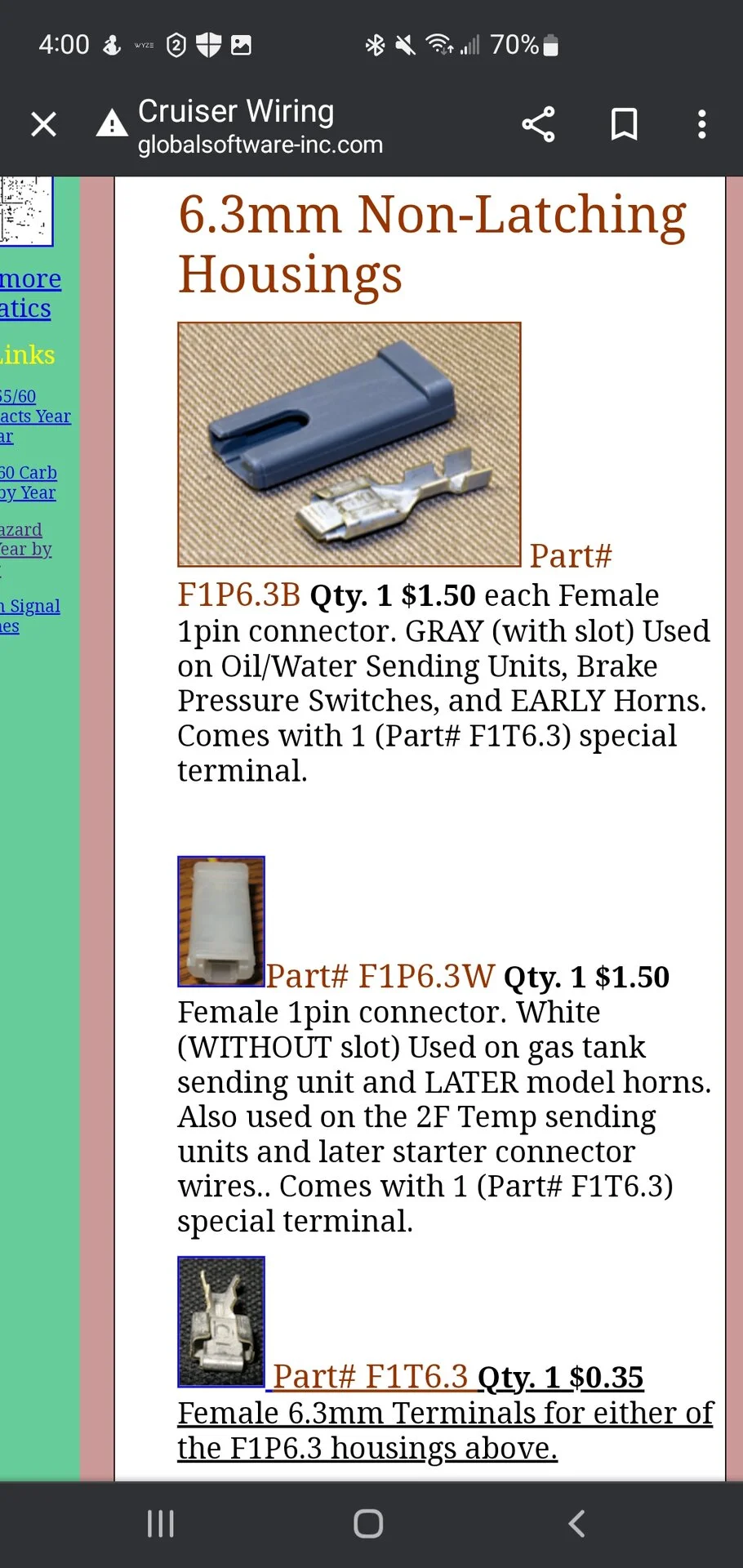

YAZAKI Water / Coolant Temperature Sensor Sending Unit Union Harness Repair Kit & Rubber Boot - VintageTEqParts.com
- YAZAKI Water / Coolant Temperature Sensor Sending Unit Union Harness Repair Kit & - Rubber Boot Comes with Correct...vintageteqparts.com
Looks installed backwardsThanks @Cruiser Corps ! Fits perfect!
