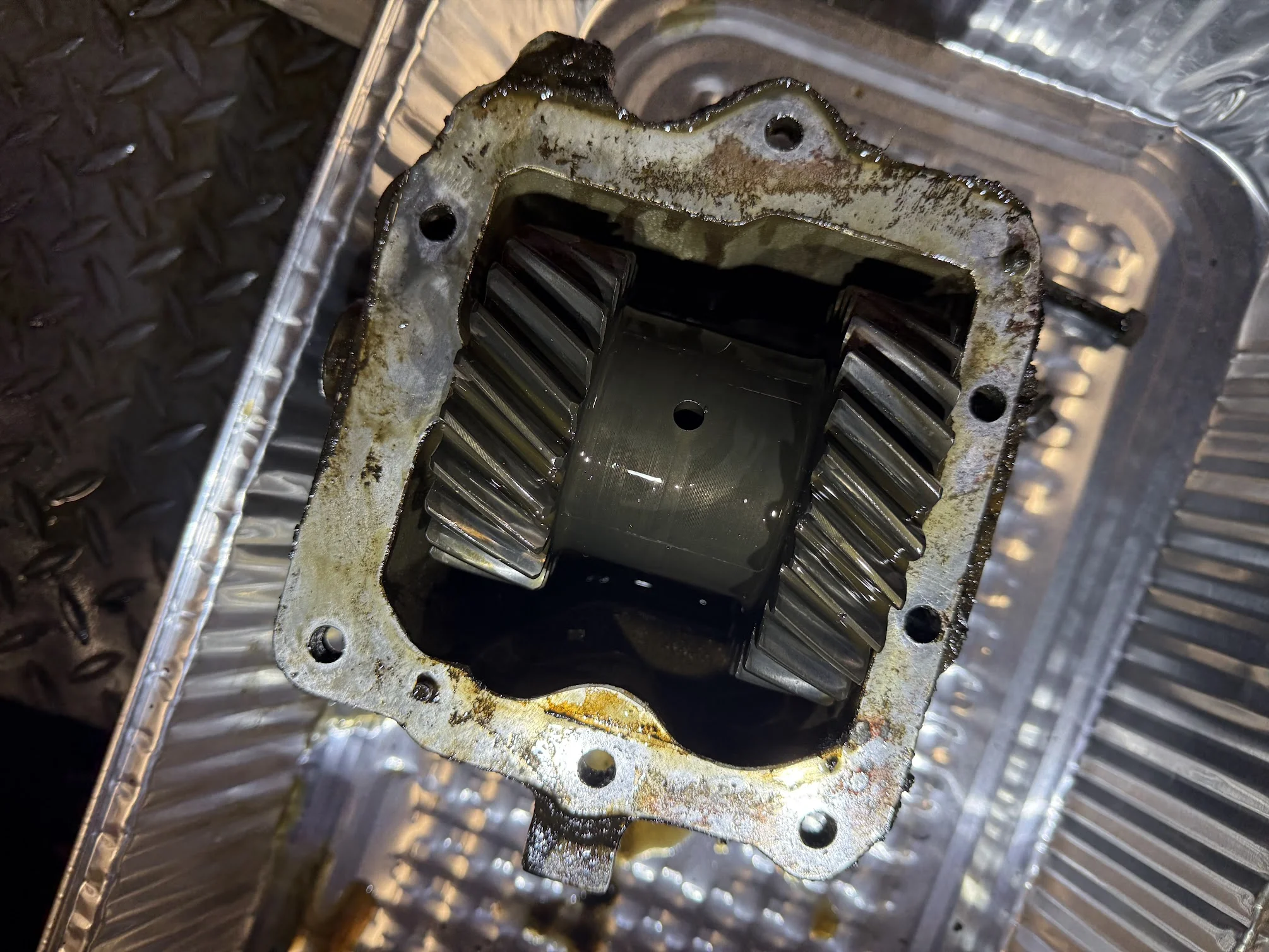

* Seal up the Fairey overdrive housing so it'll hold some gear oil.

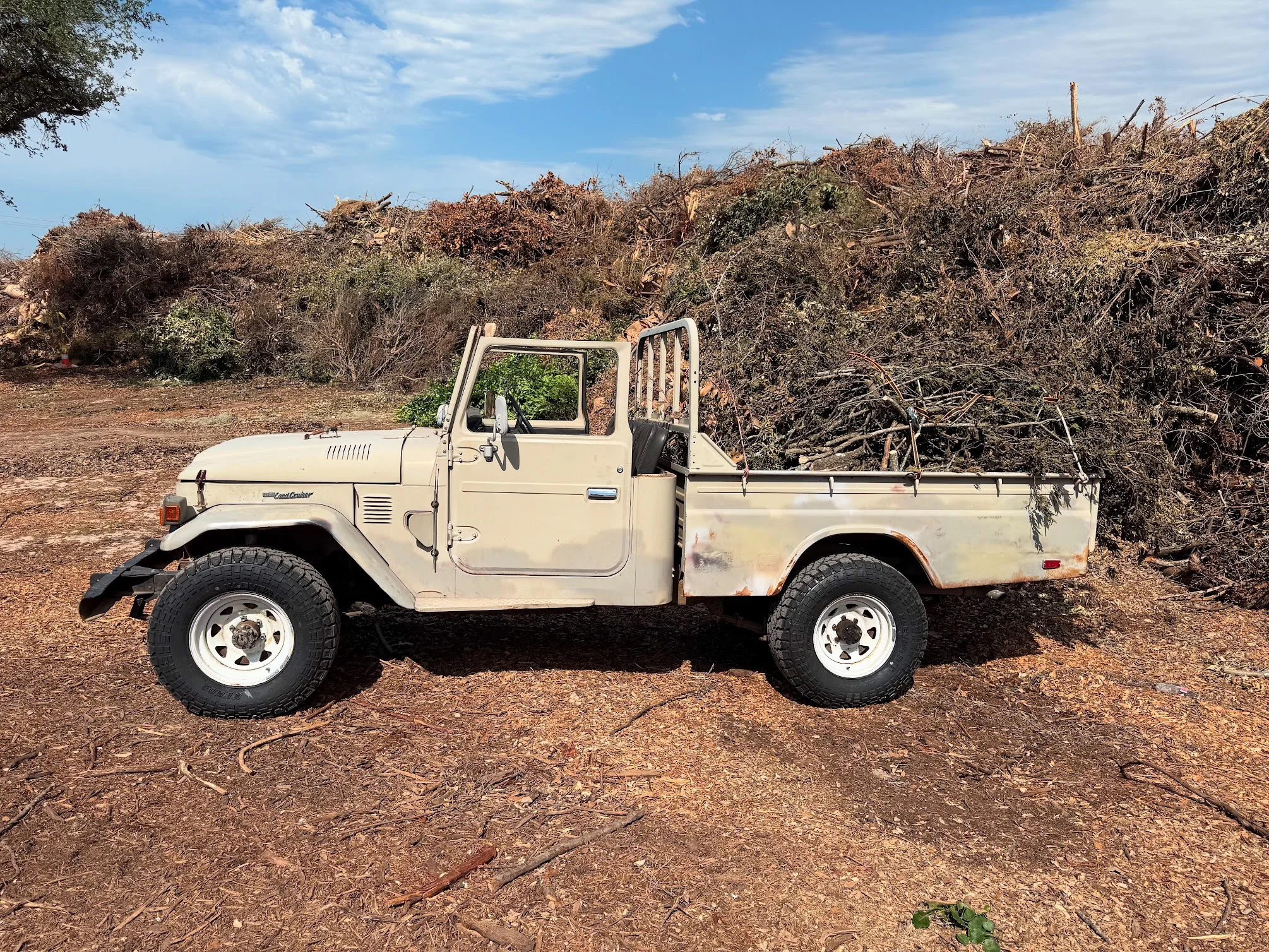

I drove Ichiro today. Two trips, about 20 miles total, and it didn’t overheat!
If it keeps behaving, I’ll reward it with tires and brakes and maybe the front springs off of a 1973 40. I get why they put an overdrive on this. It seems to be geared very very short.
Sealing up the Fairey Overdrive, and hoping its eventual death won't be catastrophic. Georg tells me they're obsolete and spare parts are unobtanium.

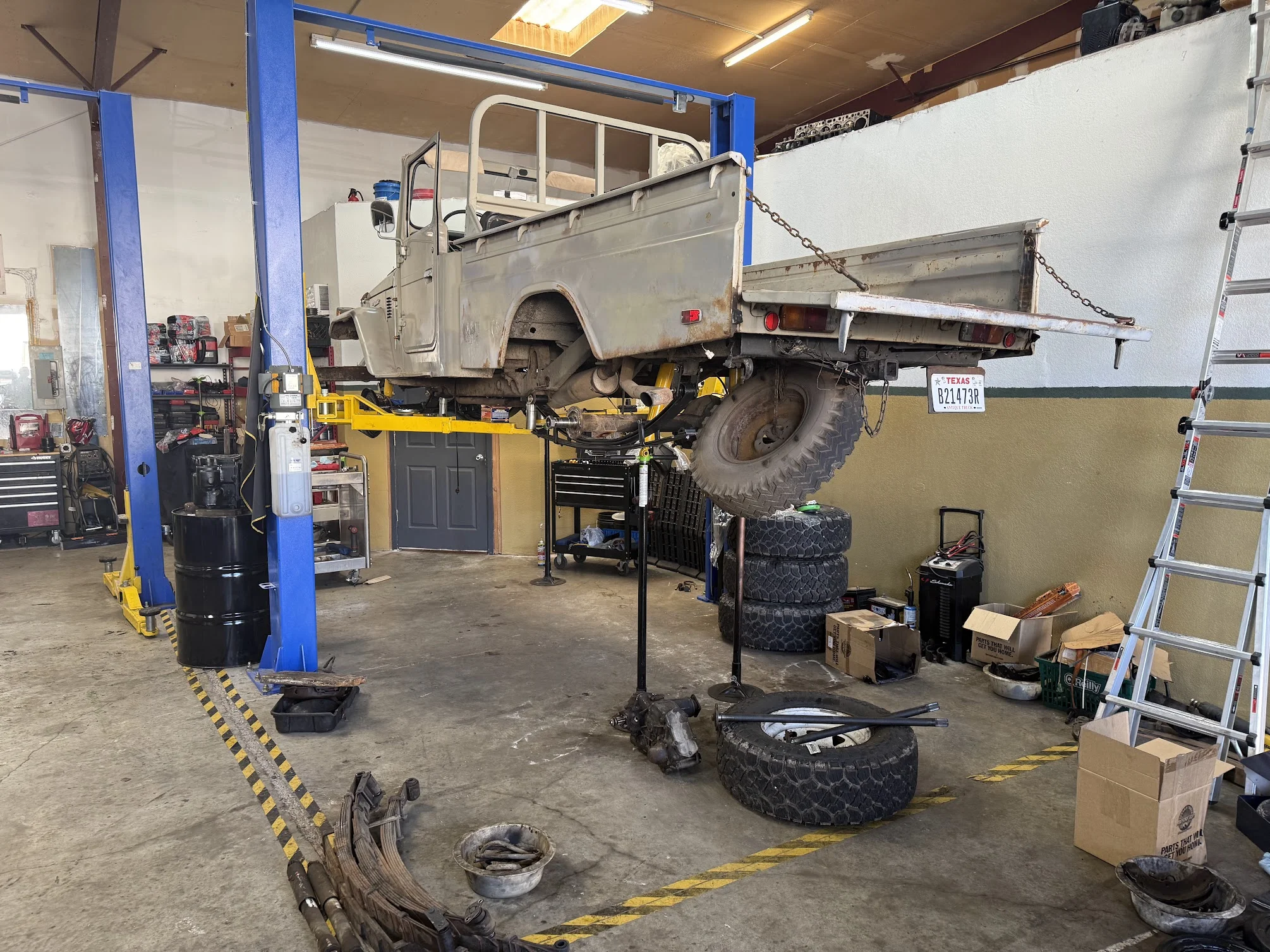

I'm re-employed after six months of "entrepreneurship", and unrelatedly Ichiro has proven to be useful and fun. So, we're investing in some professional surgery at @aljollano 's shop in Cedar Park. Ichiro should be ready for the SAS 9 event that we're not going to make this year (refer to said employment). Oh well, anyway Ichiro should be leak free and skookum for years to come! As a special bonus, Ichiro is getting the transmission and transfer case freshly built by Georg that was slated for Galen's purple 40 "Barney".

@aljollano AJ's Yotas in Cedar Park, TX:
  • Harrop e-locker installed in rear diff
  • Front axle overhaul
  • Rear axle overhaul
  • Brake system overhaul
  • Terrain Tamer elliptical springs
  • Terrain Tamer shocks
  • Installed "Barney's" 4 speed & differential rebuilt by Georg at Valley Hybrids for Dr. Galen here in Austin
