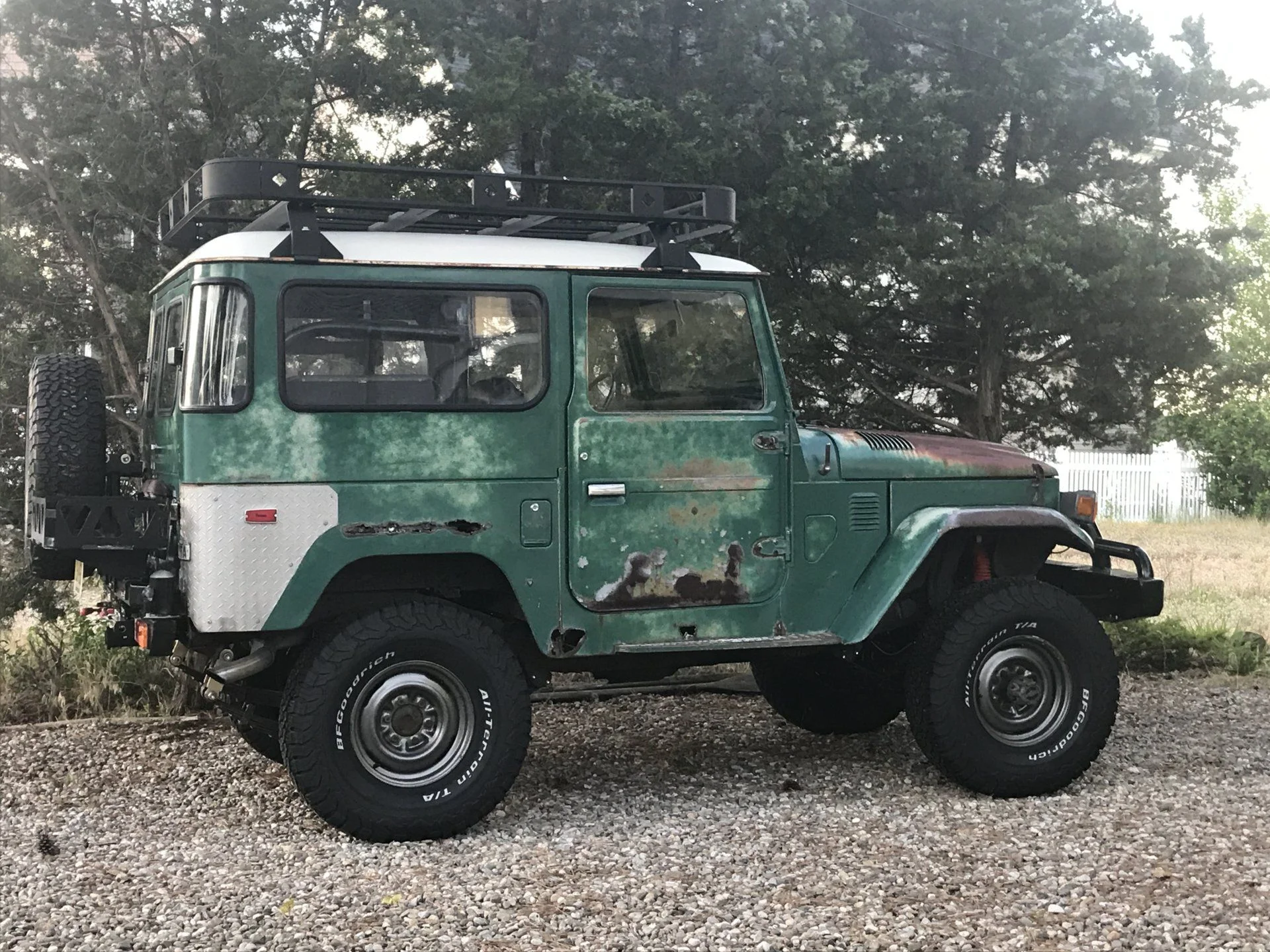

The body is in pretty bad shape, tub is all rusted and repaired by PO in a few spots. Rims are the stock steelies, but I bought them used on Craigslist so maybe there was a slight difference in a couple haha. No matter how you adjust the drag link the car ALWAYS has to be steered to the right a 1/4 turn. Should have the stock axles, as it was original save for the motor which was factory replaced at some point. Has a 4" HFS lift on it with 33 x 10.50
Cant tell much but here she is....bought her out of West Deptford NJ and she has seen a lot of work.
