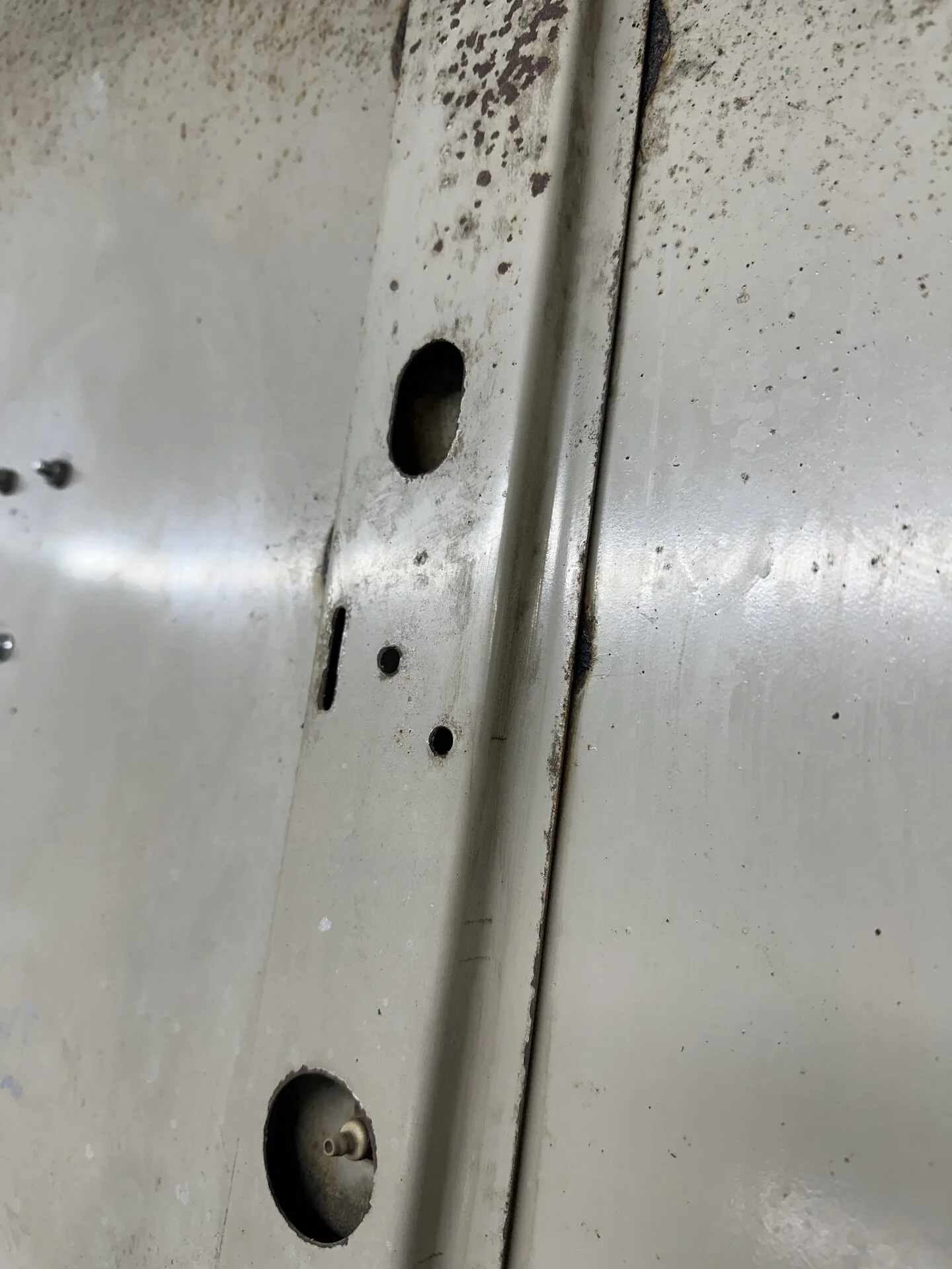

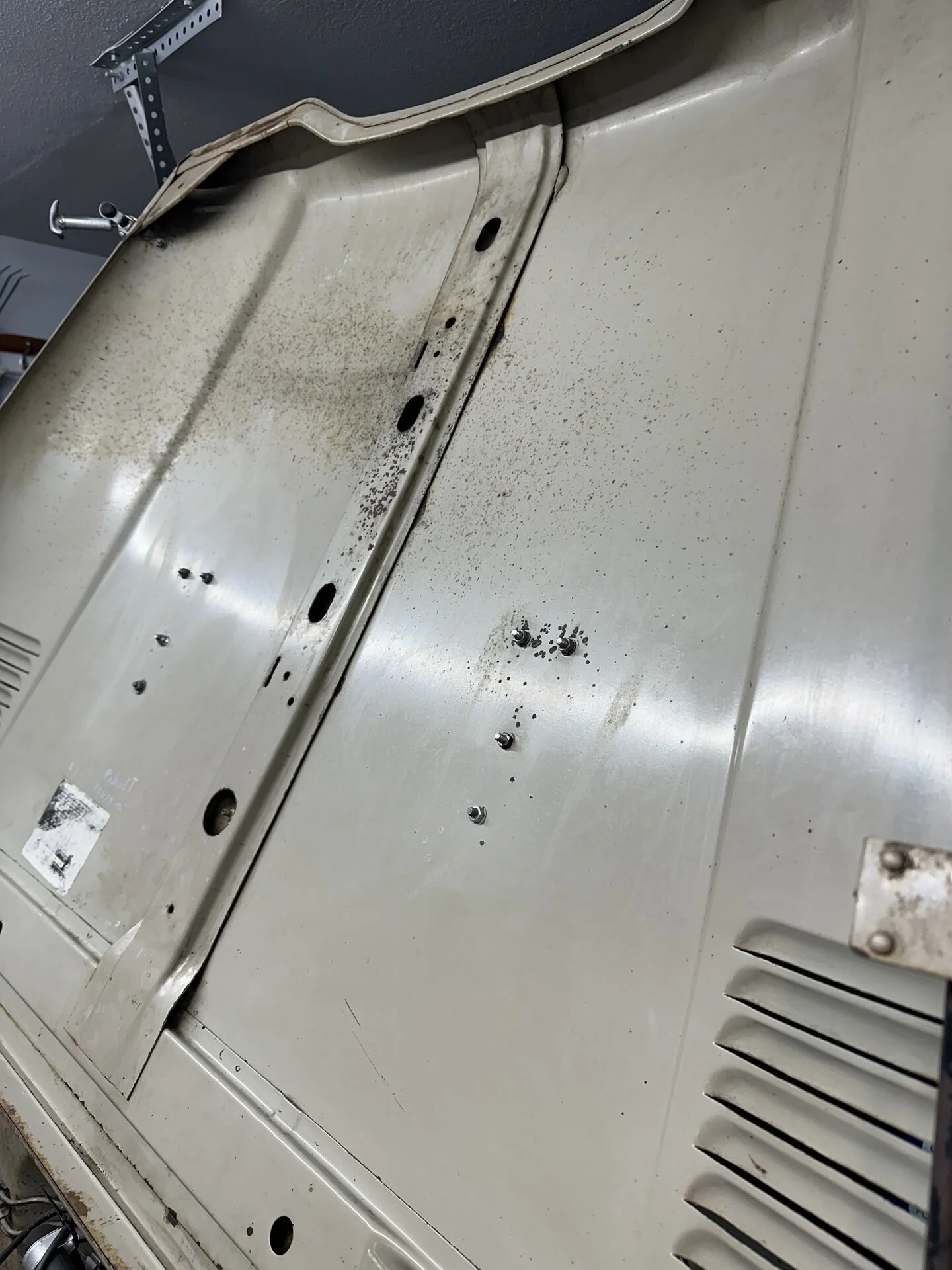

Cleaning up the hood, the center rib looks like it is glued on? As I see no evidence of spot welds. Would seam caulking material be appropriate, after cleaning and derusting?

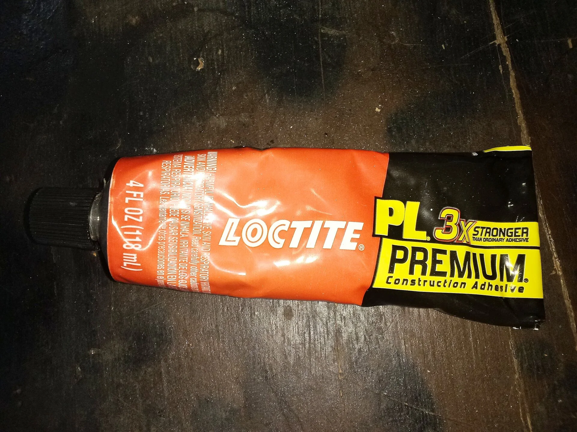

Suggestion: pry open the gap between this bar and the hood sheet metal, squirt in some PL-series urethane construction adhesive (the nastier, the better) in the gap, and then close the hood half-way onto a 2x4 (end-wise) atop the engine. The weight of the hood resting on the 2x4 (which is sitting on this loose support) will help squeeze the support bar tightly against the hood sheet metal. If you own an FJ55 or 60, you'll see the same delamination problem.
However you do it, get gentle weight on the hood against the support bar to squeeze out the excess bonding agent.

Excellent advice! This is exactly what I did. Used several small wedges to open the gap then squirted as much PL adhesive in as possible. Then removed the wedges and shut the hood on a couple 2x4s. After day or two it completely cured, rib was locked in place again and my hood was much more stable. Dries a light beige color so it should blend in well with your paint @South Texas 97 , I had to get creative with a colored sharpie to make it less noticeable on my green inner
hood. 😁

Thanks to all for the feedback. I have used the 3M black urethane window sealant in other projects for “gluing“ flexible things together , and had some left, so have done exactly what has been suggested above. Photos will follow to
