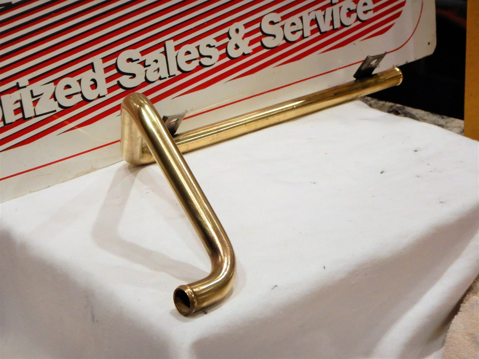

That is/was option #2 if I couldn't find a solution. FACT IS< I kinda' like the look of the old brass fitting...:bang::rolleyes:
Yah, but you oughta shine it up so's to match that valve cover :cool:

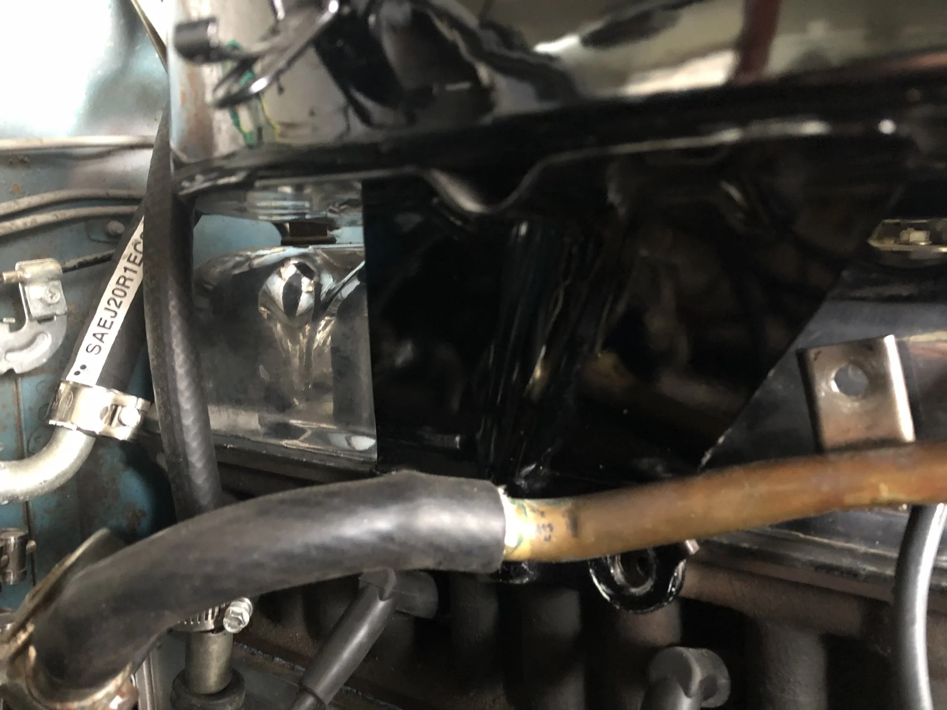

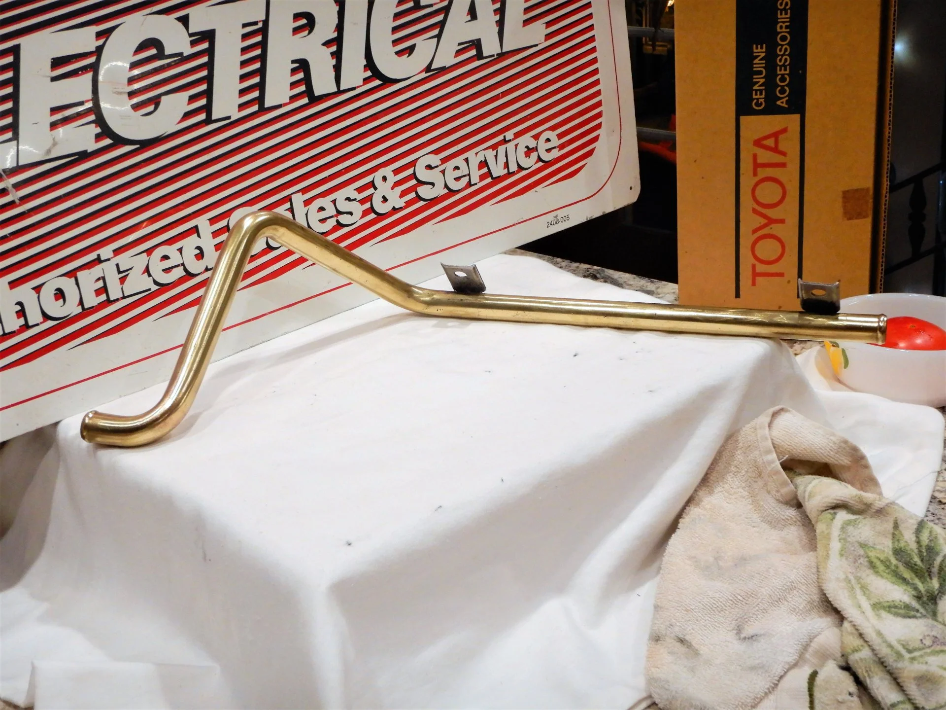

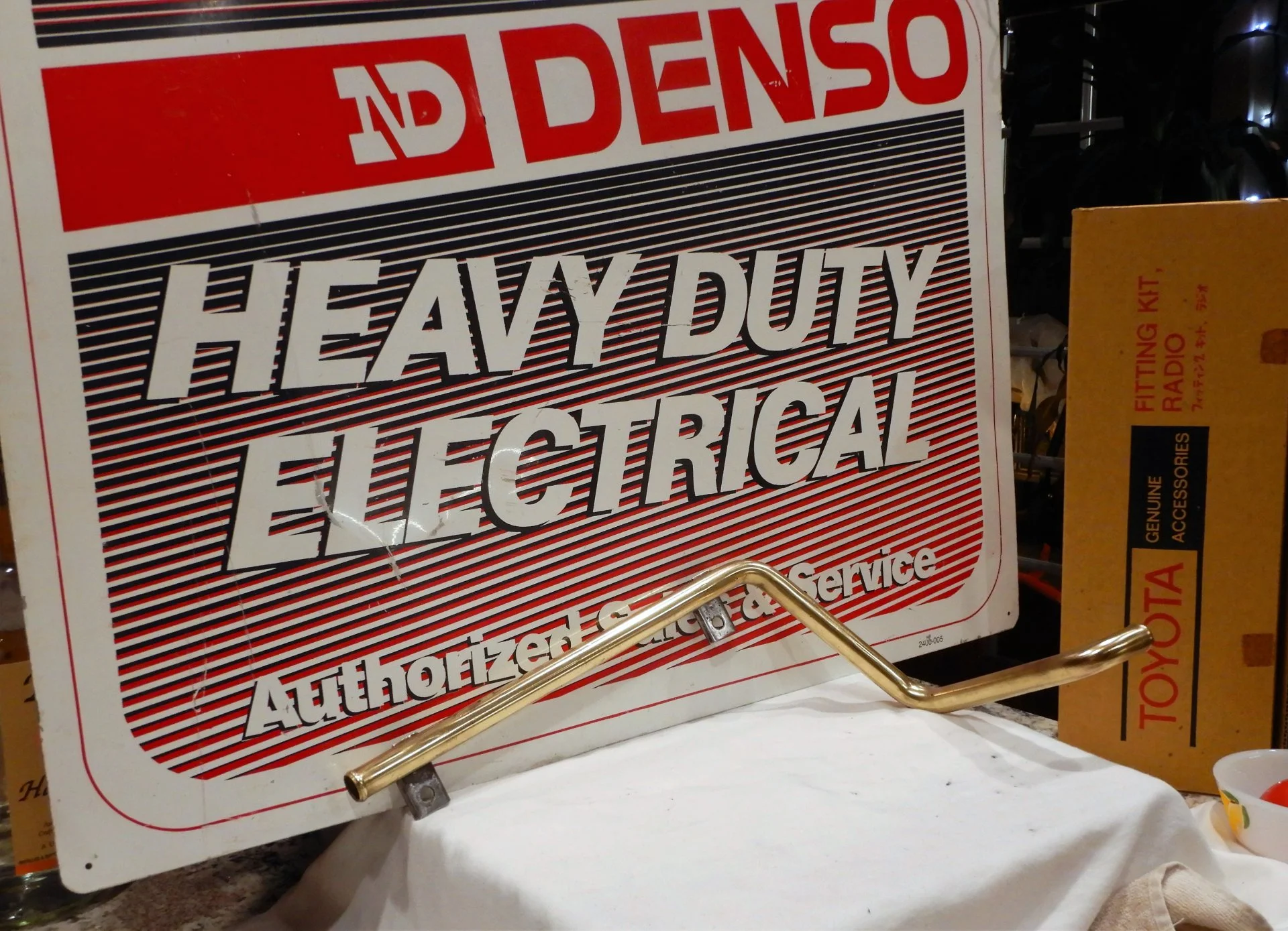

After eyeballing the circumference of the new distributer, it occurred to me I was out of space along the engine block. The "mellon" on the new unit is 2-2 1/2x-ish the size of the old dizz. Not going to fit with the original plumbing.
Current plumbing configuration is in the stock location with the original brass water pipe tucked just below the head. So, I'm working through some options. There are two bosses on the valve cover that I think will work.

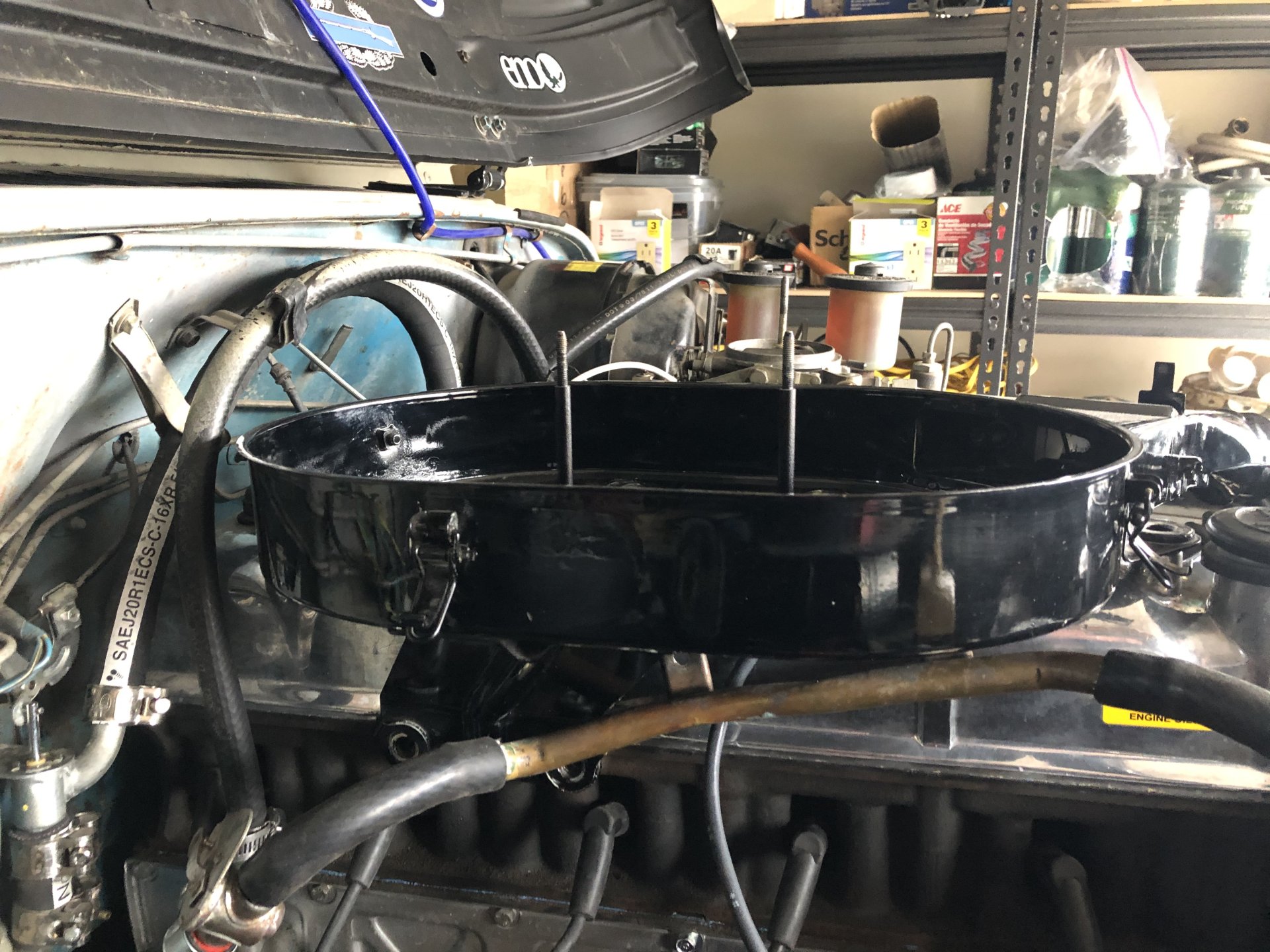

I mocked this up to ensure I had enough height without interfering with the stock air cleaner. That seems to be a "GO"!
I think the permanent solution will incorporate a piece of aluminum flat stock that will bridge the bosses. I can the hang the brass fitting on the bridge.
Current mockup for demo.
Original location:
Looks like you could perhaps use the original mount points but just flip the pipe front/back which would put the mount ears pointing down and raise the pipe? I'm not standing there looking at it and it may not go at all and/or create sufficient clearance for distributor but would be slightly less invasive and less work?

Mocked up with plumbing...Clears the air cleaner.

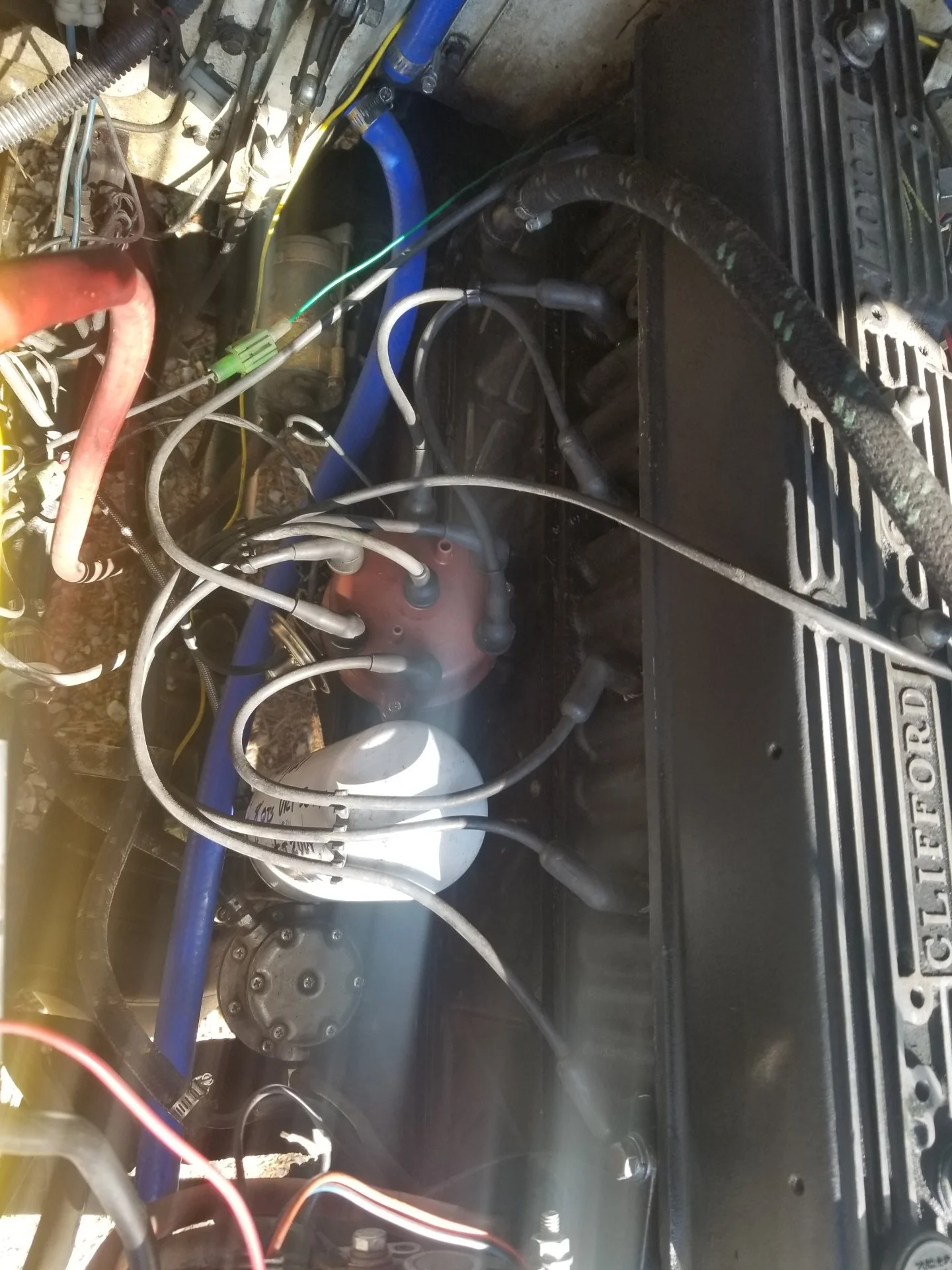

Does it "actually" fit around the DUI distributor?
I chucked my hard line and just am running a soft line now.
These things are a mystery to me too. From looking at my setup, sans distributer, I need to route above the cap. I defiantly want to keep the rear heater intact, so ditching the line altogether is not an option.
My soft line goes around the dizzy toward the fender. It's out of the way and haven't had an issue yet.
Not difficult at all. Out of the way of dizzy cap and dip stick.
Is it any bigger than the Toyota big cap distributor?

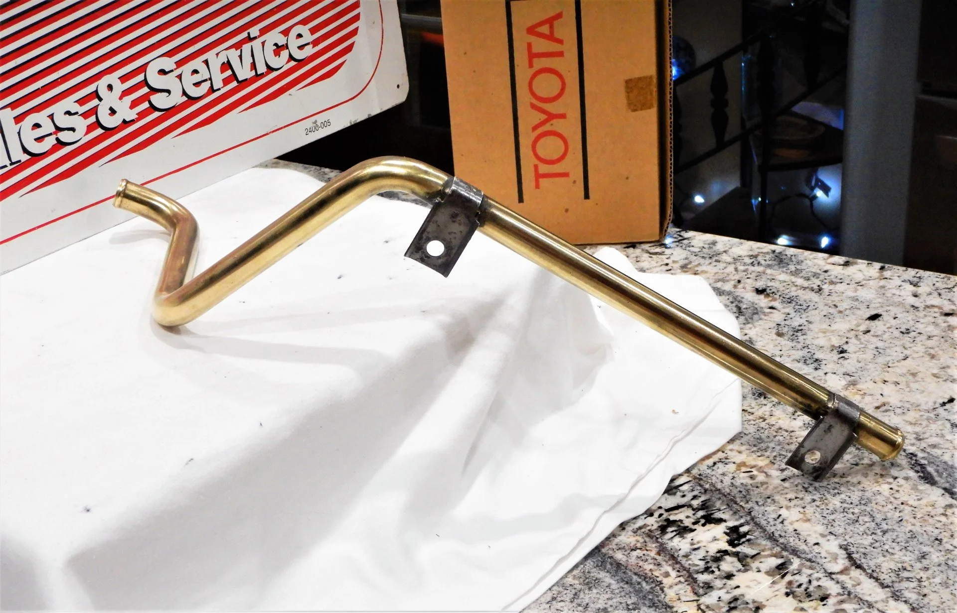

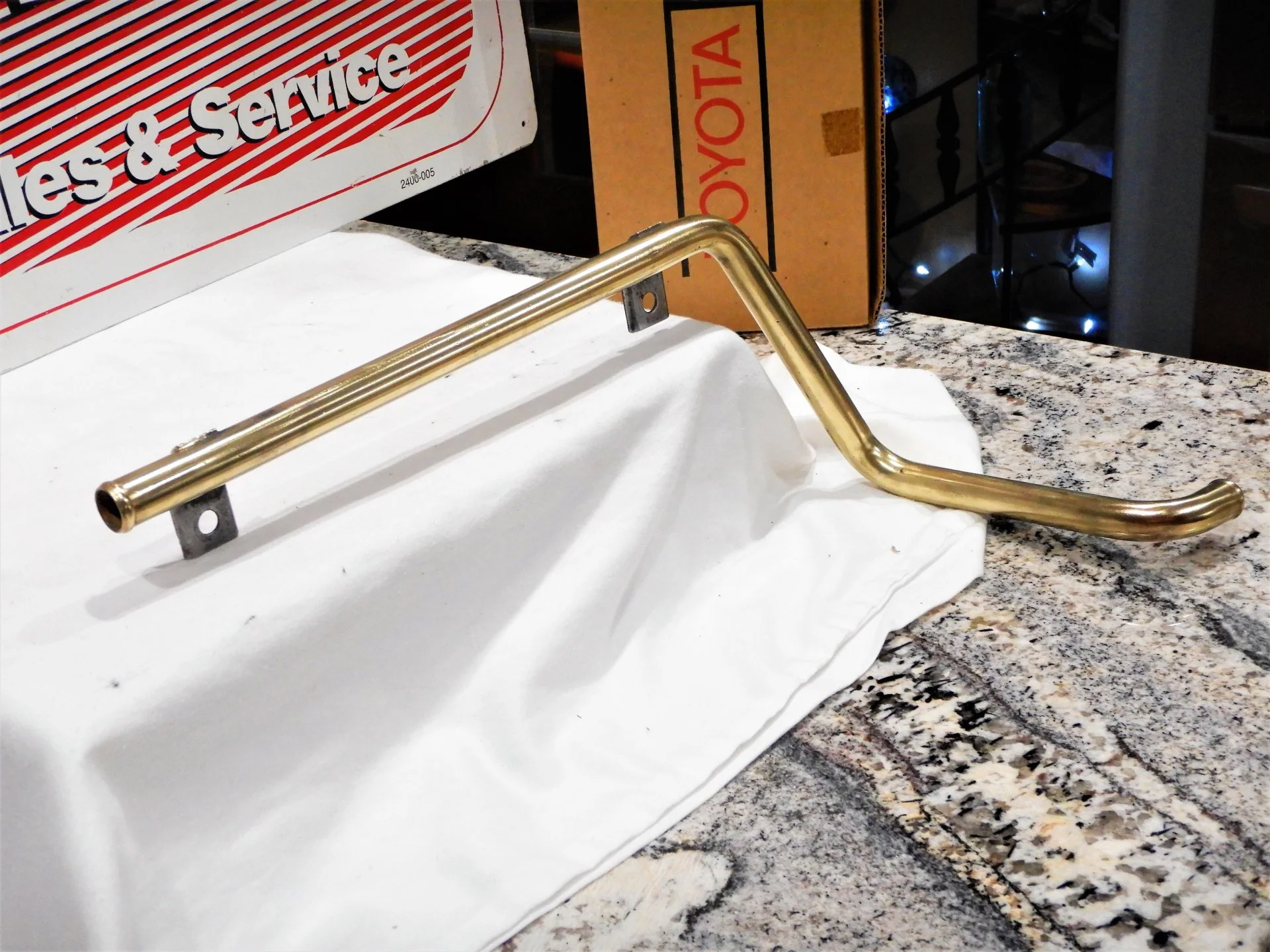

If you really like the old brass, i have a small collection..perhaps find one that fits better
