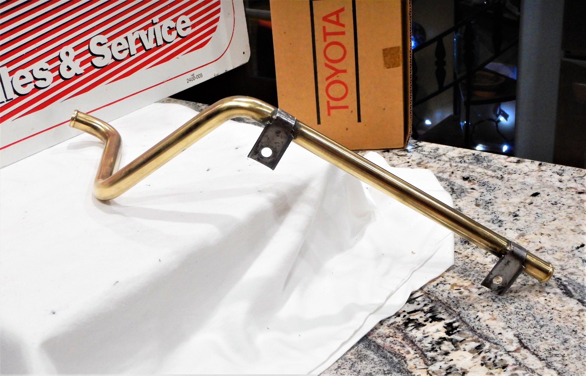

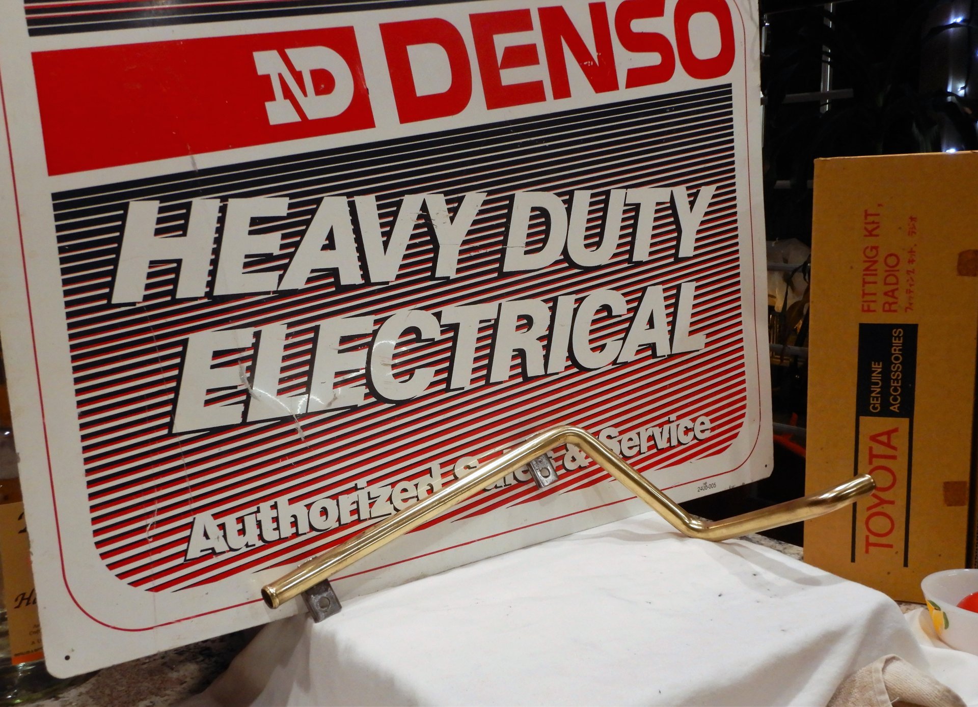

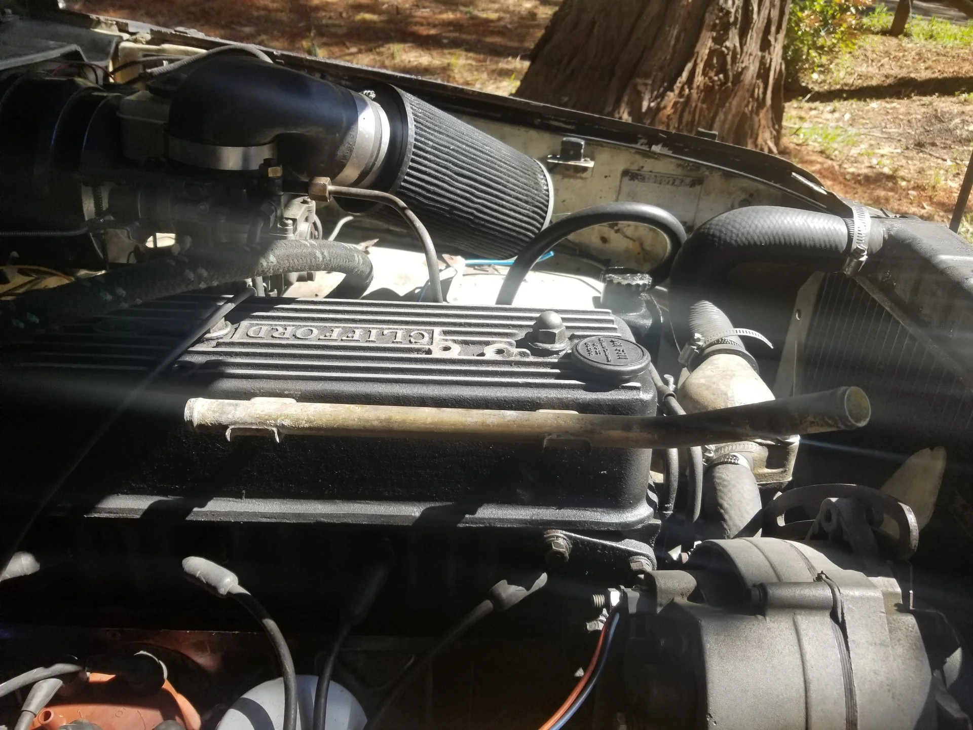

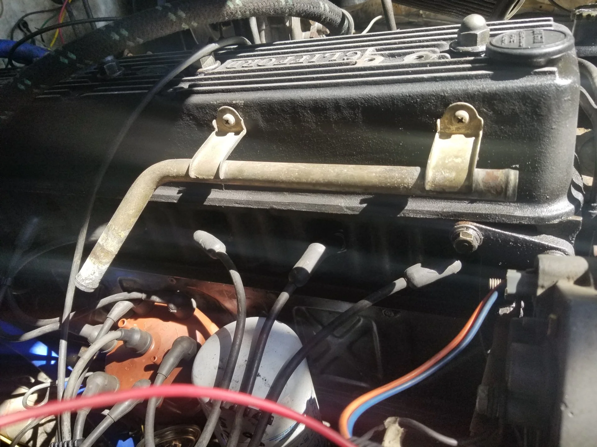

Its a GM sized Uber Mellon. But that looks like a good solution. What's that off of?
Probably off of an 83 FJ60, looks like @Pighead has it right near the middle.

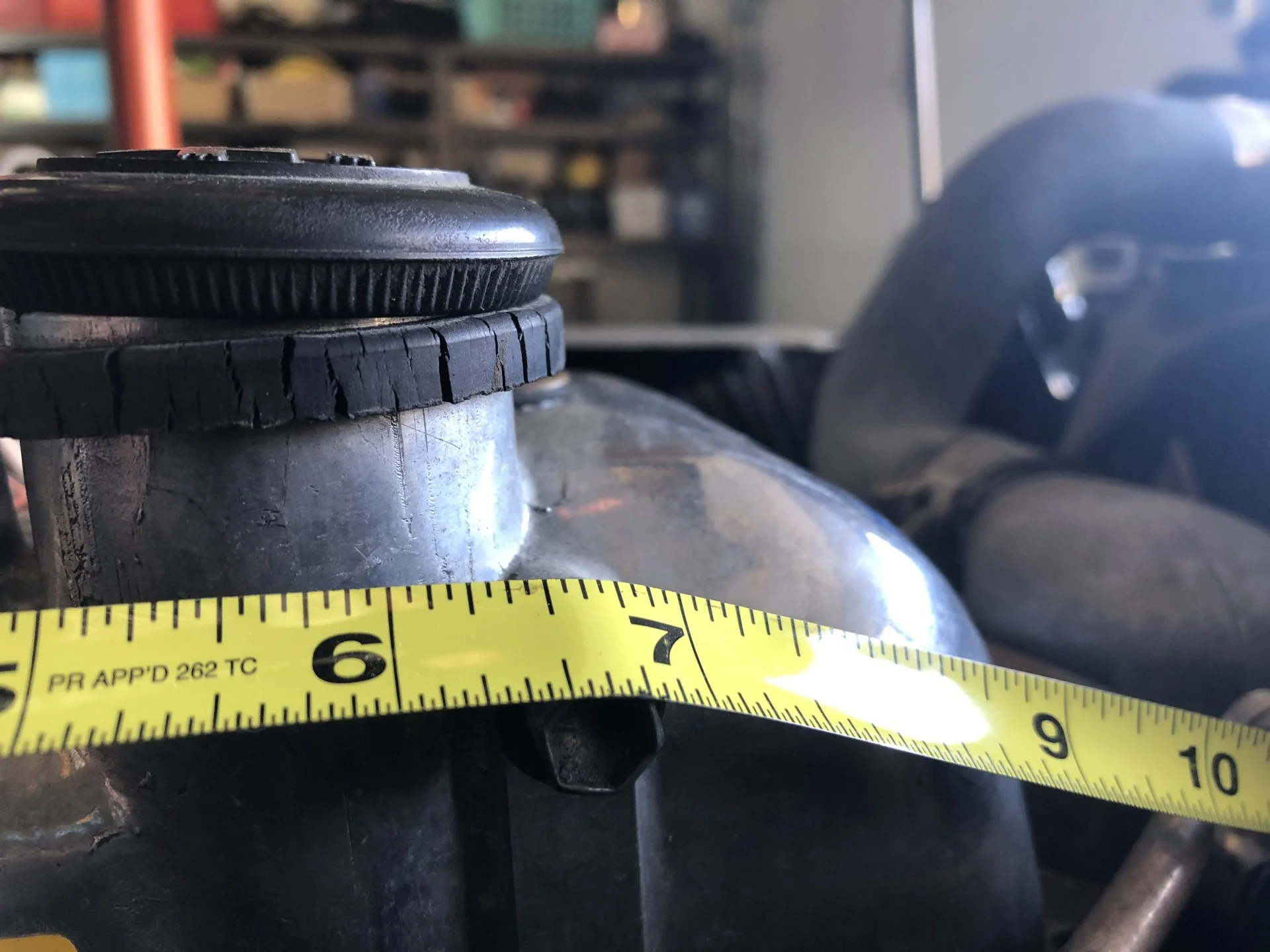

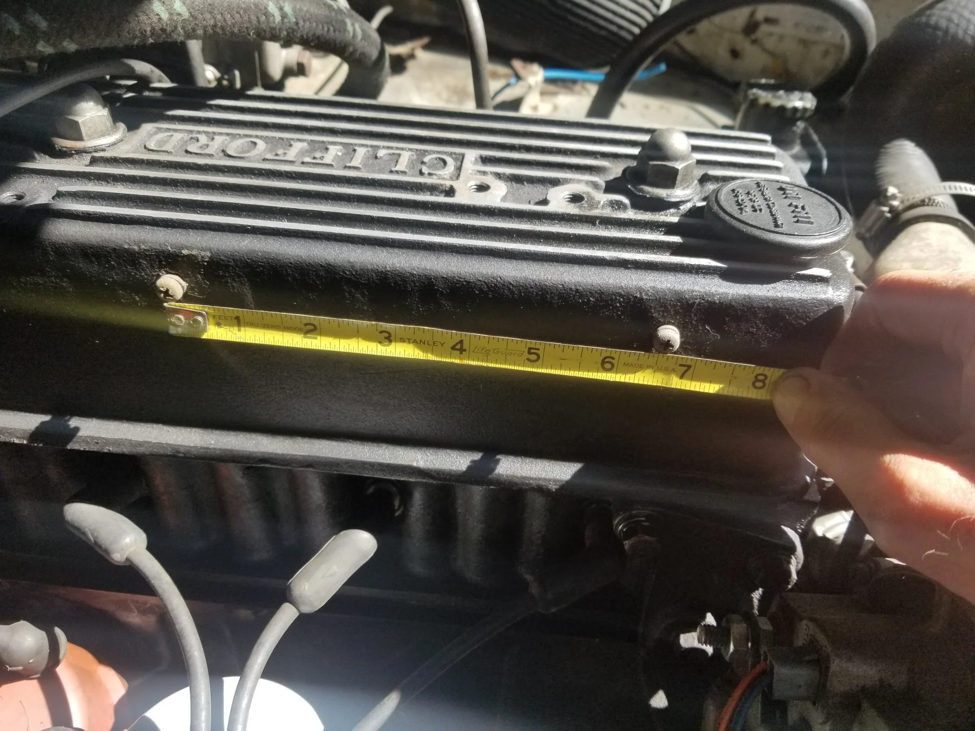

About 6 5/8, give er take a smidge, center to center.

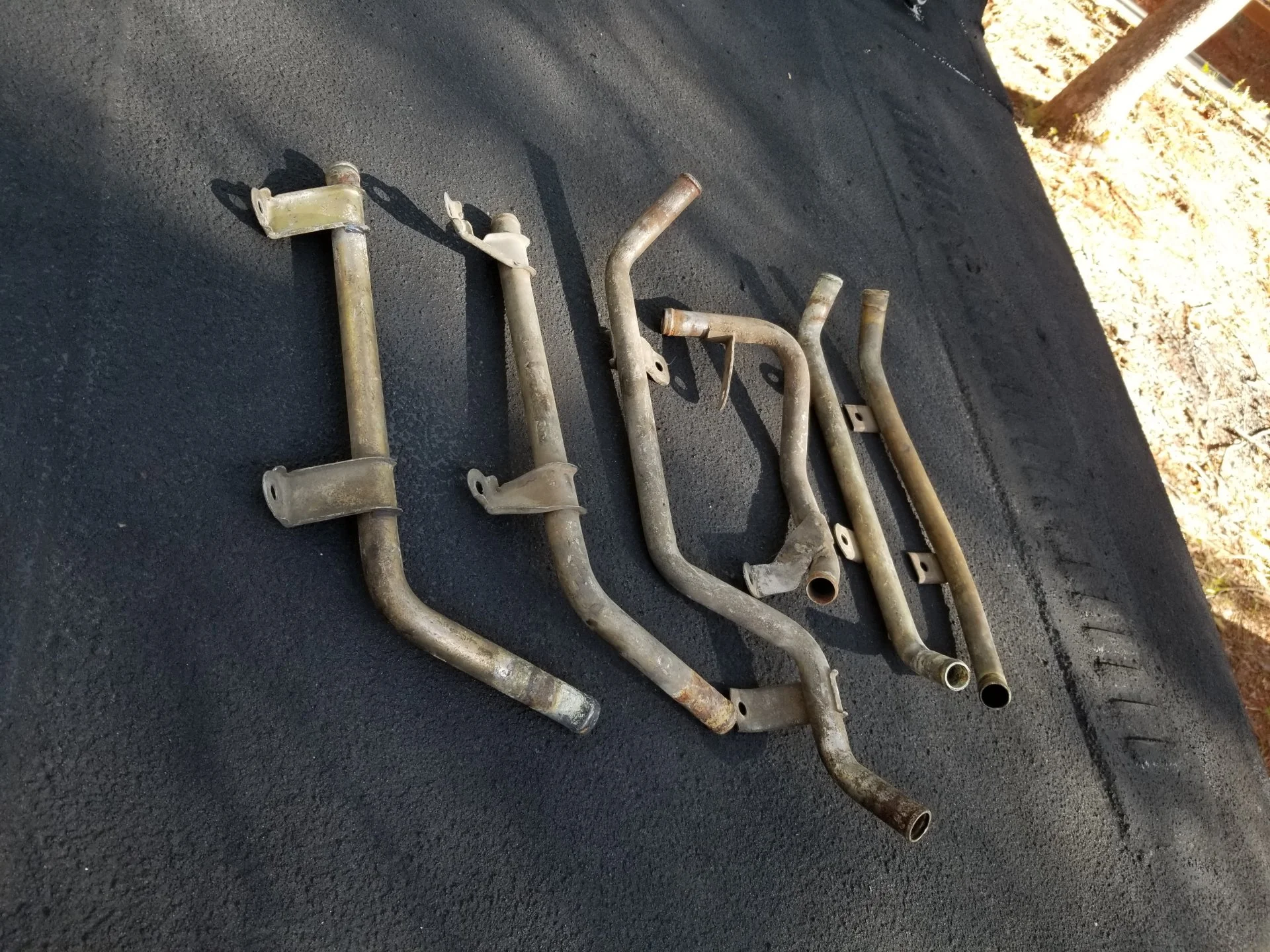

If you really like the old brass, i have a small collection..perhaps find one that fits better

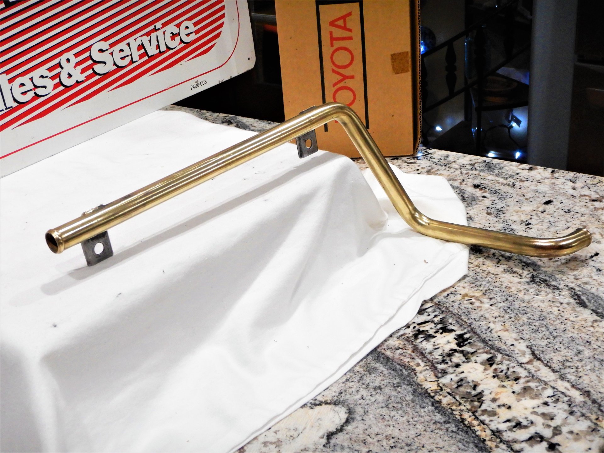

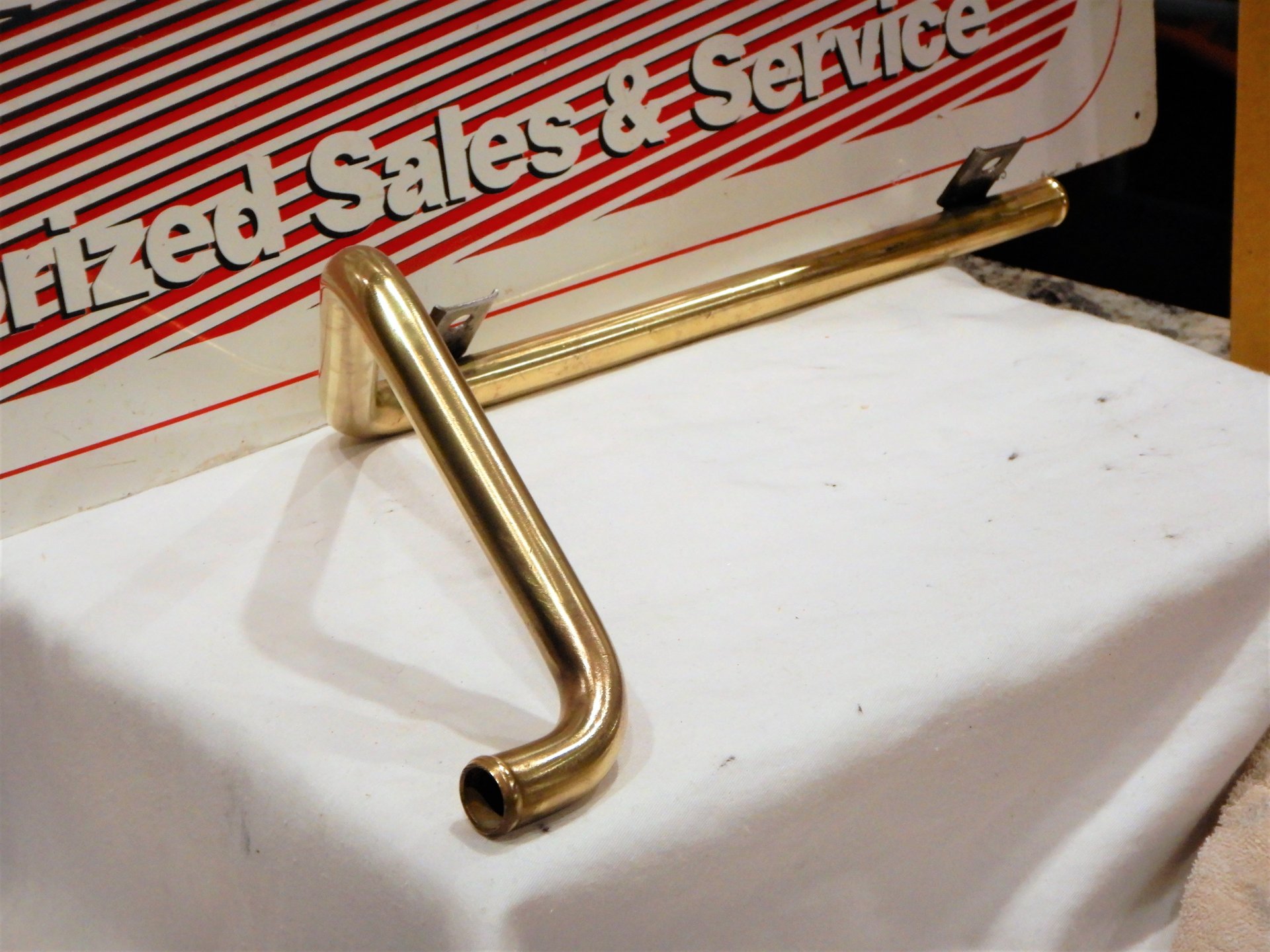

The 1st pc with the single elbow. do you recall what that is off of?
Oh, that old thing? Ty.
Found it at a PMC swap meet for 20 bucks.
I think that after installing it i increased my Pig's value by 6 bucks. The horsepower and mileage gains are secondary.

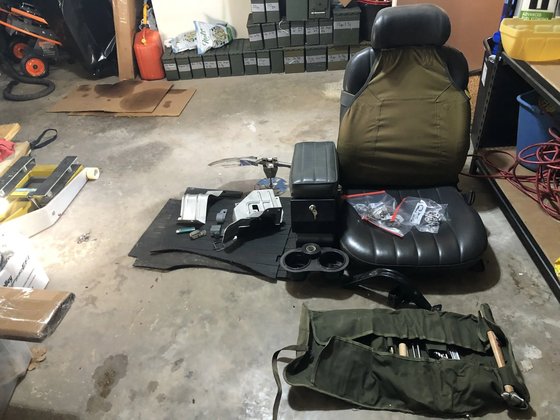

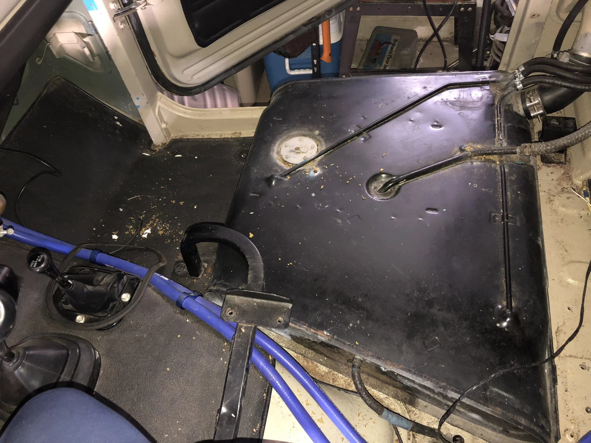

Doing what I can for now. Pulled the passenger seat, tank cover, evaporator cover and dropped the skid plate. Realized I don't have a throttle cable sitting in my pile O' parts. Called the vendor and got the "backorder shuffle".
Mule is getting a little crusty, a bath and a sheep dip via some fluid film is in order.

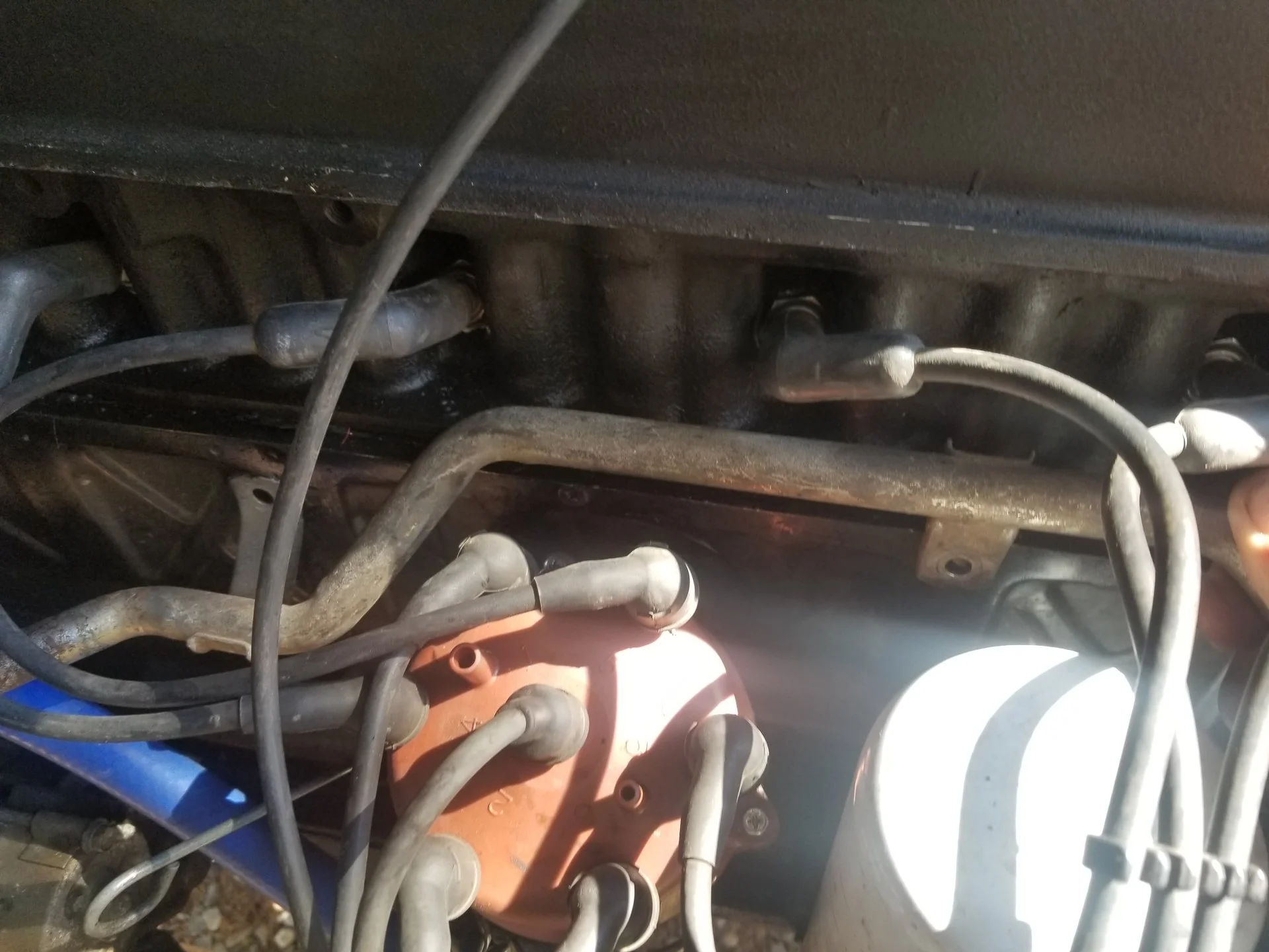

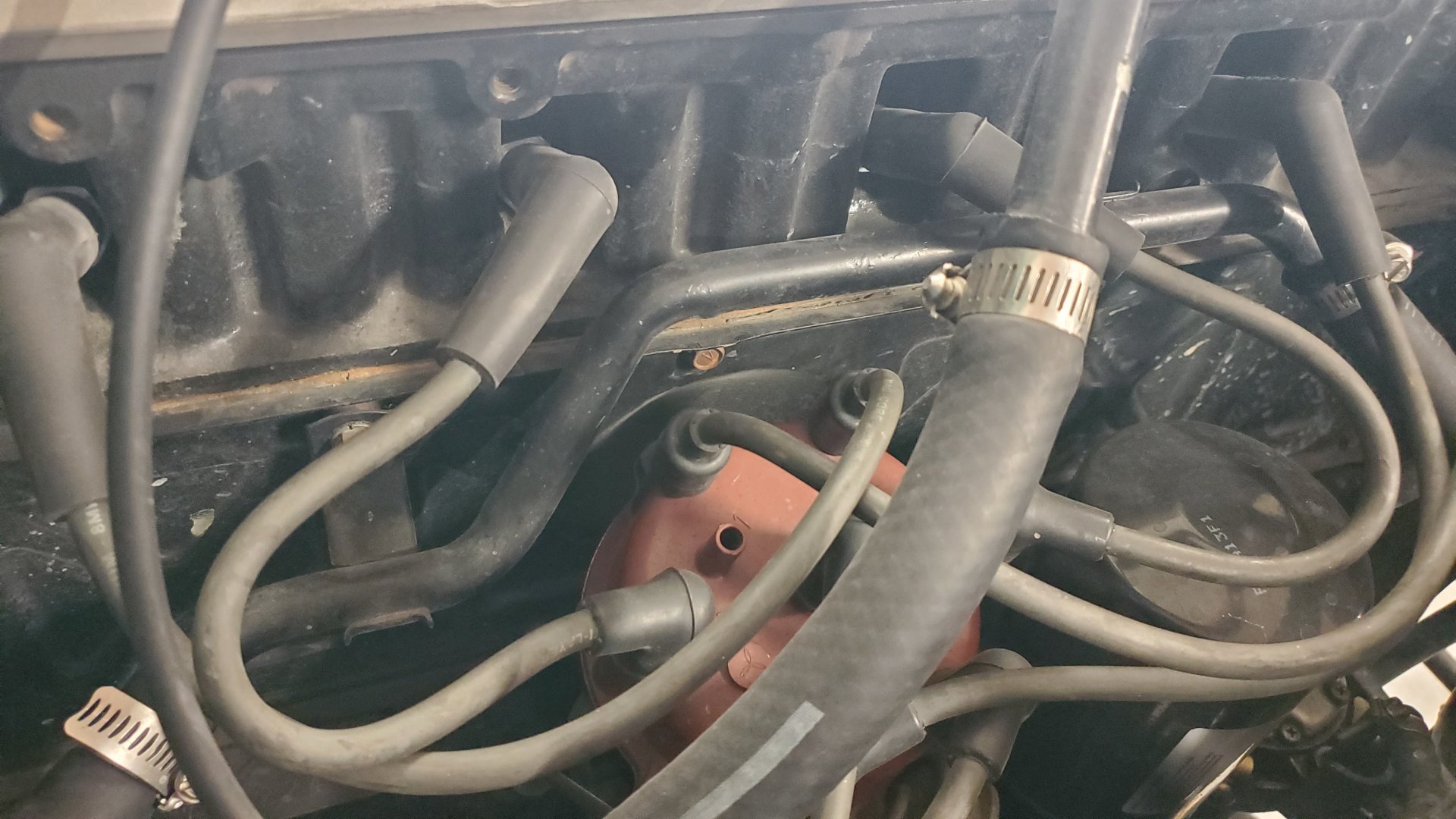

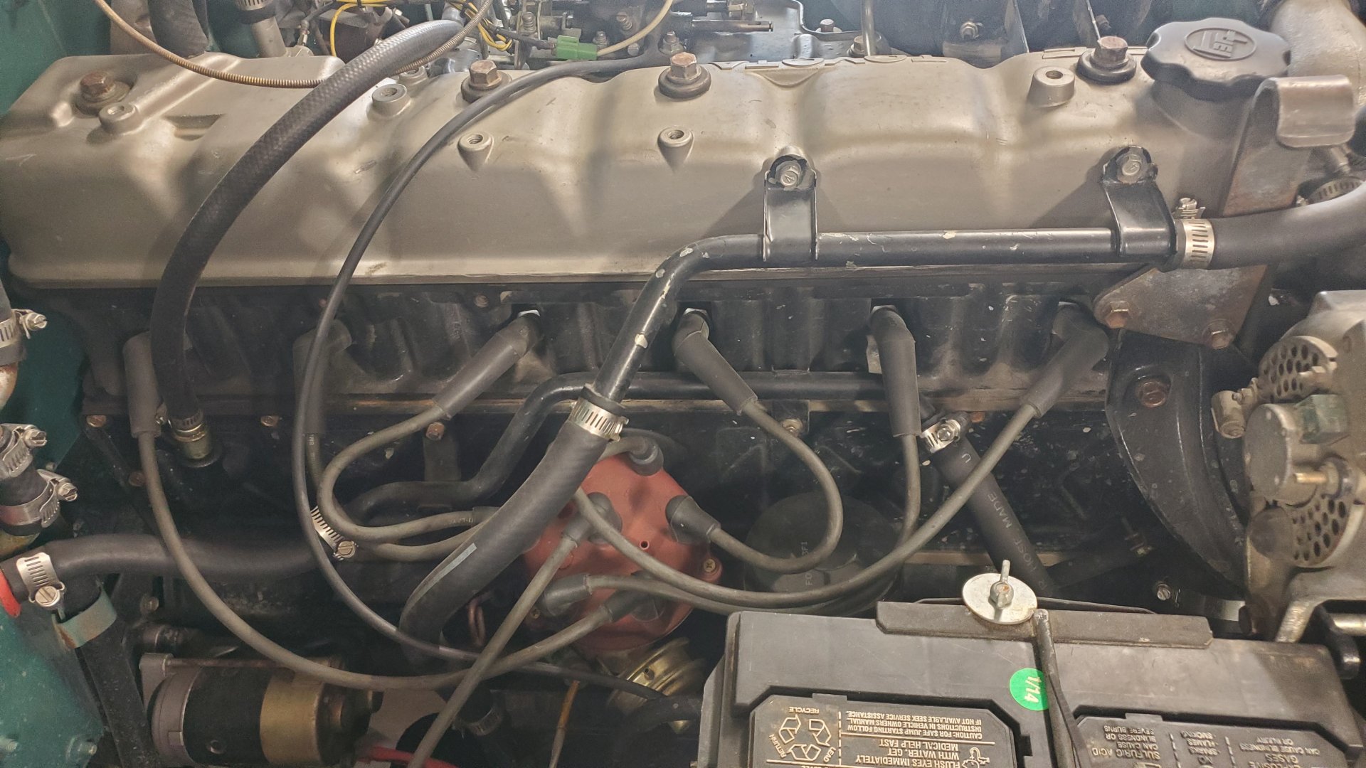

The first pic is a line that uses the side cover bolts, and probably some spacers, but clears the 60 dizzy. Is your DUM taller?
Where does the upper hose, fan side, go to on yours?
Edit:don't give yourself too much credit. I'm probably ignoranter, older and blinder
Yes, taller and a larger circumference (IE Uber Mellon). As I install the new Dizz, I'll send you a pic.

this is a pic of the original routing. I may be making much ado about nothing but I don't think I have room at the original mounting points.

You won't, unfortunately.
Worst part about DUI ignition.
I figured as much.
