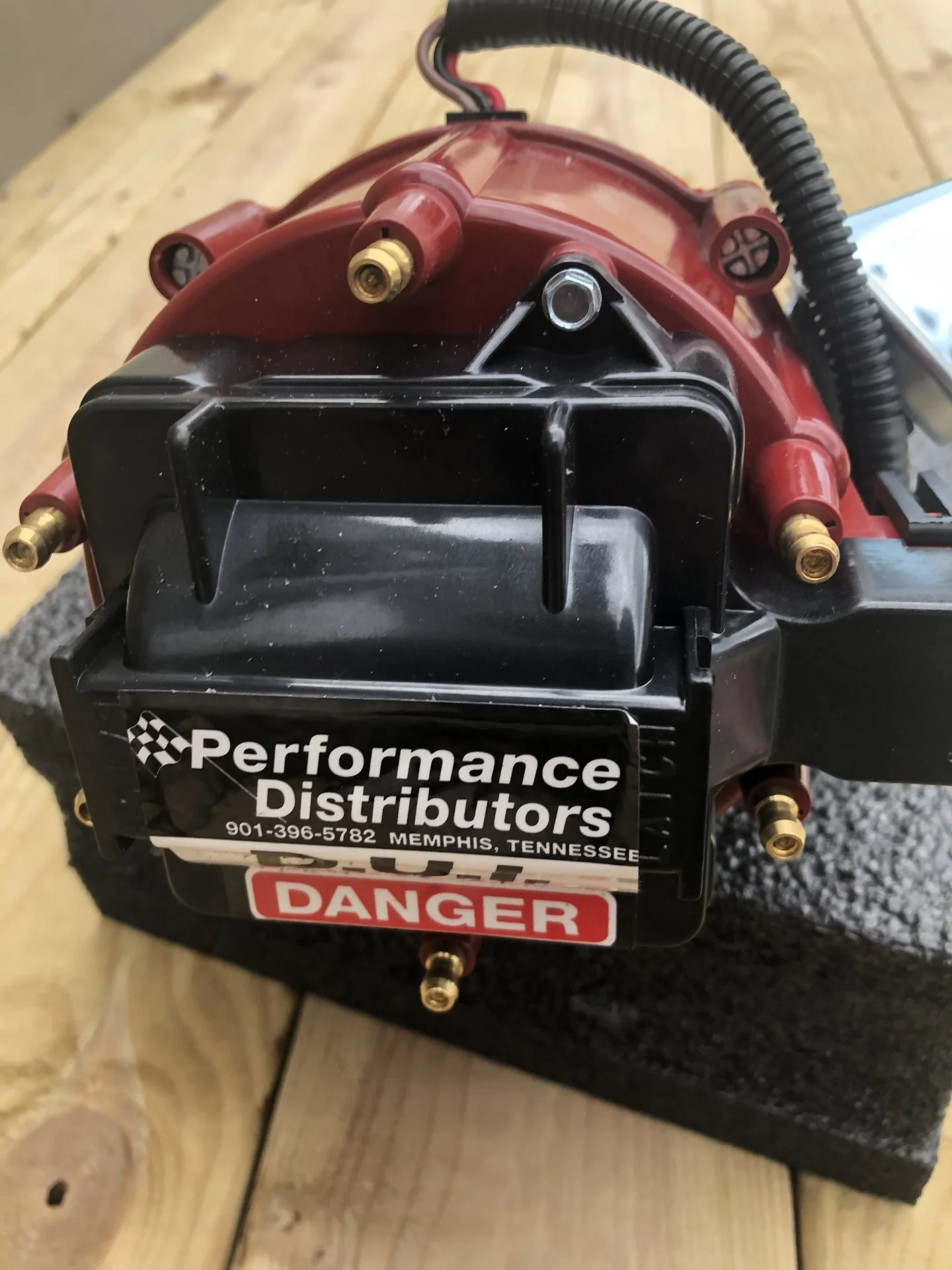

My main man, the man in brown dropped off the new heartbeat today.
Clouds part...Angles sing....Ima' have a "wobble pop" to celebrate. OK maybe I'd have a wobble pop regardless. But now, I have a legit reason..

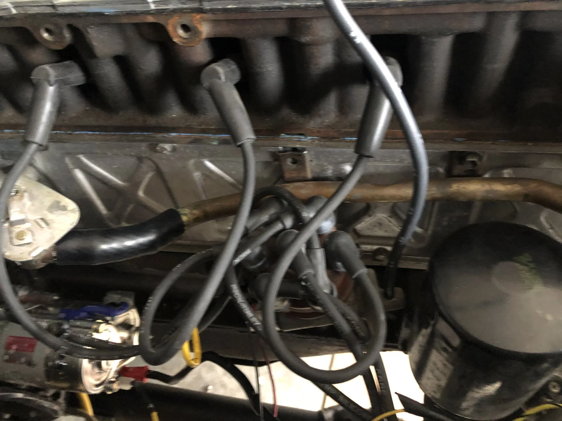

After eyeballing the circumference of the new distributer, it occurred to me I was out of space along the engine block. The "mellon" on the new unit is 2-2 1/2x-ish the size of the old dizz. Not going to fit with the original plumbing.

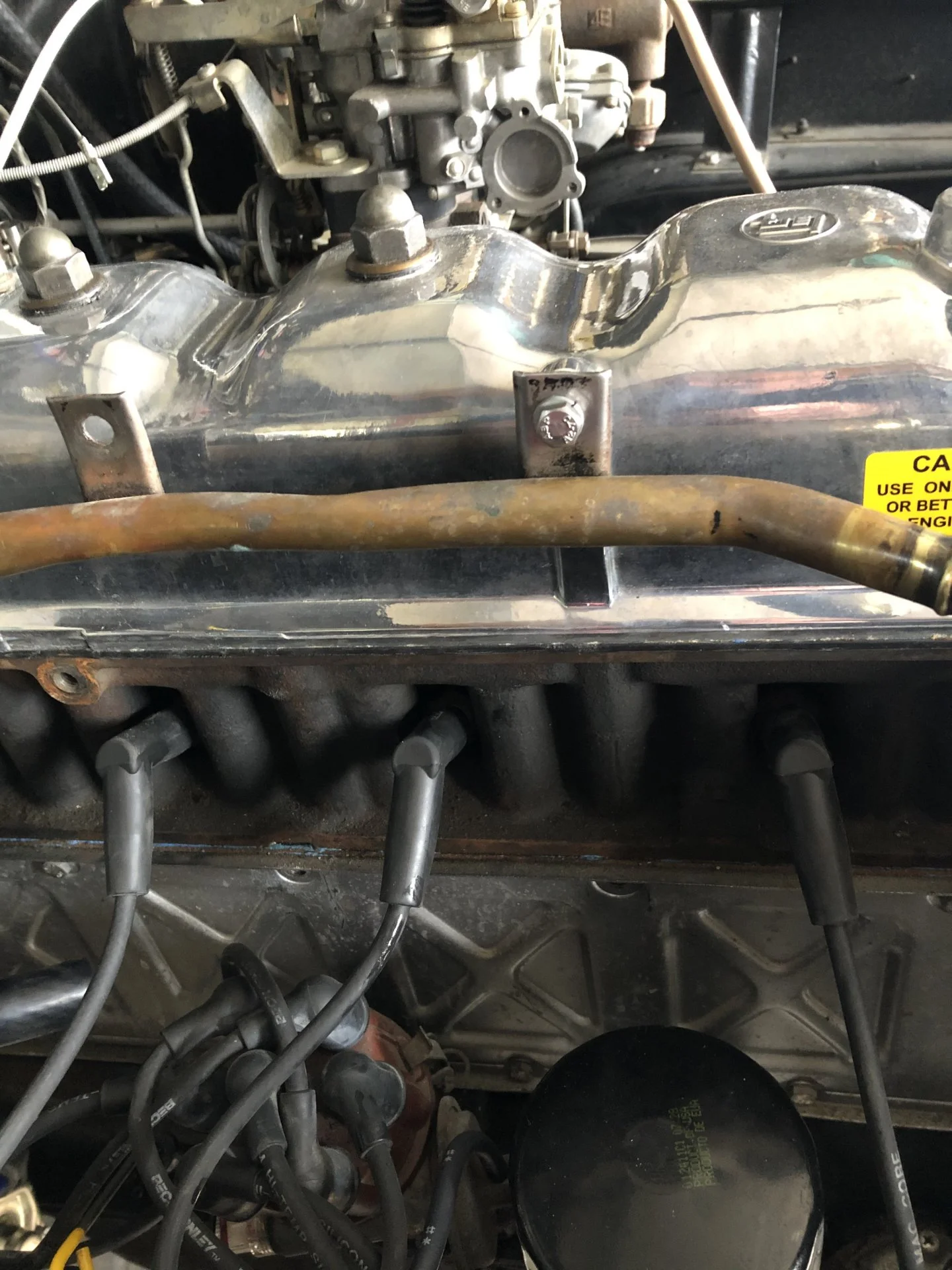

Current plumbing configuration is in the stock location with the original brass water pipe tucked just below the head. So, I'm working through some options. There are two bosses on the valve cover that I think will work.

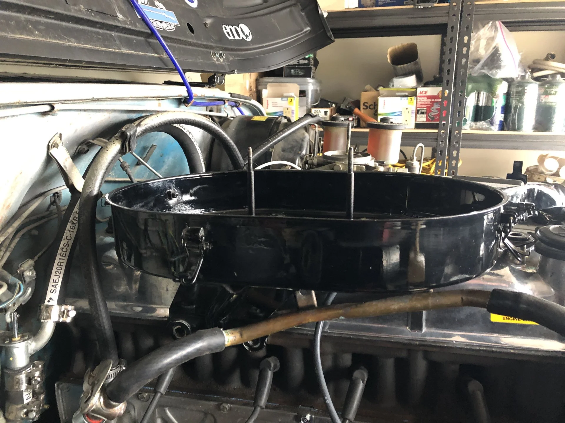

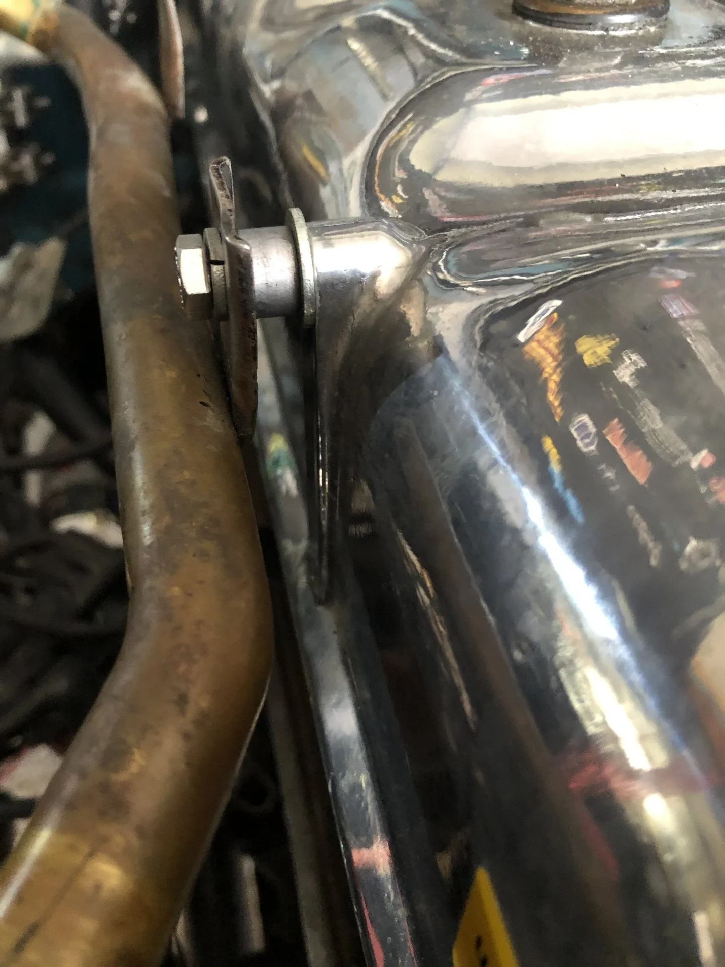

I mocked this up to ensure I had enough height without interfering with the stock air cleaner. That seems to be a "GO"!
I think the permanent solution will incorporate a piece of aluminum flat stock that will bridge the bosses. I can the hang the brass fitting on the bridge.
Current mockup for demo.

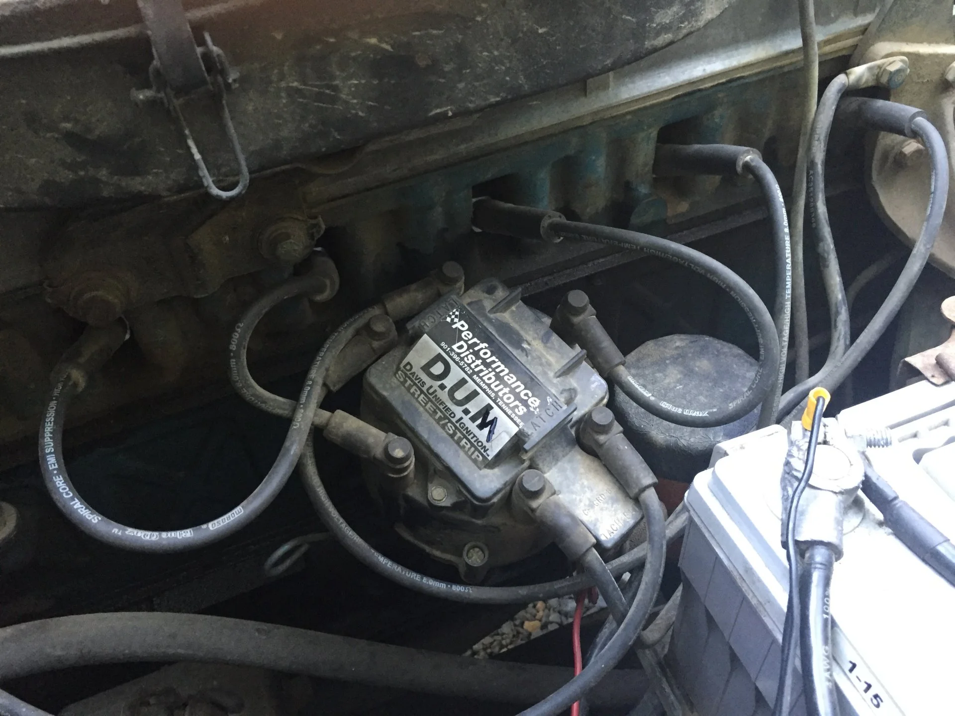

Original location:

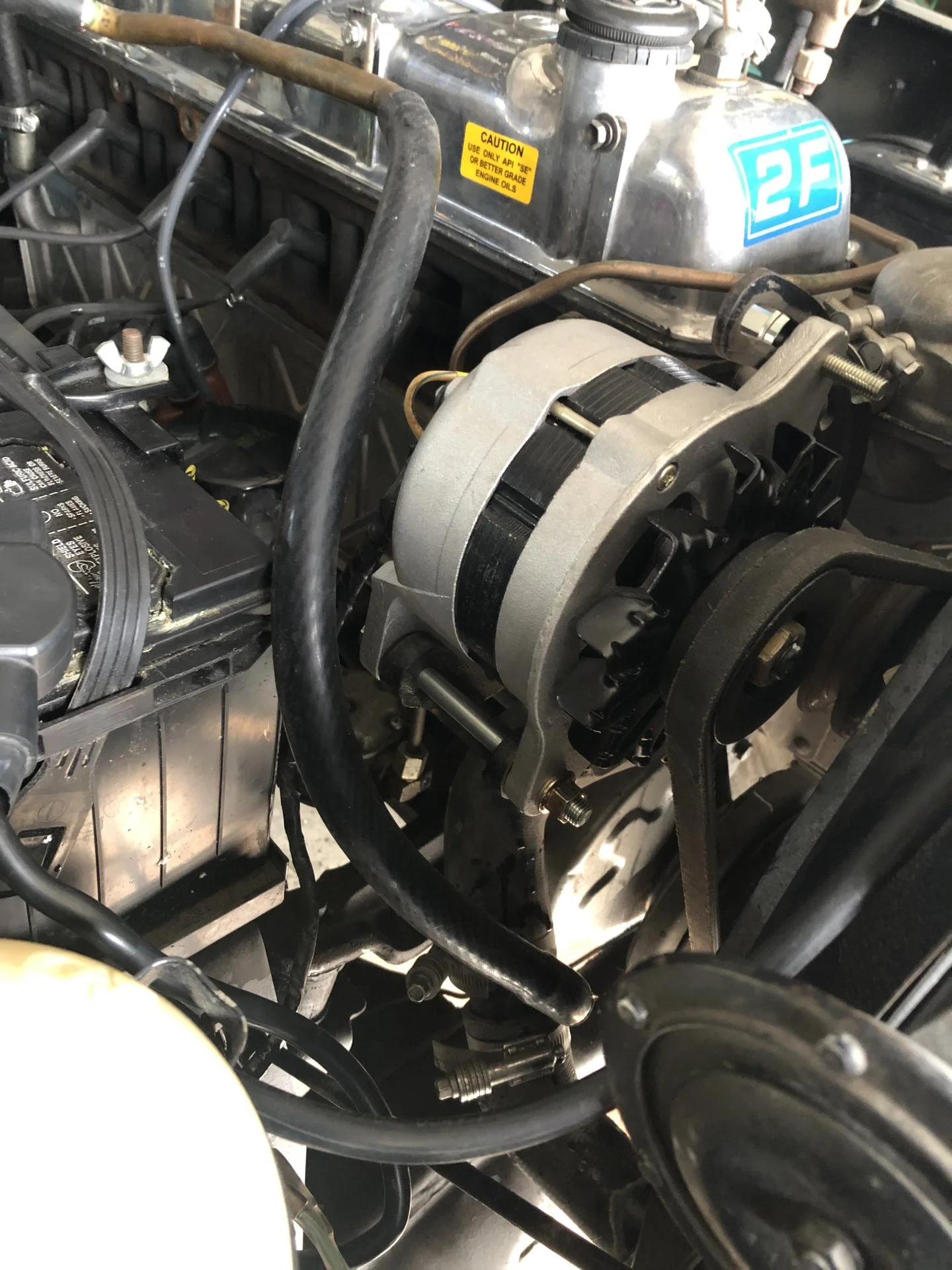

Proposed location. Only attached onto one of the bosses. Small spacer to keep it out from the block.
Mocked up with plumbing...Clears the air cleaner.

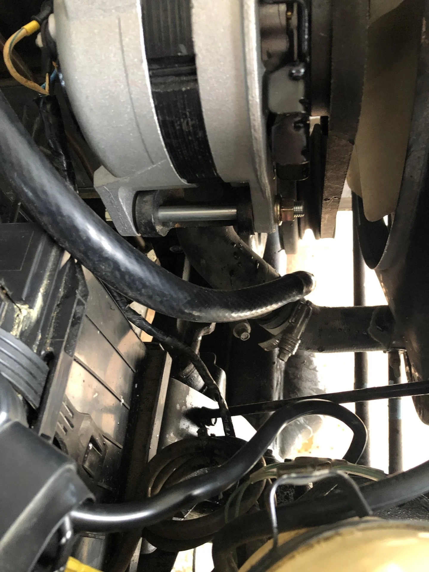

Lower hose routing. clears the alt, fan and battery. I think this will work with the upcoming fuel line routing too. Of course, I'm out of the right size clamps.
Fugly. I think your truck is trying to tell you something:
Other more knowledgeable folks will chime in ... wondering whether it would make more sense in your application to ditch the OME brass pipe and go with one continuous run of heater hose to the fire wall, thus eliminating at least 2 hose clamps and simplifying things a bit. McMaster has rubber coated band clamps for securing hose to cover plate.
That is/was option #2 if I couldn't find a solution. FACT IS< I kinda' like the look of the old brass fitting...:bang::rolleyes:
