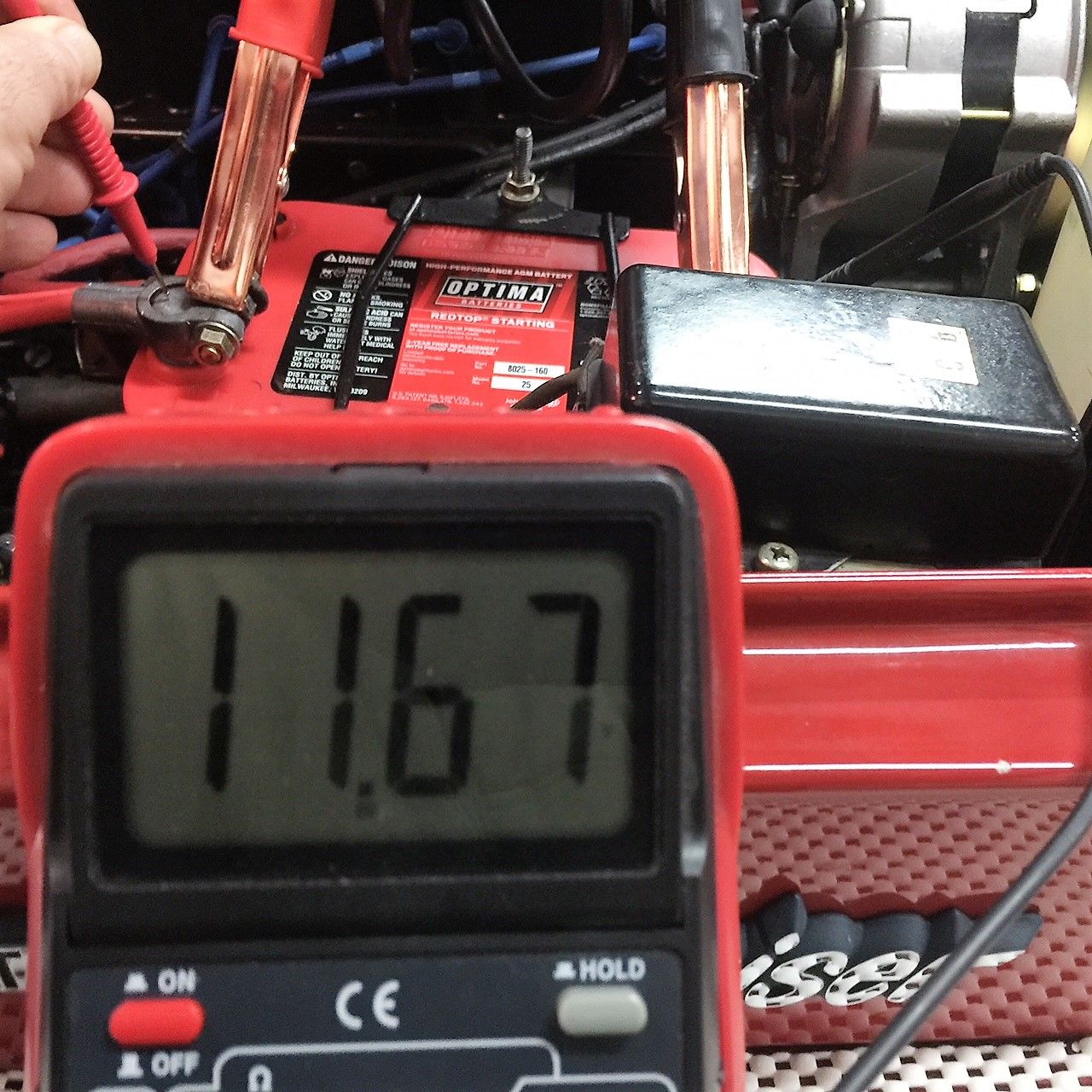

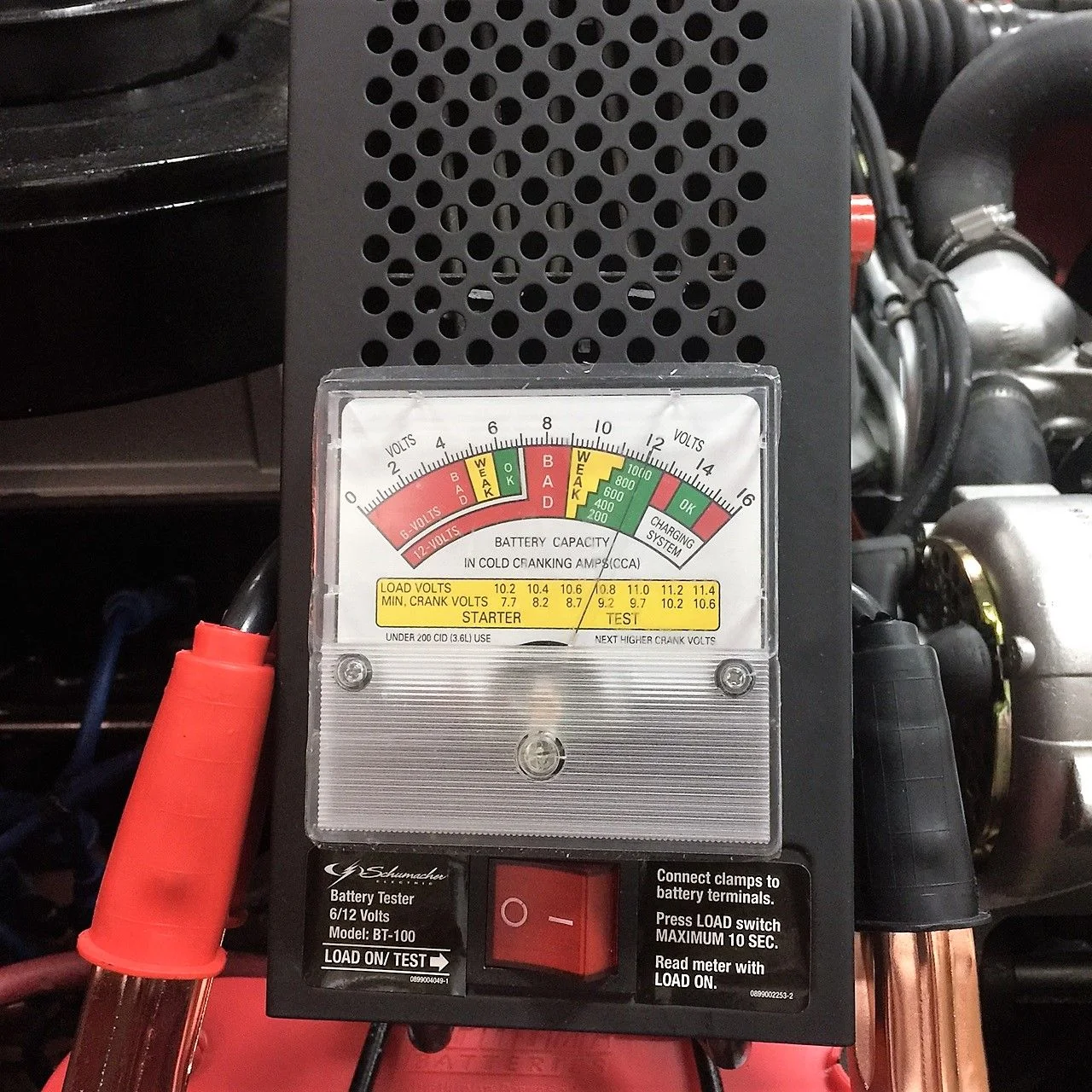

So I decided to help out a friend by sympathetically conducting similar tests on my VR, so here are my test findings.
VR testing Pic 1 engine off Lights Off ~ Batt Voltage

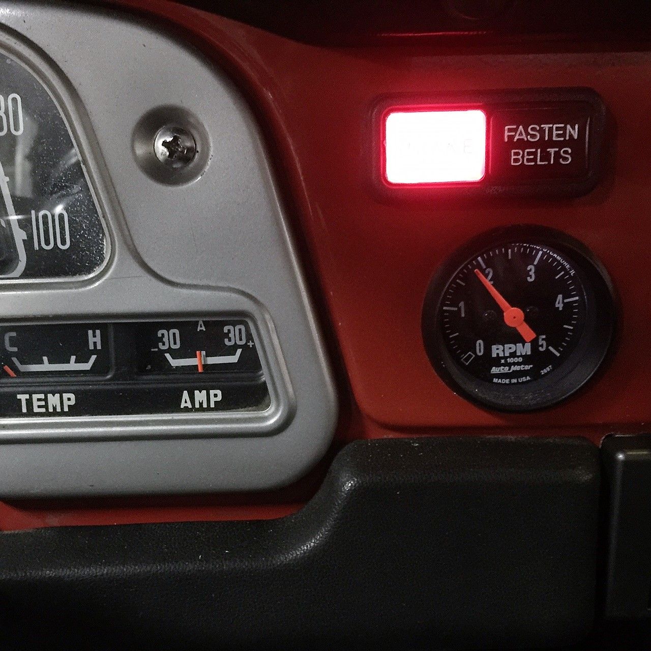

VR testing Pic 4 engine ON at 1800 RPM Lights On
full
Pic 5
full
Pic 6
full

Picture #4 tells the following:
RPM is 1800, Lights are "on", Ammeter shows 0 Amp, Voltage is 11.7V
Conclusion: The alternator is providing the Amps for the lights, ignition etc. However the voltage is too low to put out more juice (Amps) to charge (replenish) the battery. When the voltage is higher, the alternator puts out more Amps and divide it's output between the electrical system and the battery. You said that you tried to adjust the VR and no noticeable change. Hmmmmm.

Cold Beverage says it's the alternator.
1800 RPM, 11.67v off the alternator no lights. 10.2 with lights on same RPM. @ 1200ish RPM I Removed the POS (+) battery cable and the mule took a nose dive choked once and died....Old school test, but I'm pretty sure its my ALT.
I suspect a faulty new alternator as well, can't do anything about it now it will have to wait after my up coming surgery. I'm revved up and pooped out now.
Your conclusion is correct if................ there is voltage on the F terminal on the alternator (from the VR).
If there is no voltage on the F terminal, the alternator acts as if the battery is full and there is no output.
So, no voltage on the F terminal = alternator doesn't charge. Engine dies when + battery is removed. Check out why there is no voltage from the VR to the F terminal on the alternator.
yes voltage on the F terminal on the alternator and the engine dies when + battery is removed = alternator is defective.
