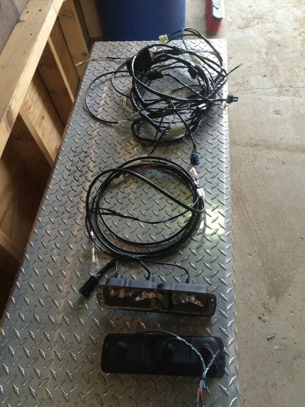

Some of the new kit trickling in.

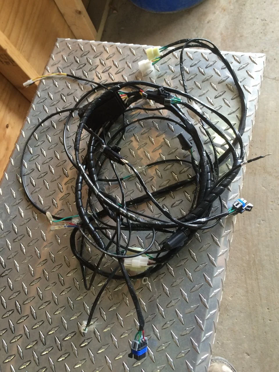

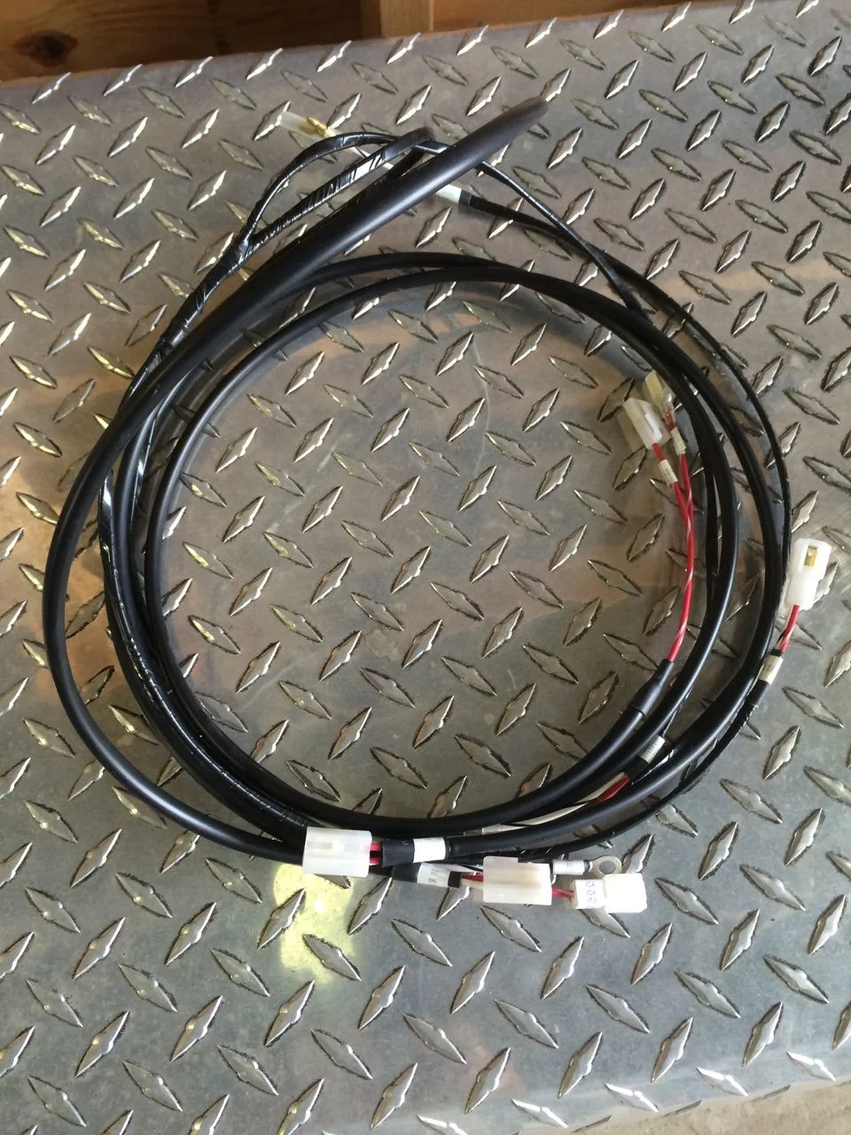

Rear harness and fog light harness made it all the way from "Paint-lick". Thanks for the speedy turn around Mark @Coolerman. Thanks for paying extra attention to the tail lights as well. Everything looks top notch...

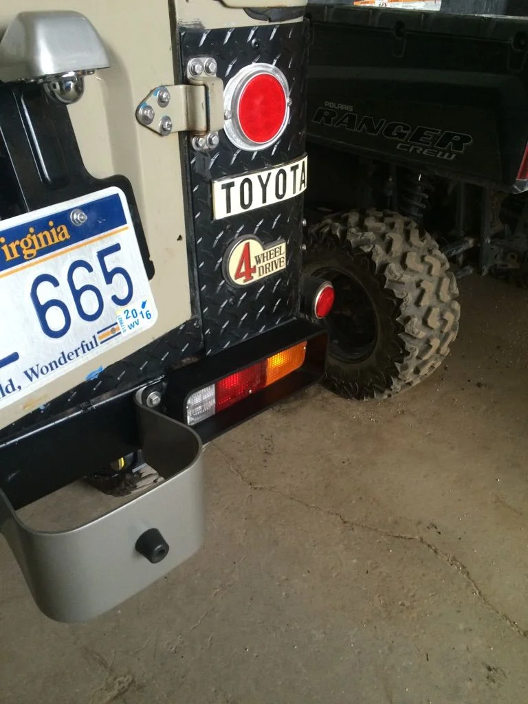

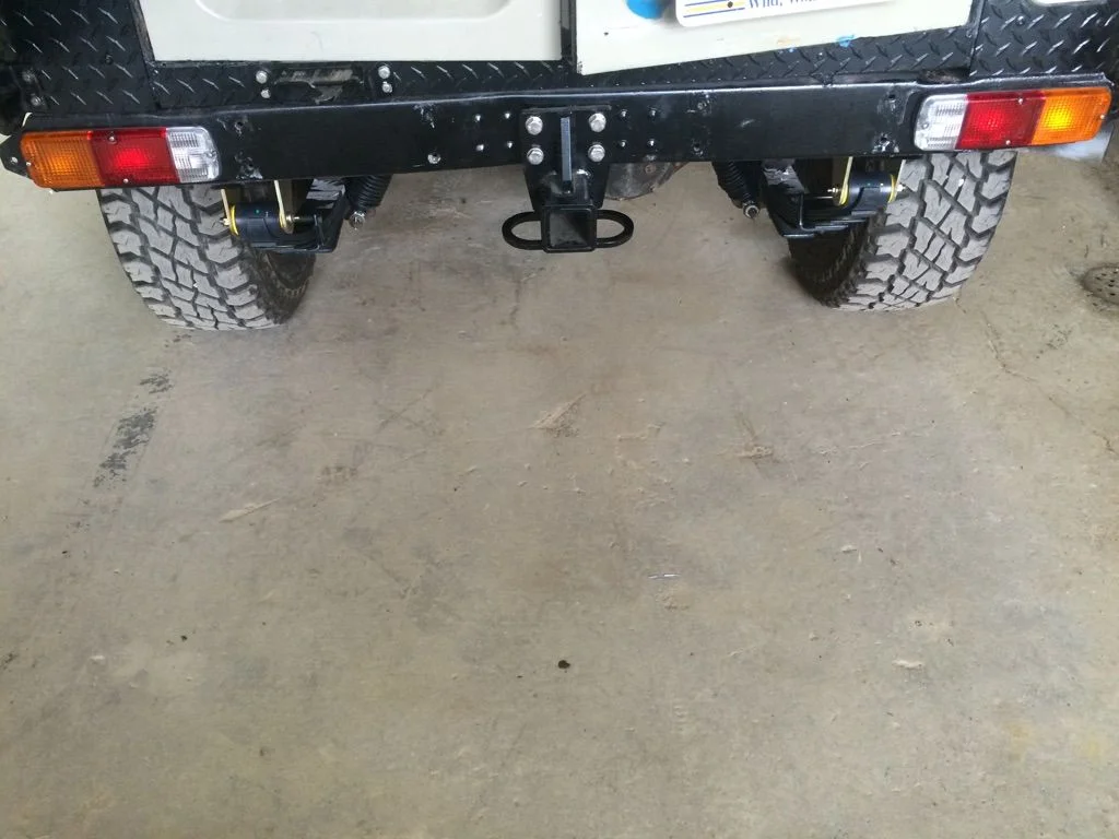

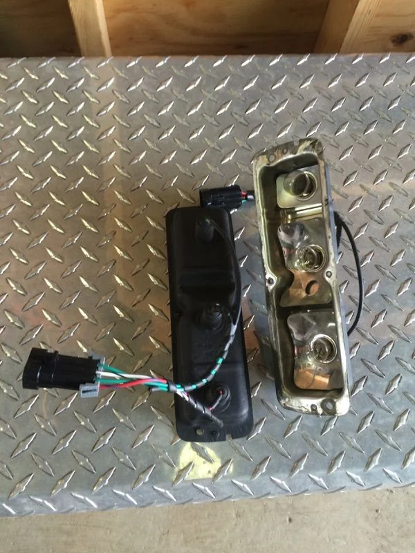

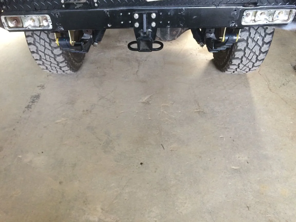

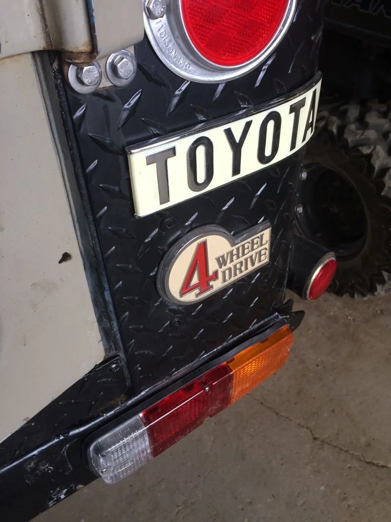

Reinstalled the tail lights. Finished up the passenger side light/bumper/tail light protector w/stainless hardware...
I'll start the rear harness later on WED.

I literally sent a ball of mangled unrecognizable wire down to KY...What came back is "objet d'art"...

You should see his assessment of my harness. Basically if I would have powered it up my rig would have burned the neighborhood to the ground.

Got it..! You are going to like the product. Had him wire in a four pin connector as well for my trailer...1st class!!

I was afraid to power it up when I first got it! After I removed all the "mystery" wiring, and the hacks, then un-taped it, then replaced all the rusted fuses, I was finally confident it would power up without smoking itself! It will be finished this weekend!
