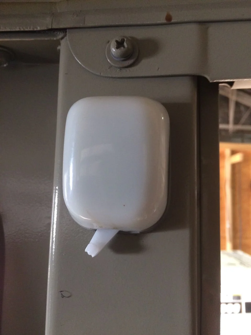

Installing the hard top and forgetting to plug in the "previously working before disassembly" interior light, is just one of those little reminders... :eggface:

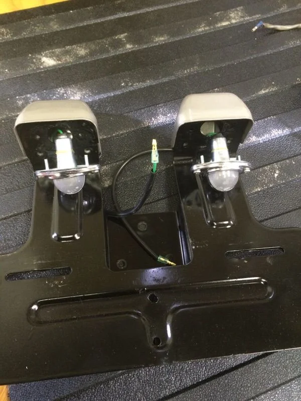

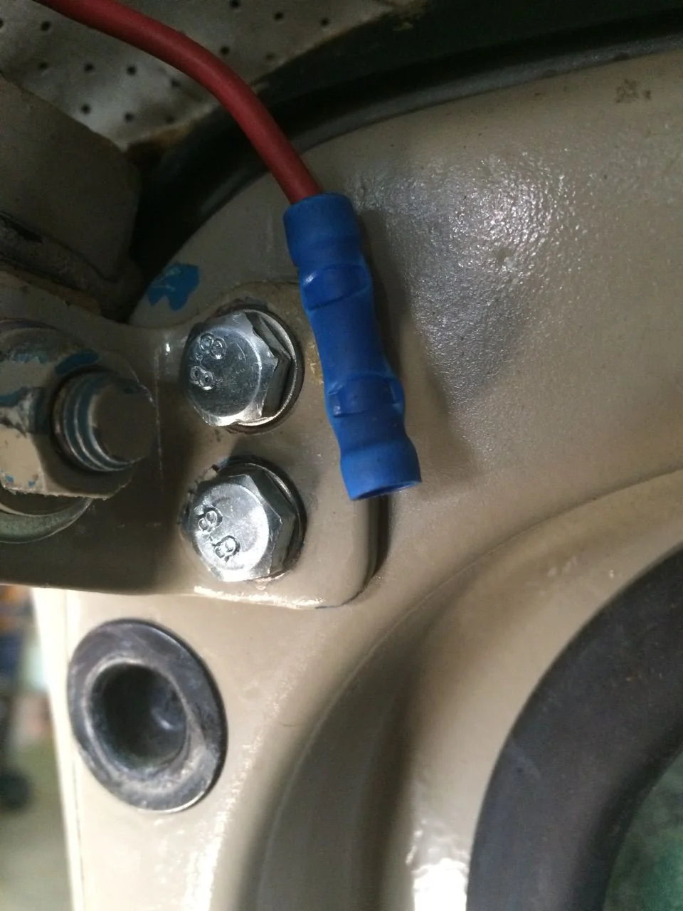

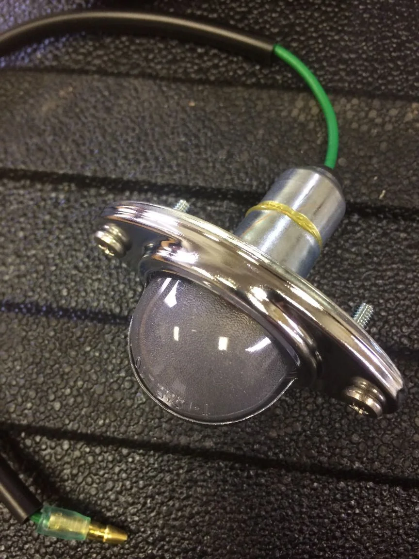

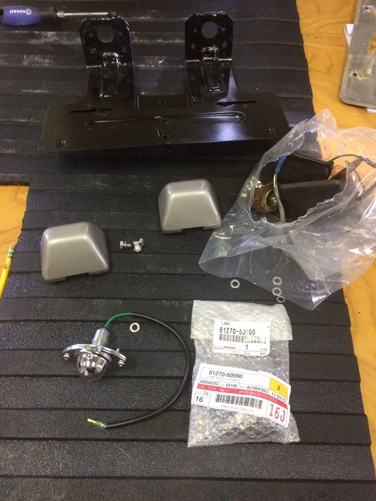

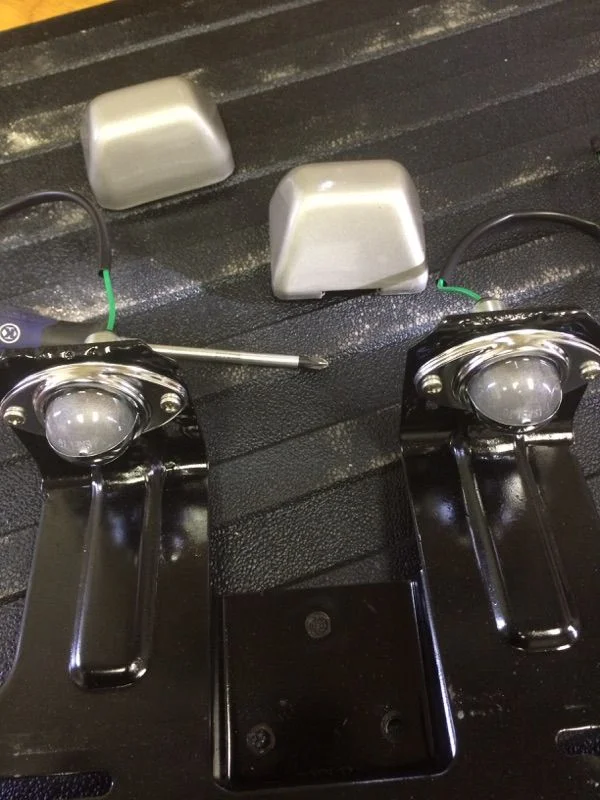

All the parts (minus hardware) for the rear license plate bracket re-hab arrived. I just mocked everything up for fit and finish. Bulb assemblies were backward during the "photo op". Just couldn't save the old hardware. Saved as much of the original material as possible. It's all on the "spares" shelf...

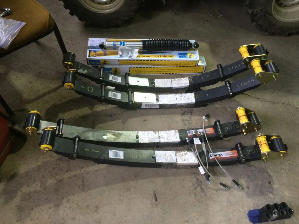

Going to terminate, with extreme prejudice, the old leaf spring pack tomorrow.
zero hr = 0900. Coffee pot is set and I have a 5 hour chaser if it looks like a protracted engagement.

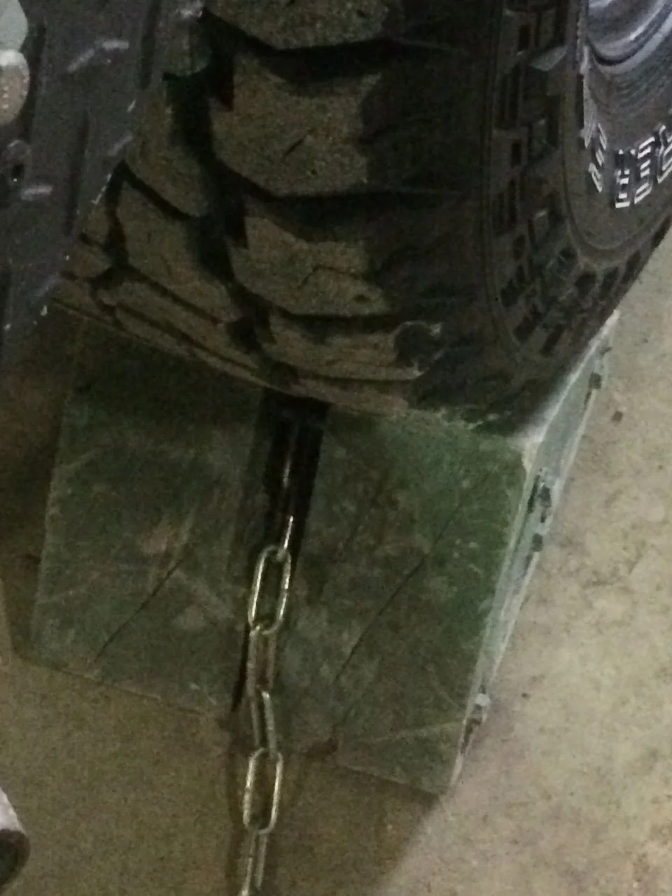

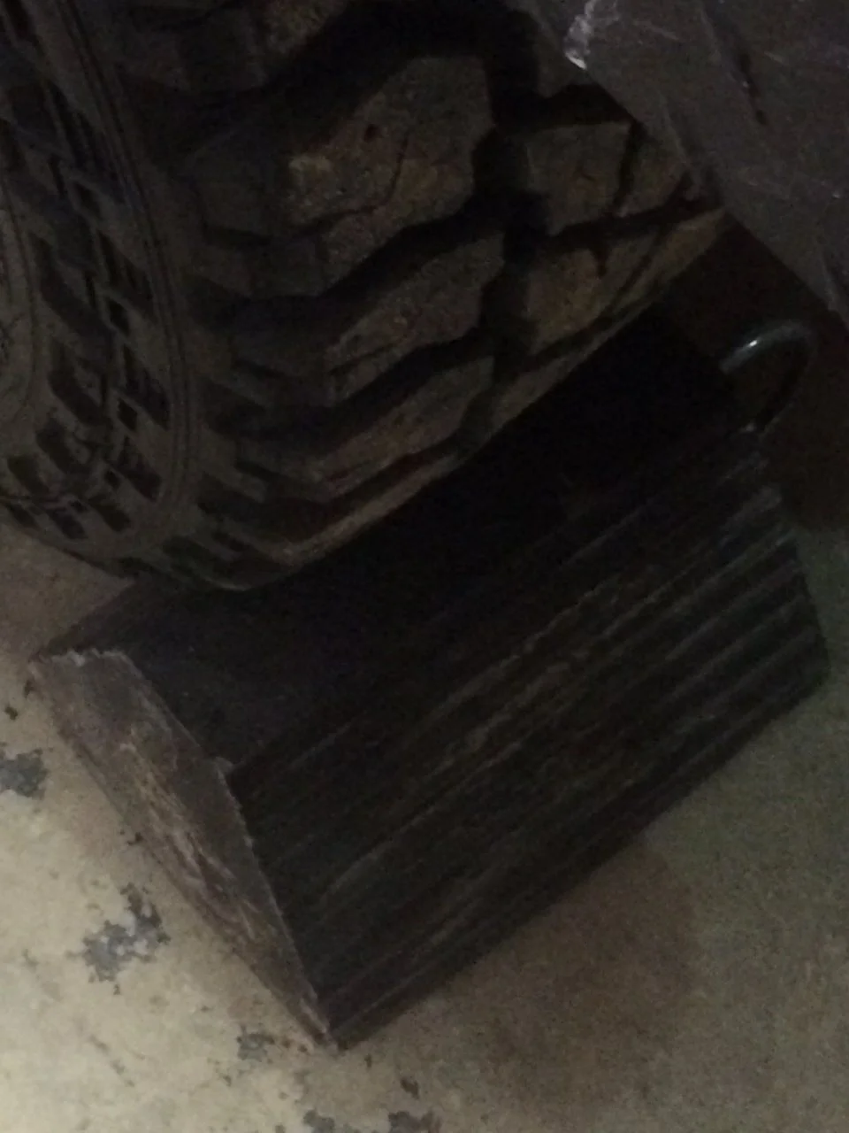

Seizing on the opportunity to sleep an extra hour this AM, I did..Late start followed by running "up-town" to have breakfast with an old friend. He's a former parachute rigger so he isn't allowed within 500 yards of a school zone. Had to take the long way IOT avoid any confusion regarding the stipulations of his parole. Later, at the diner on the other side of the county, we ran into another old acquaintance. You can see where this is going.. So, after a stack of hot cakes a black coffee and a "BS" session lasting well into the "noon hour", I finally started on the spring swap. Owing my dashing good looks and youthful appearance to a liberal dose of safety, I started by securing the rear wheels with some recently acquired wheel chocks I found under a "10T dump truck" someone forgot to secure...:meh: (No wheel chocks were harmed during the leaf pack installation. All wheel chocks were immediately returned to their rightful resting spot(s) upon completion and are now comfortably residing, on a farm in Iowa)
1 Set of wheel chocks. Three sets of "Jack stands" two sets fer' using, one set "just because".
1. Stands in place.
2. Chocks in place.
3. PB set and in gear.....

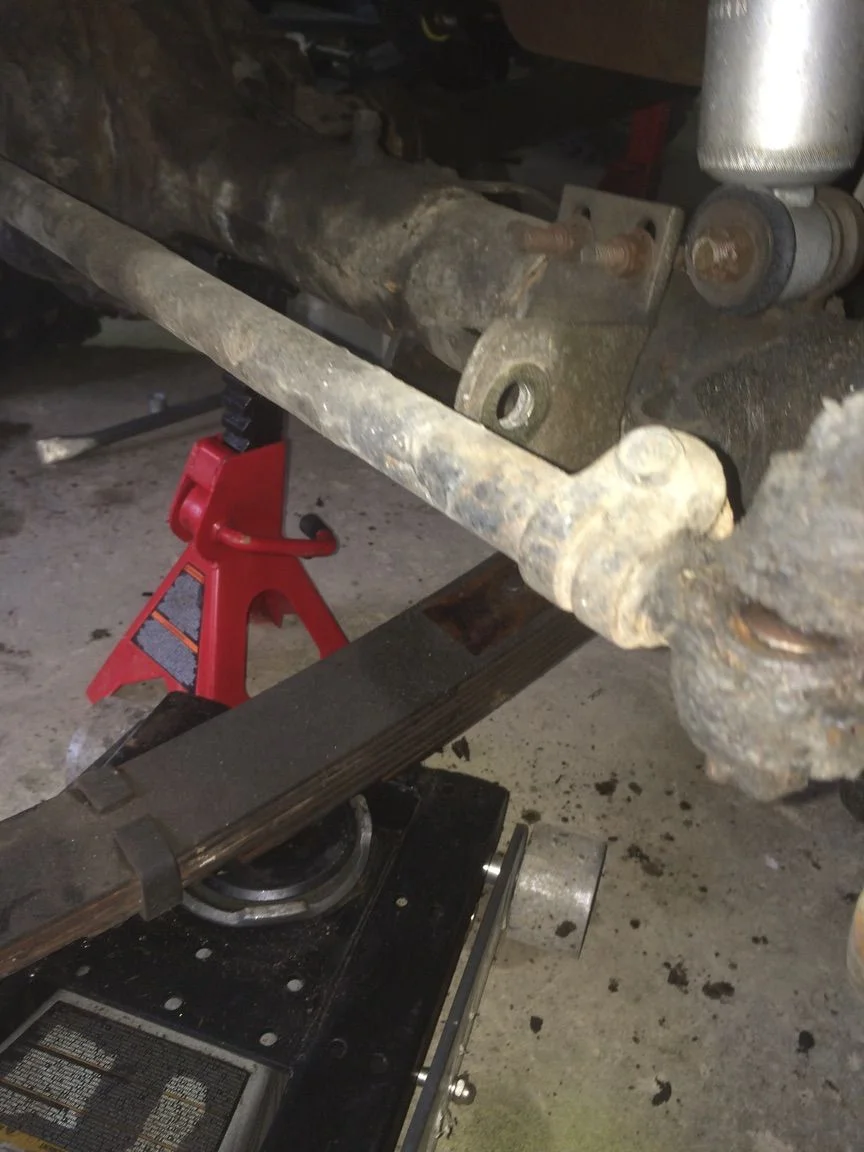

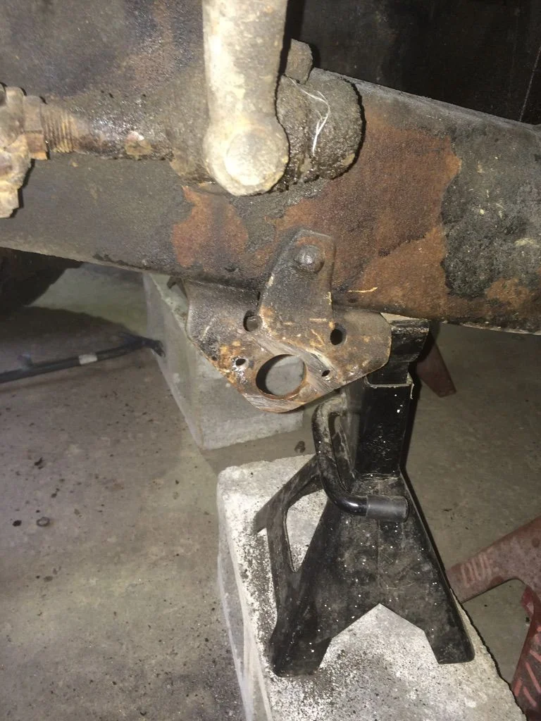

So far so good. Great breakfast, safety precautions are in place. Decided the passenger side front was as good a place to start as any.
1.Started by loosening the (all) fasteners. Spring perch, shackles and u-bolts.

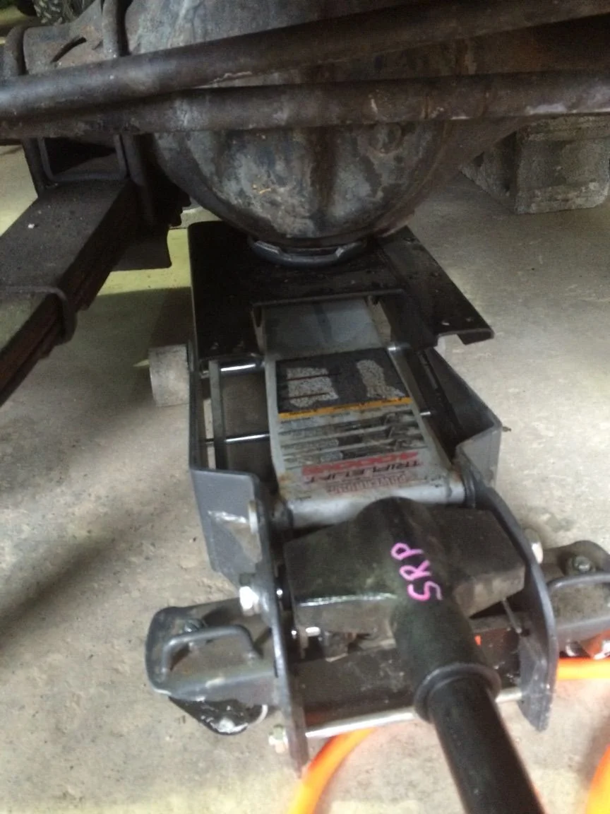

2. Floor jack set under the front Diff.
3. Off with the tires.

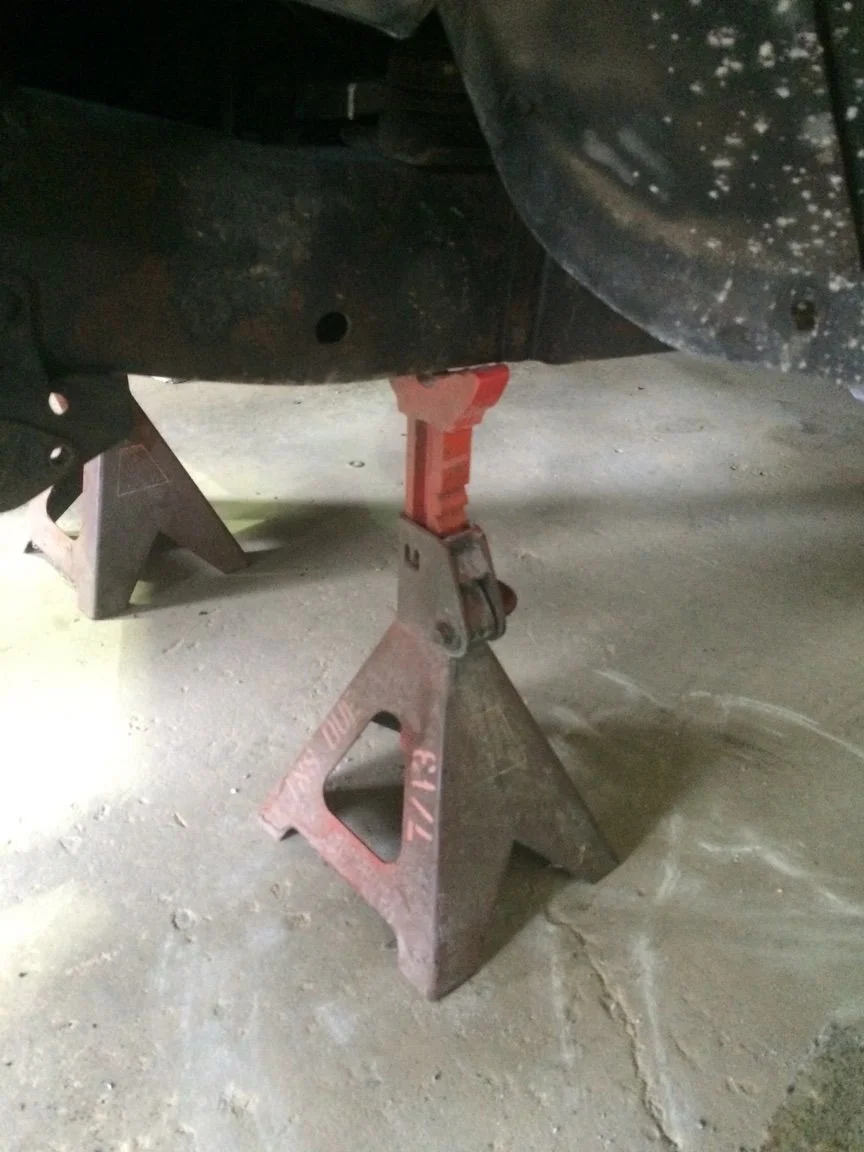

4. Jack stands under axle

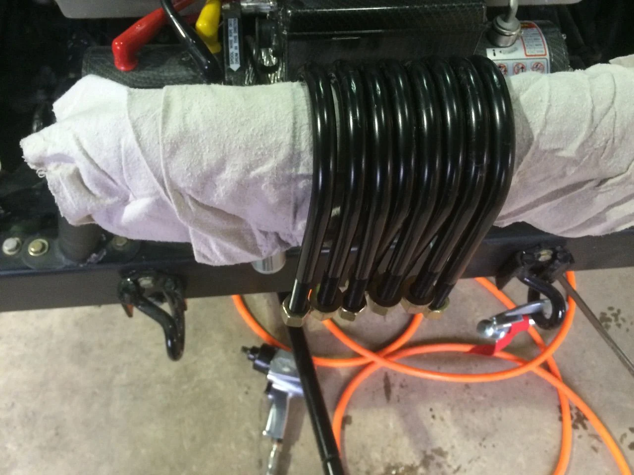

5. Remove U-bolts w/air gun
6. Brace axle with jack stand, remove floor jack.
Now this is where I get to insert a PO good news story. Liberal amount of Nevver-Seez aided in the removal of all the hardware....Shout out to the man from Idaho!!
6. Place floor jack under leaf pack.
7. Remove front shackle.
8. Lower jack w/ leaf pack.
9. Couple gentle taps on the spring perch. Leaf pack exits without much ado..

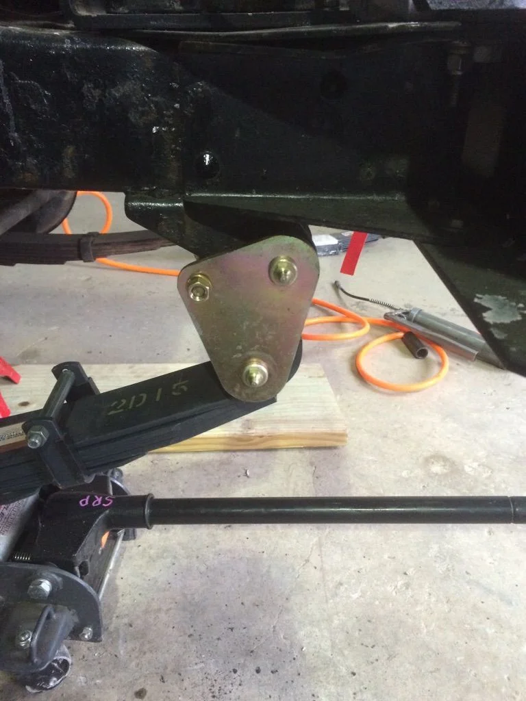

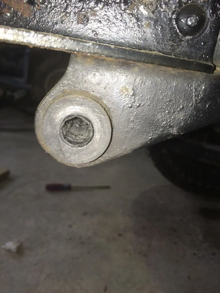

The bushing removal was anti-climactic. I used a large flat tip screwdriver and a rubber mallet to coax the bushing from the shackle mount.
1. Tapped the shoulder a few times to get it moving then pulled the first bushing out with pliers.
2. Used a brass punch inserted into the mount and tapped out the remaining bushing.
3. Tapped a few times on the spring perch pin. Front of leaf pack was resting on the floor jack (low).
4. Perch pin came out with nary a struggle...
5. Lowered entire leaf pack.
Only pic is of the recently vacated spring perch. I took better pics of the drivers side and I'll post those up during installation phase.

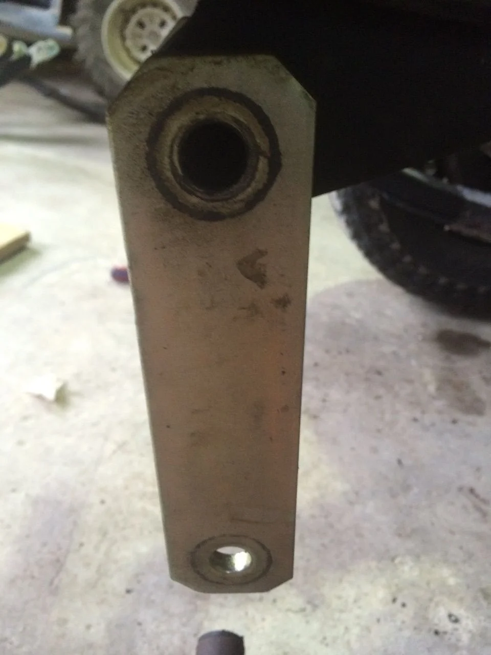

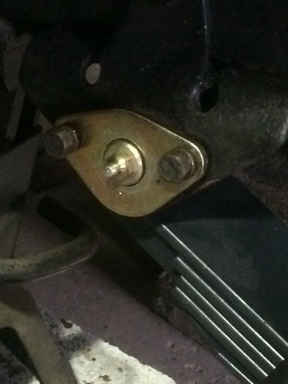

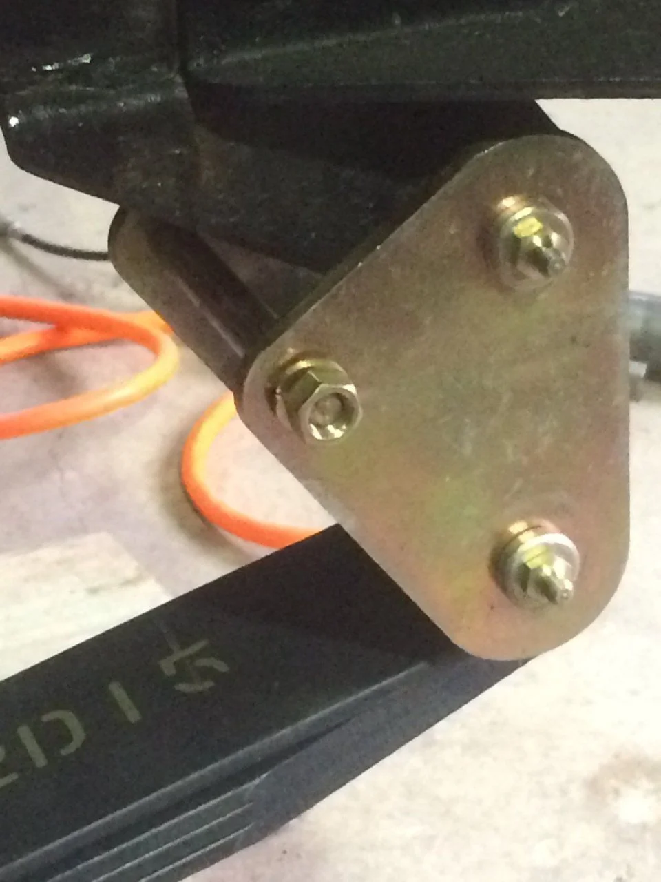

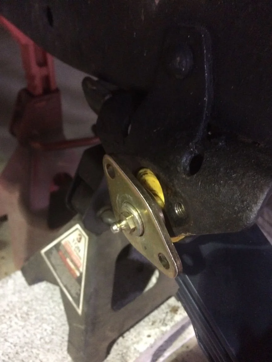

I'll post up the blow by blow re-installation pics of the follow-on mission (drivers side)..Pics below just show the front ant-inversion shackle installed and the spring perch pin installed.
It was at this point I had to make an unscheduled "head call"...Note the last pic..I think I figured out how I managed to get Anti-Seez on :censor::censor::censor::censor:
