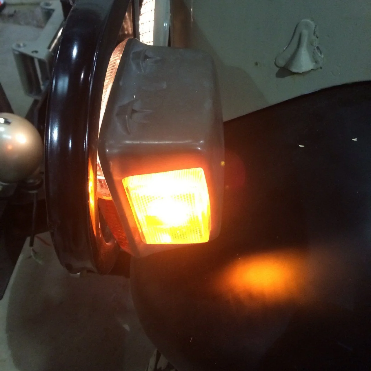

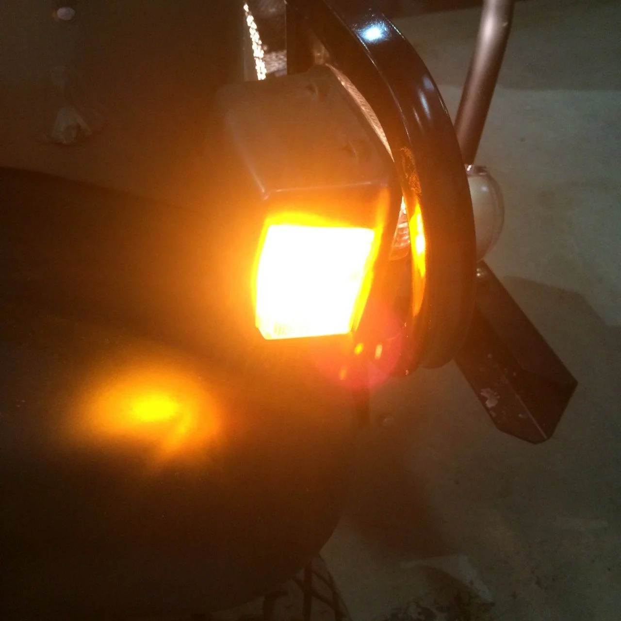

Working out some of the Gremlins..Front harness is still in respectable condition. Rear? Not so much. Still running traditional bulbs. Would like to move toward LCD in the future. For now, I'll dance with what I brung.

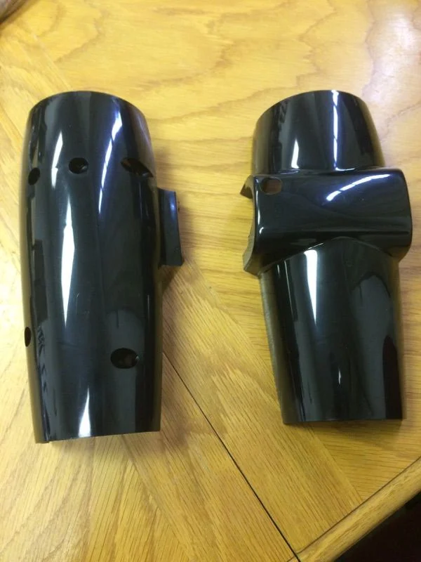

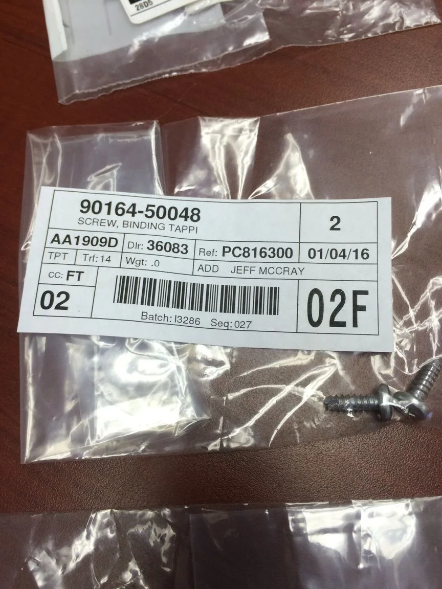

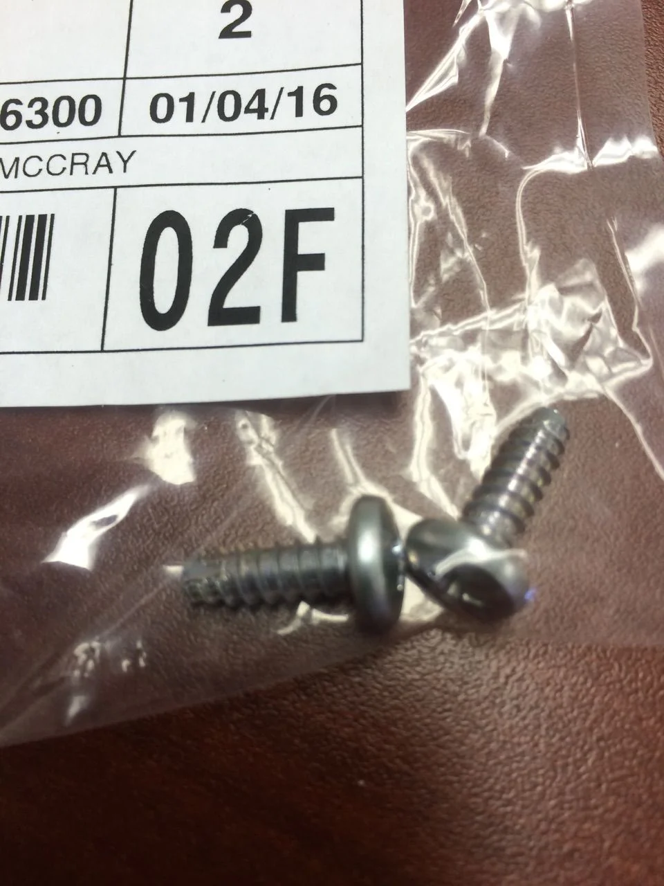

Ordered a steering wheel cover a few weeks ago. When it arrived the "Mounting" hardware from the "old"column would not work..At some point Toyota stopped encapsulating a threaded ferule to attach the upper and lower halves of the cover. New screws, sent free of charge from "Griffin Motor Sports" (no affiliation) pictured below with applicable part numbers if your updating your column cover.

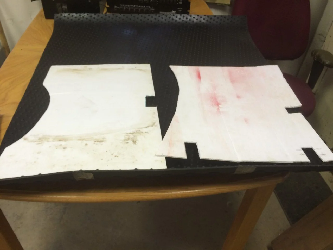

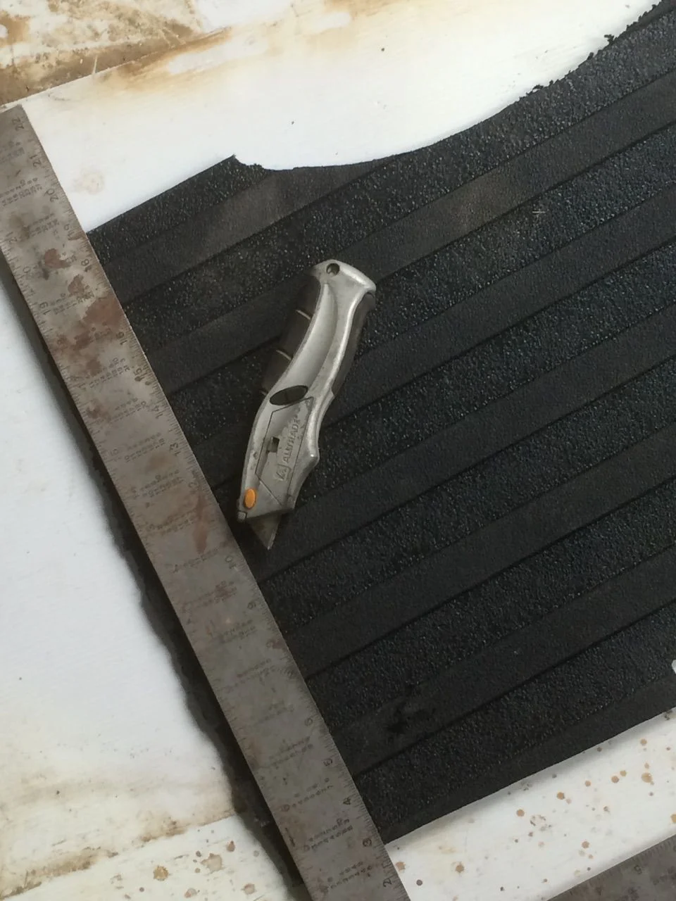

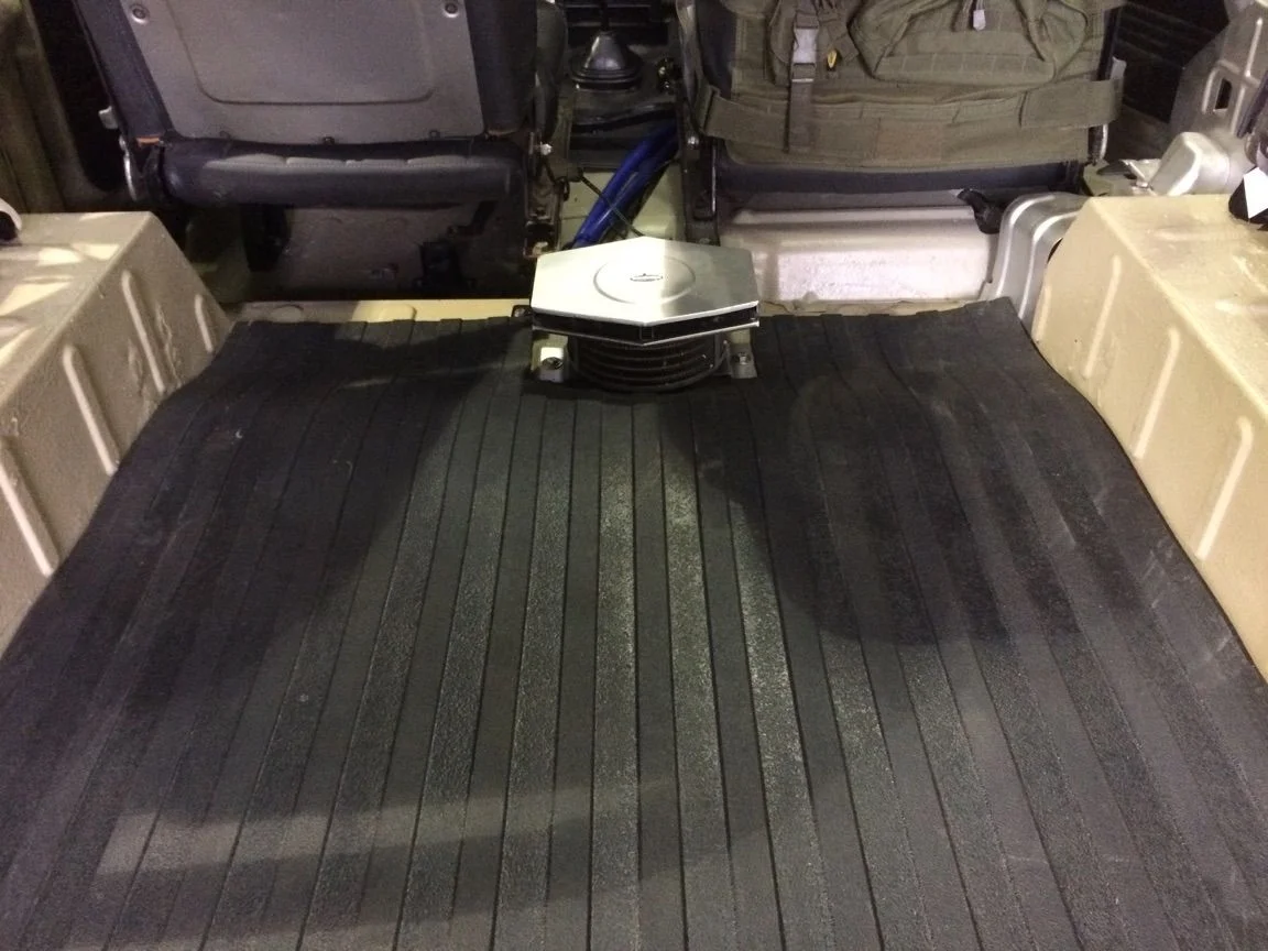

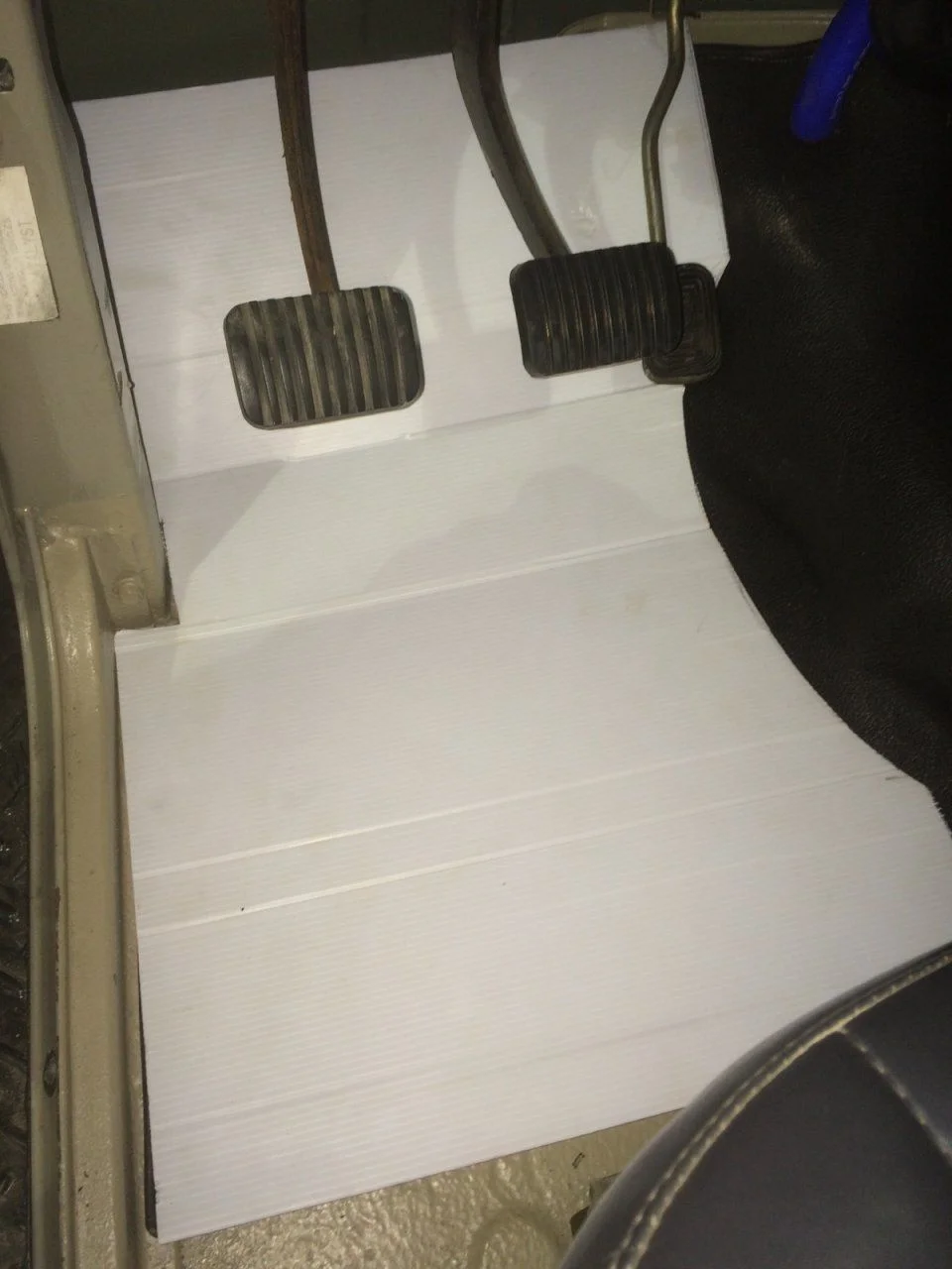

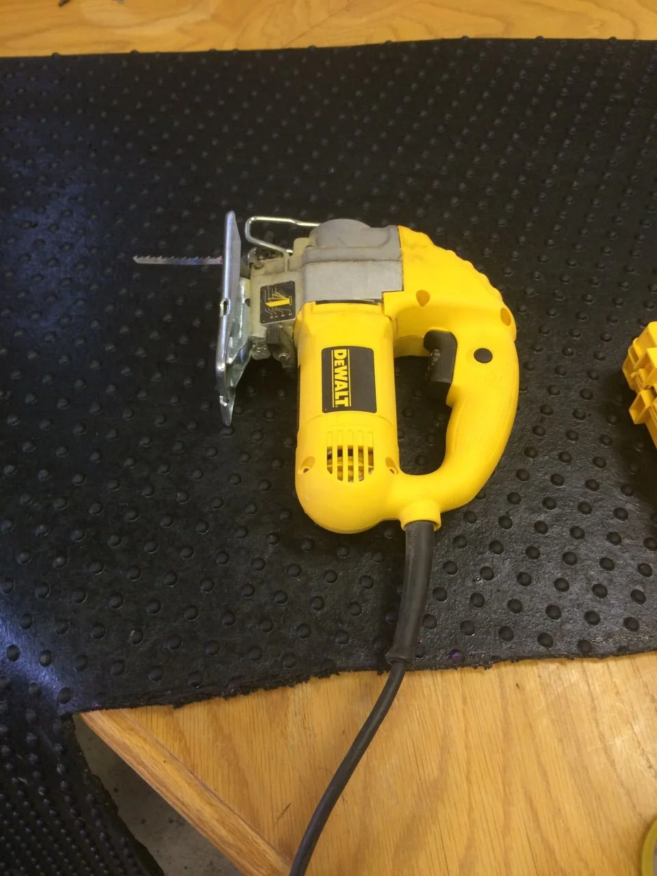

Started the front mat fab. Rough cut with a jigsaw. Left a little extra IOT trim with a straight edge to a finish cut..

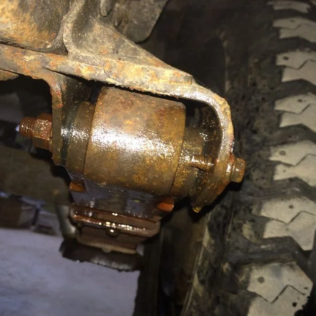

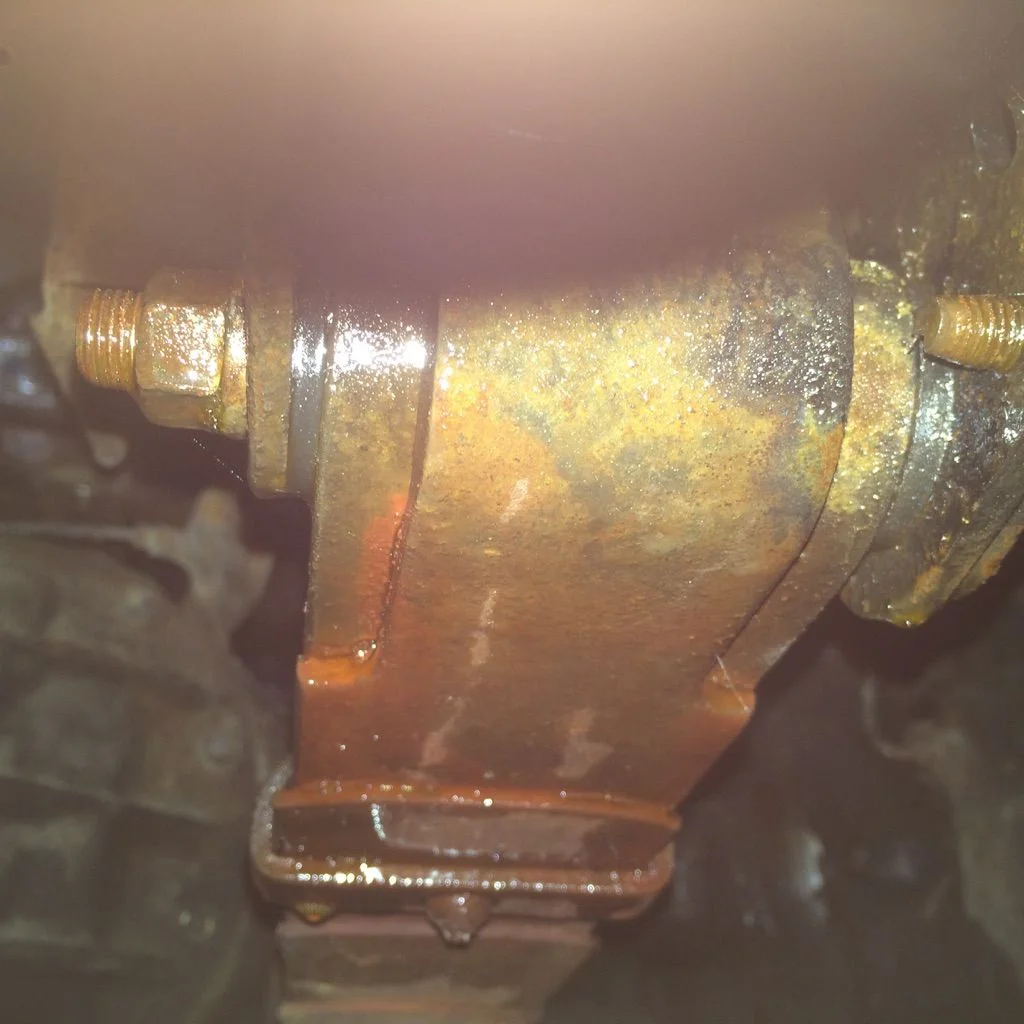

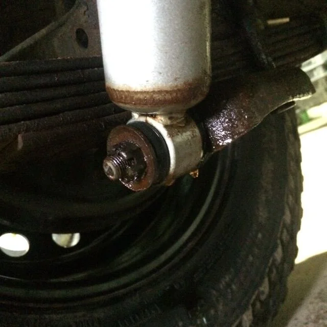

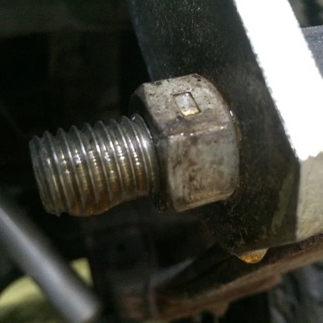

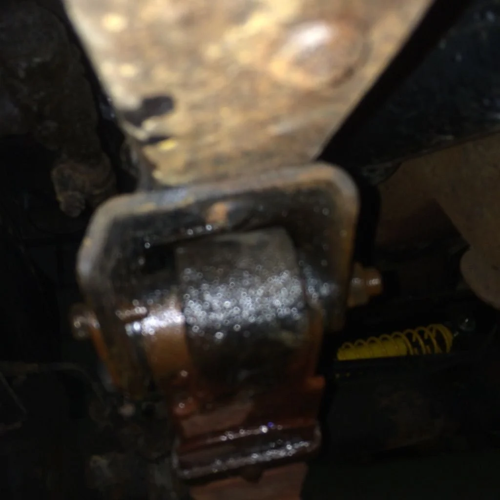

Hitting the perches, shackles and shock mounts one last time with PB. Threads all look pretty good at this point after the third application.
"Chuckle...:lol:" Wanted to hit everything at least three times before executing..From what I could tell, before a liberal dose of PB, everything was pretty rusted. Owing to no particular rush, a 6 day wait on the lift, and thirty years of rehearse, rehearse, rehearse..Execute, I'm just marking time now...
Admittedly, the shocks and shackles are good to go now. The perches, I believe, will give up the springs, bolts and nuts w/out further pre-execution persuasion.
BTW..That parking brake is shaping up nicely..

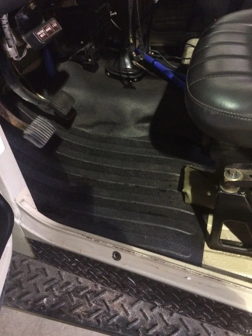

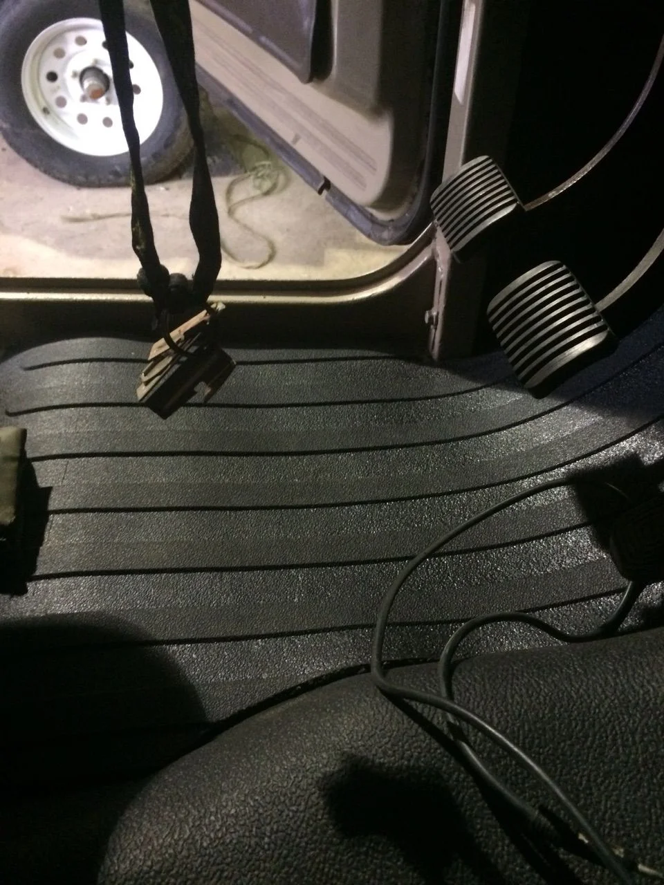

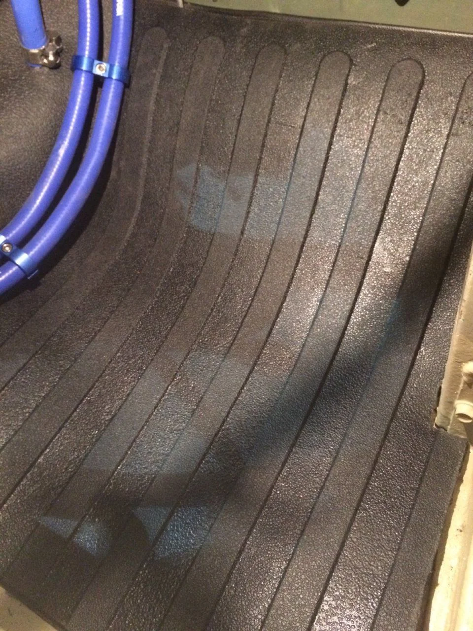

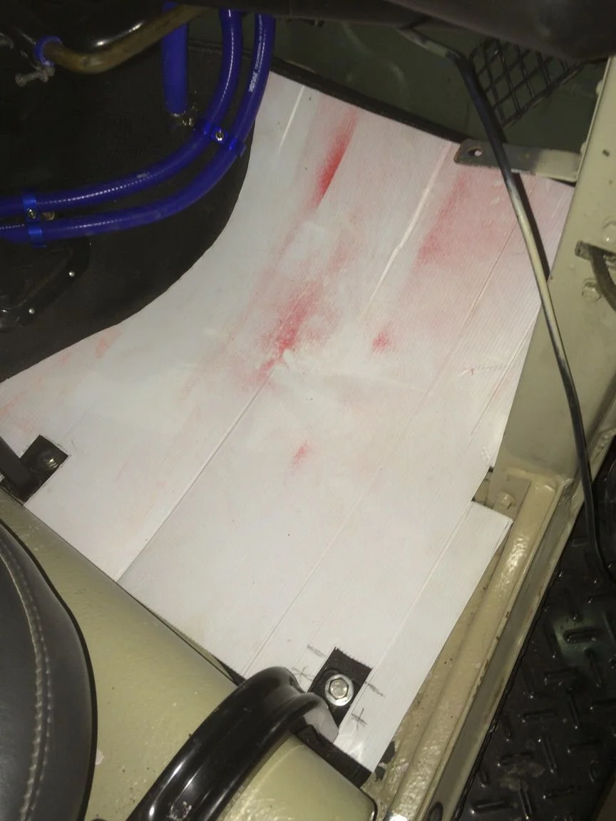

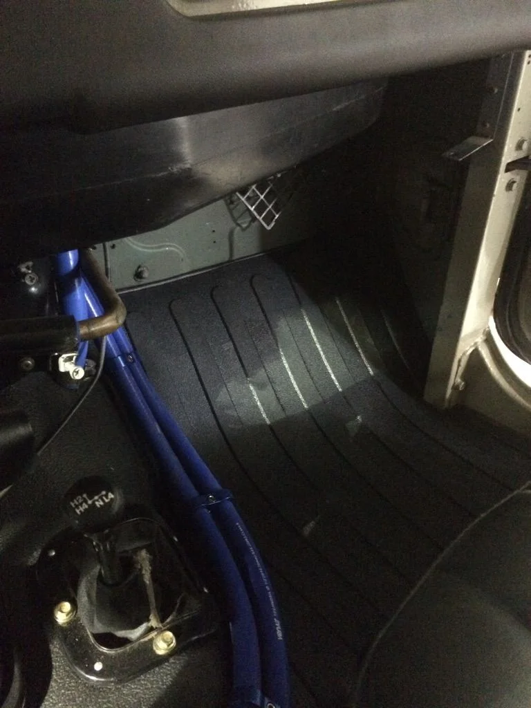

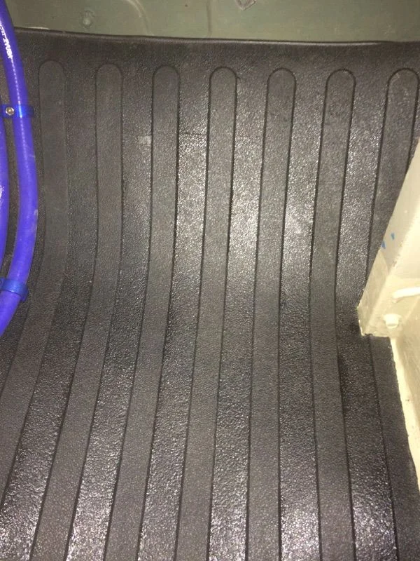

Passenger side front mat from template to final fit. Last pic is the tub for reference...

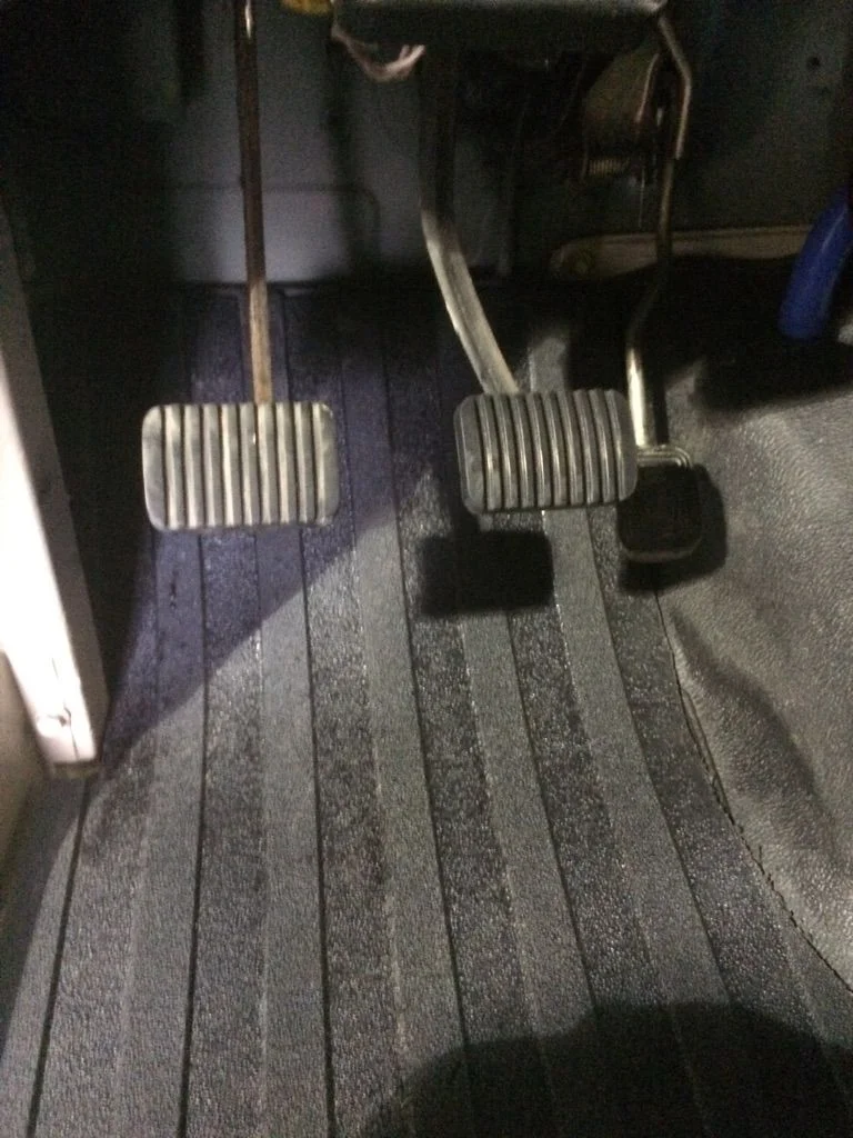

Drivers side mat installed concept to execution.
I was wondering when someone would point that out.
No, I was serious..That is very clean work...I'll be taking a stab at that soon enough too. Thought about rear disc conversion. Hate given' up the parking brake.
