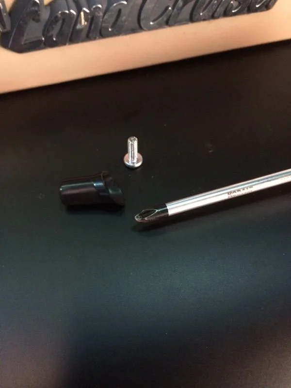

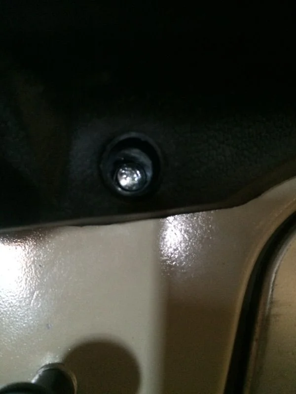

New dash-pad inserts and screws added..

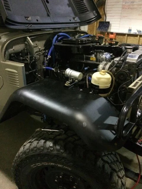

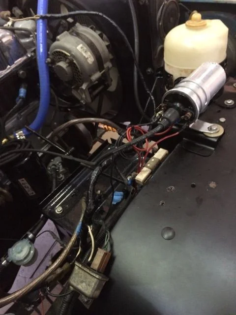

Passenger fender/apron loosely mounted IOT adjust as needed. Passenger turn signal mounted as well.

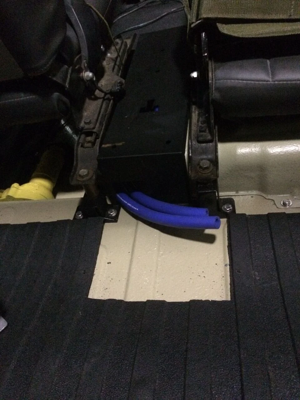

Cutting my rear heater hose to length. I still need to trim the rear mat for final installation of the housing. Still looking for a good solid used core.

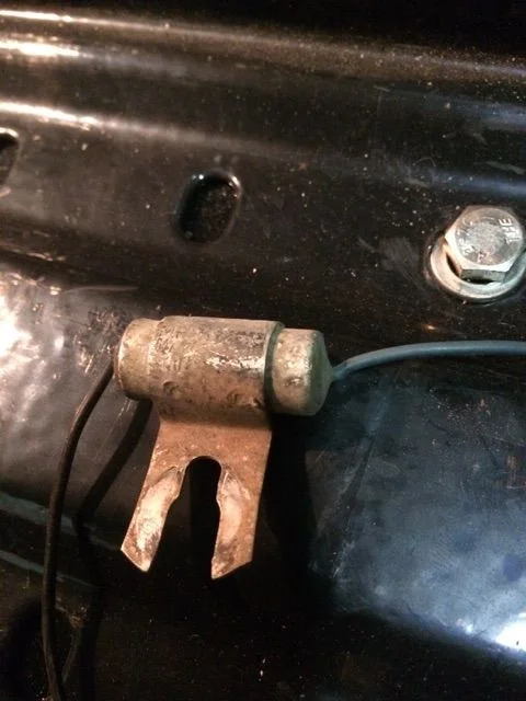

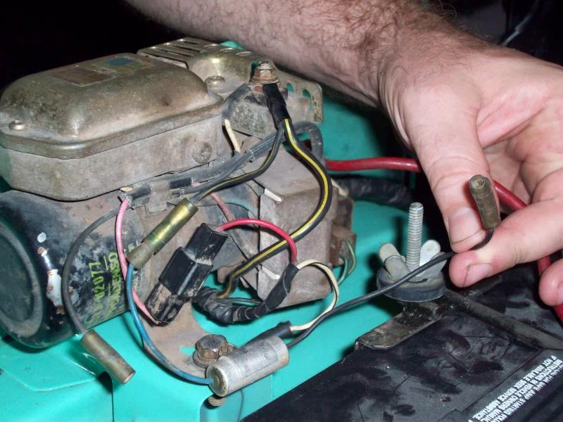

Mystery part #2 solved. Thanks @JohnnyC and @White Stripe for your help. Resistor is/was for a radio. I don't have a radio so this goes in the spare/obsolete parts can with the "Flux capacitor".
2nd photo boosted from @ccasteel for reference.

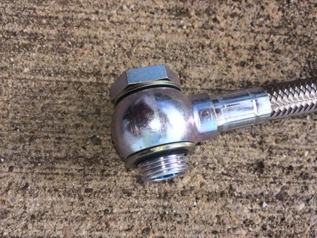

If I can "git roun to it" this week I am going to finally install the Transmission to Transfer Case Bypass Hose from @shipmag. Installing as a preventive maintenance measure at this point. I bought this hose last spring but was OBE with other "issues". Anticipating firing the ole' mule up in the near future. So, I want to install the hose beforehand. Should be a straight forward installation.

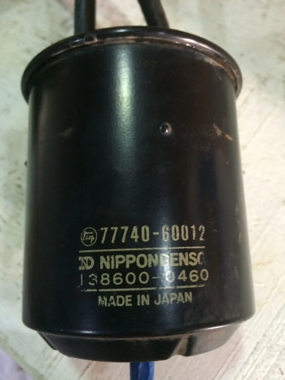

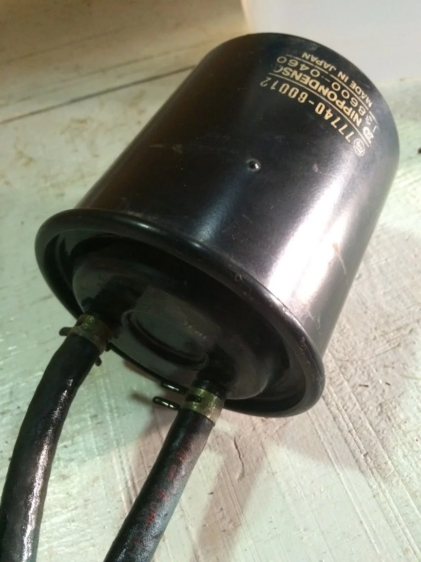

:banana: Cleaned up the charcoal canister (Just because). Used a little "Go-Jo" and a soft cloth...I'll hit it with an old soft cleaning brush later this PM.

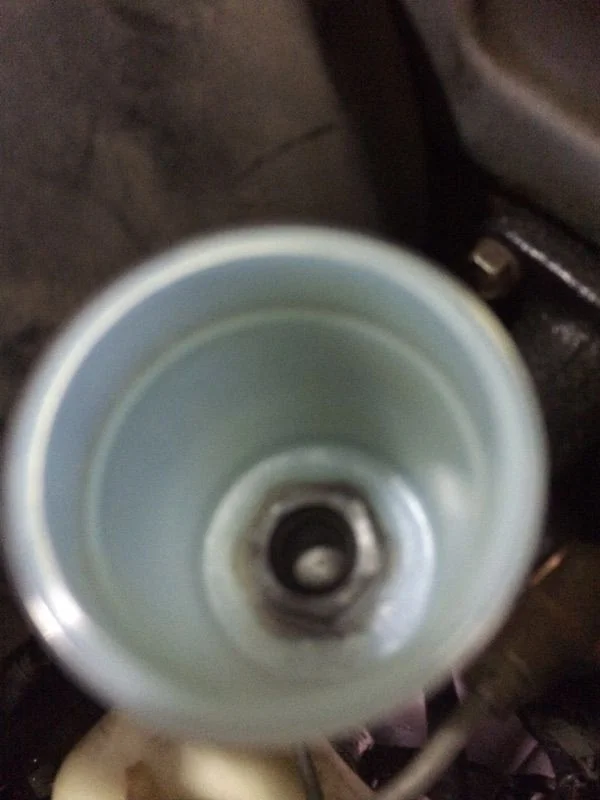

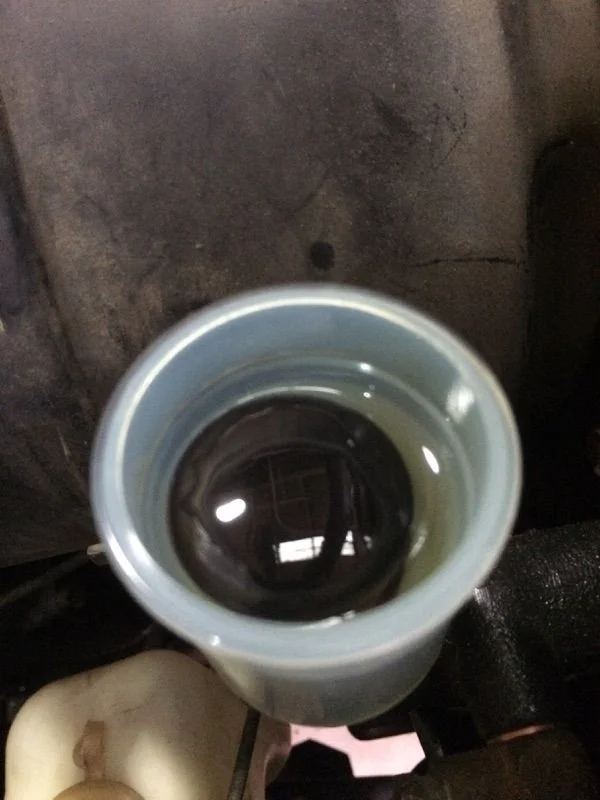

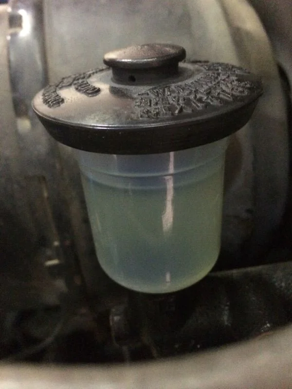

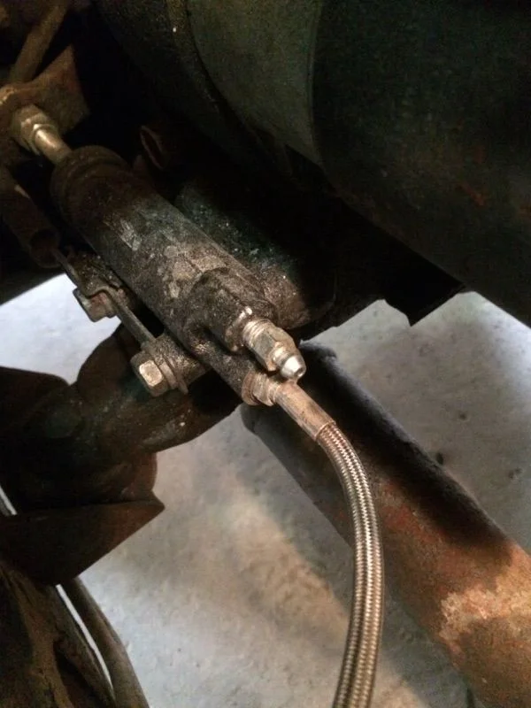

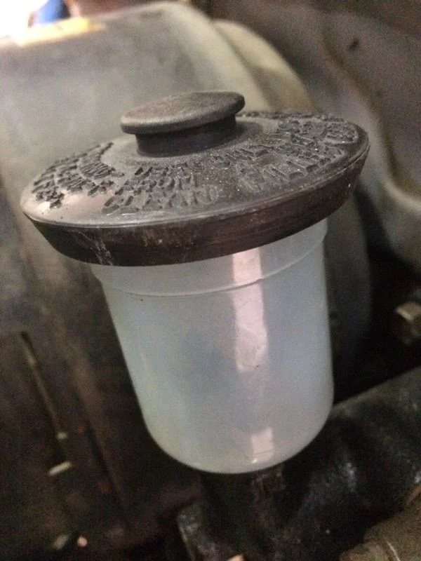

Prepping the slave cylinder and bowl for bleeding. I gravity bled the system as I was the only muldune I could talk into assisting...
System is full and no leaks.

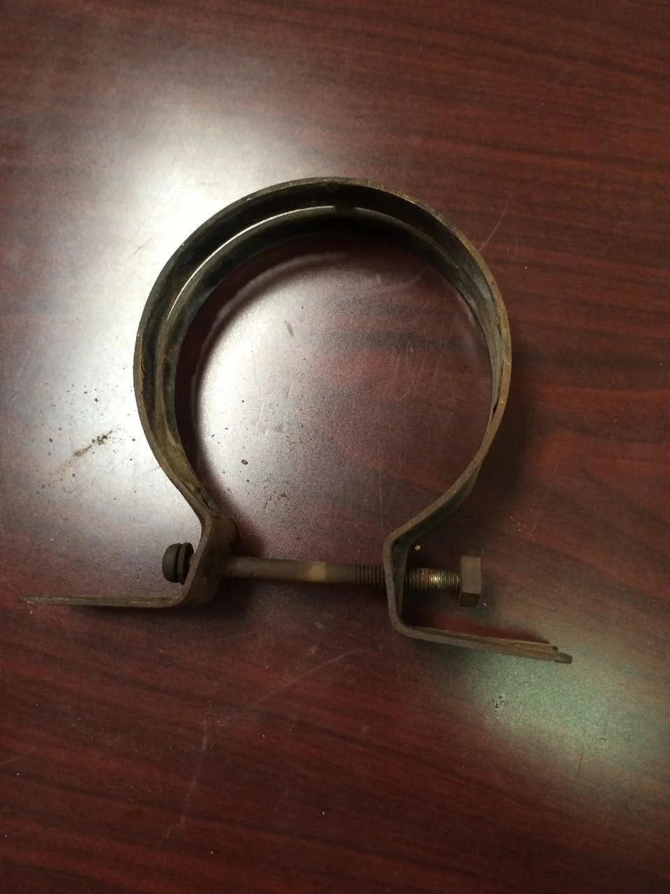

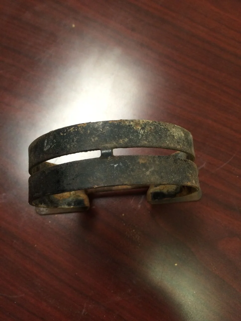

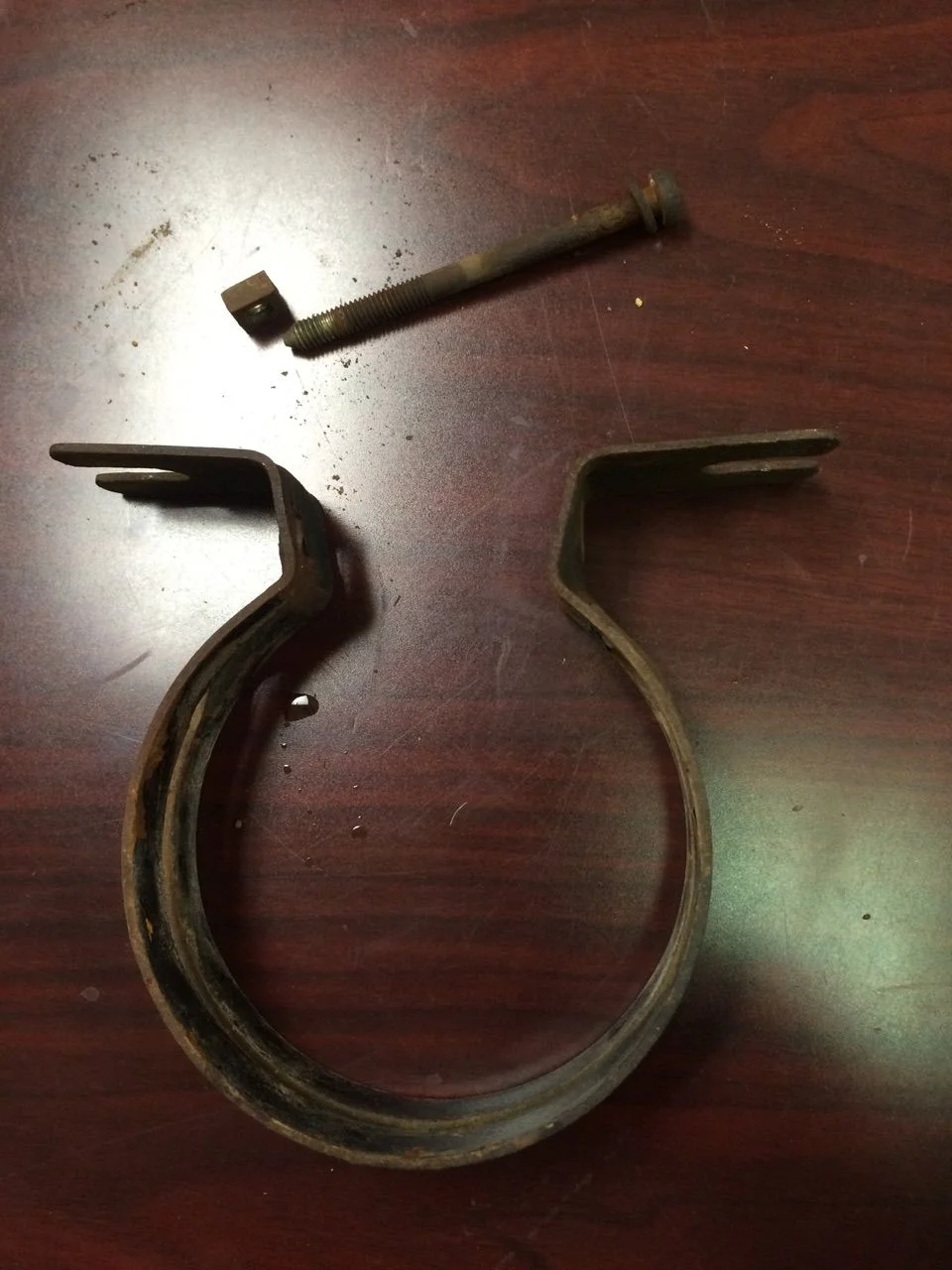

:banana::banana: Charcoal canister bracket needs work. I'll run it through the blasting cabinet in the AM.

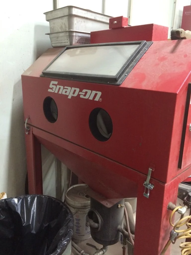

Cabinet type?
Yes, its a medium size cabinet, foot operated. I don't recall the brand name. I'll post up a pic later today.
What kind of blaster are you using for small stuff?
Snap-On cabinet makes short work of most items. When time permitted I used this cabinet on a lot of the smaller items on the mule.

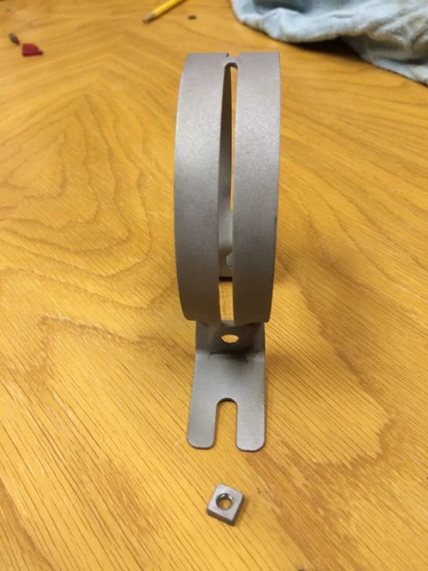

:banana:Charcoal bracket cleaned up nicely. I hit it with a coat of primer earlier and I'll paint it in the AM. Mail room was closed today so the post-man did not come through with the remaining stainless clamps. Before / after.
Looking good bro, you definitely are doing some clean looking work. I can't wait to see this rig on the road!
