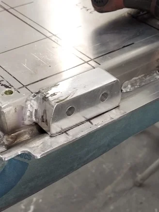

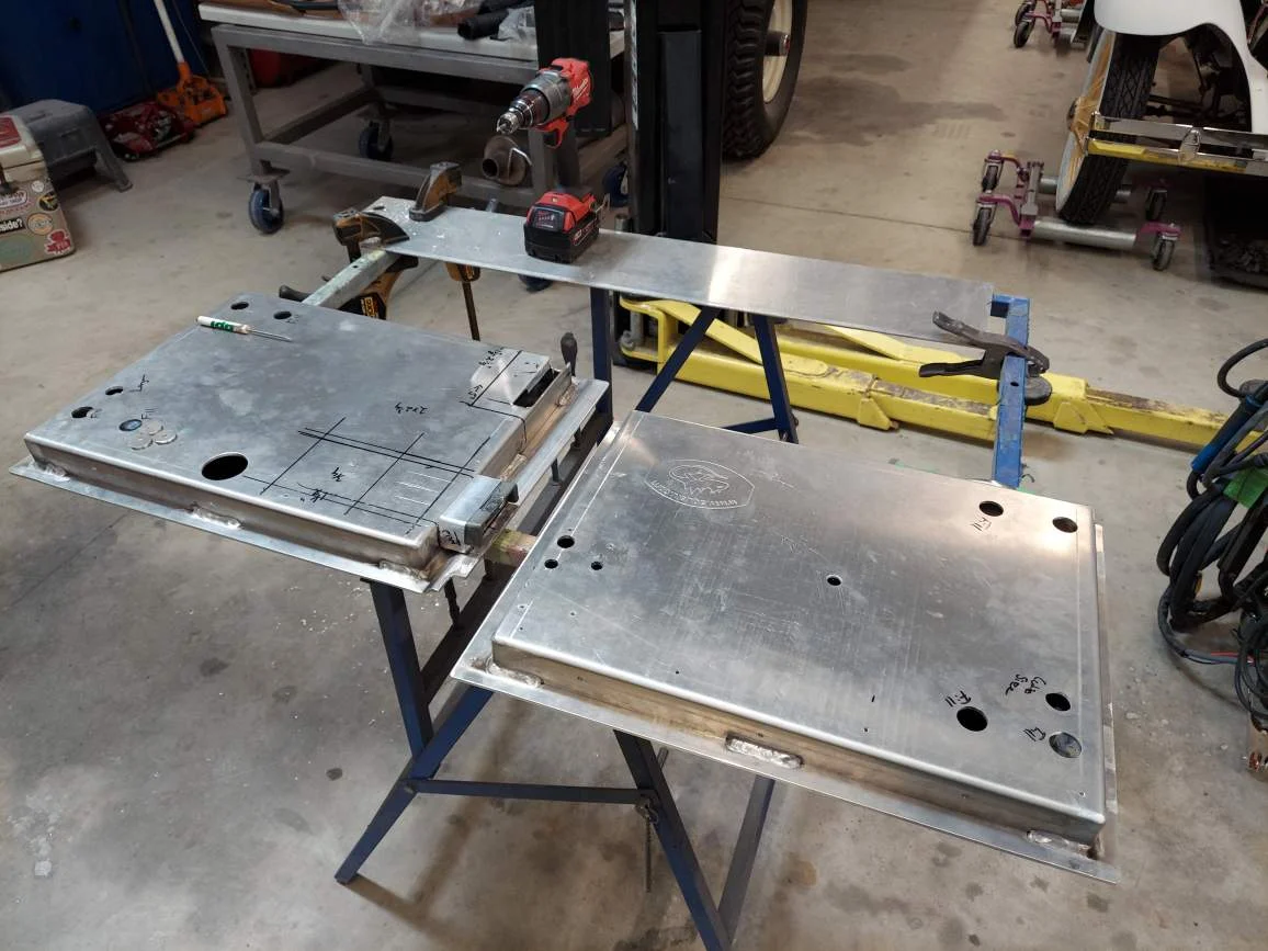

Current ops: You can see the rear ambi 1/2 doors taking shape. Keeping an OE-ish look with the hinges, handle and lock. Mods to the frames and top door hinge(s) also. I think it would have been easier, philosophically speaking, to use the fold down tailgate or 1/2 doors with the roll up rear window. Yup. Sometimes my little Infantry head doesn’t process rational thought when dealing with the Mule. :hmm: You don’t see the Ambi door option in the wild very often soooo hey we got that going for us.

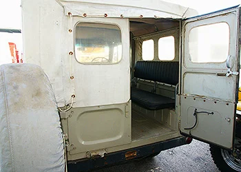

I think the soft ambulance door setup will be pretty cool. However how does the upper part of the door not flop around?
The factory rear soft doors have a latch that holds the sides together about midway up the upper door section. They are fairly rigid as well. I assume the aftermarket doors would have some similar latch. Pic from SOR.

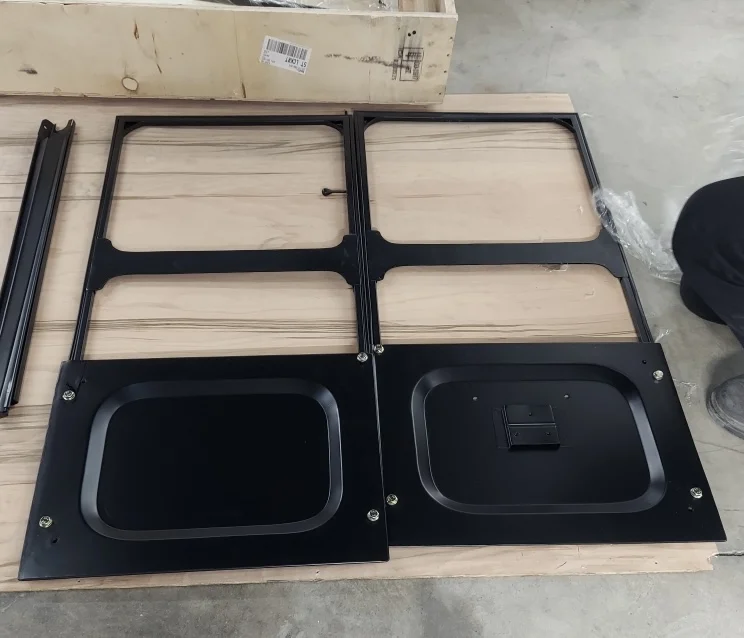

We’re bantering some different solutions to an issue that comes from adding the AQ rear doors/removing the TROA sheet metal from their door frames. (Opinion piece) One of the issues with the TROA system doesn't provide a good latch for the lower door. We wanted a latch for rear door if the top is removed.

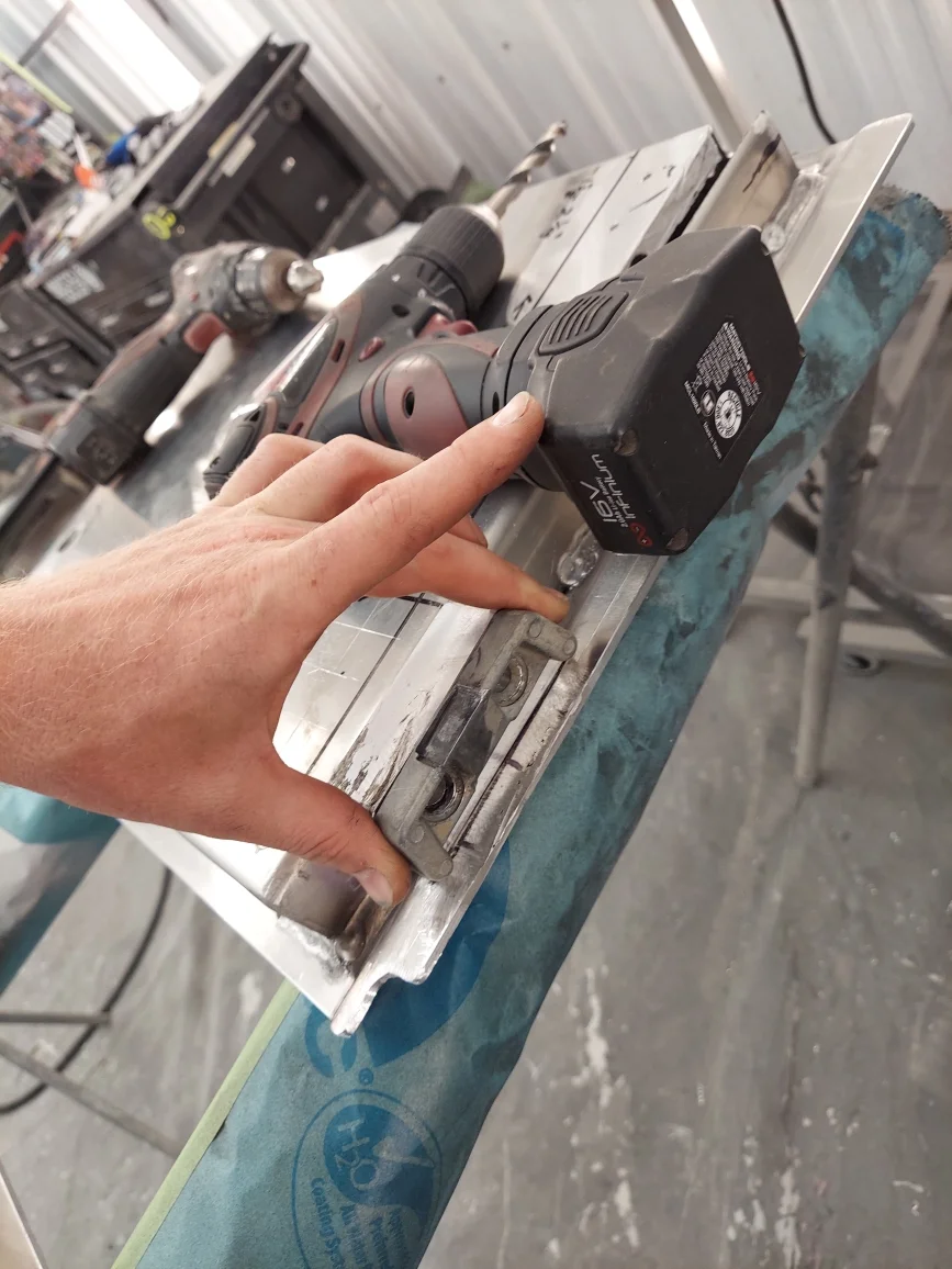

So, a redesign was in order. If you scroll up a couple pages you can see where the lower door was modded to take an OE latch system and incorporate it into the AQ doors. AQ came with a recessed latch but IMHO opinion it’s not the best design. The spring loaded pin into the tub isn’t one of the best designs either. Not knocking the tub, absolutely love it. It’s just some of the ancillary parts that I don’t care for.
The “tops” of the door frames, IOT fit just right, have a slight “lean in” angle. The current plan is to add a bracing system that supports the frames.
I’ll post up some pics later.
Good comparison of the TROA door and the Aqualu door we’re using. Either or would work. I’m blaming g the owner/operator for all of the “what if”, “why couldn’t we” or “let’s try this” additions..😎

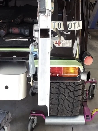

Spacer to position an original ambi door catch. The laws of Mule physics: “For every mod, there’s an equal and opposite mod required in order to make it look like there’s no mod at all” 🙄
