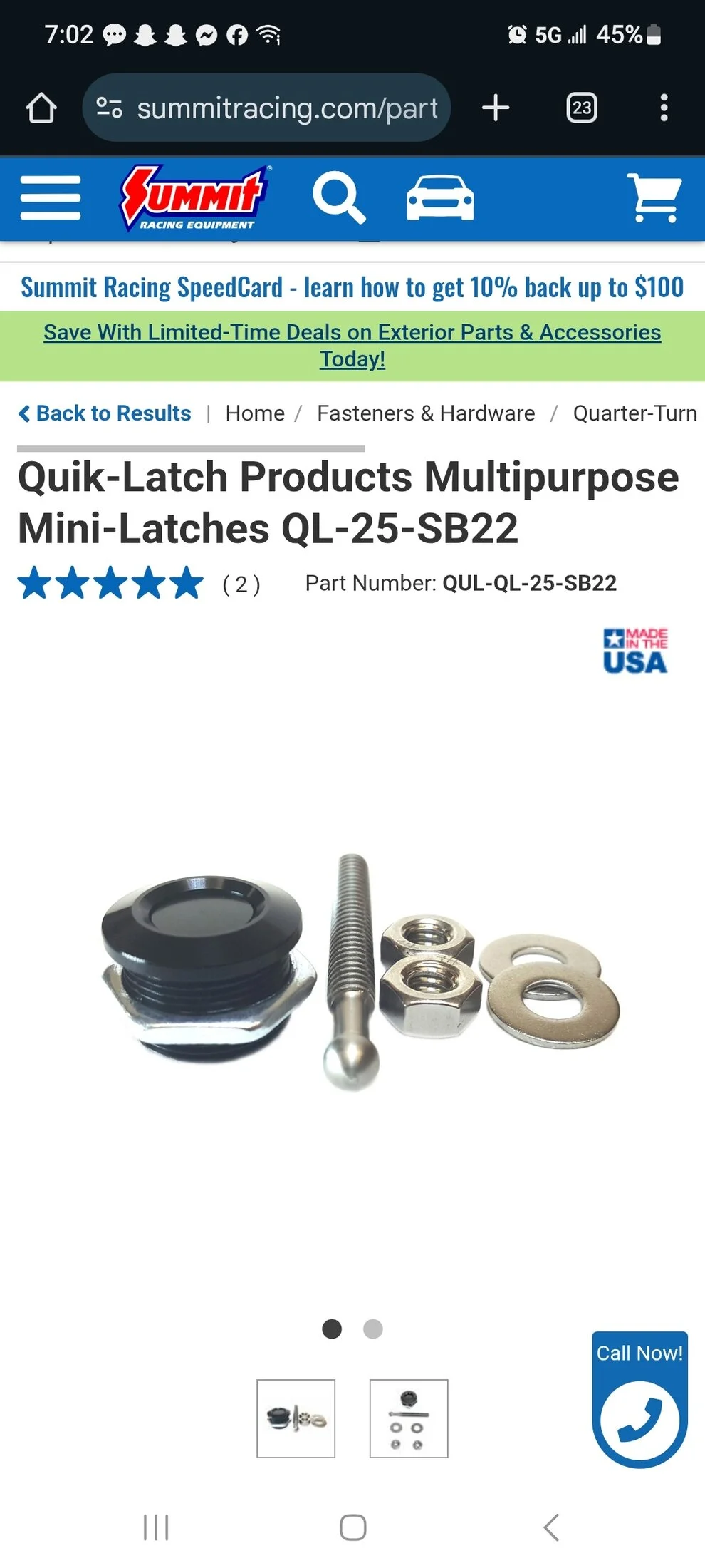

Can’t seem to get the vid to attach. I’ll work on it. Consolation: here’s the quick latch from Summit if your inclined to give it a go..

Does that "latch" by spearing through the door?
Short answer - Yes.
Expanded view of the closeup posted above. 1st pic is looking at the mechanism from inside the bed. It has a “docking” type catch. You can see the collar above. ^^^ If you look at the male/plunger you can see a coiled spring. Insert/lock. Keep in mind, these are not YOTA rear doors. No qualms about opening up the aluminum.

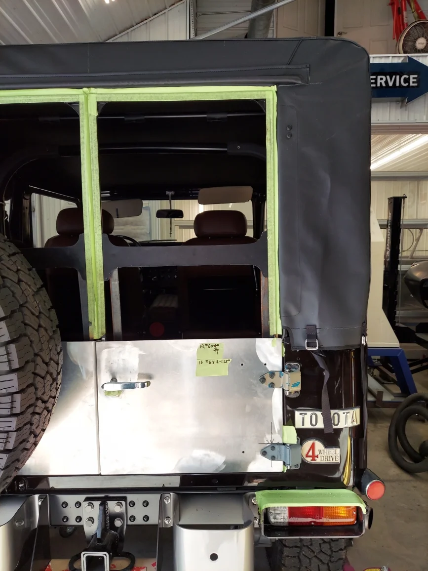

Current ops: You can see the rear ambi 1/2 doors taking shape. Keeping an OE-ish look with the hinges, handle and lock. Mods to the frames and top door hinge(s) also. I think it would have been easier, philosophically speaking, to use the fold down tailgate or 1/2 doors with the roll up rear window. Yup. Sometimes my little Infantry head doesn’t process rational thought when dealing with the Mule. :hmm: You don’t see the Ambi door option in the wild very often soooo hey we got that going for us.
Future OPs: Outside door runs and chrome window trim (no wings) are holding us hostage ref: complete front door assembly. Meh…In the grand scope of things, if 2.0 takes up a Florida life, those doors will probably be hanging in the garage as wall art. And if it stays in the Land of Nod, those doors will probably be hanging in the garage during warm weather ops. Worse case scenario, for the near future, I’ll run the YOTA (who are we @#$&%£€ kidding) safety straps.

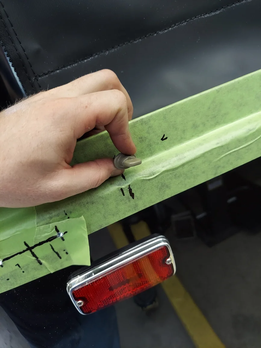

Twist lock/grommet/footman loop installation coming up on the event horizon. There were even some minor mods to the footman loops (why not :rofl:)
