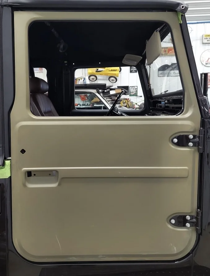

Mock up is “mocked”. Doors and hood remain original 1.0 full blown mule skin. All things considered (abuse from current owner) they weren’t in bad shape. Going to give credit to regular fluid film spray treatments for staving off any serious damage. Inner door mechanism(s) were in very good shape as are the outer handles.
Hit up the Father Son Team at JR’s upholstery with a WARNORD and a BPT engage the door cards. We’ve discussed a couple of options. I think in the end we’ll go with a stockish look with the MGV to match the seats. Meeeeybbee.
I am in no way suggesting this to you however I have been considering options for my doors as well. The CCOT Serengeti door panel painted to match is one that I am considering.
The Serengeti’s were on the table as an option. I really like the clean look. I have a set of the Australian door cards to use as a base.

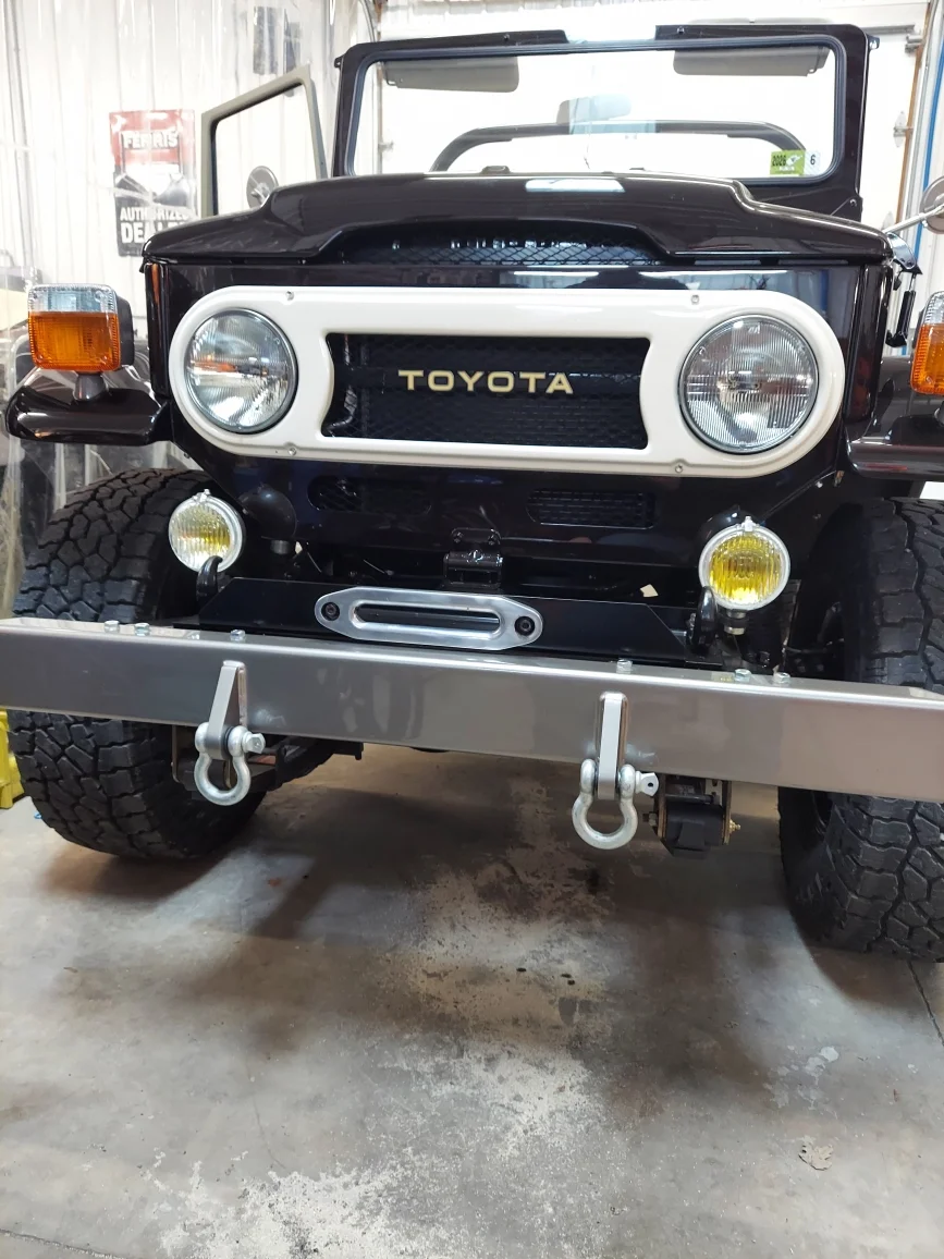

Some of the “smalls” that didn’t make the cut in “24”. Added the D-ring shackles.
Picking up a winch this summer. The Warn 89305 ZEON 8-Looks like a good candidate. With the AQ tub, we trimmed some phat vice the weight of the OE tub. Ms Revenge should be able to extract herself out of any unforeseen asphalt entanglement with an 8k.

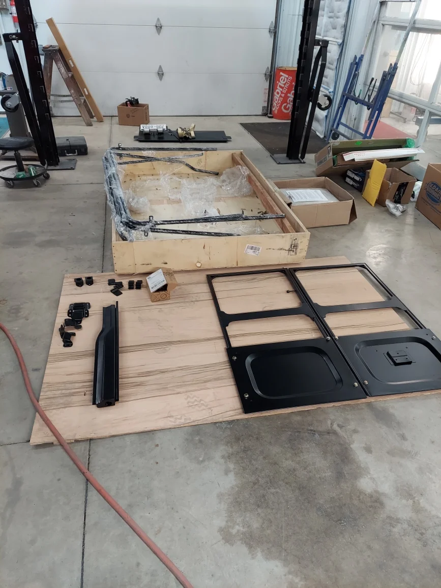

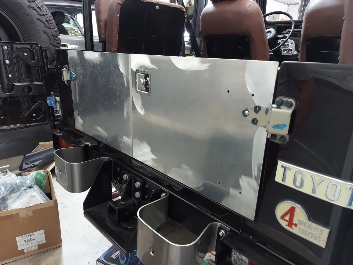

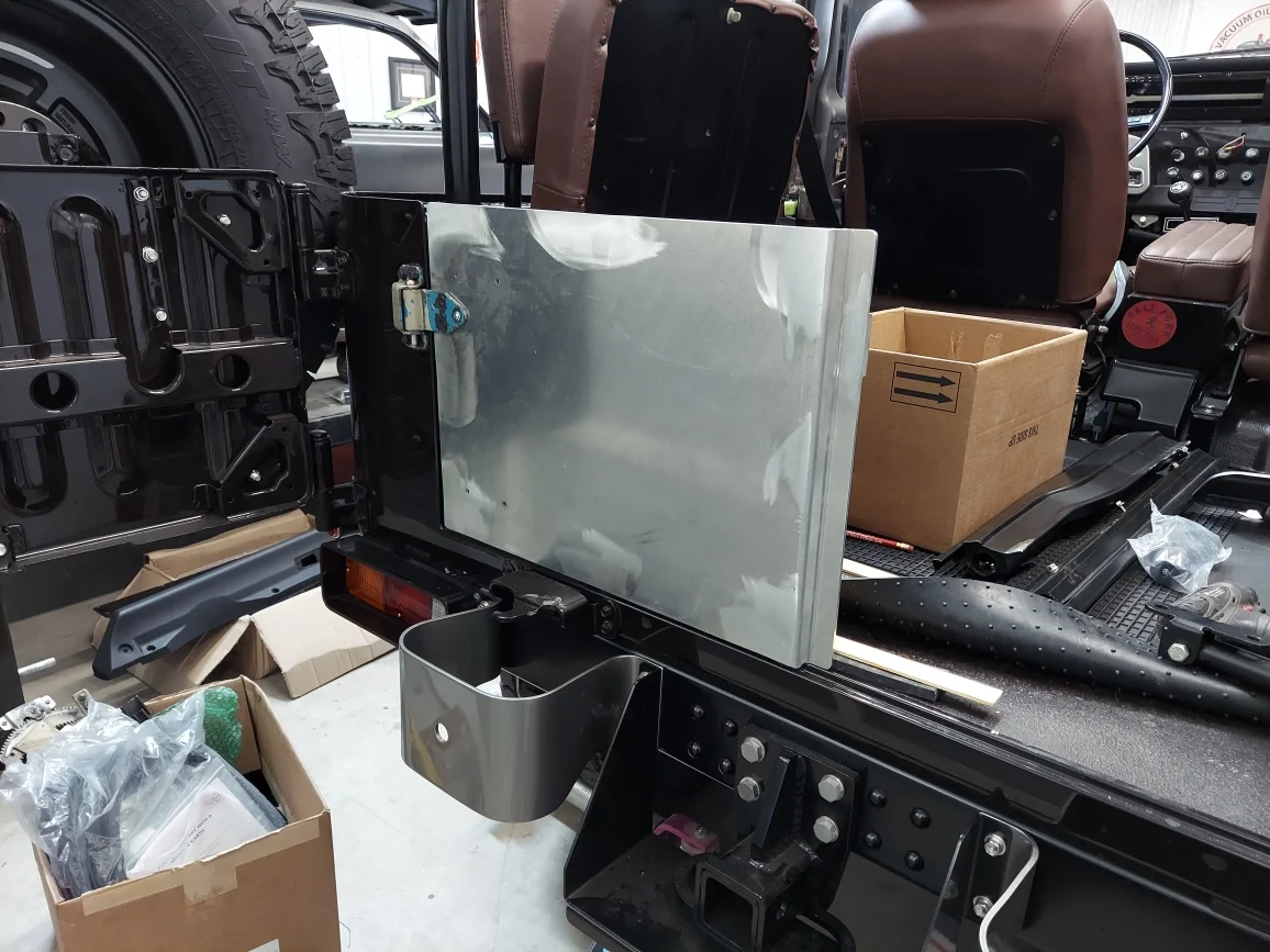

Initial unboxing. The Ambi door selection does come with a tailgate section. I didn’t realize this when I hit the send it now button on the interwebs. I just assumed there would be mods required IOT make the TROA Ambi door frames work. The TROA doors a thin mint at best. Doesn’t make it horrible, just makes it a challenge. We have a set of AQ doors also and a 2nd set of Ambi door hinges. So, without running too far down the rabbit hole, there’s a “spit in the dirt and draw with a stick” phase to make a determination on which way to go.

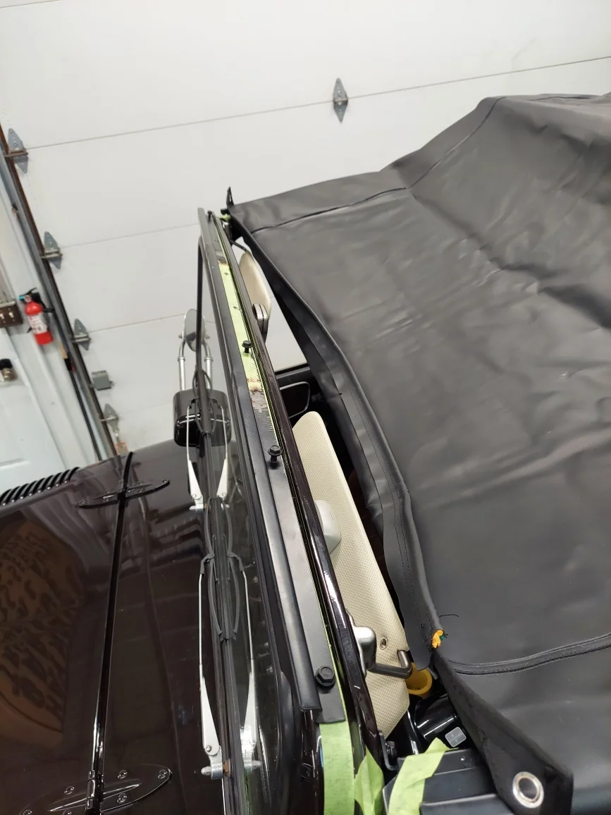

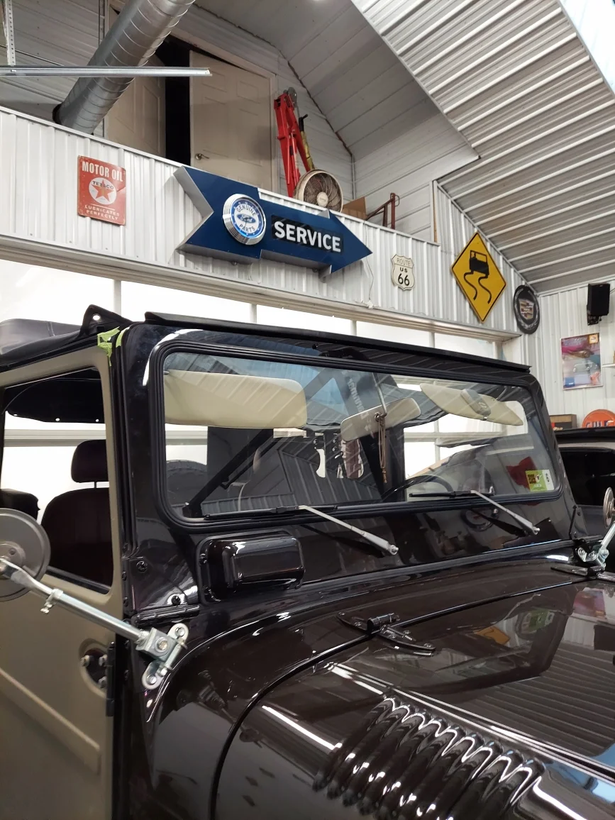

Test fit. Windshield channel going on.
There are some nuances with the AQ cowl/windshield, not complaining, couldn’t be happier with the product but, there are challenges associated with a non OE tub, windshield and cowl.
I’ll post up a review later in the thread for the TROA.
Door gap getting dialed in.
