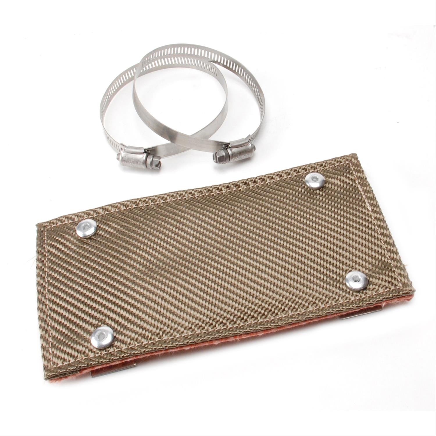

These have helped tremendously:
Also look into Flowmaster 51022 muffler heatshield kit. I used this around the muffler. It now about $60. It was cheaper when I bought it ($39) so worth the risk.
Where did you install these?
I just bought some header insulation wrap and some aluminum backed adhesive insulation. Going to try that in the engine bay on the fire wall. I had some foil faced bubble wrap insulation laying around at work so cut some pieces and put under the carpet. Has helped a bit. I find with the top and doors on, even with the kick vents open, the heat just kind of lingers at the floor. Just scored a deal on a used Bestop so hoping to get that installed this weekend and get some more airflow going.
Under drivers feet.

Under drivers feet.
So are you saying this goes under the floor mat? Or on the pipe below? (off label, so to speak)
