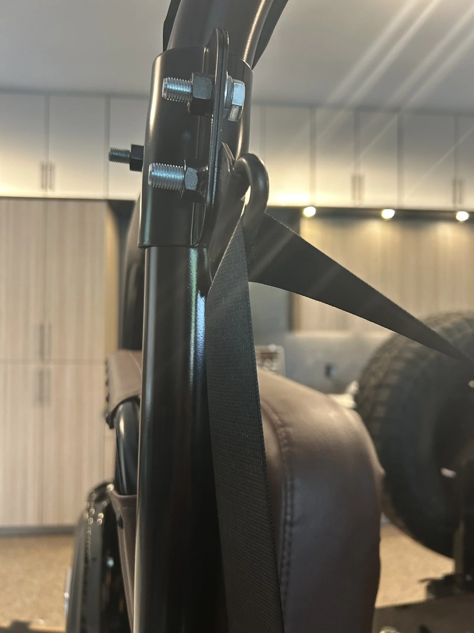

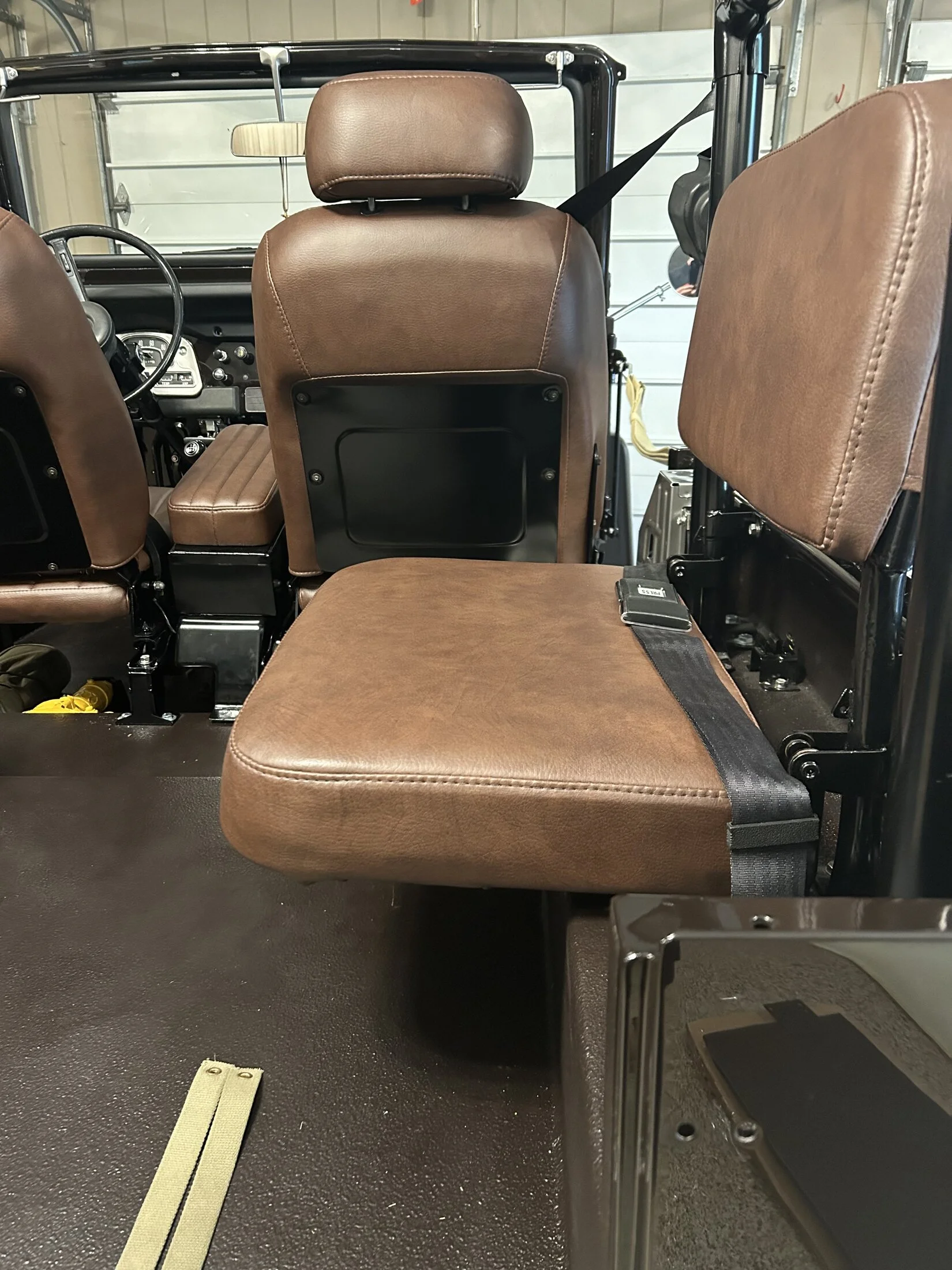

So, this AM I figure I’d knock out a easy peasy seat belt install. Simple enough…Attach to seat, attach to roll bar then attach housing to, hmmm attach housing to thin air... I stood there for a few minutes like a chicken watching a hat trick. Then I rememberized, 1.0 had a mounting point on the tub for the housing. At least that’s the story I’m rolling with..

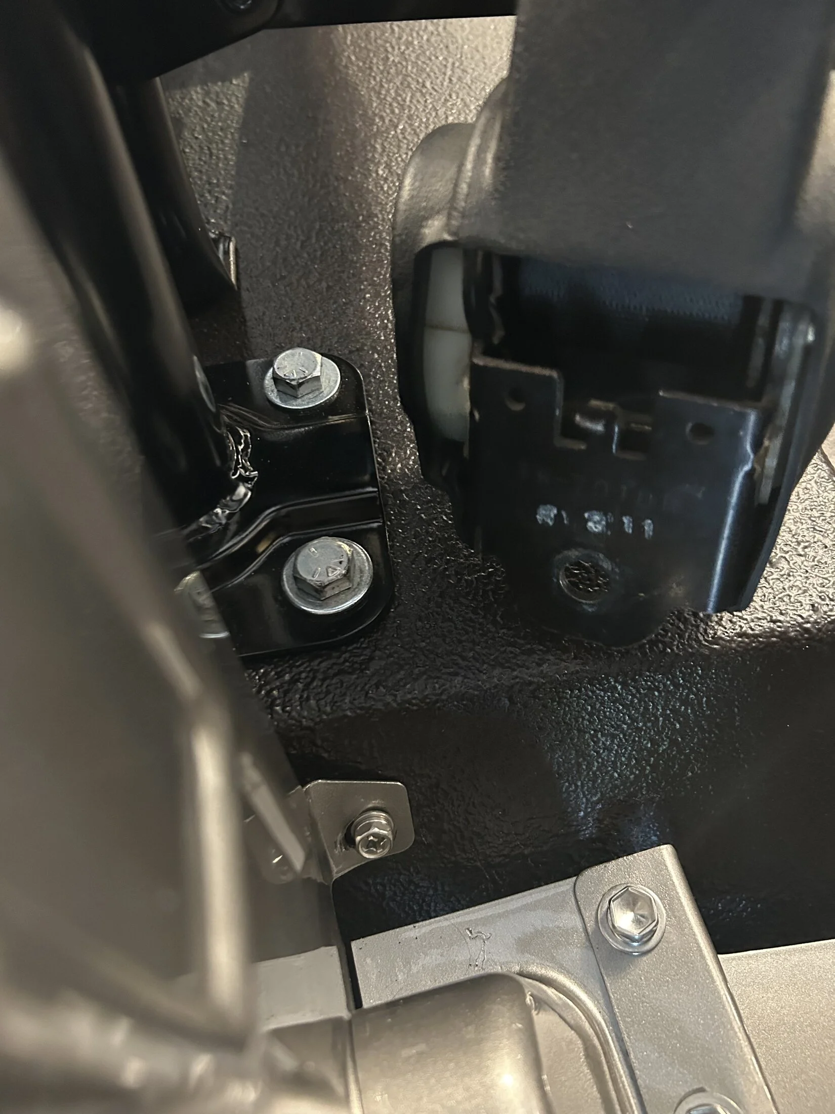

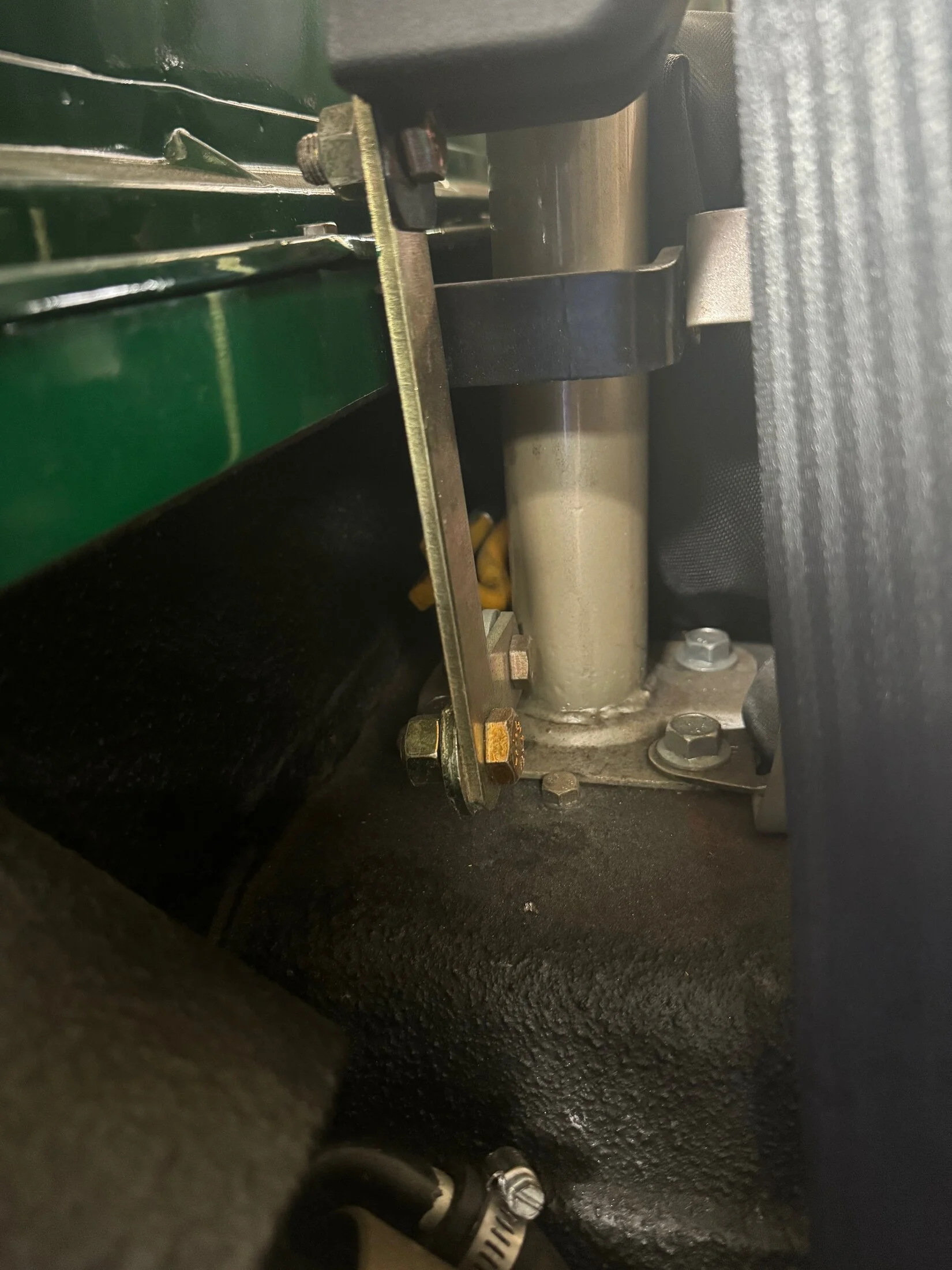

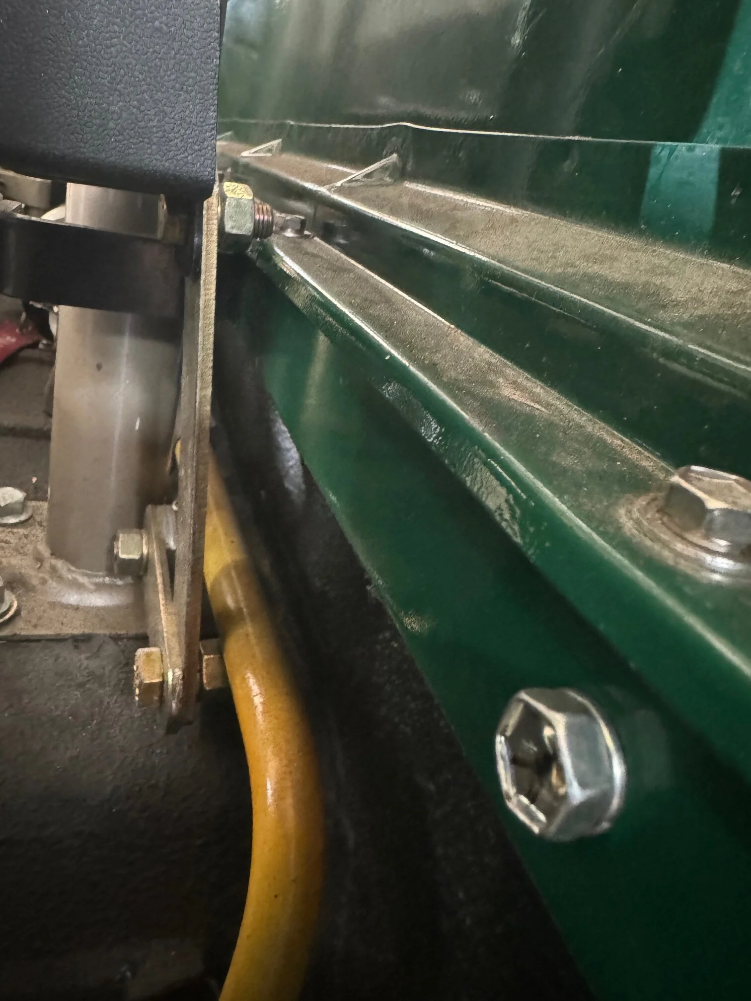

@Green Bean I recall you mentioning at some point either fabbing up or purchasing a bracket that attaches to a mounting point on the foot of the roll bar. Can you be so gracious as to shoot me a visual memory activator of your 3-point housing bracket/mount?? 🙏
At your leisure sir, no urgency implied…😁
Thanks..Assuming 7/16 mounting hardware??
Edit: Did the bracket come in your kit?

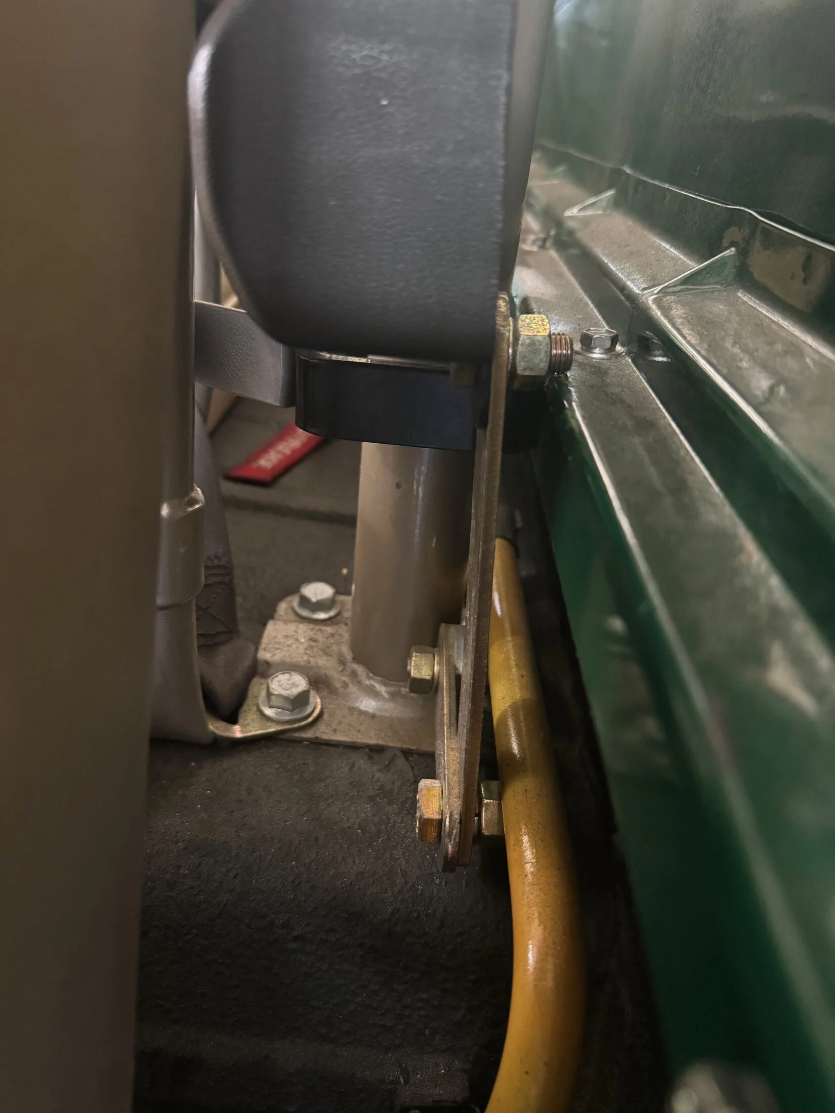

Wow, a trip down "Memory Lane." I purchased this seat belt kit from CCOT. It came with some of the mounting hardware that I used. But, since our roll bar didn't have any provisions for mounting the retractors, I purchased a pair of 6" single bend angle brackets from here. Nobody has ever accused me of being the smartest knife in the drawer, so I'm virtually positive that there are much better alternatives. But I didn't want to remove the roll bar and weld a bracket onto it and deal with repainting, so it seemed my options were somewhat limited.
Wow..That’s not what I visualized in my tiny lil’ Infantry head..I’m liking an “L” type bracket. Something “Romper Room” proof. In my case, I’d need to bolt it to the outside mounting point on the roll bar foot. My clearance on the Evap cover isn’t there.
@Green Bean
Checked CCOT and Seatbeltsplus. That’s for the tip. 😎
I believe the hardware was 12mm. Although might have been 7/16, would be close. Brackets did come with the kit. Found these on Amazon. I thought the powdercoater had lost mine so we had some of the ones below floating around the shop. Of course after I get them painted and mounted, I found the powdercoated ones. But the ones below would have worked fine.

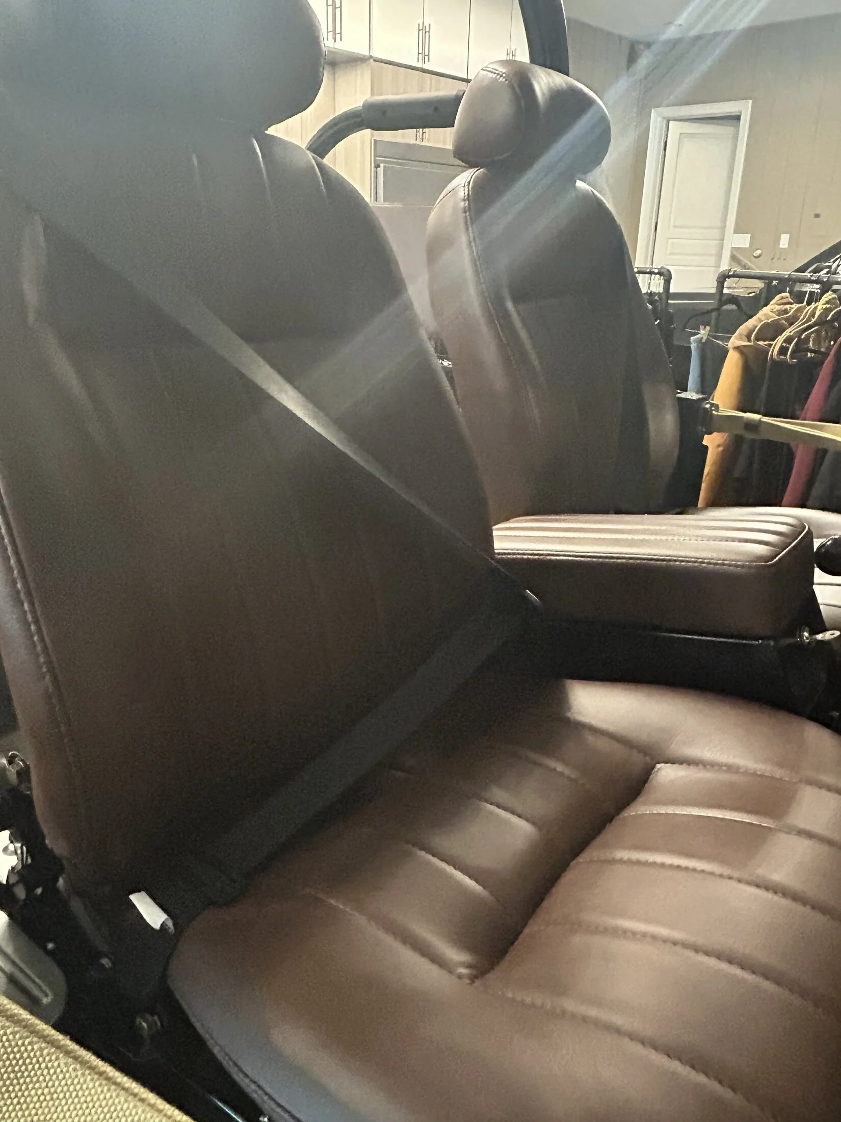

Seat Belts are in… sorta. Ordered a 90* bracket for the housing. Should be here in a few days. Next up, bolt on tailgate and license plate bracket, then hit the local chapter of the DMV. Thinking about sacrificing a box of doughnuts to the “gatekeepers”.
I picked up two extra sets of the 90* brackets yesterday…Trying to workout an idea for my Jseat anchor points.
