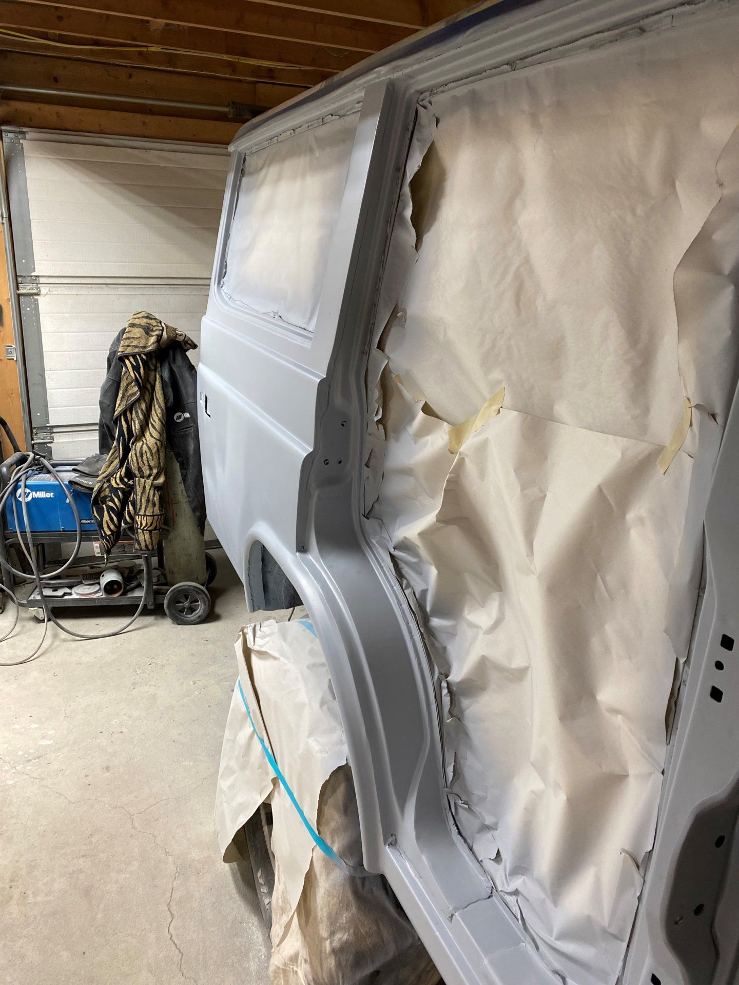

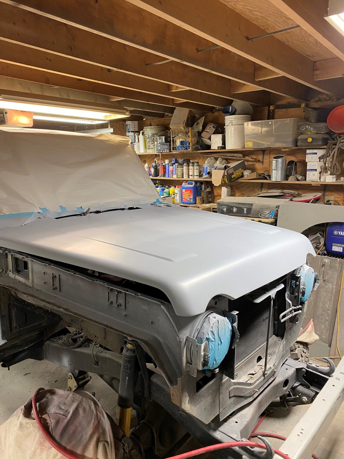

At this point rust repair on the body is progressing well. Still much to do, need to work on the roof, front fenders, doors and tailgate. We elected to primer the body to provide some metal protection before moving to the other areas. Body and paint prep work.

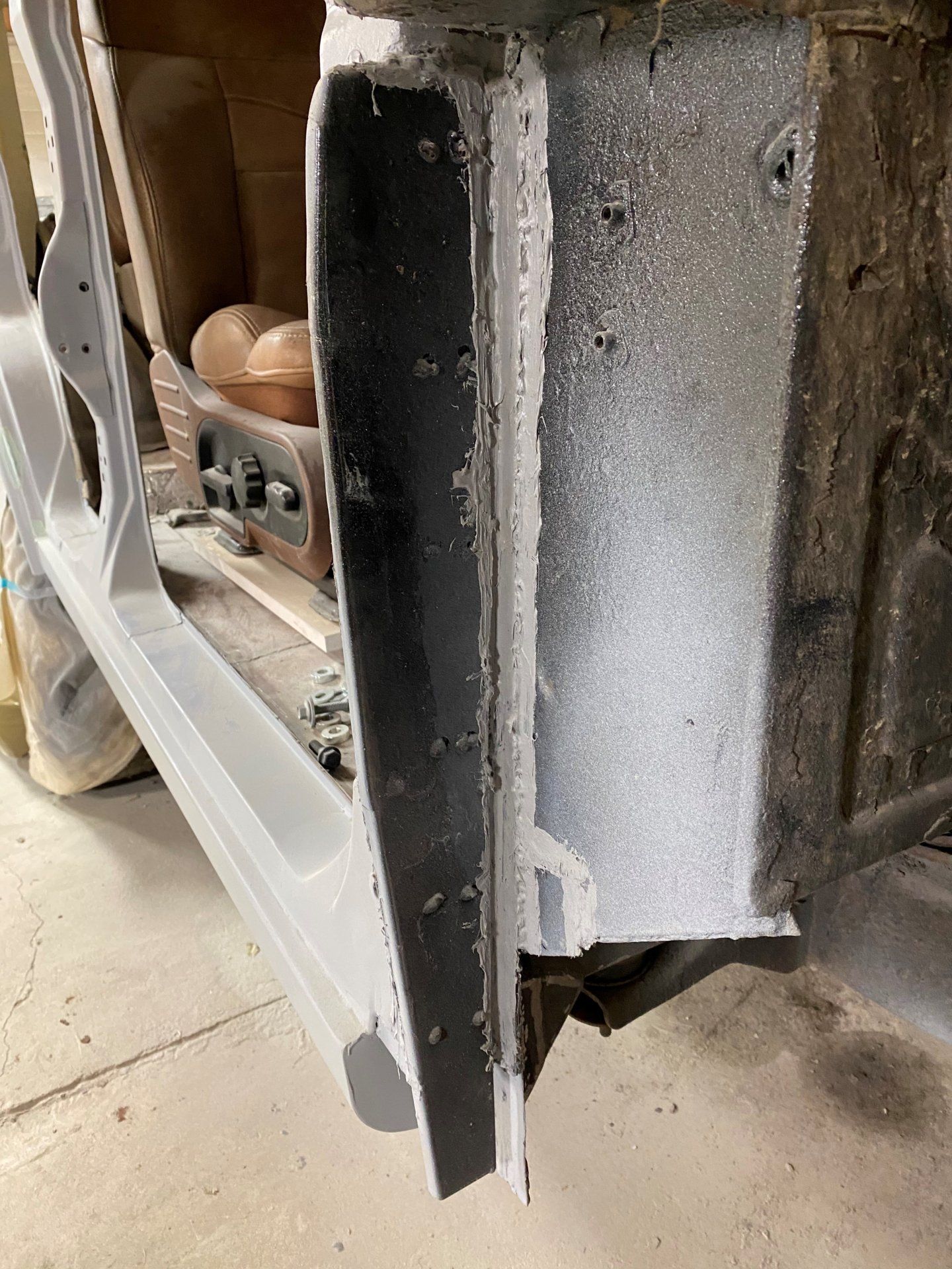

Next phase to attack are the doors and tailgate. Completely removed all hardware. Stripped down to bare metal. Can see the rusted areas at the bottom of the tailgate.
Cut out the bad medal.
Welded in new metal.
Treating all metal with this rust converter. Hoping to slow down any future rust. Of course this pig won't see any more Pennsylvania road salt. Not a fan of garage queens, I drive all my cruisers but they get put away for the winter. March is here and I'm anxious hit the road again.
