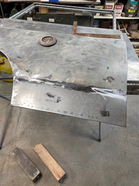

I feel like the doors and tailgate are taking forever! Enough to start wearing me down. Don't see the forward progress. Every part needing some rust repair. Many pieces, stripping, cutting, bending, welding, bondo, sanding and primer. Do it all over again, 4 doors and a tailgate. The payoff is I know we're doing it the right way.

Despite the complete and repeat process I am happy with the results.

Nice work!
