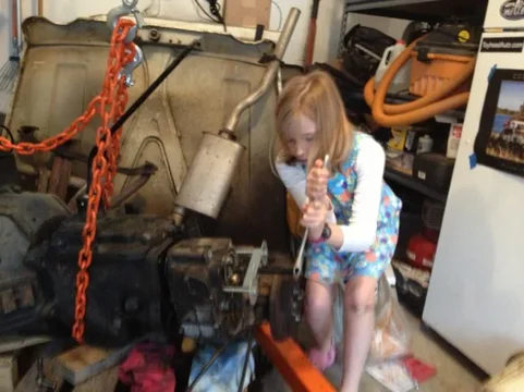

Thanks guys. I got a few hours to work on it yesterday. I had my #1 helper assist on pulling the transfer case:

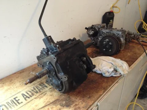

I pulled the transmission as well and cleaned things up. 38 years of crud did not come off easily. The plan is to replace gaskets and seals and parking brake shoes.
I'm planning on doing the same on the engine. I don't have an engine stand, so that may wait until I install it on the frame.

I love having help from my little ones.
Incidentally, that's the same outfit I wear when I wrench!!!
