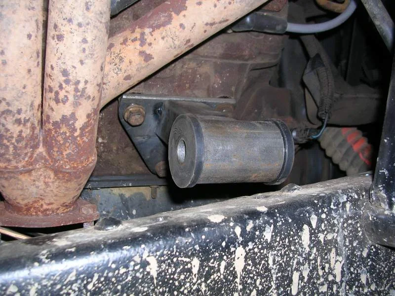

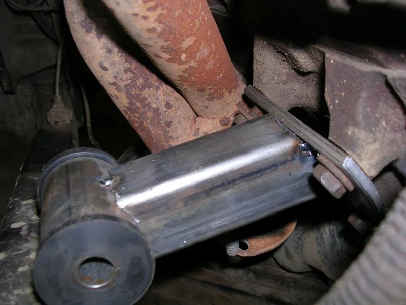

motor mounts....
Had the AA-type in there, allowed LOTS of shift in the motor, side to side, front to back, etc....trying to reinstall the tranny crossmember was already turning into a PITA...
So, somethin beefier, and much more stable....these outta work....
one more, welds cooling, frame side mounts tomorrow morning (family party this aft, cleanup time...plus, outta shop propane, and it's gettin chilly!)

The mounts your making, XJ bushings?
Do think this will flex less than the donuts? I've got the donut style motor mount (Downey with Toyota rear engine mount donut) and one of them is flattend out.

I definitely feel this will flex less.....DOM sleeve and poly bushing/insert were from PolyPerformance.com. Few other shops I know make these too, real solid stuff. Basic leaf spring bushings...
Hated the donut mount since it could easily shift on the horizontal plane....dammed irritating.
