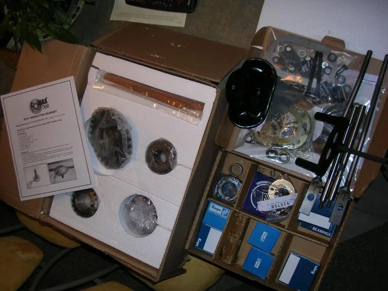

first is my care package from Advance Adapters....LoMax 4:1, pimpin twin stick, and the D300 rebuild parts.
