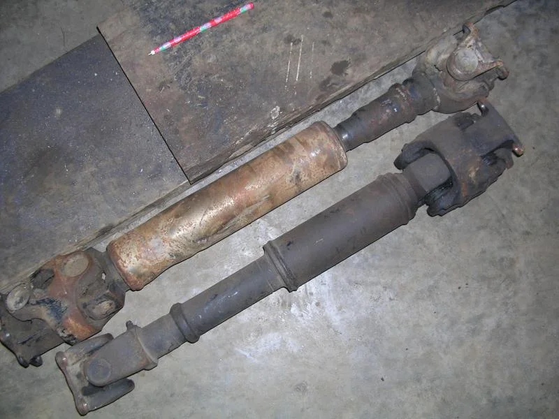

Rear will be 24-1/2" or so...interestingly, that's the identical compressed length of a minitruck CV shaft....I "hope" that switching to a rear flange instead of the 1310 yoke will put me in that range....

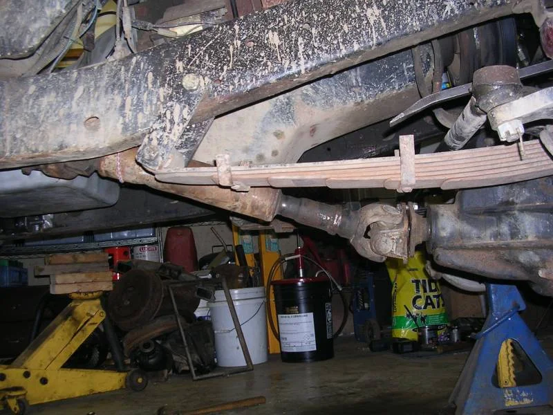

Front, from the yoke face (mid-u-joint) to the face of the front flange is 40-7/8". Shown is the mockup of my old dented 27-1/4" CV shaft (mini CV, Cruiser slip/joing/flange). Again, it's quite possible a stock mini CV would work here, but I'm FAR from a shaft expert.
gonna PM Jess in a PBB thread now, and call Tom Woods Monday as well....Preferably, I'll run Toy joints all the way thru with flanges on the D300....however, I'm unsure I'll have either end setup so they require a CV (front is VERY likely tho....) Also unsure, at least in front, that there is room for a flange and stuff...may be forced to run the stock 1310's up there (no big deal for front work)
two more shaft pics....one of the estimated operating angle of the front shaft (that's the longer one in there) and the 2nd is of both of my CV shafts for a length comparison...

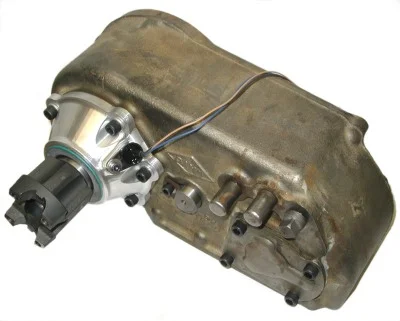

Twin sticks are enroute, Lomax 4:1 is enroute, HD outputs are under consideration...stalling for the new Novak 32-spline short rear one...and may not do the front one
this one....
According to my call to them, they are hoping Jan 15...course, it was originally pimped in the September 2003 4WD&SU magazine on page 79, and hasn't been released to the public yet... (yes, I have the issue...dammit...)
