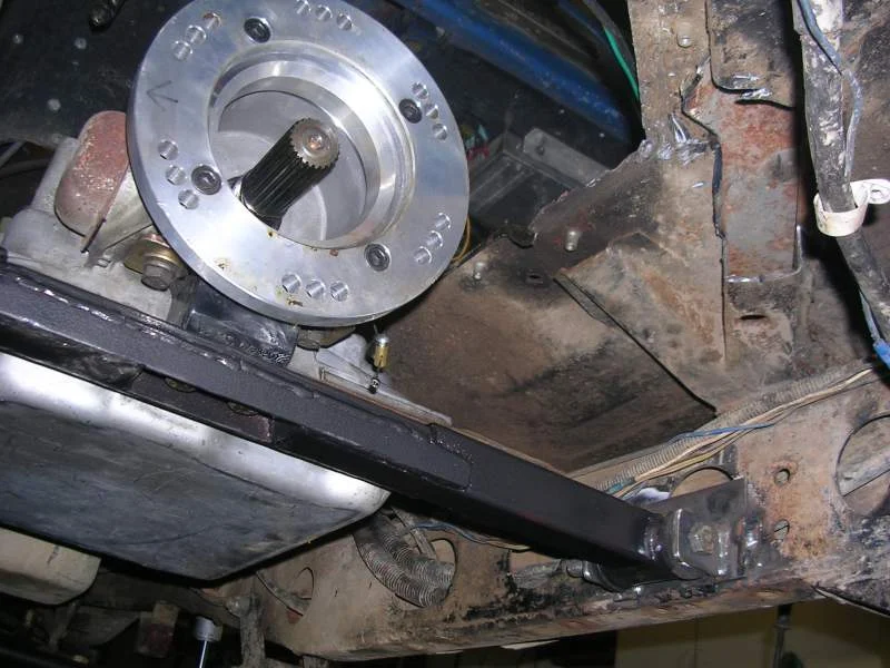

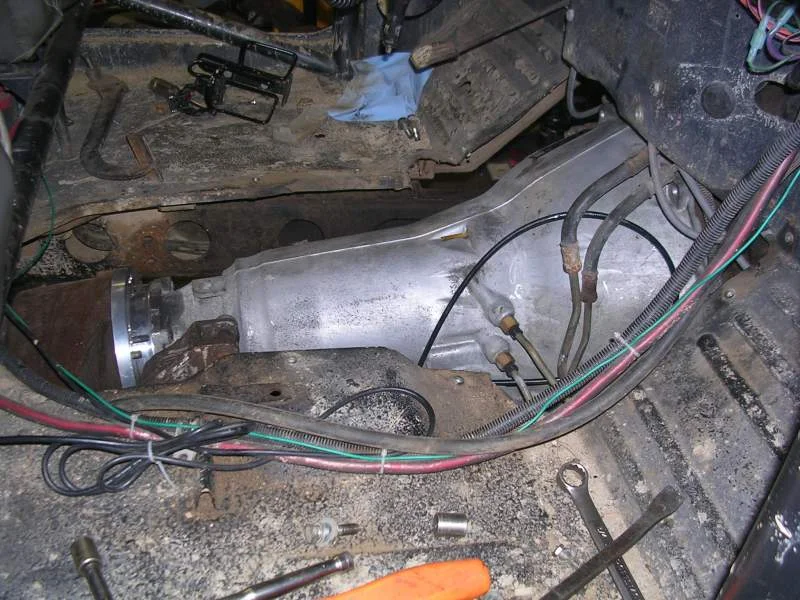

two pics from 11:30a this morning....DEFINITELY gonna get a double-front driveshaft to miss the tranny....an expense I was hoping to avoid, but am not gonna fight...
however, she's nice and flat underneath....pan is same level as the frame rails....
next: tranny mount bracketry....
2:45p...crossmember is fabbed up, just need to come up with a creative idea for the frame-rail side....
pretty tight on the front yoke....which is good....tube ends up in the same plane as the trranny pan...

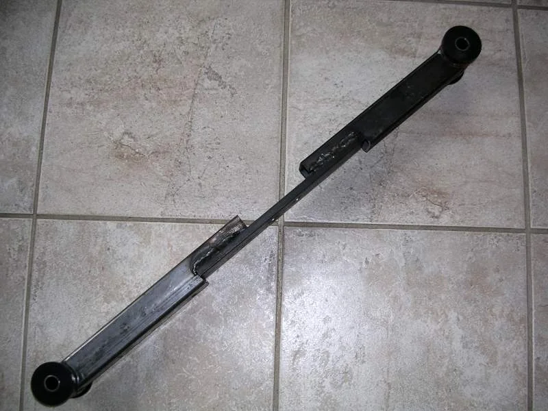

crossmember mount option 1....don't like it, gonna ditch it...
buddy just emailed me, he used spring bushings/tubing on the crossmember, and a couple tabs welded to the frame.....I was considering the same idea, just not with the poly...another thot was with shock eyes (you KNOW I love to use those for projects....hehehe)
any thoughts?

Good to see ya ditch first design, looks weak. :flipoff2:
I went with a poly bushing on each side of my crossmember and have 2 tabs on the frame like suggested. And for God's sakes man, plate the frame where you plan to weld the tabs to, this light weight s*** is out of hand. :doh:
installed....made some more tweaks to it, still gotta weld the frame plates and paint those, but will wait until the tranny is back out....
