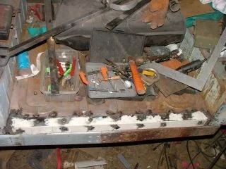

Well I went ahead and started tearing the rear axle out to flip the springs so I can get the measurements for the rear quarters to be moved back before I finish them. Took some picks of my passengers side lower sill cut it off totally but I think I need to cut it higher to meet the door opening. It will be easer to weld upand blend in that way I think.

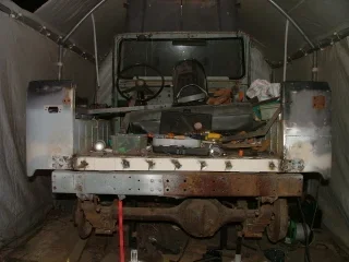

Got my springs flipped so I can now cut my rear fenders and move them back I measured from the axle to the front then tuck that measurement to the back and added 1 inch but I think I might need more for the axle to move back when stuffed. Any one out there have some suggestions.
Can you see a problem with these springs I might need a new pair.
here some pics of the rear fender moved back I should be able to fit 35s in the wheel well after a SOA now and I’m starting on the pass side decided to replace the hole bottom section I was just going to cut out the rust and replace the metal. But since I’m in there.

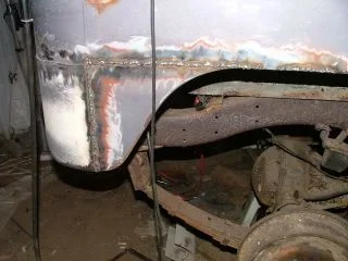

No problem Burl, I’ve got plenty more to do without the axles I got the drivers rear quarter all welded in need to grind the welds down and be done with that side. got the pass. rear welded in shape now to cut out the old and weld it the new. I’ll try to post up some pics tonight.
chris
Got a lot done this weekend. Finished burning in the pass. side rear wheel well burned in the rear sill. Burned in a patch panel on the pass side lower door well. Another couple of weeks and the body will be ready to take off and prep / fix the frame.
